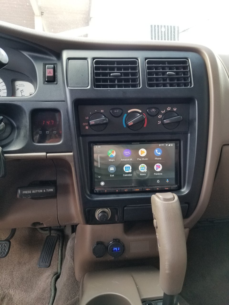

    The volume knob was one of the reasons I went with the unit as well! Also, as Ron said, the orange color background you can select goes great with the factory dash lighting.

    My radio totally love it!

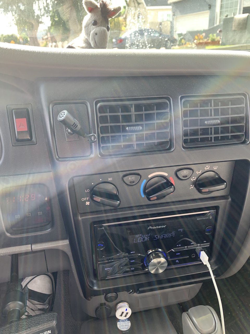

    I have the same unit but cant get android auto running. It tells me put the vehicle in park when it already is. I'm guessing I didnt wire something up correctly. Maybe you can help me out.

    I ran that green ground wire to some bare metal around the center opening behind the radio.

    Hmm. I'm going to remove the radio tommorow and check for my ground. Also going to try finding a spot for the microphone.

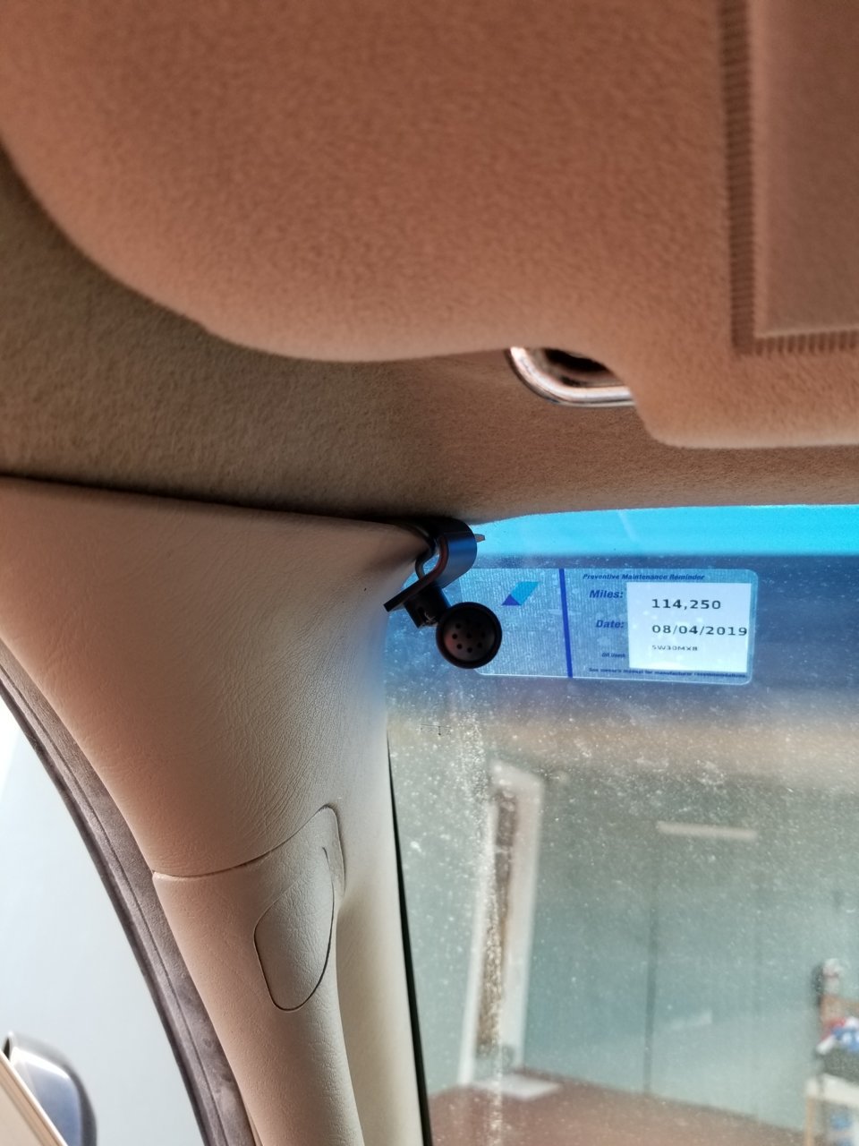

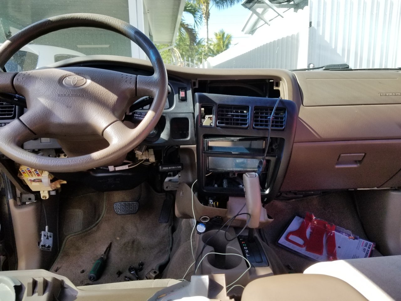

    Got around to removing the radio today. Ran the green wire to ground. (Finally have android auto) Ran the microphone. Also wired up a voltmeter/usb. 20200119_120606.jpg 20200119_131907.jpg 20200119_131921.jpg

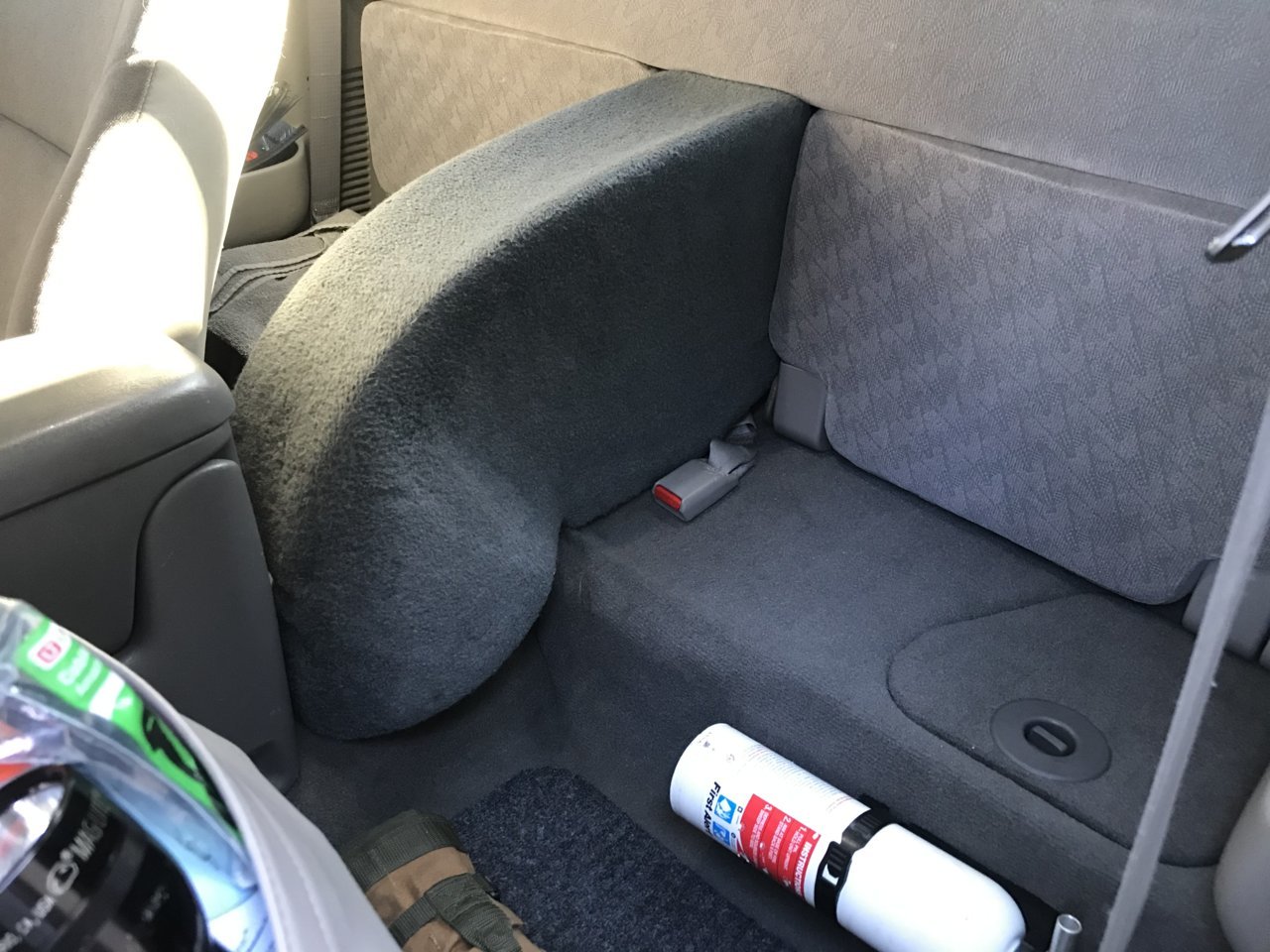

  20. Jan 23, 2020 at 7:13 PM
    #80
    chrslefty
    chrslefty [OP] Well-Known Member
    Apr 20, 2012
    #77258
    3,028
    chris
    Mesa az
    01 trd
    Stockish
    How do you like the stealth box??sound good??
