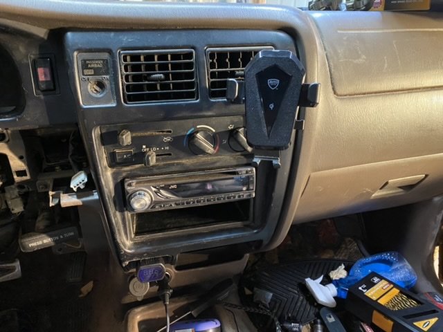

    Finally working on putting the dash back together for now.
    I got the JVC installed. I will be all back into all this again in a week or two if the stereo I paid for arrives in that timeframe and is in working order.
    I also got the wireless charger put on the vent but still have to run the power cord for it. I modified the 2 lower power outlets to be constant power instead of switched. The truck doesn’t really sit much since I found the wiring short.
    more to come once I swap the head unit again!!

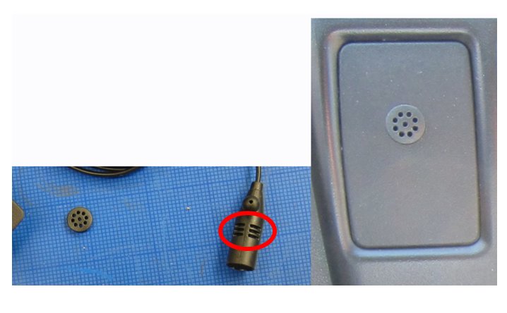

    If you mount microphones like this keep in mind that it is defeating the ambient sound cancellation features of the mechanical design. The vents on the side of the mic, circled in red below, function similar to how a pitot tube on an airplane samples from directly forward vs. from the sides to separate dynamic from static pressure. Here's a quick link if you haven't reverse-engineered pitot tubes yet: https://www.quora.com/How-does-a-st...t-work-if-in-this-case-there-is-relative-wind . The mechanical design of a microphone can be thought of as essentially the same type of pressure sensor as a pitot tube, yet the body is designed for higher frequency response.
    When those side ports on the mic housing are blocked, you will have more background noise and the mechanically-designed beamforming is defeated too if present which helps focus the sensitivity on the preferred source.
    Also, this approach gives a direct mechanical path for vibrations to transmit from the dash to the microphone sensor. The reason these little cheap phone mics are mounted on a single pivot with a cantilevered main body is because it acts as a frequency filter to reduce direct vibration transfer. I'm sure you guys already were aware of this though and are comfortable with it.
    Not intended to be critical, just not sure how much you guys are into mic performance.

    Thank you for the extremely educational post!! ..... now to look up pilot tubes.

    Modern mic design is why Alexa and Siri can resolve voice commands across a room. The other trick is electronic processing based on time delays between multiple mics. But the above is really an attempt to do the exact same thing by use of the mechanical design such that the background cancels itself out by being 180 deg out of phase between what comes through the side ports and the main frontal ports.

    Definitely by far without a doubt the most I've ever read about a microphone. And now I know what pitot pressure and a pitot tube is:D

    I discussed this experiment at length with a friend with a background in electronics (and who's a bit of an audiophile) before trying it. We knew there were some real risks in what we were trying. But the alternative was going to be to hook up no mic at all, cause I can't stand the way they mount originally, and it was easy to try.
    Not much expected, and not much lost -- I've probably only used the mic for a handsfree call three or four times in the last 18 months!
