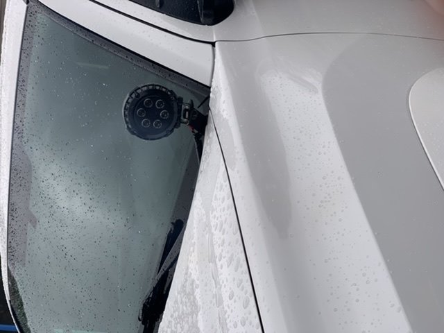

    Did you use the harness supplied with the Ditch lights to hook up the OEM style switch? I'm looking to do the same with the G34s.

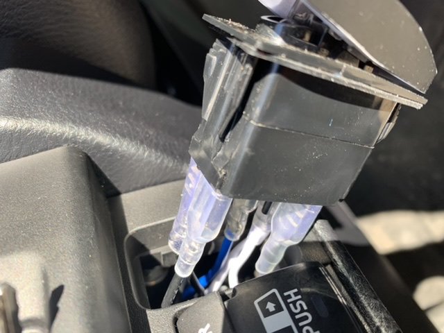

    so this just crossed my mind and I’m gonna ask most likely a stupid question but I’m trying to think of everything it could be possibly. So my switch has 5 pins. 2 negative on top 1 in middle and 2 on the bottom. I’m using a 4 pin relay... again I don’t see how it would be the problem since it did work before I had installed and routed into the truck cab. I really really love these kc hilites I just want it to work! Lol damnit. Btw I’m 99% sure it’s got nothing to do with quality or durability of these lights. They’re built of the highest quality. I answered my own stupid question already I know.

    Post a pic of the switch.

    Clear as mud. Do you have a volt meter? You need to trace the voltages until you find where a wire is loose or backwards. The switch likely operates the relay, so it seams to be working...so Check the voltage and polarity at the passenger KC connector, if you have 12v there check your polarity. If not check all your connections on that side (grounds and hot). If it worked when test fit you have introduced a connection problem most likely.
    Do you have an ohm meter?

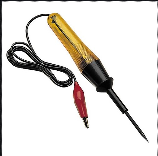

    These are cheap and quick to tell if you have power. Cheaper option than a meter, but having the meter comes in handy. And yes, if you don't have power at the connector on the wiring harness at the light, you get to start tracing lines.
