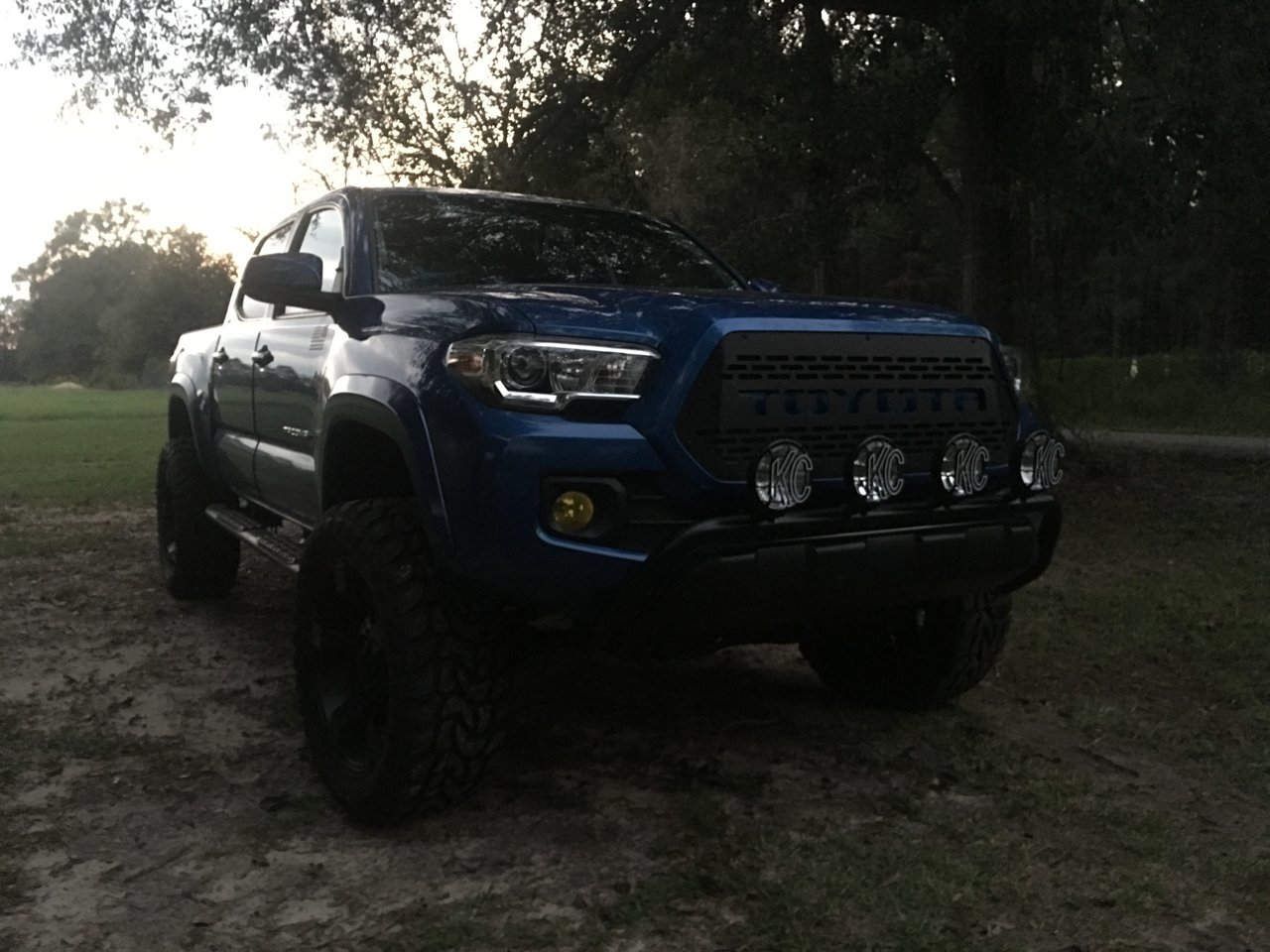

    My Revtek has 4 tabs built in and my 5” Apollo’s just bolted right on using the supplied posts. Note the Revtek instructions had all these directions about pulling the grill and such...I was able to carefully slip the brackets in and bolt them tightly with box wrenches without removing anything. Helps to have someone hold it up. I covered all the wires with split tubing and wired it all back to a centralized box on top of the fuse box, because, well, I’m a nut job. ;-). There is a wiring cowel beside the steering column I passed through the firewall and I mounted my switches in the coin holder space on the left side of dash above the rear window switch. I tapped the high beam to run the relay for the drive lights.
    Light it up and post a pic!

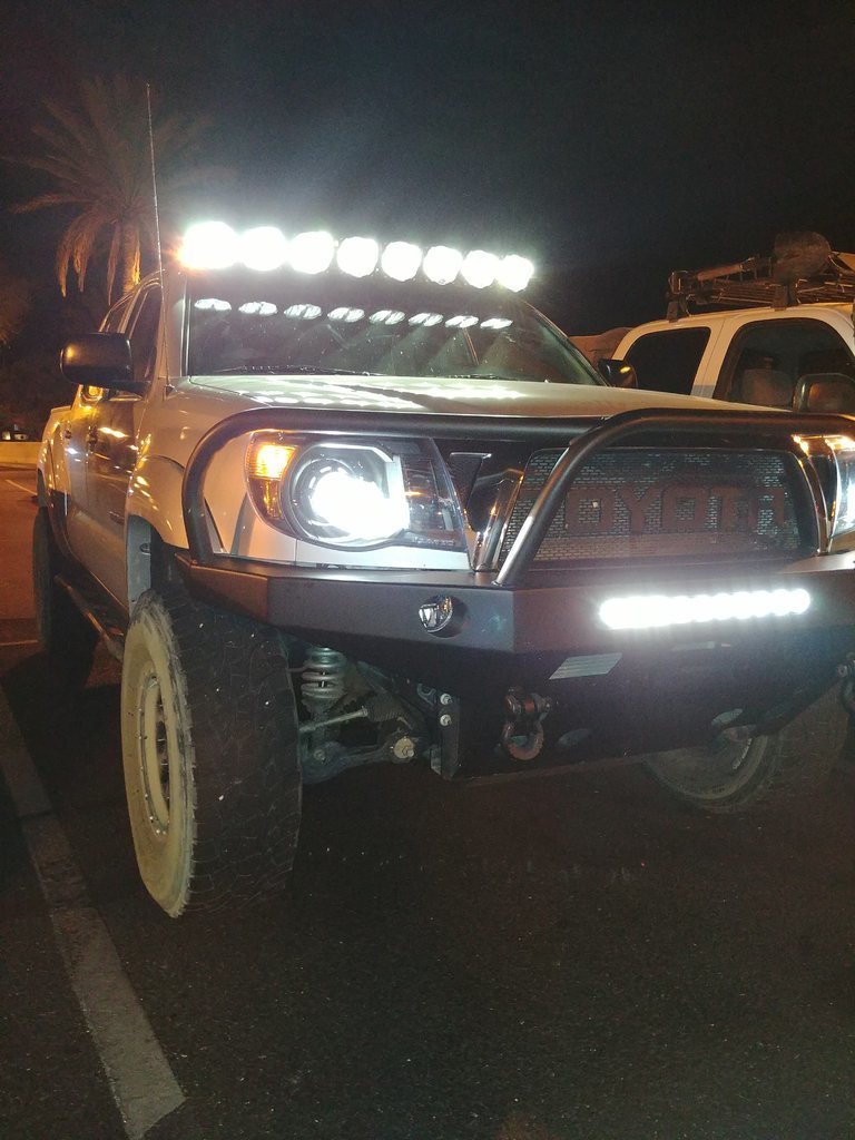

    Forgot to post this pic of my truck from a TW meet a few weeks back! Courtesy of either @Brindybot or @05tacomabro. I really need to work on getting my own high quality pics haha.

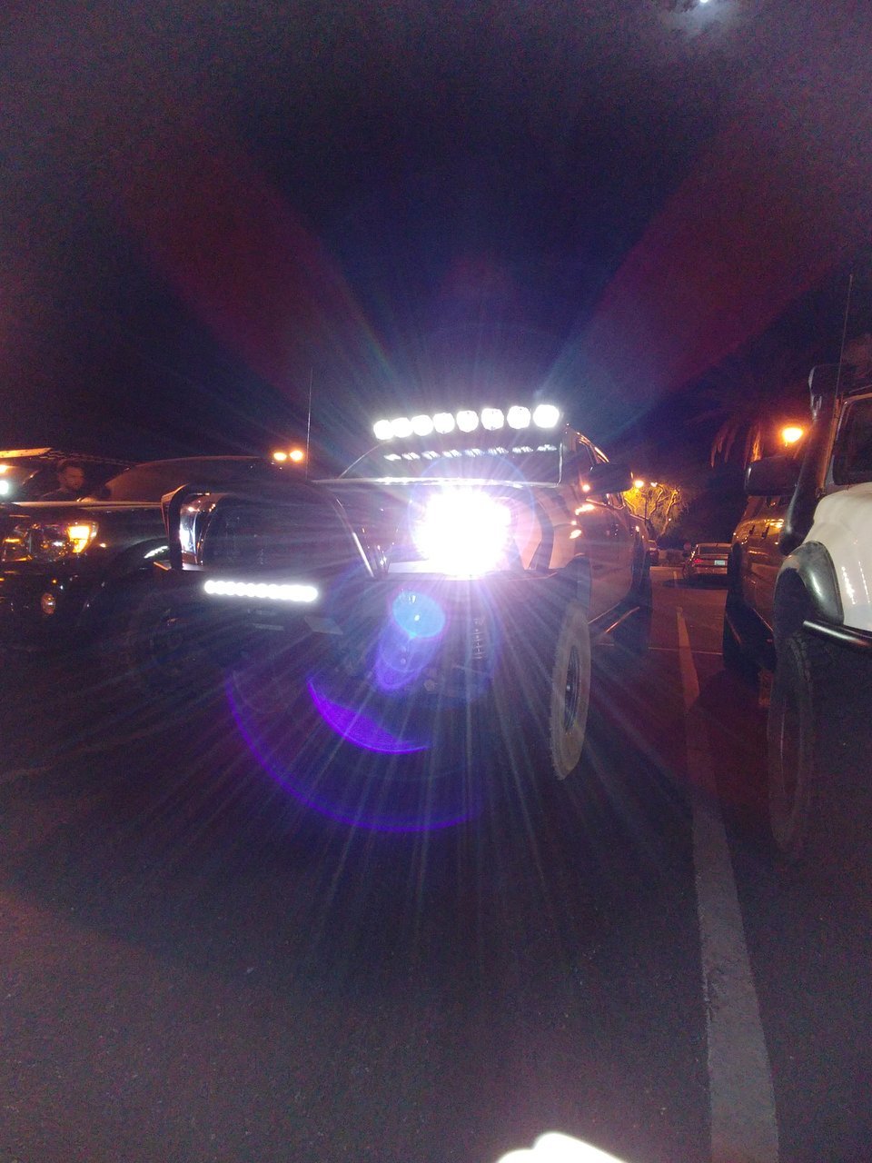

    I was just using my phone but heres the second one I took as well kinda shows more of the lights up top.
