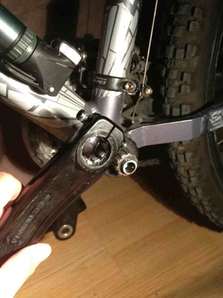

    Was stoked to go riding this weekend but this happened last night :( .I think it's just the crankset (FSA Moto-X) that I have the replace, tell me if you see something else though?
    The bike is a '11 Norco Bigfoot
    I'm just out of warranty, is this a difficult repair?
    P.s.
    From personal experience and reading reviews the FSA Moto-X crank is a POS. This is the second time I've replaced it, first time under warranty. I haven't even taken this bike down a trail yet :rant:

    So the crank arm fell off it appears.? If the splines are ok, can't you just mount it up and tighten it down. If the pinch bolts are coming loose, maybe loctite em....

    its hard to tell without looking at it in person but from pics online it looks kind of like the head of the bolt broke off some how and is stuck in the spindle. the design looked similar to shimano hollowtech in the picture so thats what im thinking. its possible that the bolt just fell off too but its hard to tell

    It's pretty easy to replace the cranks & bottom bracket. Before you replace that tho, can you clean off the BB axle and inside of the crank arm, replace the arm and tighten the pinch bolts?
    If you go the replacement route (which it sounds like you might want to do at some point), you will need a bottom bracket tool to remove the old BB. Depending on what you get to replace it with, you may need a different tool for the new one. You can find youTube videos to show you how to do that swap. It's pretty easy to do.
