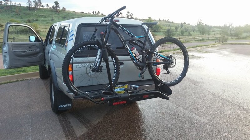

  20. Jun 4, 2015 at 11:00 AM
    #8060
    manitouyota
    manitouyota Well-Known Member
    May 30, 2015
    #156414
    207
    Austen
    Manitou Springs
    2001 TACO DC 4x4
    Is that Buff Creek?
