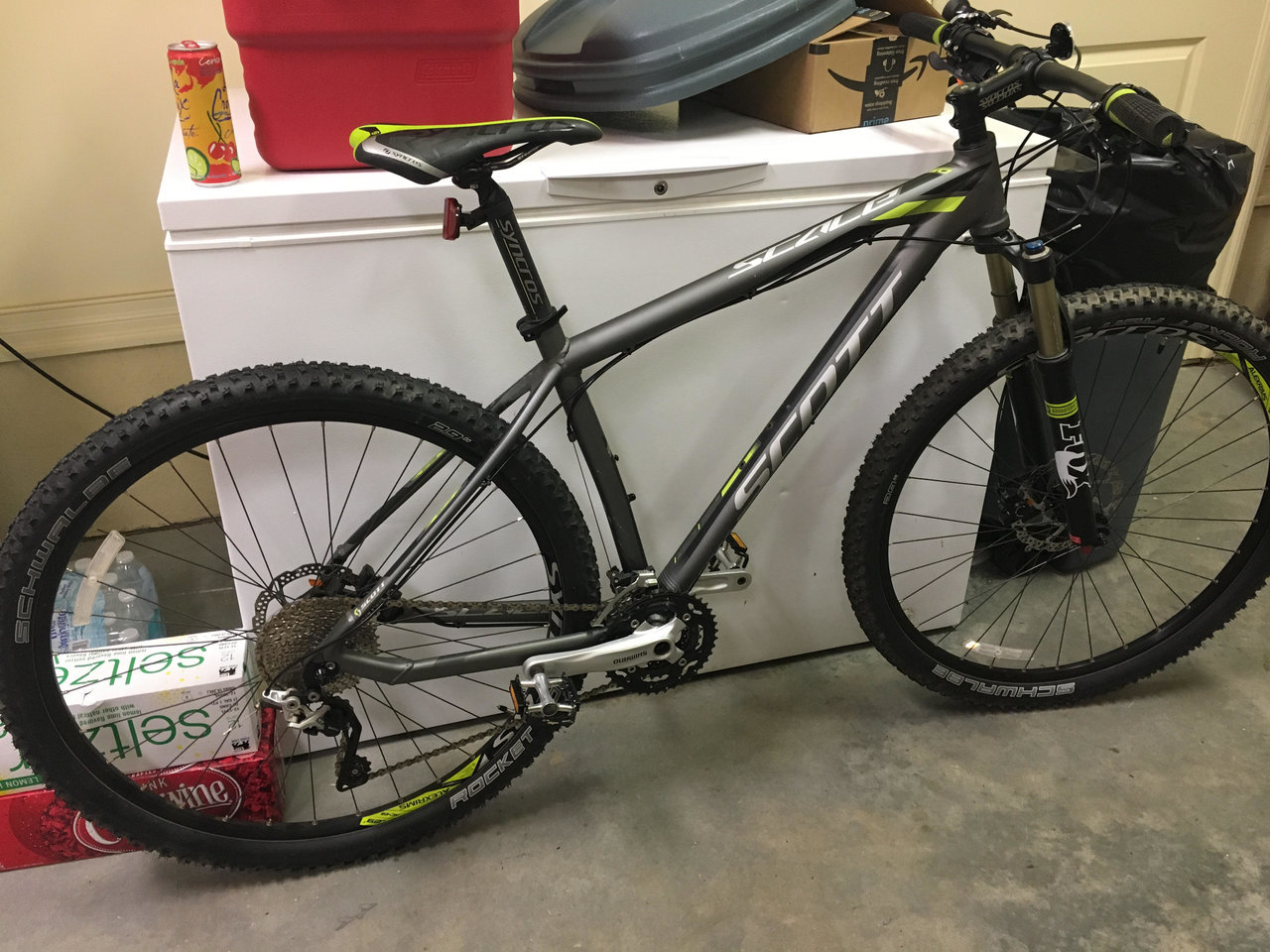

    Scott Scale 950

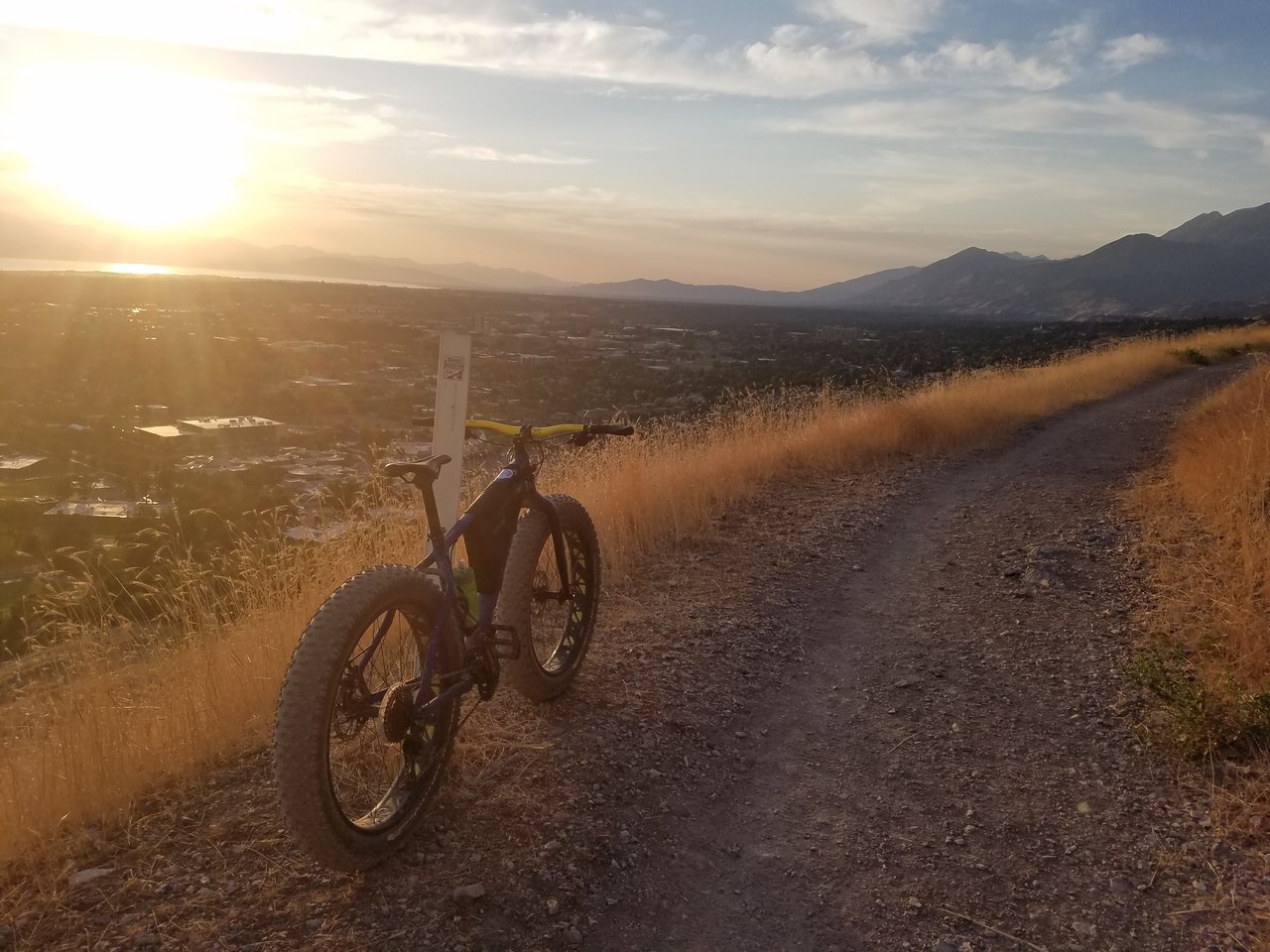

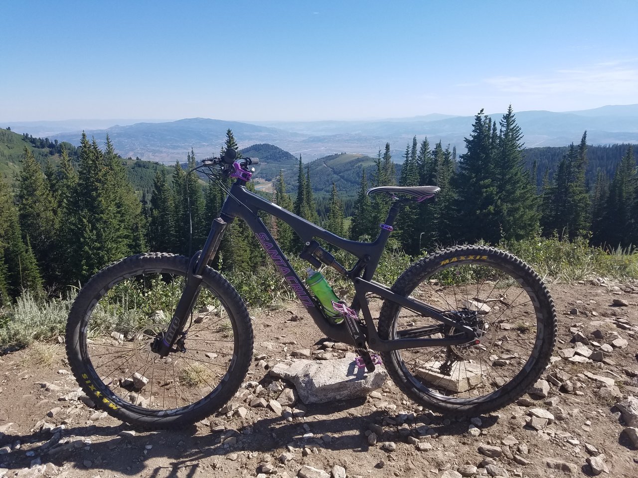

    The steeds:
    Top of Wasatch Crest Trail
    Post Crest / Post Tour of Utah viewing watering hole stop (didn't have a rack) with a bud and his '97 Gary Fischer:
    My boy Blue:
