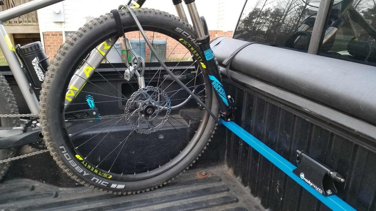

    I built a new bike rack for my truck. The one I had before attached to the top rails and I had to leave the tailgate down when I drove. This new one attaches closer to the front of the bed and the bike fits inside now with a half inch to spare.
    I beveled and welded the ends because I'm hopelessly OCD
    Used some stainless steel hardware in the bed for an attach point
    Now I can keep other gear in the back without having to worry about it flying out of an open tailgate.

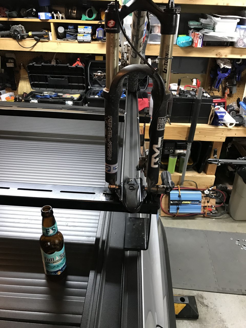

    Yep KB Voodoo and I’m trying to reuse some Rockymounts, but there’s still and issue with how the rocky mounts attach to the trays. What I have here does not work:
    Where the bike mount was attached to the front cross beam, I have to bolt it to the very front portion of the bike mount, and not to the wheel tray like I have it shown on the photo. The way I have it is not secure in the front. I have the voodoo cross beam bolted to the rocky mount wheel tray in both places, using the bolt track under the wheel tray. The front of the rocky mount where the fork is attached... that’s a separate piece. Because I don’t have it directly bolted to that piece, the mounted bike flexes back and forth quite a bit. This was the maiden voyage, and I didn’t even use it. Got to try to make it work. Thought no one would notice, now I got some splainen to do! :facepalm::facepalm:
    Mounting the cross bars directly to the fork part of the rocky mount is problematic. It’s so flush, that the tightening mechanism (the handle thing) lacks clearance and at best is inconvenient. So I have to think about a spacer or big ass washers. To eliminate flex, the rocky mounts must be installed flat, clean and tight. Still have not got it right. That’s the scoop man.

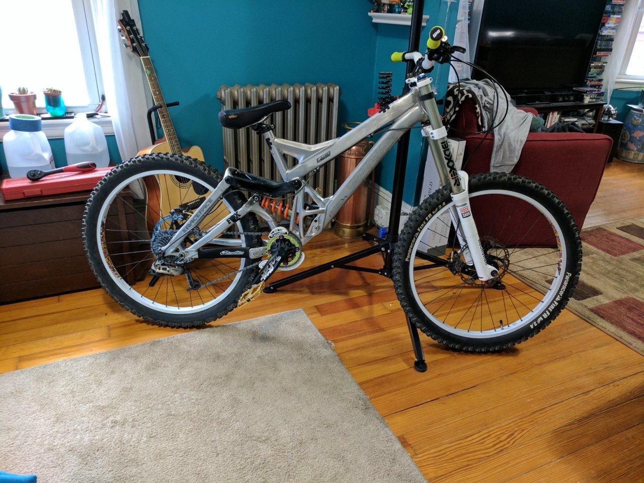

    Shes a little dated but for the amount of riding i get to do these days she serves me just fine. 04 demo 9 pro frame i s ored on the cheap and built up over last couple yearsIMG_20170727_181505.jpg

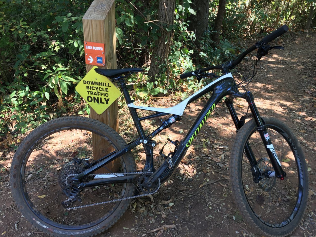

    My stumpy in its natural habitat. Still patiently waiting for my taco to be built...

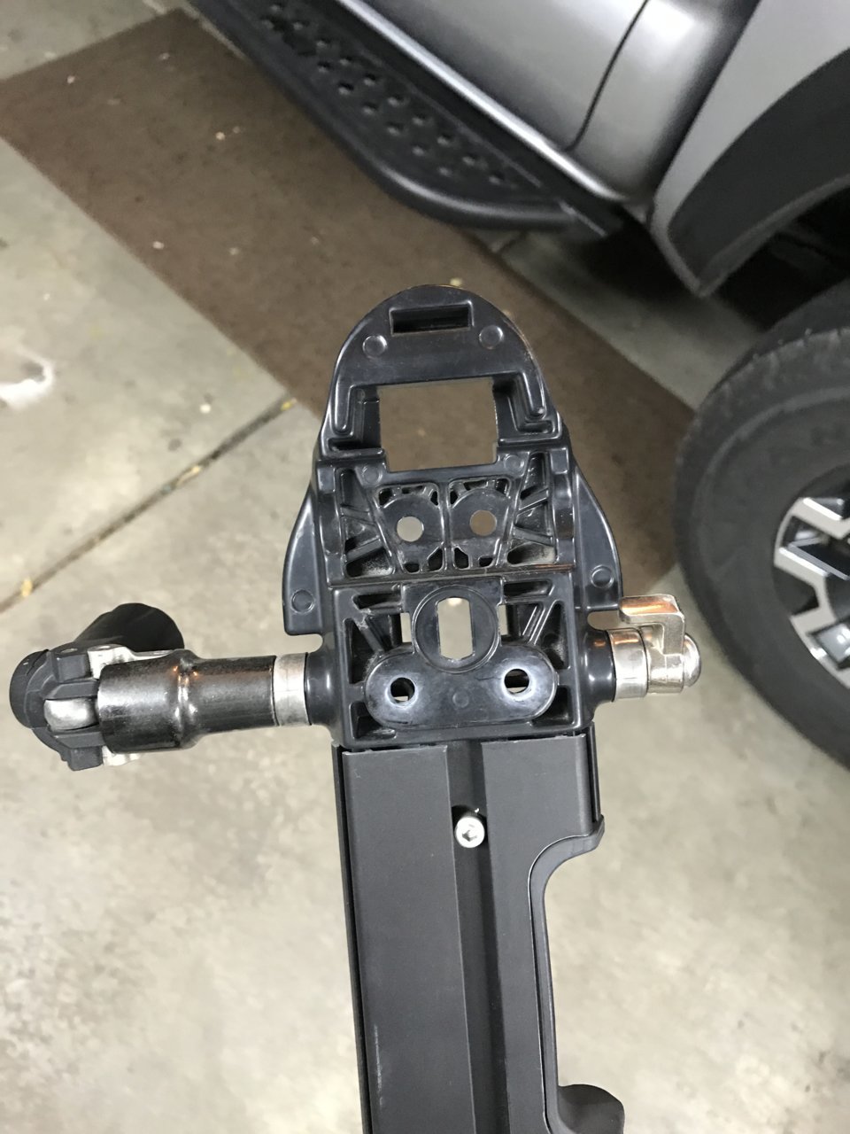

    Okay, the Voodoo crossbars are awesome, but it looks like the Rocky Mounts won’t work. It’s better but the mounting point up front still allows too much sway. When it’s mounted like it’s supposed to be normally on a rail, the mounting surface is wider so it resists the torsion.
    That’s the first problem. The second is that the release clamp won’t turn when installed anywhere along the the voodoo rail. The only place it works is on the outside as shown in the pics below.

    Nice bike! I'm on a stumpjumper as well, but not one that nice. Also awaiting my truck to be built, lol. Welcome.

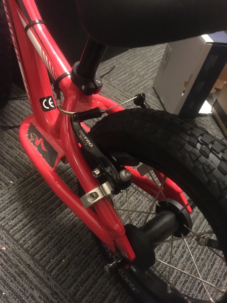

    Added brakes to the kiddo's bike. He was starting to scare us on the hills.
