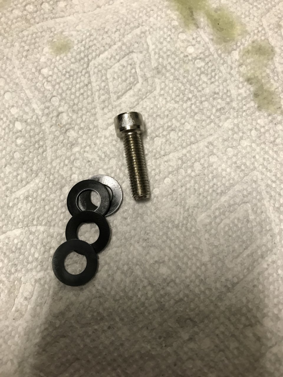

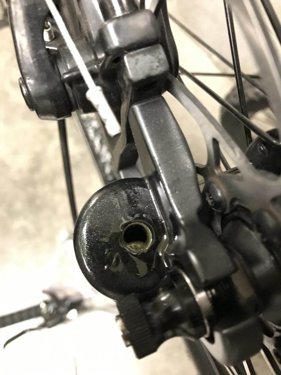

    Cheap fork probs.. noticed some drips on the garage floor, remove bolt and find four washers supposedly "sealing out" the oil? I'm assuming this is not normal?

    Not sure what you mean "sealing out." Were all 4 washers under that bolt? Doesn't look like the bolt head would even hold them. Most forks have a small crush washer under that bolt. I'd see if I could find a small nylon washer that fits snug around the bolt and button it up with that. If it hasn't lost a lot oil, you should be fine. Looks like Fox green, you can order some online and add a little if you want, but they usually take a specific amount and you don't want to overfill.

    I only lost a little bit, it was basically weeping from the bottom bolt, only a couple drops per night. I ended up cleaning off the bolt with acetone and adding some teflon tape to the threads, so far so good but if it comes back I'll have to see what the deal is with all these damn washers, and try to replace it with just one nylon or crush washer. You are correct, the four washers were under the bolt.

    I missed it, what brand and model fork is that? It seems odd that it's a plain bolt. There's usually a stud, crush washer and nut at the bottom.

    It's a DNM RC-32. A cheapie air fork.
