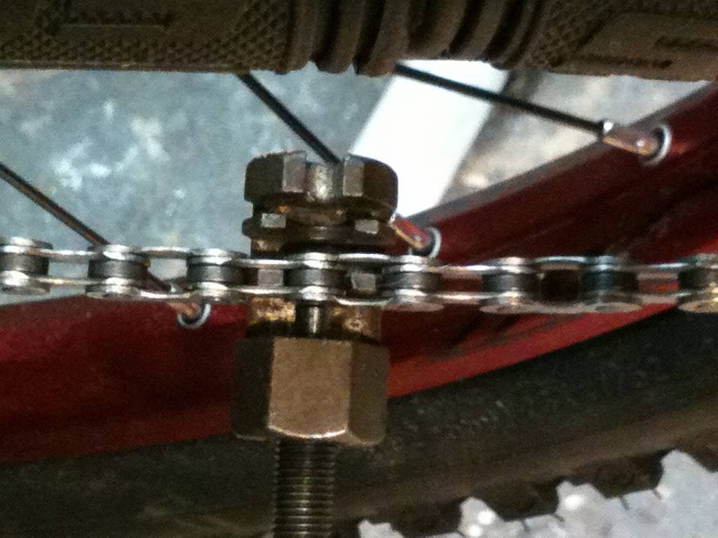

    flipped my bike over and started checking things out. I think I found the problem. as I am spinning the pedals the chain moves fine until one point and I can see where there is a link that does not move freely as it should. One link gets kinda stuck in either and up or down angle and makes a "click" sounds as it moves over the rear der. I think when the bike is under load and as soon as that part of the chain goes over the cassette is jumps track and goes into 6th gear.
    Would I be better off just getting a new chain or try taking my bike to the LBS and seeing if they can repair mine?
    As I said before this chain is pretty much brand new with only 5 or 6 rides on it.
    I tried using a degreaser and working the link around and re greasing it to get it to move more freely but I did not succeed :(

    Do you have a chain tool?
    you can free a link pressing the pin a little, you use the upper notch in the tool.
    I can post a pict tomorrow.

    no I dont have a chain tool. I should probably get one though...its just one of those things you never think about until you need it

    when you get one.. you can free a tight link by putting your chain in the upper notch and apply light pressure, this will spread the plates a bit.
    in this picture the tool is sideways, typically the threaded part is "up"

    Thanks. I'll see if the bike shop has a chain tool in stock I can grab. I was actualy up there erlier today getting new brake pads and I didn't even think about it while I was up there..
