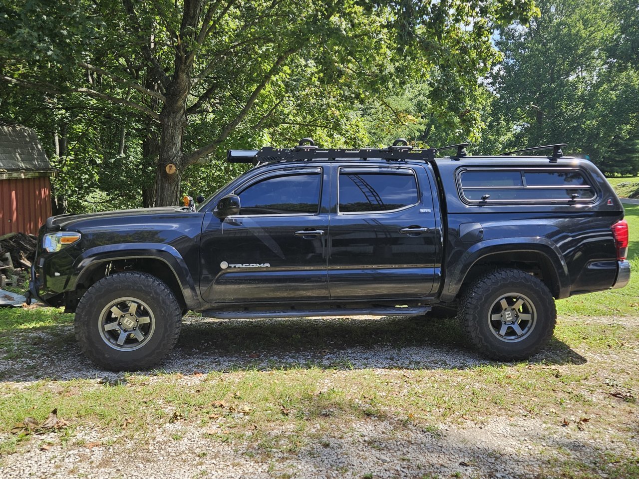

    How you fellas liking your Radflo 2.5s? Looking to change out my ICONs since I've added a SP X1 and the ride sucks and looking at the Radflo v Fox. Went down to Radflo yesterday and did a tour, cool people and great setup. TIA

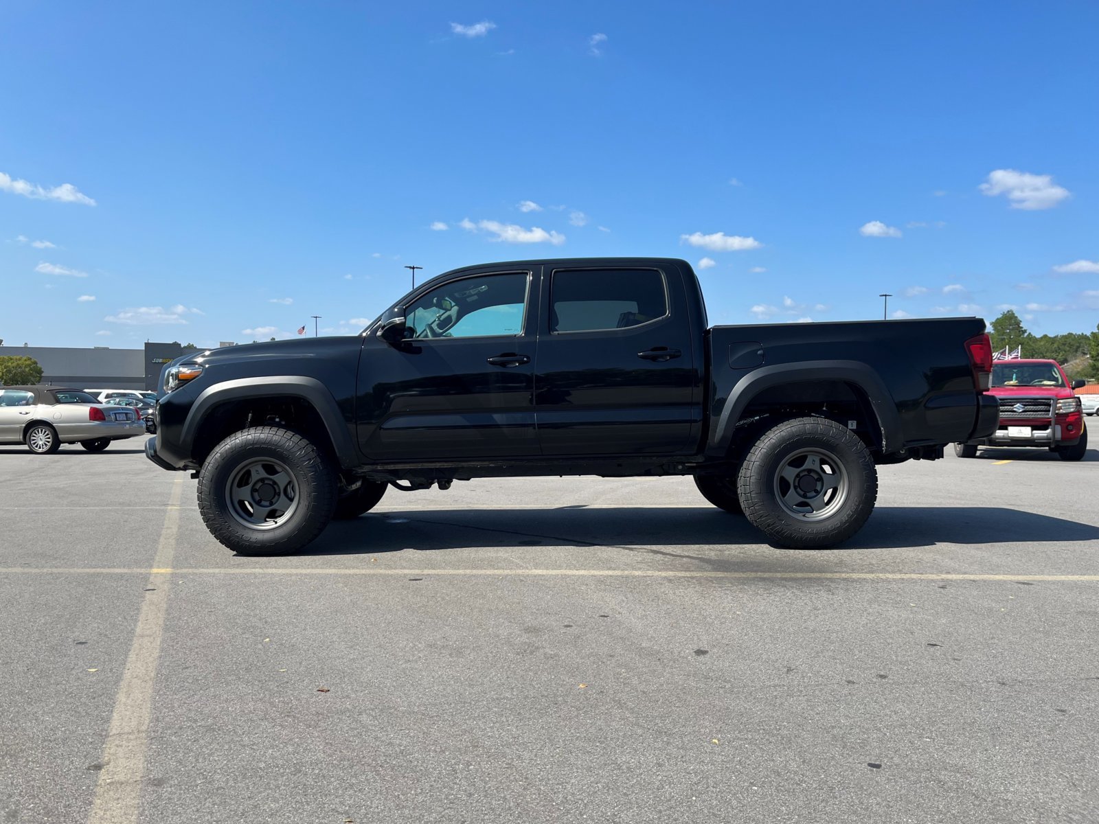

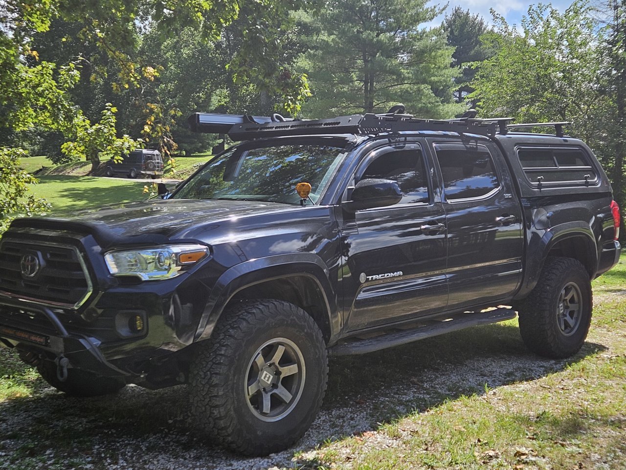

    Got them on today. Even with the bumper, winch and steel skid, with the 700 lb coil and no preload I'm at about 2.25". I'll drive it for a week or 2 then make some adjustments.

    Tires are 285/75/16

    whats 2.25" referenced from? truck looks stock height to me.

    Center of hub to top of wheel well. It's a SR5 4x4. It has a stock look but those are 285/75/16 tires so it gives that illusion

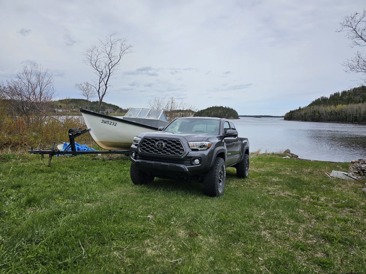

    my personal truck with 285/75r16 with no lift. looks like exact same height.

    What are your measurements center hub to bottom fender?

    Front- 21"
    Rear- 22"

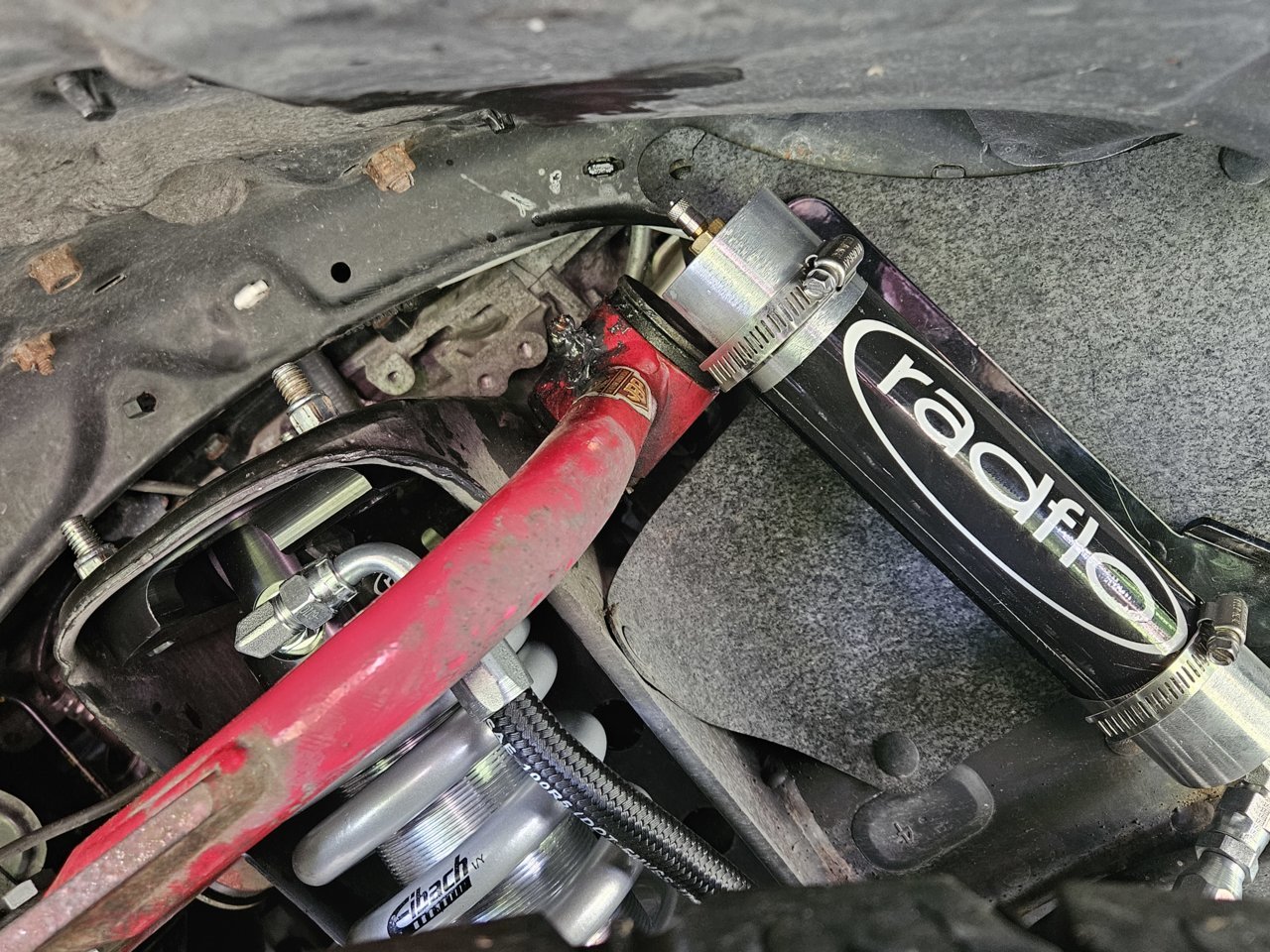

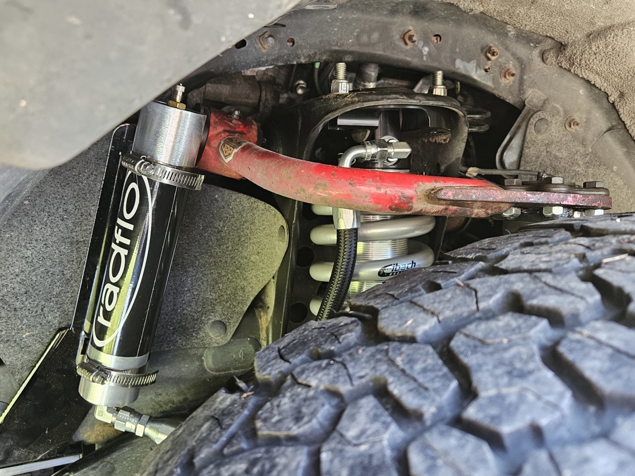

    Alright so, I have a 23' TRD OR. I also have Radflo's w/remote resi's all around. My front center hub stock was 21", after install I am at 21.75". I read you have an SR5 so just throwing my info and numbers out there to see if it helps. Everywhere I have read on here says to not go higher than 23" center hub to bottom fender as your CV boots will wear. I will be bumping mine up 1" as I AAL so the rear is sky high right now. Hope this helps!

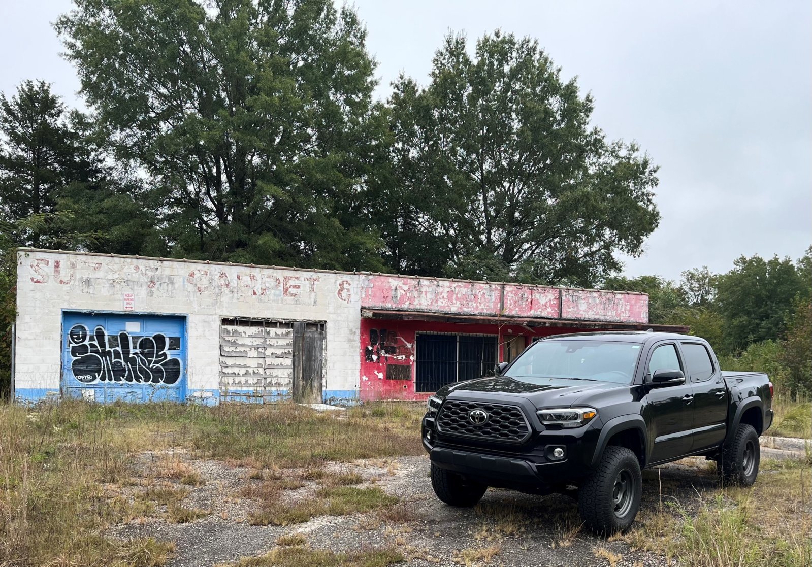

    Keeping this thread going. Lifted the front up a little more. Wheels are SCS F5's 16X8 +0 offset, tires are Open Country AT3's 265/75r16. Wish I went 255/85 but can always swap when these need to be replaced. Absolutely love the Radflo's.

    I know this is a bit old but did you go with these? I just got the same camper and am looking to sort out suspension
