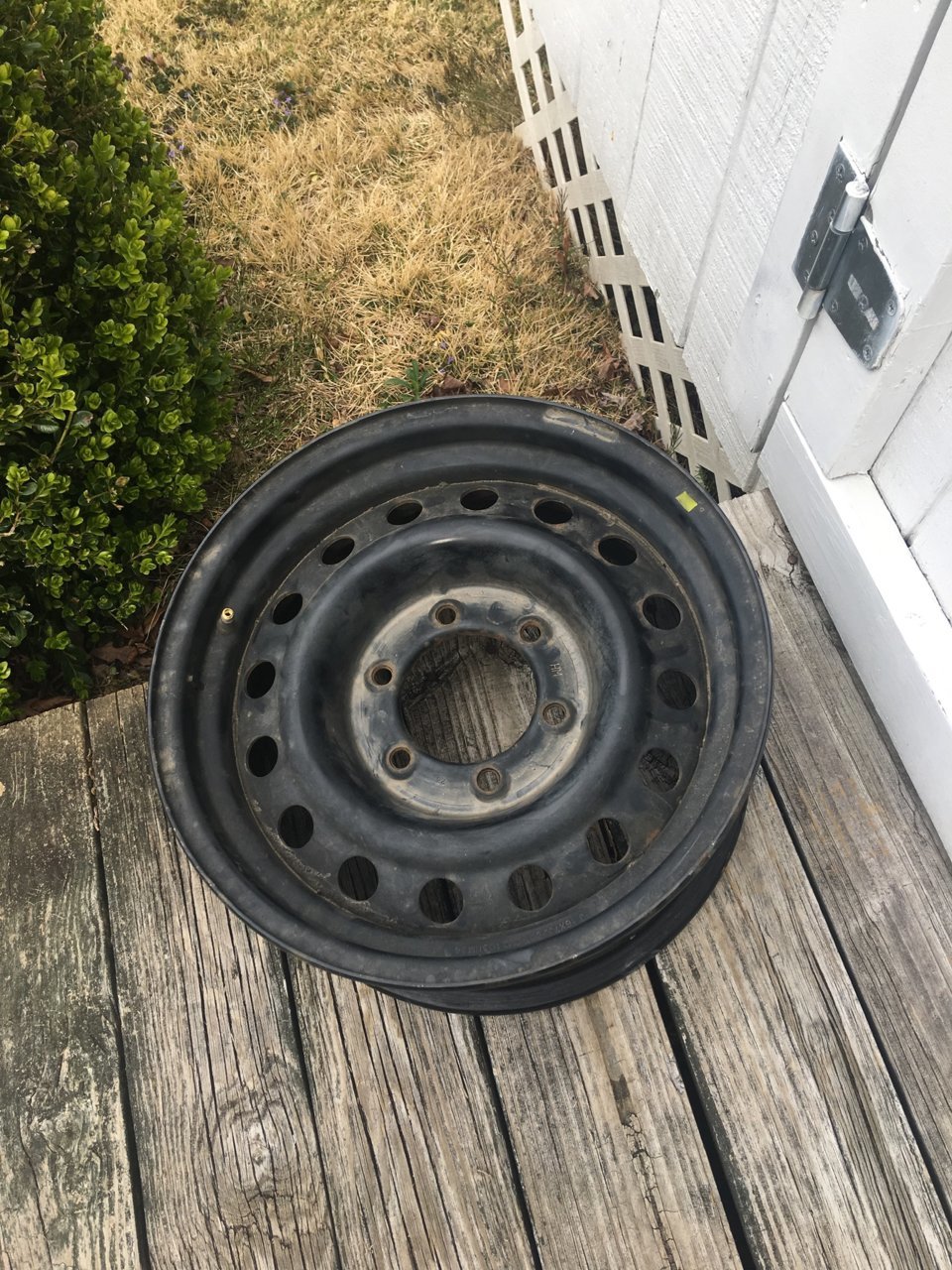

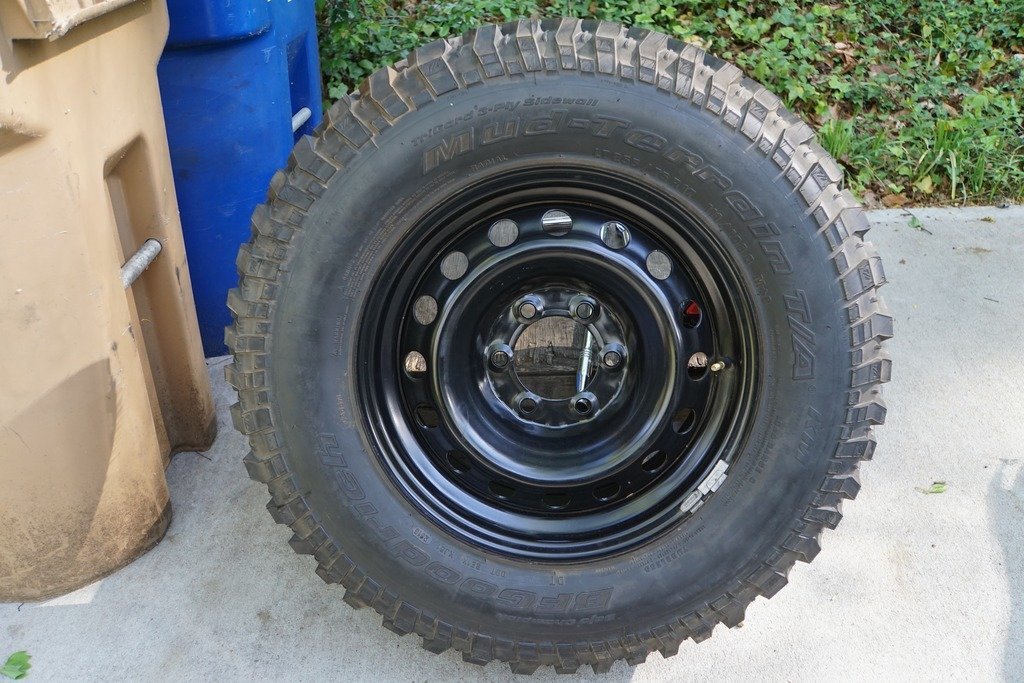

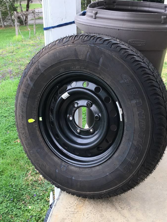

    Ok, here is the 411,
    All 1st Gen steelies (spare style and silver designed) either from a 1st Gen Tundra or Tacoma will NOT have an oval hole near the valve stem. They all should be 16x7 and have a tad more offset than a 2nd/3rd Gen steelie.
    If you have a newer Taco the older Gen wheels will sit out about 3/4 of an inch more than your stuck wheels. Now many many folks have reported ZERO rubbing issues with 1st Gen wheels on 2nd Gen trucks. I have 265/75/R16s on 1st Gen Tundra wheels and have ZERO rubbing and like the slightly wider stance.
    I am slowly gathering a set of steelies and have a few of each Generation, lol...
    I am not sure the pictures will help but you might be able to tell the difference in stance.
    First pic is a 1st Gen steelie, 16” also the FJ will not have an oval hole and is a 17x7.5” with the slightly wider offset, I believe they sit just a tad more out then my 1st Gen wheels do. It gets really interesting when you find out there are 5th Gen 4runner spares that are 17x7 but I can’t confirm the offset though. They don’t show up that much.
    1st Gen 16x7 steelie
    2nd Gen 16x7 steelie, (Note oval hole near valve stem)
    FJ steelie, 17x7.5 all round holes.
