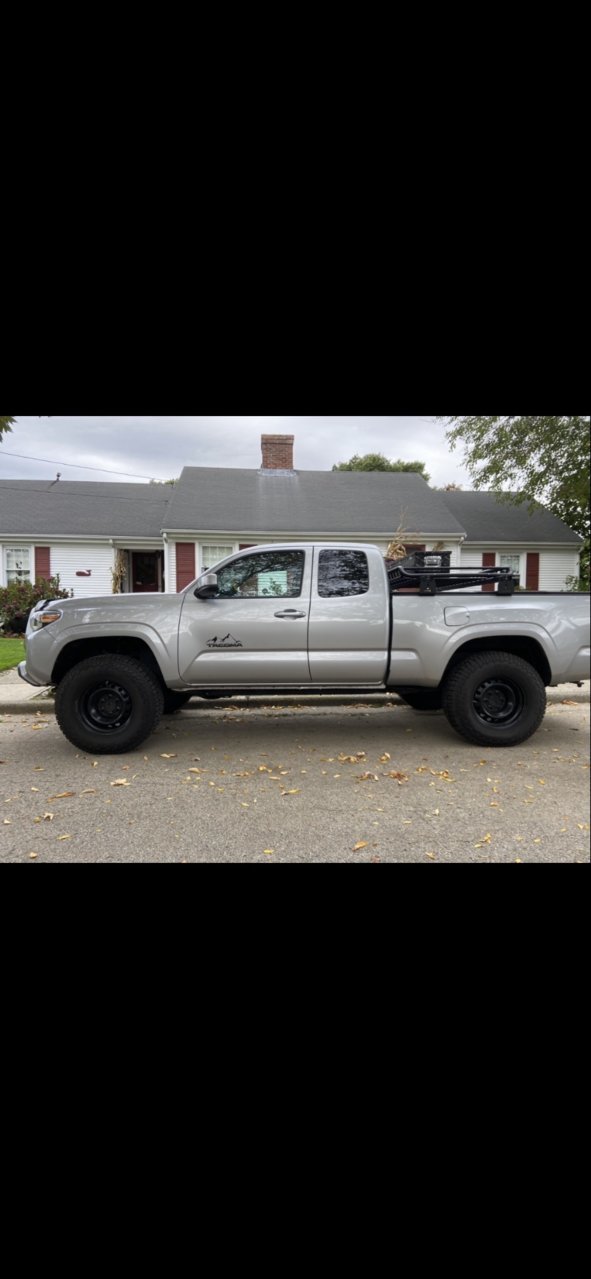

    finally got new shoes for it. 265/75/16 KO2's with toyota OEM steel rims. stock suspension and lift. base V6 4x4 SR model. also just mounted the CBI rack. still waiting on locking black lugs

    looks great. Simple and clean. Where did you buy your OEM steelies? any issue with caliper clearance?

    thanks, zero issues. it's the OEM spare wheel from toyota $144 each. exactly the same as the spare, so perfect fit.

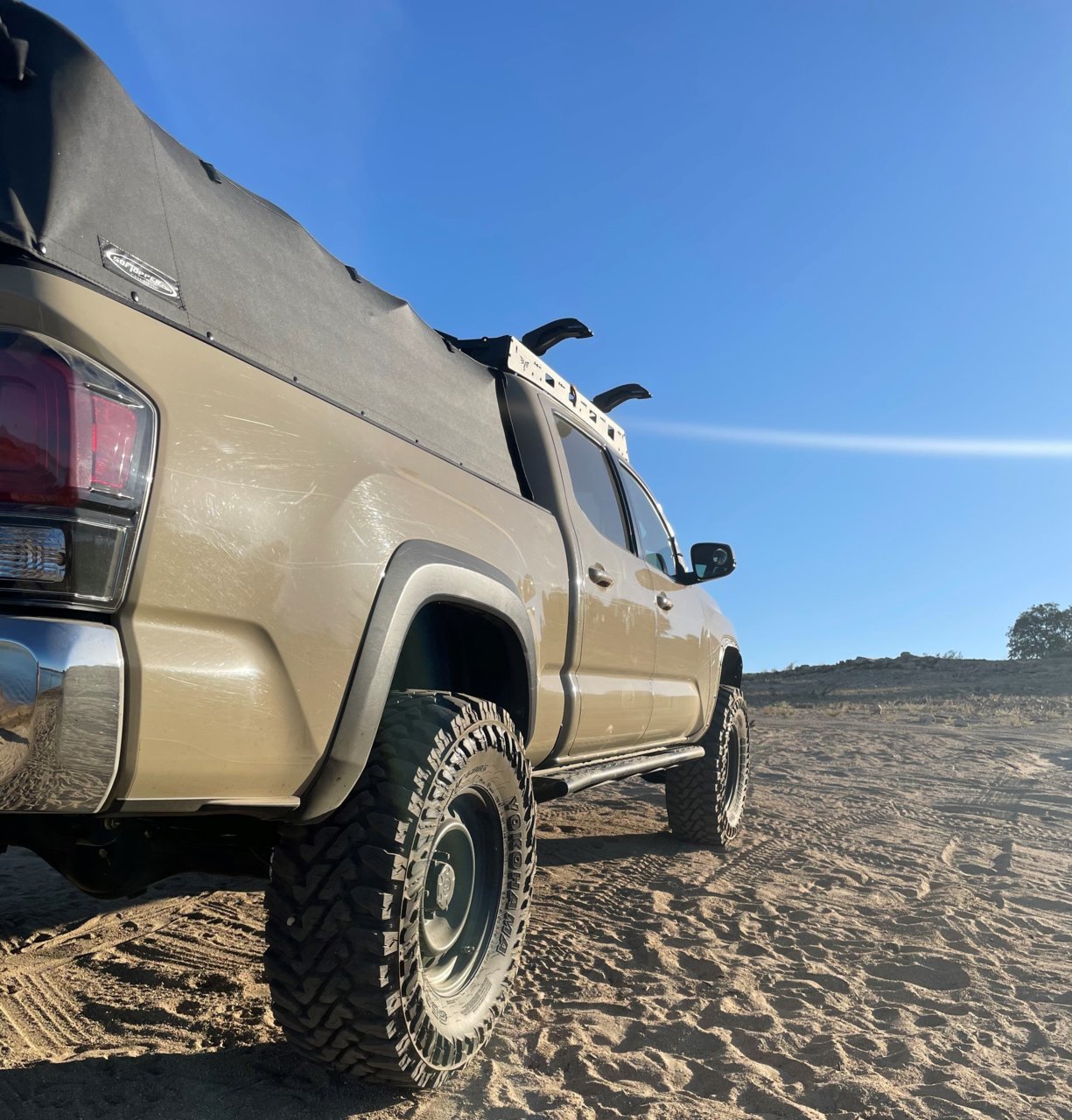

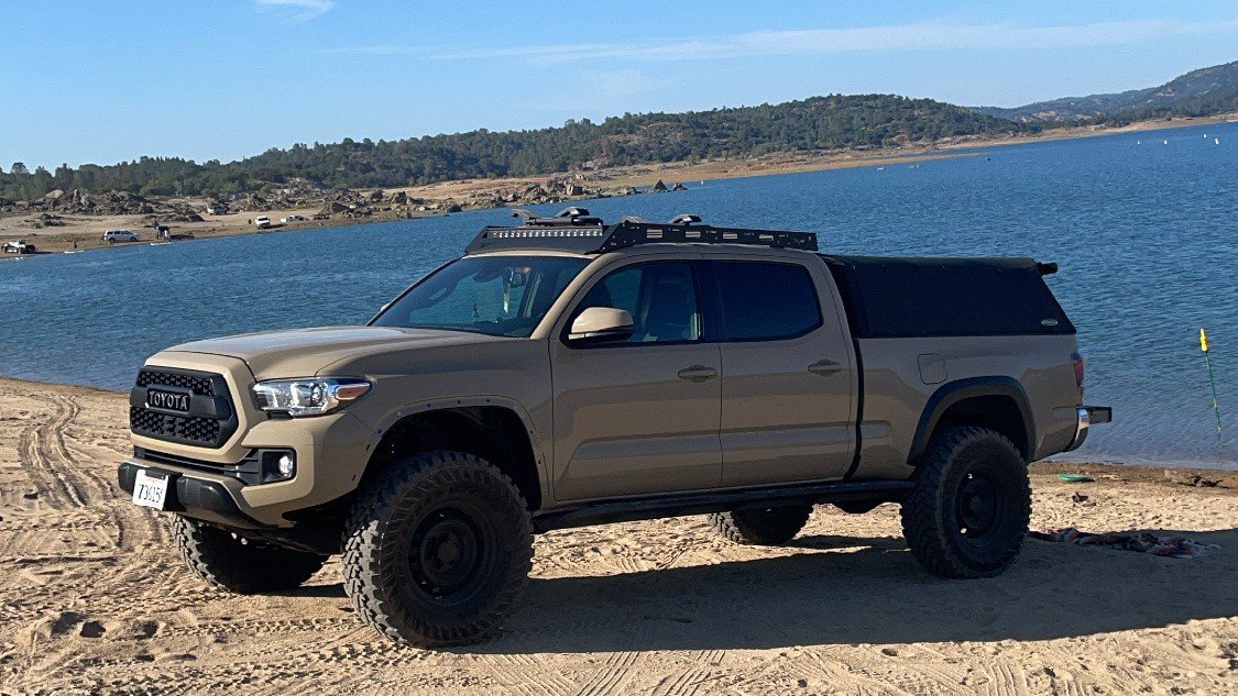

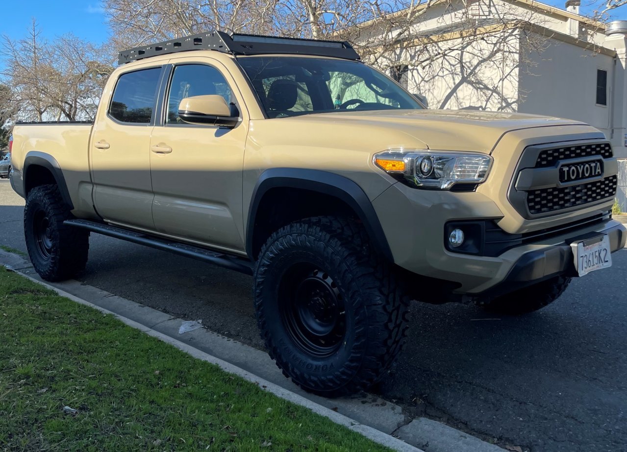

    -Dobinson’s IMS shocks on C59-354 coils -Dobinson’s rear shocks -Dobinson’s L59-111-R heavy leafs -Wheeler’ off road super bumpstops -Wheeler’s off road U-bolt flip -JBA Upper control arms. -35x12.5r17 Yoko Geo MT’s -17x7.5 4Runner spare steel wheels (Part #42611-35430) -Trailgear 1.5 spacers -C4 fabrication rock sliders -Relentless Fabrication High Clearance Rear Bumper, no swingout. -CBI T3 front plate bumper, no hoop/bullbar. -Ironman 4x4 12,000lb synthetic winch -Victory 4x4 roof rack -China camper from Alibaba -CVC tuned -ExtremeLED lightbars in the roof rack and front bumper. -Baja Squadron's in the rear bumper -MESO customs stuff everywhere -Dobinson’s Zenith air compressor mounted under the hood -Homemade S-pod relay box -Entire sound system replaced and sound deadening added
    Sorry I haven't been frequenting the forums much these days and I don't really have that many good pics yet. But here's a couple
    And yes I ended up going with 4runner spares. The center caps I believe I went with t-100 caps off ebay because they looked identical and were significantly cheaper. I sanded, primered, and painted the wheels and caps all with rustoleum pro semi-gloss spray paint for easy touch ups if needed.
    https://www.lowes.com/pd/Rust-Oleum...5Y-Cqm4PKxsqVFFmKIxoCvygQAvD_BwE&gclsrc=aw.ds

    Looks good. Really good

    Thanks! Wish I would have went with 16’s now instead of 17’s but overall I’m happy

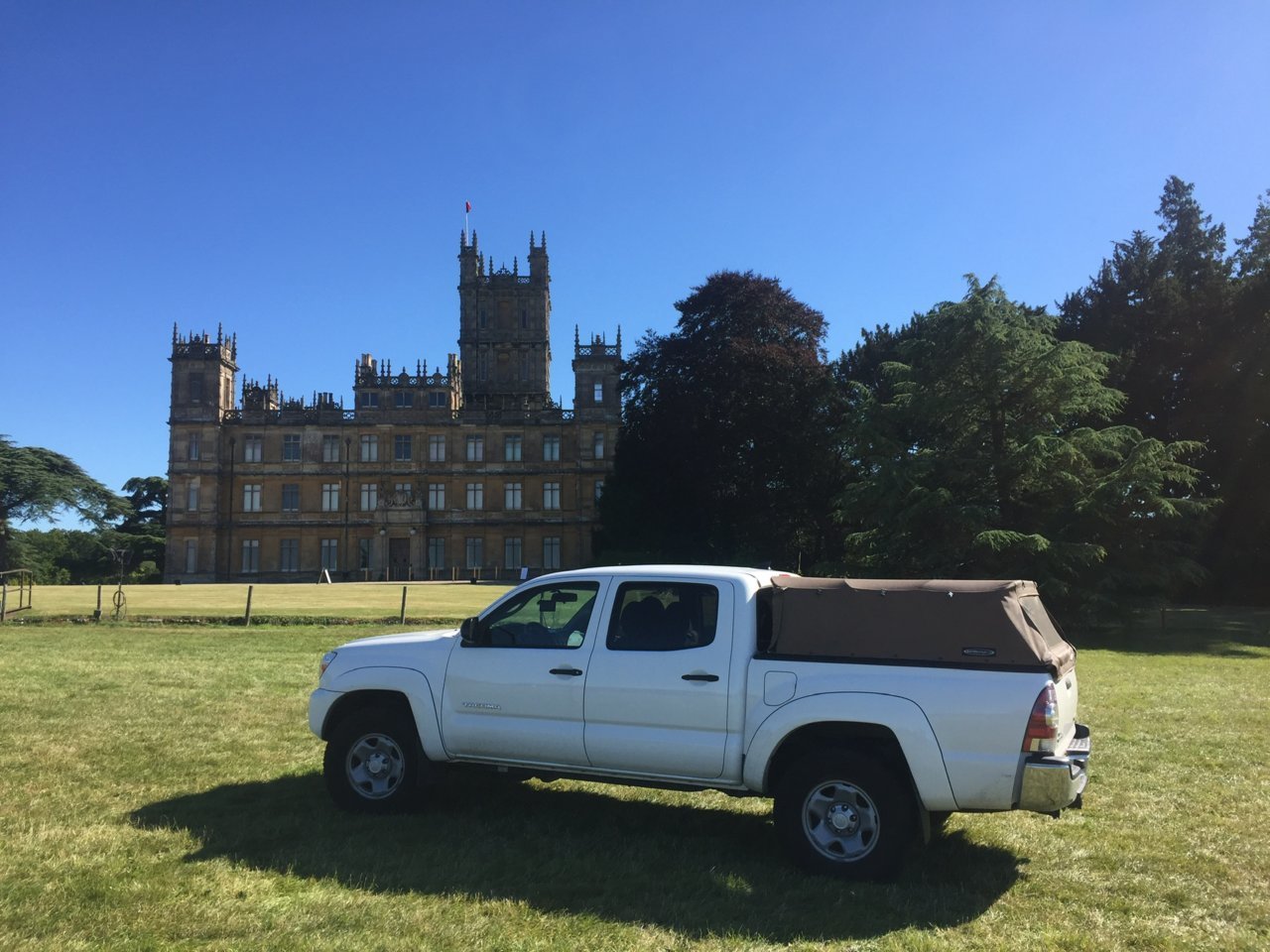

    3322D526-AEC4-4F32-AE18-466B73BC27E9.jpg Steel wheels parked on the lawn of Downton Abbey

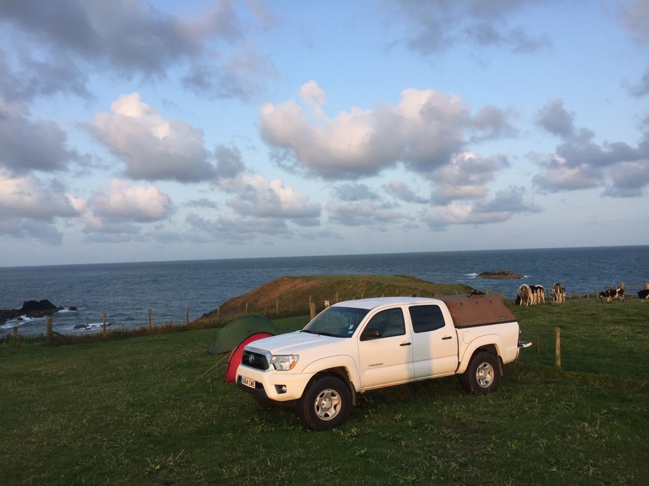

    EDA16006-142D-4176-AEE9-FFFA3FA0BCA8.jpg Steel wheels on the coast of north Wales
