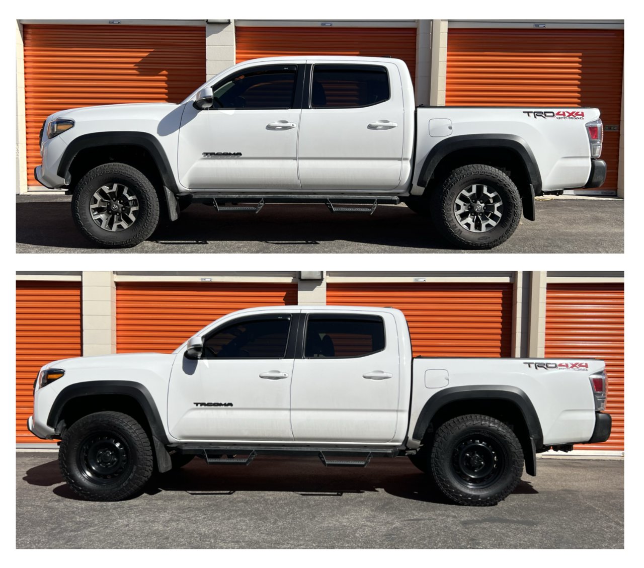

    FJ steelies came in the mail today. I've got a question for those of you that have had them on for a while, any paint issues or rust? The steel wheels I've seen on other vehicles are always rusted out and look like crap, I'd like to avoid that.
    Any extra protection anyone has added to them before having them mounted?

    That’s one of the nice things about steel wheels. They are easy to repaint. If your 17’s are anything like my 16’s I wouldn’t worry about the finish. Mine had a pretty heavy coating that I had to scuff good before applying the 1H5 base coat. So I guess my wheels have 3 layers because I finished with satin clear coat. :) I guess you could do the same, a clear coat if you think it would help.

    Those look slick. I’m gonna go the same path. What rubber ya wrapping those in?

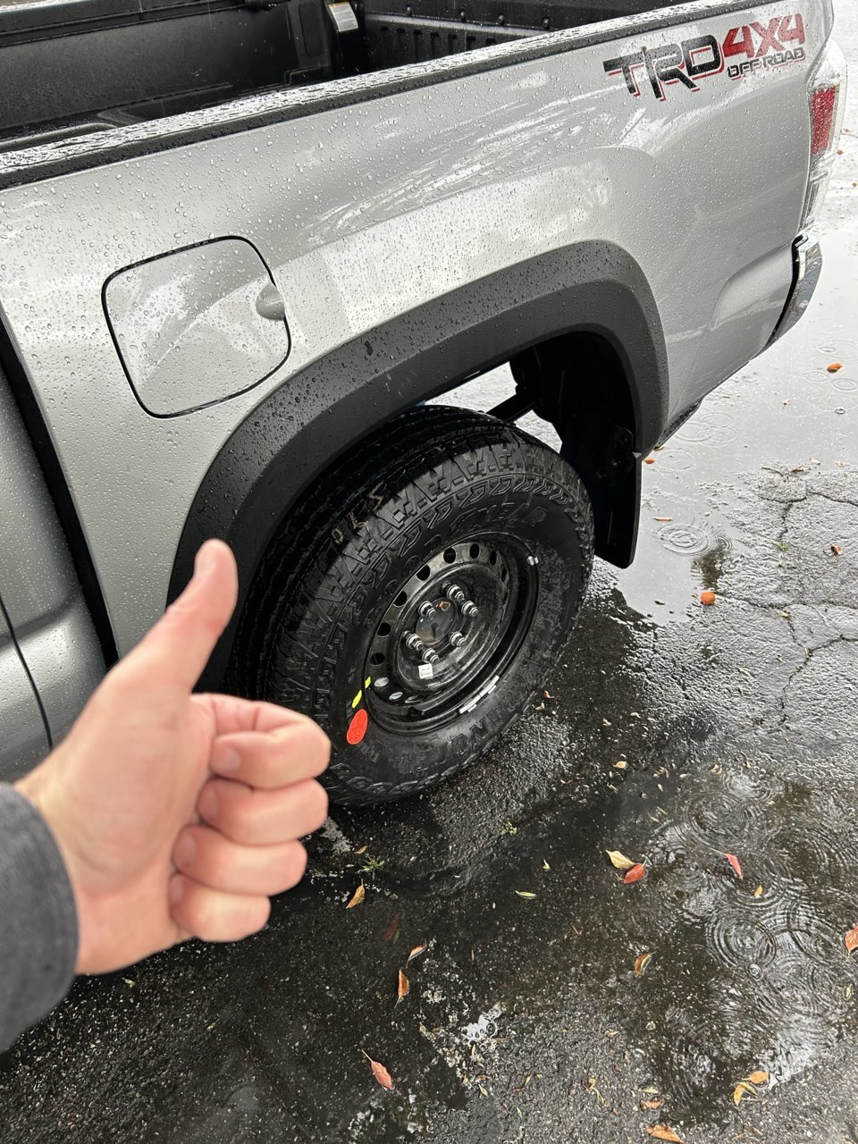

    BTW As people have stated, spare steel wheel/tire is deemed 'for temporary use only' because lug nuts made for alloy wheels must be swapped out for conical or 'acorn' style lug nuts. The lug nuts made for Tacoma alloys have a flat seat and are not meant for the steel wheels lug surface. I just remembered this looking at this photo.

    Right on. Thanks for the info. That was just to get to the tire shop, had to buy a new one, that sucked. Thanks though for the lug nut info though. I didn’t know that but I’ll buy correct lug nuts when I officially cross over to the steel side.

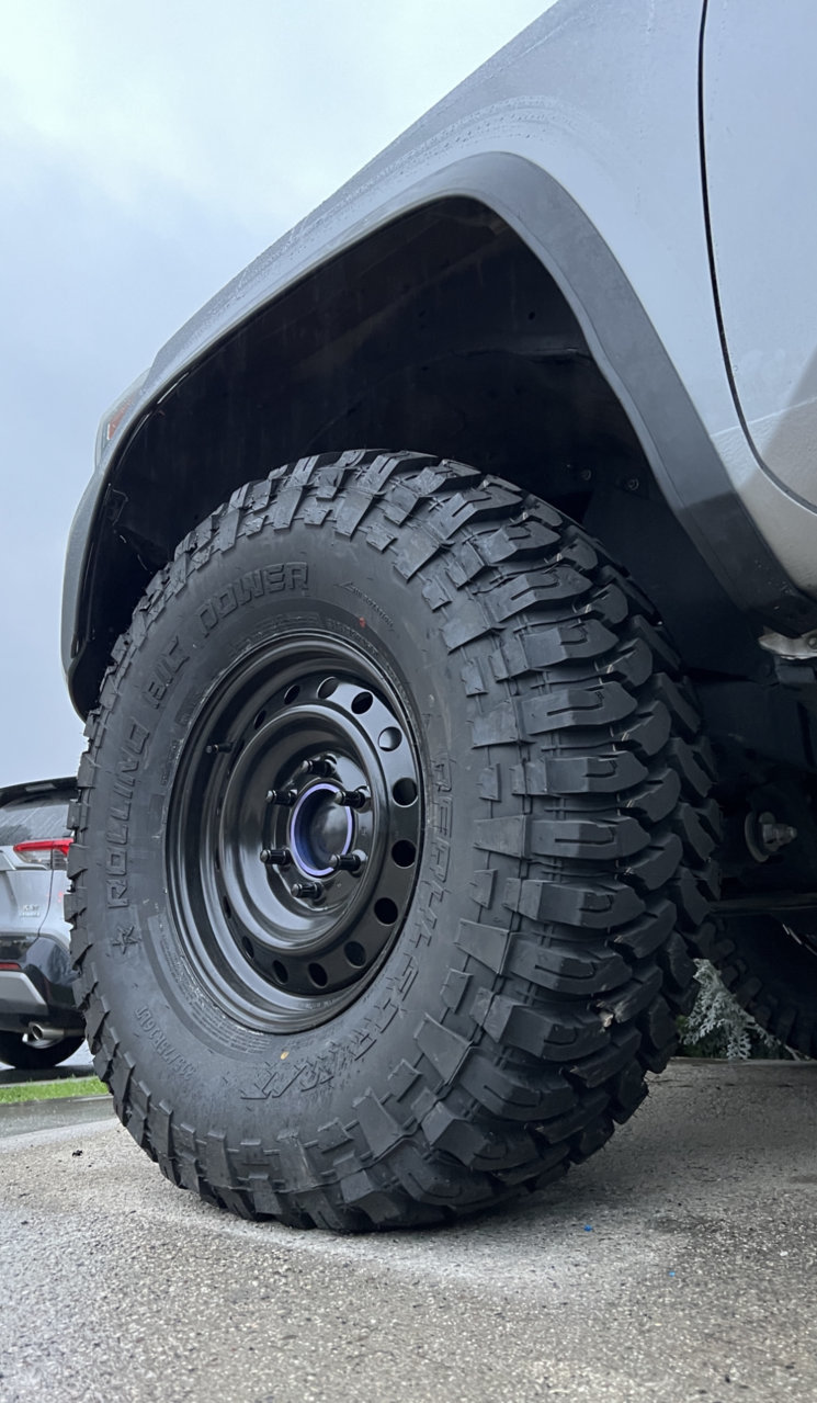

    Those are awesome, great angle! Appreciate the pics.

    the factory lugnuts ARE conical at the face and specifically designed to seat against the spare steel wheel with the same 60 degree profile as an “acorn” steel wheel lugnut.

    DAMN that looks good.

    I’ve always been a HUGE fan of M/Ts on steelies. Not very practical at 7” wide but I’ve made worse decisions in my life :kona:

    Tacos with OEM alloy aka 'mag' wheels used an entirely different type of lug nut that are not design to work with Toyota (or any I'm aware of) OEM steel wheels. Yes they will work in an emergency. You can see in the picture @TuesdayTaco76 posted the lug nuts are not down on the 'flats' of the nut.

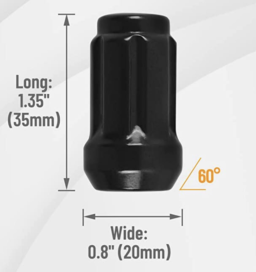

    The factory lugnuts (which I’m not running) have a flat “mag style seat with a washer, AND a 60 degree tapered end to use for your spare -Toyota is NOT going to provide an improper fitting lugnut on 235k trucks a year.
    I did however buy the proper 60 degree lugnuts to run the OEM spare wheel
