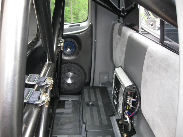

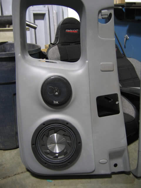

    Modified the stock rear door trim panels to hold the sub panels:

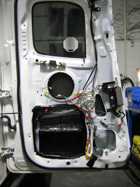

    Modified the door so the enclosure could slide in and lined it with some sound deadening material:
    Unfortunately my rollcage interfered with the panels and I couldn't close the doors. I took a jigsaw and free-hand cut the raised areas of the panels, flipped them over so the speakers would be recessed instead of raised, re-glassed them, sanded, painted them black to match the cage, and stuck 'em back in.
    They sound sweet and hit hard.
