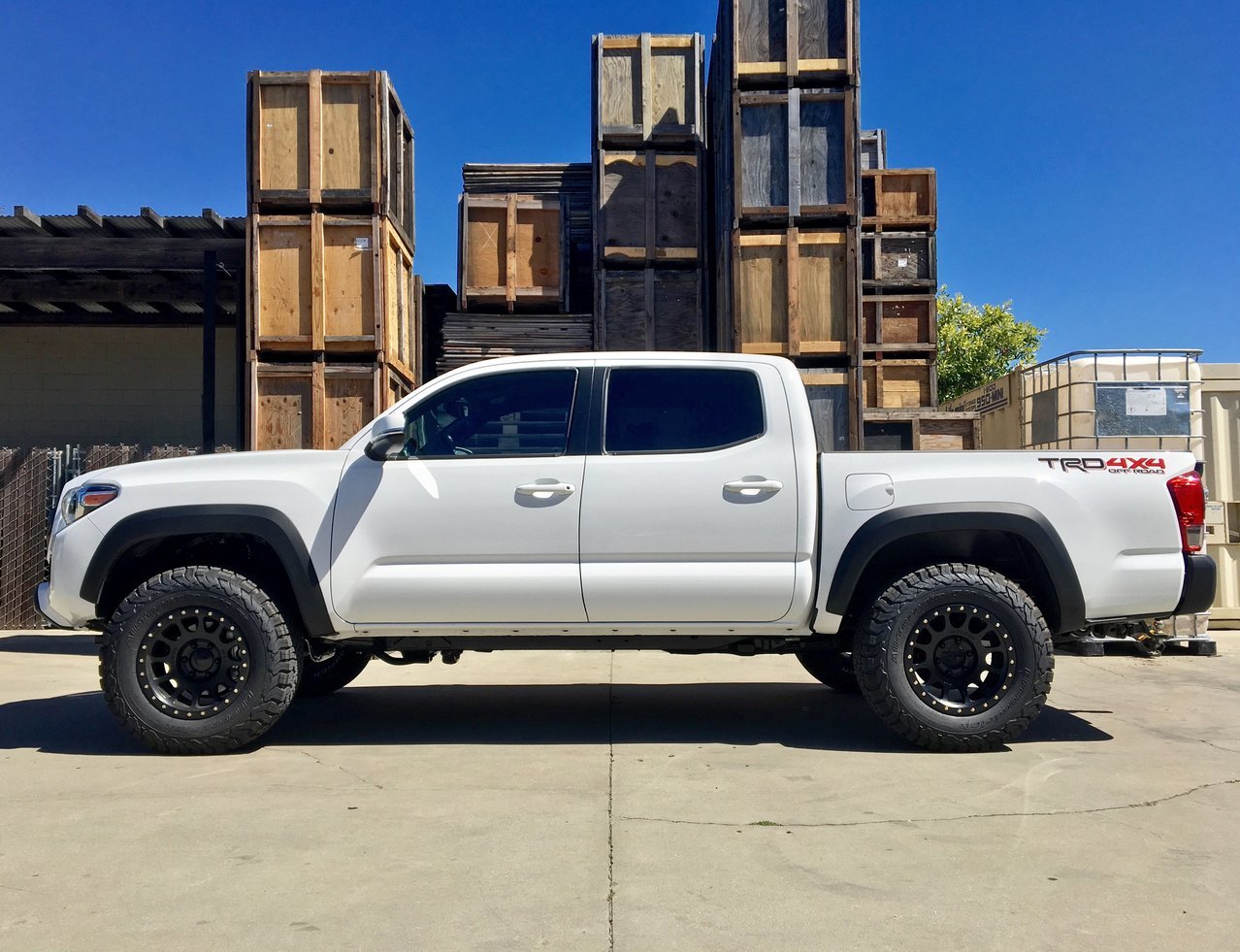

    Looks great. What are your 5100's set at?

    I PM'd you back but for others that are curious they are set on the 3rd ring which I believe is 1.1" lift on the newest 5100s

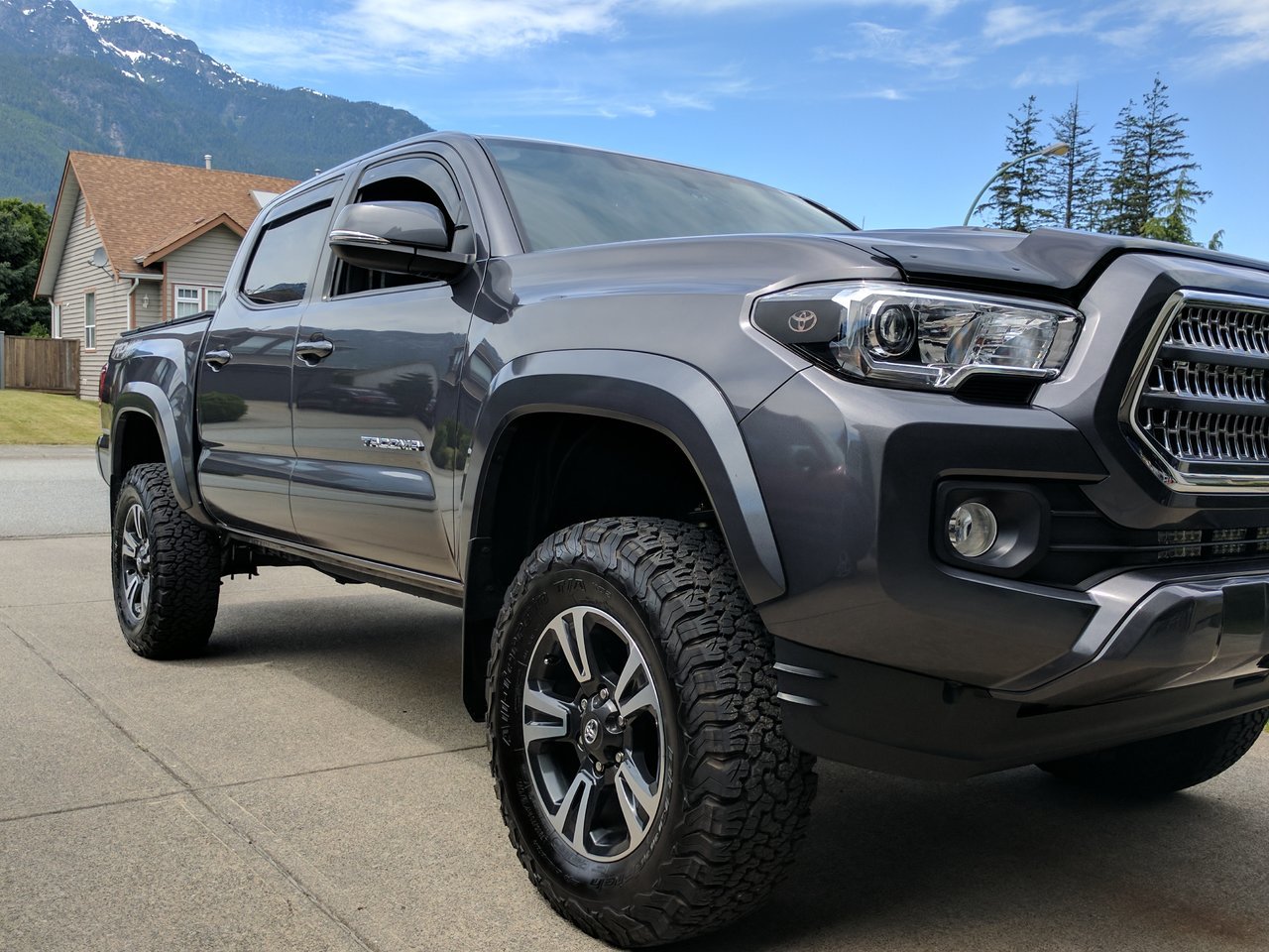

    Yes, 265/70r17 bfg ko2. Can run stock. I am now lifted with ucas and spidertrax 1.25 spacers. Will go to 285/70r17 soon

    Your truck looks great!!!!
    What lift did you go with? What settings did you do on the front coilovers?
    Were the spacers needed for rubbing on the control arm or just to get a wider looking stance?

    Went with 3/1 low range level kit and bilstein 5100's set at 0. Put spacers on for stance. They are needed if going to a 285 tire to clear uca's. I also needed new uca's because my stock ones would contact coils during full droop. New uca's were also needed for a good alignment

    Why would you use spacers if you bought 5100's?
  8. Jun 28, 2017 at 6:49 AM
    #428
    SR5 BRI
    SR5 BRI Brian Good Sport
    Dec 29, 2015
    #173454
    1,435
    Brian
    Albany n.y.
    2023 Sport Quadcab
    Alot
    That didn't t make any sense to me either

    Didnt want a stiffer ride. More like stock now. Eventually I will buy new king coil overs. Tried the bilsteins only for lift and they made the truck way to stiff in the front.

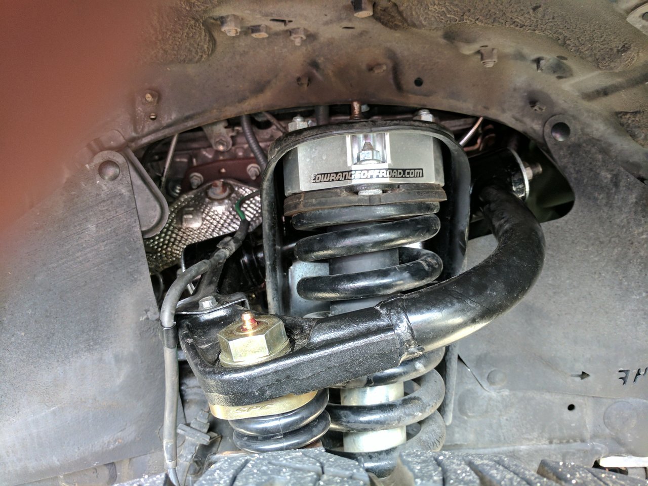

    awesome doing exact setup Saturday, how you liking the kit so far any vibrations ?

    Had to replace ECGS needle bearing. The kit is good however, dont expect to drop both wheels without the uca's hitting the coils. You will need at least SPC light racing uca's. The combination I went with didnt bust the bank for what I want to do. One day I will get the Kings and TC uca's but not til this setup is worn out. No vibrations other than the stock crappy needle bearing. This kit imo with stock shocks is too soft. Billies on 0 setting is just right. Smoother and a little bit firmer of a ride than stock but not harsh either like when using the bilsteins only to create 3inchs of lift. It is good for what it is cost wise. The kit has very nice machined parts and includes tapered rear blocks, bump stop spacer, diff drop and skid plate spacer. I would also get yourself in addition to this kit a sway bar relocation kit and OME carrier bearing drop kit.

    thank you sir , I guess needle bearing went immediately after lift was installed? or was it some time thereafter

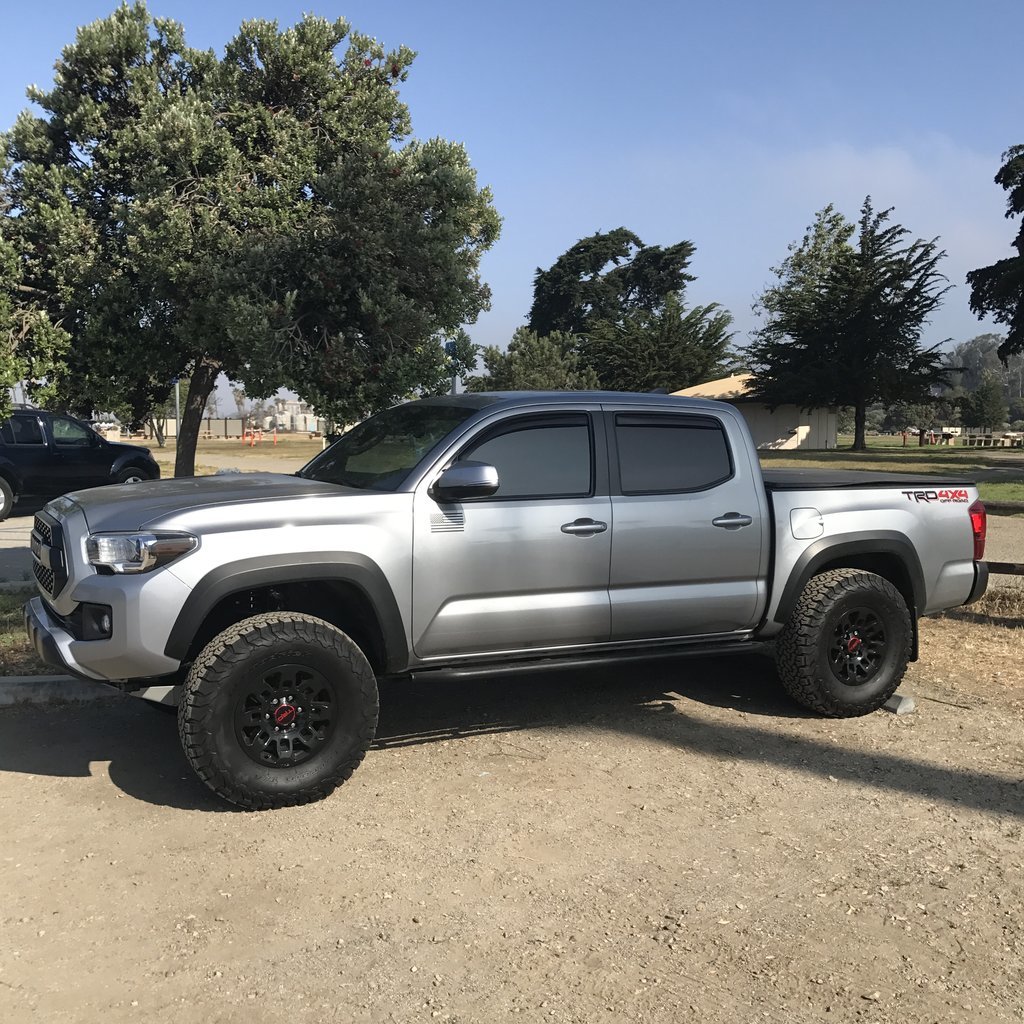

    IMG_2856.jpg TRD pro 16x7 wheels with BFG KO2's 285 75 16 with Bilstein 6112's and 5160's.

    Right away classic vibrations. Put in 4WD vibration gone.

    Looks good. How Do you like the 6112s so far?

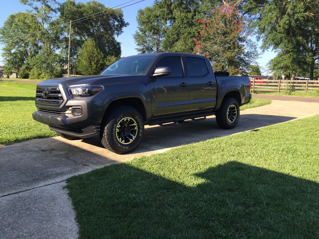

    Replaced the 245s/steelies with 265 75 16 Cooper AT on ultra mavericks 16x8 +10 on stock suspension .IMG_0579.jpg IMG_0043.jpg
