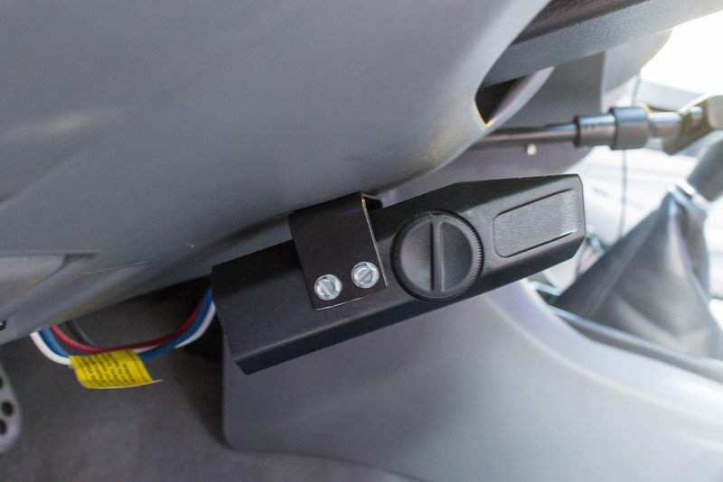

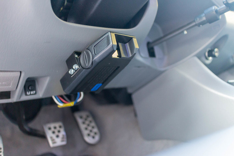

    you ordered the tekonsha toyota harness? that makes it easy.
    I cut the bracket down on mine so it would sit closer to the mounting surface.

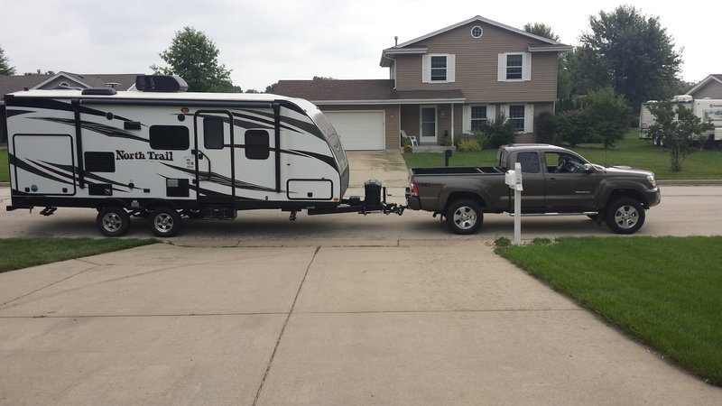

    That's a really nice TT, what size? dry weight? and max weight?

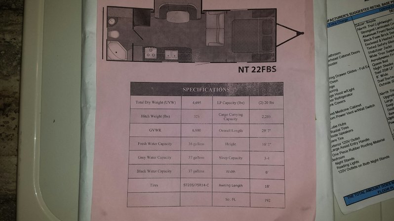

    It's 29 ft overall, dry weight is 4700 and max is 6500, hitch weight is 375

    that hitch weight seems wrong. it should be 10-15% of the trailer weight... at least 650 lbs if the trailer is loaded to the max, with about 1800 lbs of payload including water above its 'curb weight'.
    I'd try and stay on the light side of that trailers load rating when you're towing it with a tacoma, 6500 is the max tow with the factroy tow kit, and 650 lbs of tongue weight leaves you like 550 lbs of driver/passengers + gear. more hitch weight leaves even less.
    a weight distributing hitch will likely make that tacoma+trailer ride /way/ better....
    otoh, i see you're in florida. thats the land of flatness, I guess, so maybe its not a big deal.

    I was wrong on the hitch weight it's 325 and max is 69.

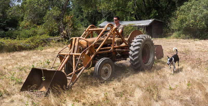

    wow, that tractor is 30 years old?
    I dont even wanna think how old my 1947 8N is, but its older than I am, hah!

    I guess it's actually closer to 35-40 years old. That's a great rig you've got. I've been wanting to get into vintage tractors for a while, so this is just my first small stepping stone, to ease into it before I go for something bigger and older.

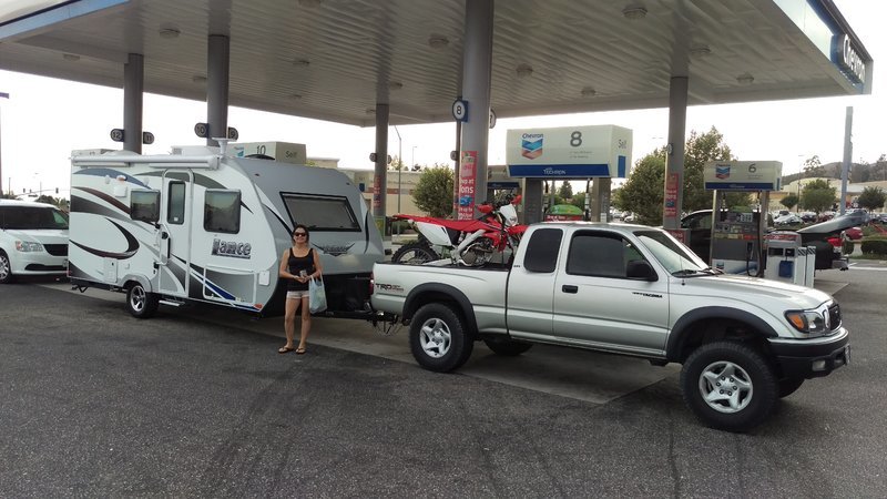

    That must tow better with the Taco...
