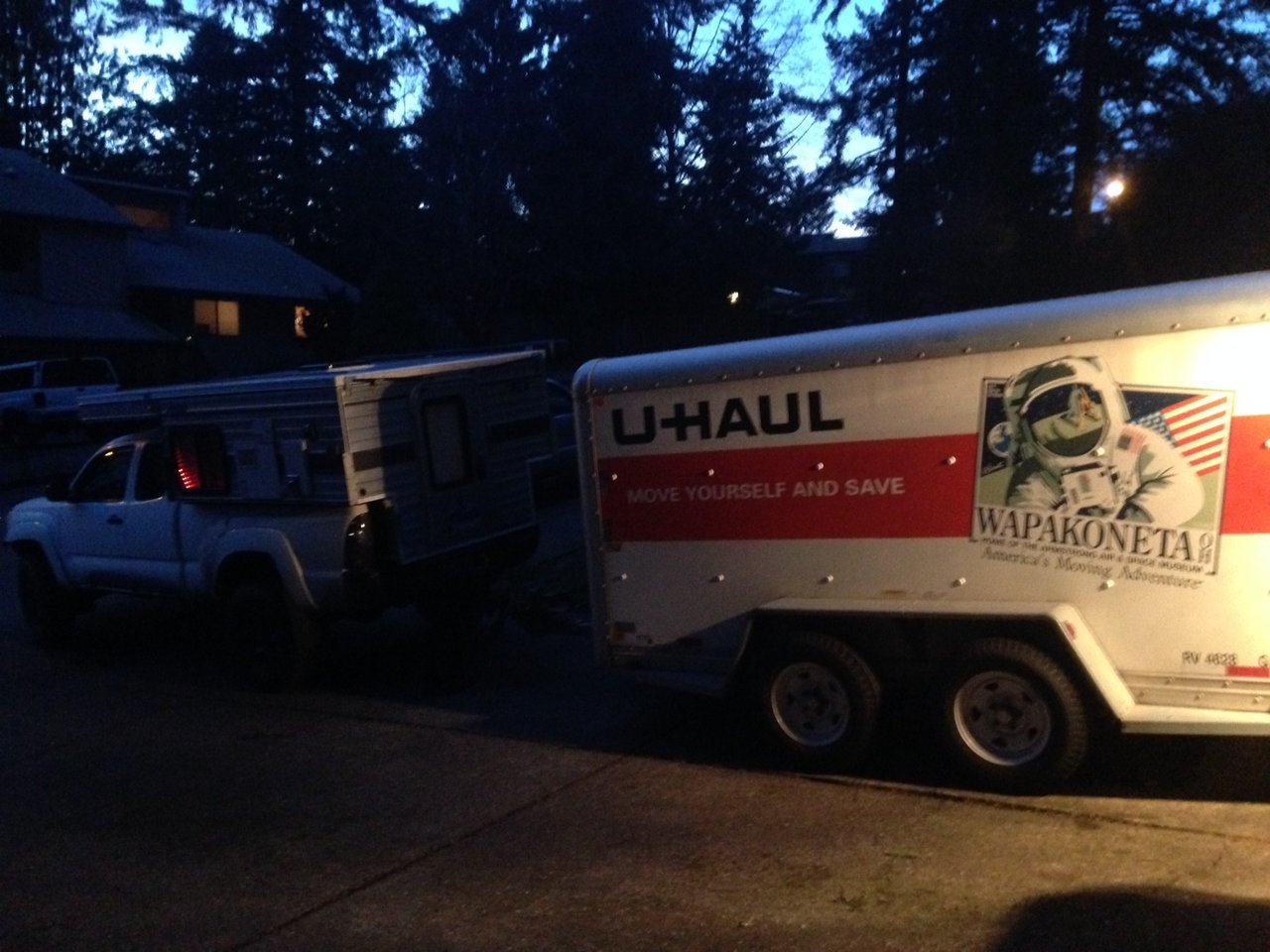

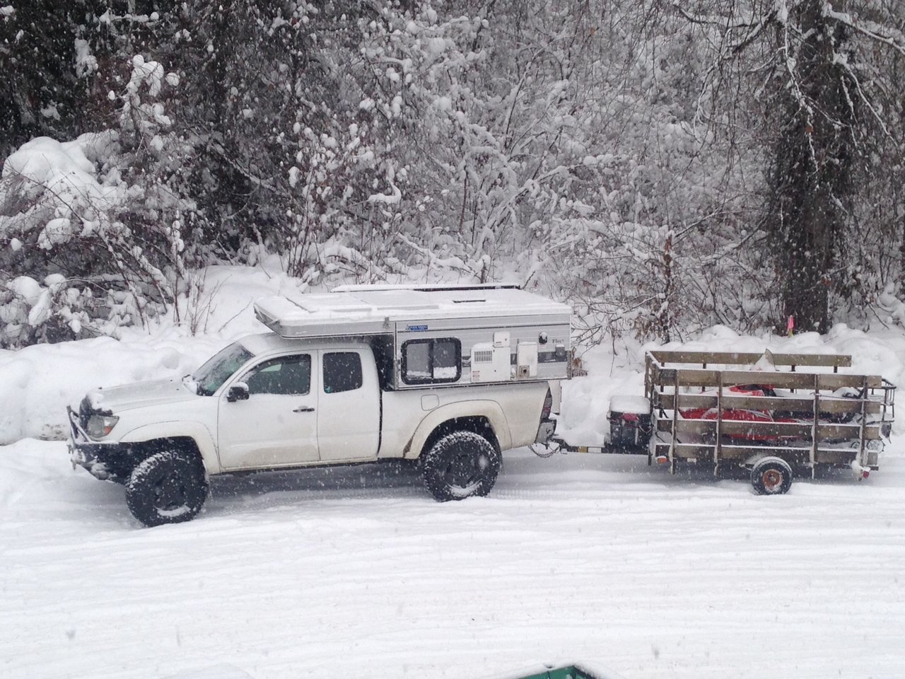

    Black this black that , 315-75r16 pro-comp A/T's , 285-75-r-16 treadwright gaurd dogs full OME lift with Dakar leaf spring pack, boss airbags, 4.88 nitro gears, dakota digital speedometer calibrator, tjm air locker, arb onboard air, spider tracks 1.25" wheel spacer, sport headlights, brute force fab hybrid front bumper, 6000k 4" led fog lights, 24" double row led reverse light, storm trooper shift knob, rebadged badg-less black mesh grill, Kenwood double din stereo, 400w Rockford 12” sub . Anytime fog lights. Oh yeah almost forgot the 2016 FourWheel camper fleet model for extra traction and a place to crash if you do get stuck or broke down. 2x160watt solar, mppt charge controller by blue sky energy. 3 deep cycle batteries 20gallons water, 6gal hot water, 3.5cf 2way fridge/freezer, 6gallon propane... just getting warmed up.
    Loaded front to back and up to the roof. Made for a long drive from Portland Oregon to Wenatchee Washington with 40mph headwinds part of the way. Trailer scaled at just under 6k the camper weighs 1.5k86BAA584-05AE-452D-B83C-3867D404B649.jpgthis is a more normal and practical load...69469698-B18E-47A8-BFE2-944D4415EC8F.jpg

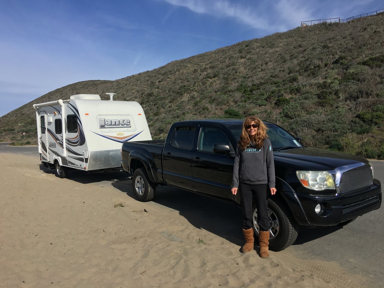

    Hey ( left coast nerd ) John
    Used to pull an 1800lbs tent trailer.
    Just went to a lance 1245 hybrid just under 2500lbs
    Pulled it home from Southern Cal over the grapevine with no wdh.
    Took it on maiden voyage over 17 to Sunset Beach. Did find a little bouncy on the back roads. I have airbags.
    The previous owner pulled it with a 2014 tacoma. He got talked into the wdh he used once. So I have it thinking about giving it a try. What do you think ?

    smallest lance I can find is the 1475 ? dry weight 2500 lbs, gross weight 3700 lbs ? is that the one ?
    anyways, sure, if you got it, give the WDH a try. if its the conventional spring-bar type, you'll need a couple BIG wrenches to adjust and tighten it (I used impact sockets and 1/2" drive breaker bars). if you have airbags, I suggest you load the truck, adjust the airbags back to the empty ride height, THEN hitch up, and adjust the WDH without touching the airbag pressure for the suggested percentage of sag per the WDH docs... Somewhere I read Toyota suggested going closer to 0% sag, instead of the 20-30% suggested by the WDH makers.
    IIRC, you do something like this...
    1. start on dead level ground. level the trailer with its tongue jack, measure the height of the trailer hitch.
    2. install the WDH on the truck so that with the truck loaded and preleveled via its airbags, the ball is at the same height as the trailer hitch...
    3. measure tongue height of truck without trailer, lets call that H1. lower trailer onto tongue, measure height without WDH, thats H2.
    4. Take (H1-H2) as the initial sag (S1), and take from 0% to 25% of that S1 as target sag S2, and subtract (H1-S2) to get target height H3.
    5. via trial and error, hook up the spring bars on the WDH, and measure the hitch height again, if its not the desired H3, release the spring bars, adjust the tension on your WDH and repeat this step.
    I believe when I setup my WDH, my S1 was about 3-4" and I aimed for an S2 of about 0.5-1".

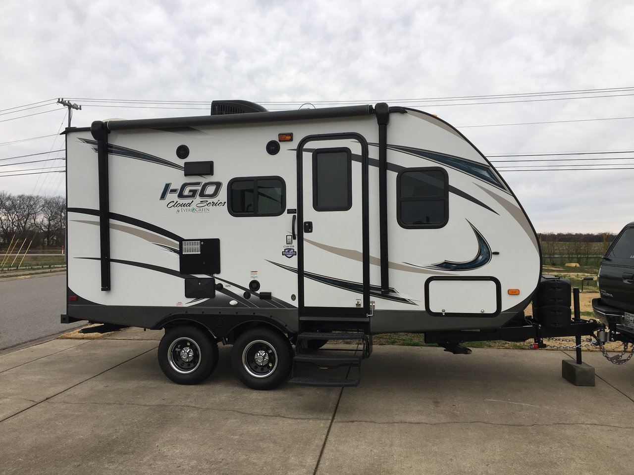

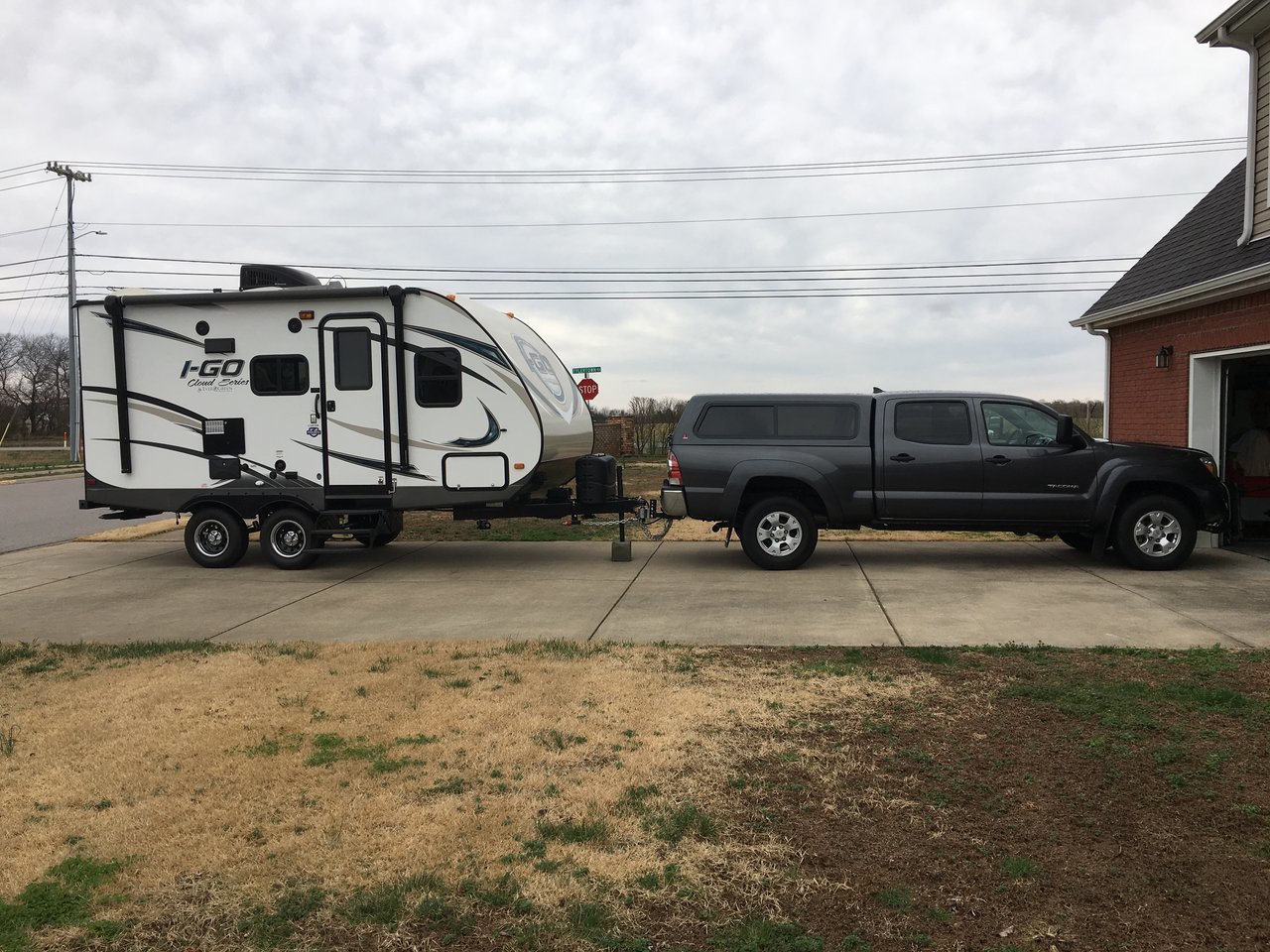

    IMG_0041.jpg IMG_0042.jpg Just picked this up this past week end. 3400 dry. 2016 Evergreen I-Go cloud 198FDS

    why oh why does everyone quote the EMPTY ('dry') weight of a trailer? whats the GROSS (max) weight? what you're going to be towing is going to be a lot closer to the max than the min, when you figure water, propane, food, clothes, bedding, and general 'stuff'...
    I do like your Anderson WDH on that one, if I'd gotten one of those, I might still use my WDH, but the spring bar variety I ended up with is just too much of a pain...
    and yikes, Evergreen apparently went out of business in 2016/// That seems to be a real common thing with the 'stick built' trailer industry. Thats yet another reason I went with a molded fiberglass trailer, the established makers of those (Scamp,Casita, Escape, Bigfoot, Oliver, others) have all been around 20-30 years or more, and show no signs of going away. Yeah, they are more expensive (but they last a lot longer), and they don't use dealers, so you have to buy direct from the maker, or second hand. They *all* use the same appliances, accessories, axles, and stuff.
