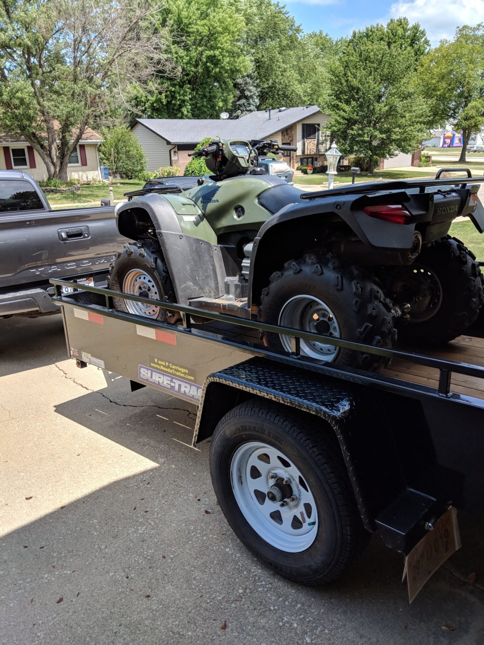

    Bought me a trailer and a ATV.

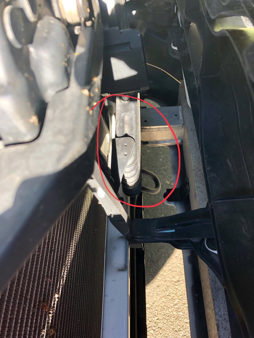

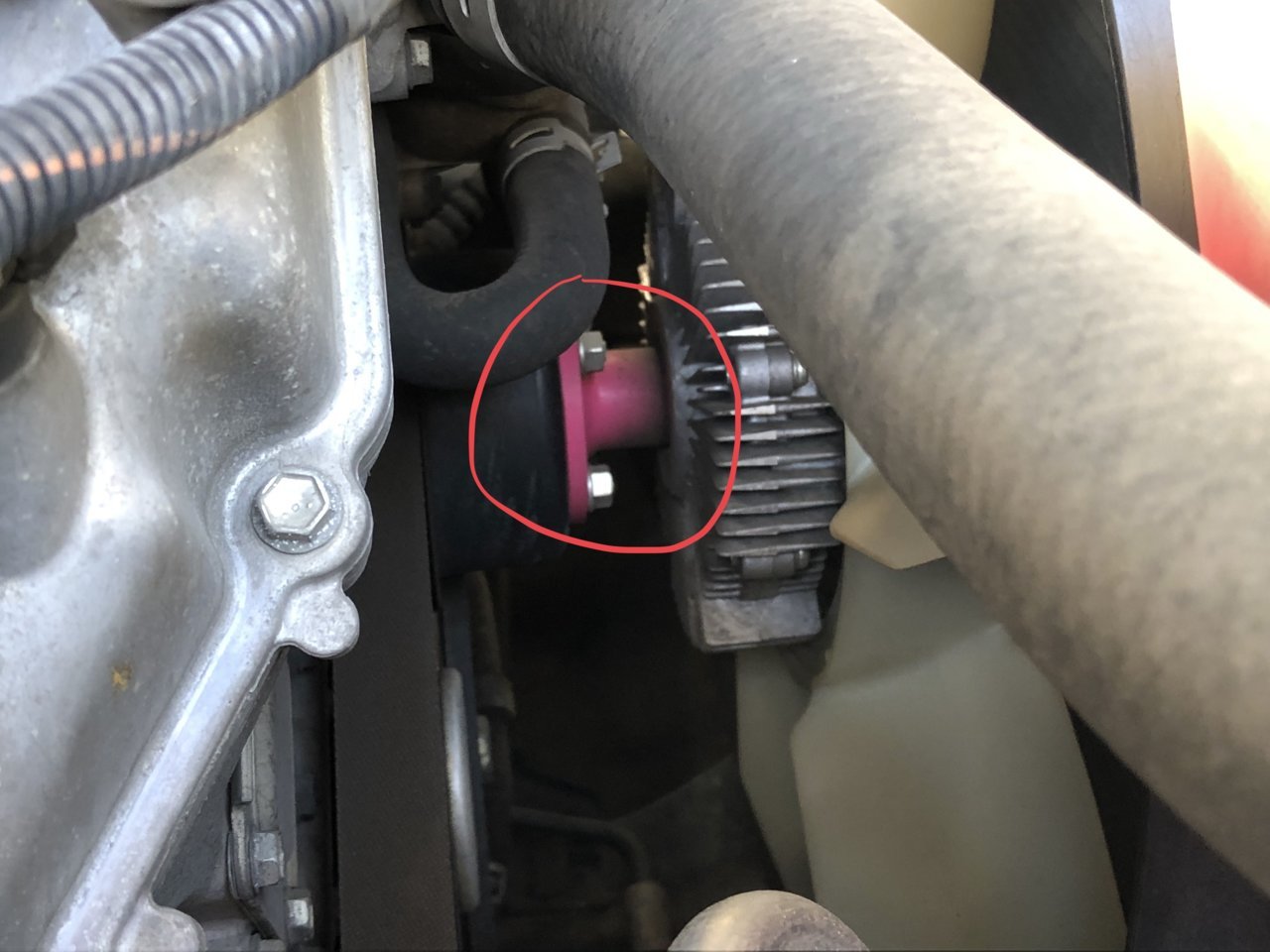

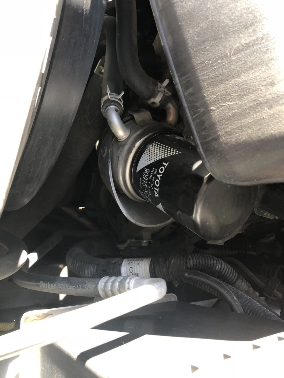

    I have a 2011 sport with the tow pkg. Here are some pics of the trans cooler, oil cooler and the colored fan housing. I learned from others on TW about all of this. Try the “towing bible” thread. It has great info. Maybe others have more input.

    oh yeah, forgot the tow package includes an aux oil cooler as shown in the last pic above...
