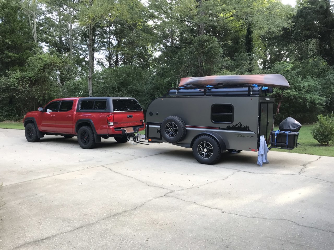

    Loaded up and headed out!

    What is your thoughts on that trailer?

    So far it has been outstanding. Done everything so far I have asked. Have already taken it to the mountains of SC and NC and currently sitting in the low part of SC as we speak. Tows great and is easy to set up while camping. I would buy it again.

    Yeah, well, what is it?

    Intech pursue flyer

    Looks alright, don't know the price. https://www.intechrv.com/pursue.php
    I'm a big fan of those one-legged stabilizers, as opposed to a scissor stabilizer. Scissor stabilizers hang low and limit you offroad. The one-legged tucks up nice and has a nice round footprint sandpad.

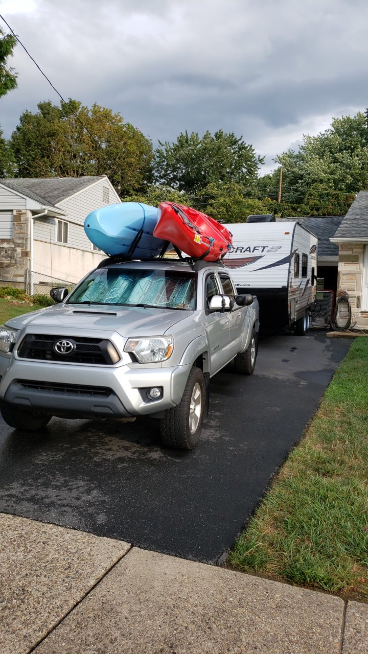

    Scangauge saved my ass for a 2nd time in 2 years. Forgot to put the truck in 4th gear, saw the trans temp going up and realized my mistake. I’m constantly monitoring my trans temp when towing, great investment.

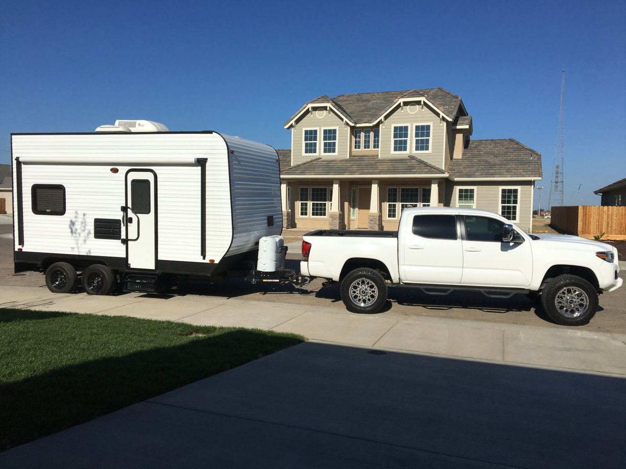

    This is my set up. Dunesport toy hauler 14' two dirt bikes and 50 gallons of fresh water and gear at 4100#'s.

    Hey, nice! We've got a Dune Sport, as well. Is that 7 or 8 feet wide? How's it tow in wind without the hump in the rear?

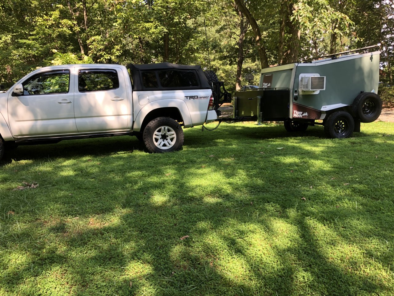

    piddly stuff
    5'x 10" utillity trailer and our micro camper

    Hello tow-coma my trailer is actually 8.5 wide body. I was looking to buy new and found this used for a price I could not pass up. I am really happy with my set up just can’t wait for my ovtune...

    OK, I see. We have that, too. I don't expect people to know it's 102 inches on the outside... Lol.
    I see your fridge is on the passenger side, what layout is that?
    We got ours from Dune Sport. We couldn't buy one prebuilt from Carson for less than we could order it from Dune Sport. Yours looks so new! Must not have been used much!

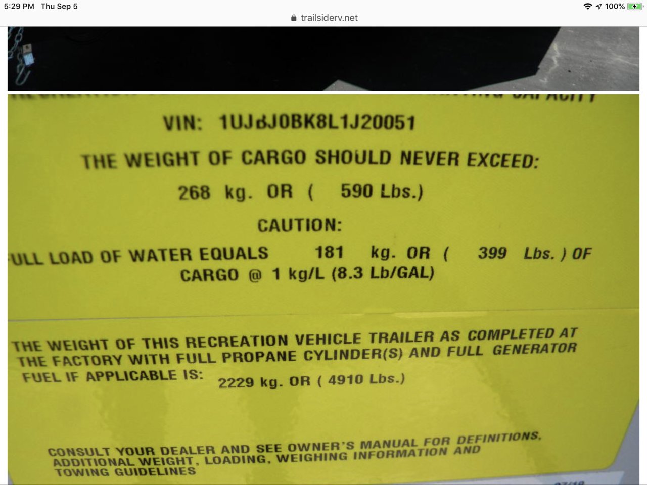

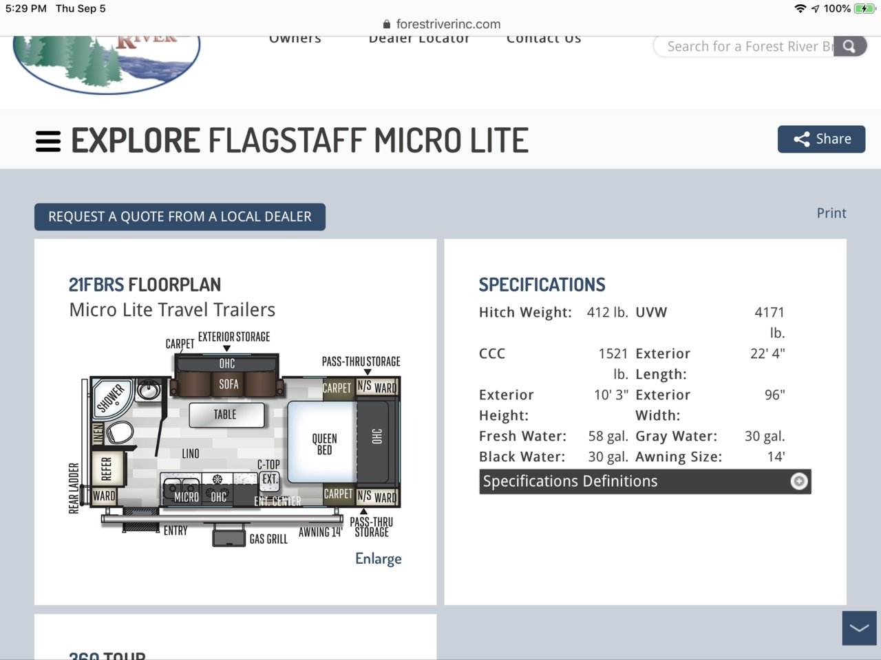

    Need advice, I’ve been looking at the following 2 travel trailers and would like an opinion on if they are ok to pull with a 2019 trd sport 4x4 short bed. GAWR is 11360 for this truck.
    The first is a Jayco jay feather j2 16 rk
    The second is a forest river flagstaff micro lite 21fbrs
    I plan on using a 4 pt equalizer wd hitch.
    Appreciate the feedback, thanks

    Personally I think the Jayco is too heavy and Forest River is probably the heaviest I'd want to go. Remember to consider the weight of cargo and passengers. I have a 2018 Keystone Passport ROV 173RB that is just under 4,000 fully loaded (about 3,000 dry) and while I think the truck handles it pretty well, it does give the truck a workout on hills or in the mountains.

    ^^^ What he said. I'm at 4100lbs dry and find the truck is definitely at the max. Headwinds can be challenging sometimes 3rd gear is all you can stay in during those challenging times. The truck handles the weight fine and feels safe with my wd hitch but it just needs more torque.

    Hello my set up is the ada version with a 3x3 shower. Built in generator that only had 3 hours on it when I purchased it. Yeah it was hardly used and that is why I couldn't pass it up.
