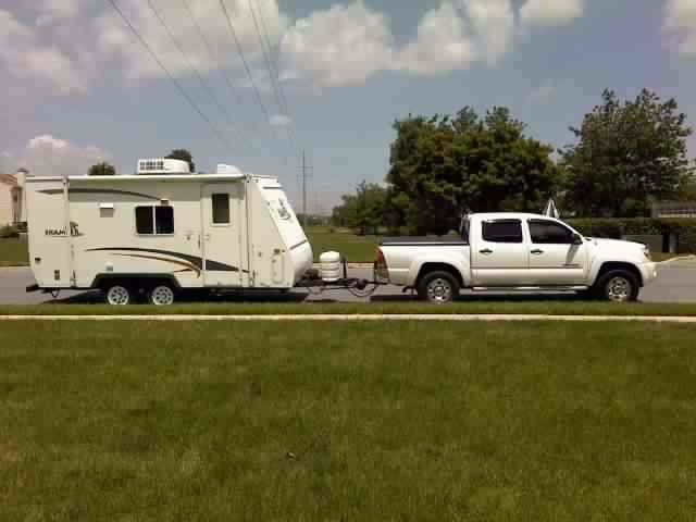

    I bought it this morning and now I can join this thread.

    Cool! Looks like it sits level. Is your truck suspension stock or modded?

    Stock I also had the TSB done. There is also a weight distribution hitch. It pulls fine you just see in the mpg it is about 10 mpg.

    Congrats on the trailer chugchug, looks good.
