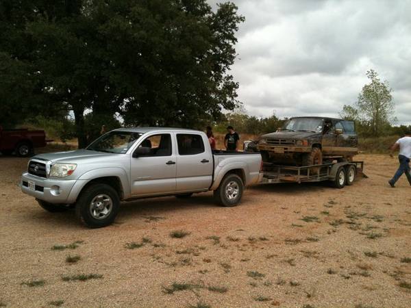

    It's an 89 Toyota Pickup. I got some stuff done to it.. FJ axles going under it soon.
    I'd do it..I'd be more worried about burnin up the tranny even with a cooler..then breaking the rear axle or stressin the frame.

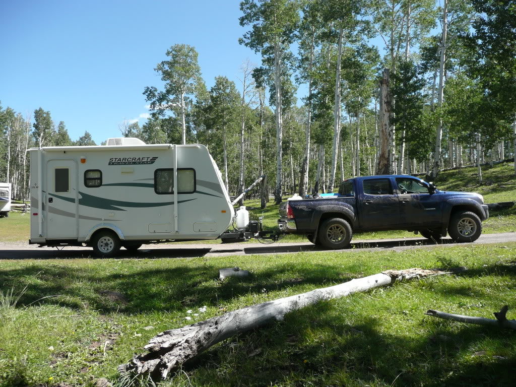

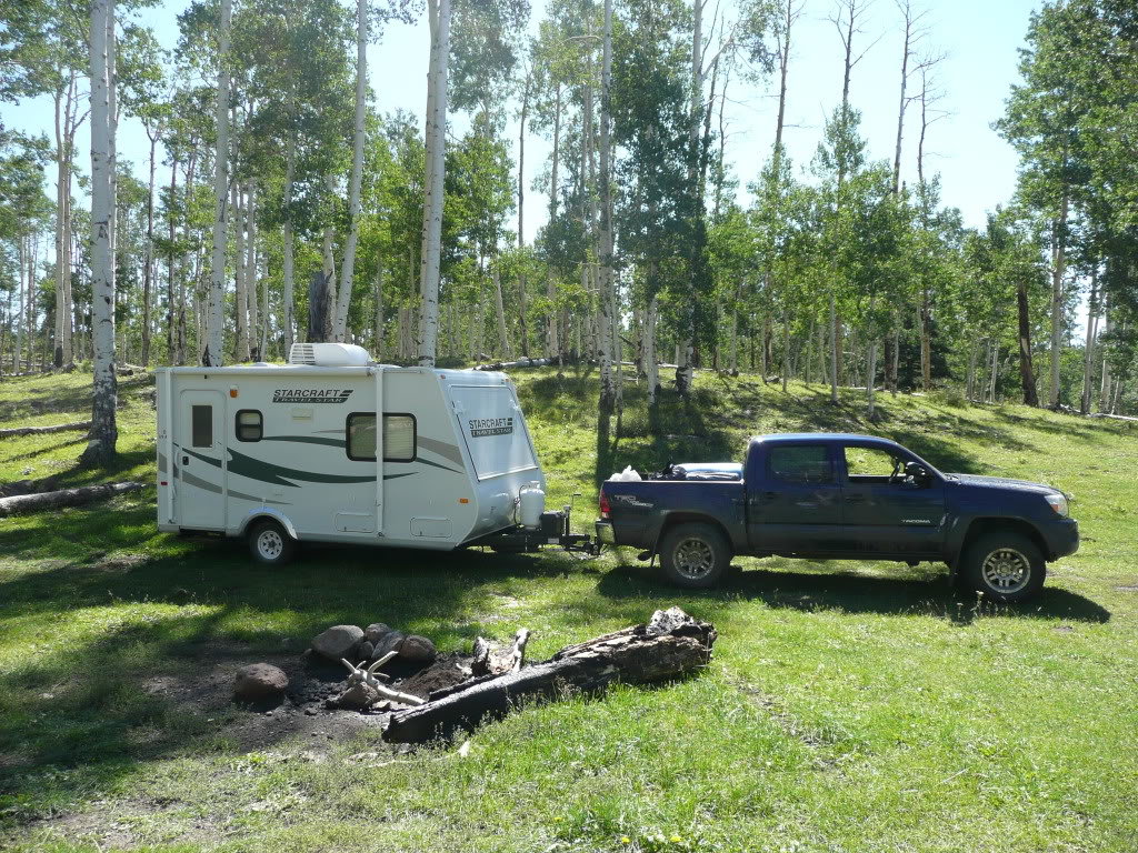

    I tow a 2010 Starcraft 168 RB

    I hate to say it, but it looks like you are sagging badly even with the WDH. It's IMO not adjusted right, or there is simply too much weight. I would take a trip to the scales asap to find out what is going on there.

    I think it was the weight of the gen set and gear in the bed that was causing it to sag (based on my numbers I still had some payload cushion left). I wish I would have taken a picture when I had the bed unloaded and was taking the trailer to dump the tanks. It sat level. But I do agree, I need to tweek my WDH to see if I can take somemore weight off the rear axle. When I set up the WDH initially, it was done with a totally empty trailer and truck. I need to do it with a full water tank and at least the gen set in the bed of the truck.

    I agree, I'd measure and adjust everything fully loaded. Be careful not to over-adjust the Equalizer, though, you are only supposed to compensate to the trailer tongue.
    08TRDOFFROAD, do you have Timbrens?

    No, just the TSB leaf packs.

    I have to agree with the other comments. Your WD hitch should be adjusted a bit more. I had three bikes, two Honda EU2000 generators, two 5 gallon jugs of gasoline and an extra propane bottle in the back of my truck on my last trip which was across the country. I have a chain style WD hitch and dropped an extra link since my trailer was fully loaded as well. I was traveling by myself (my family was in another vehicle since we were moving across state lines) and I know I was maxed or near maxed on the rear end. My trailer is a lot bigger and heavier than yours and despite that my truck was almost perfectly level. I have an 05 with the origional springs before they released the three spring pack and the only other thing I have is the Roadmaster Active Suspension system. If you're going to tow a lot I would seriously look at making adjustments to the hitch and/or adding a helper spring or other to help with the sag.

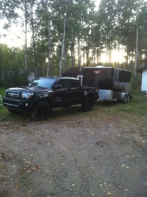

    7'X16' All aluminum frame.
