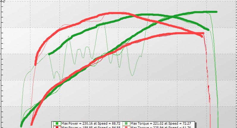

    If you look at the rated horsepower and torque numbers on 2nd vs 3rd gens the rpms are higher for both on the 3rd gen. Its a higher revving engine. Thats just how it is. The 2nd gen does a little better in lower rpms than the 3rd gen does. And the 3rd gen does a little better at higher rpms than the 2nd gen.

    we are talking about 600rpms though initially and how significant it is on the numbers.

    I smoothed out the average hp/tq curve.
    HP/Torque always intersect at 5252 rpm. The graph isn't the best representation of torque at a certain RPM because the RPM range on the graph is not the same for both motors, as shown with the 4.0 with 5252rpm near the end of the graph compared to the 3.5, showing that the 4.0 has a lower redline.
    Just looking at the visual representation the torque difference is minimal and really just moved up a couple hundred RPM. Now the 4.0 does have a steeper gain at the lower rpms but the 3.5 does have a smooth flat curve all around with no sharp peaks as people seem to suggest. The HP difference though is pretty significant from the 3.5 to the 4.0 though.
    As others have suggested, it's probably a transmission issue as the gearing in the autos is way higher than the manuals. If you've ever driven an automatic 6speed, they're all pretty similar on the hills. Those who have done 4.88s or even 5.29s say anecdotally the truck drives much better, the way "it should" have been from the factory.

    No it doesn't that green line would be the torque numbers of the 3.5 if it had another .5L it shows the 4.0L 1GR has higher numbers, but the 3.5 is making more torque per liter if that makes sense.

    I think we should note, that in his graph we dont know what engine its testing..could be the supercharged taco engine..Might not even be tacoma lol

    The website I pulled it off of said it was 2 stock tacomas 2nd and 3rd gen v6. Could be inaccurrate, That just what it said
