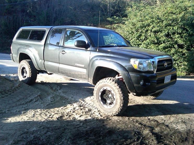

    06 SR5 Tacoma
    Toytec ULK, OME Dakars, Bilstein Shocks, Extended Brake Lines, 285/75/16 Duratracs, Pro Comp Steel wheels, Relentless Fab Front Bumper/Sliders
    This was 6 month after i installed the toytec ultimate lift set at about 3'' maybe a bit more with 265/75/16. the cap settled the aal a bit and i think it ride smother with the cap. now i have 285/75/16 which i like alot more.

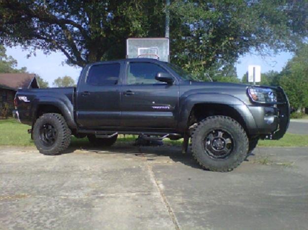

    Metalic Grey 10 Double Cab SR5 4X4
    3in Rough Country, Pro Comp Wheels, 285/70R/17 Buckshots, Brush Guard, OEM Steps
    3in Rough Country, 9x17 wheels, 285/70r/17 Maxxis Buckshot Mudders

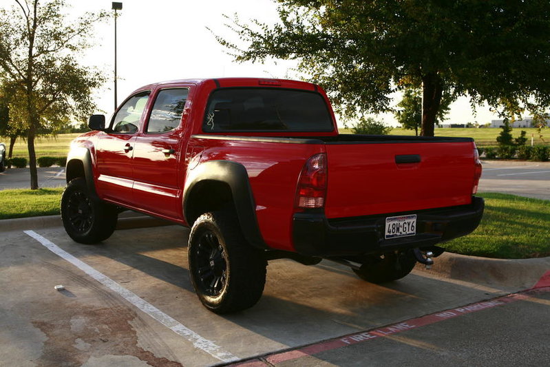

    08 PreRunner
    3'' lift and striaght pipes!
    This is my 2008 pre-runner with a 3" lift and 32s.

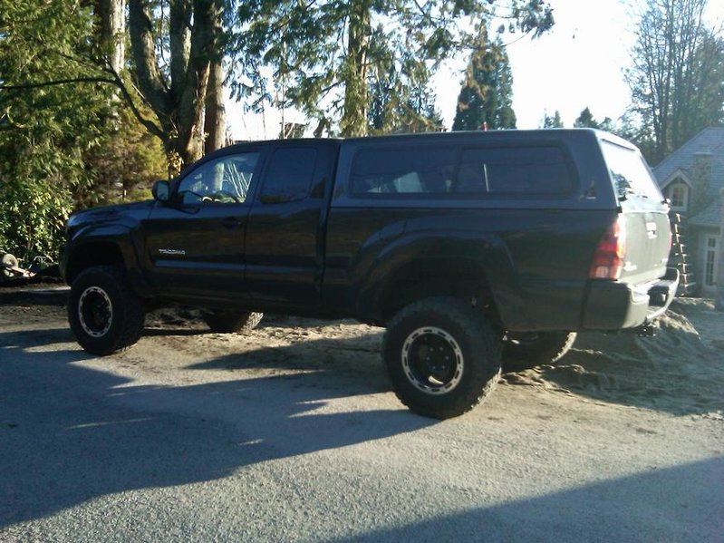

    17 Taco 4x4 SR5 Access Cab White
    More recent photo with the MaxGaurd on the sides.
    305/70/16 COOPER DISCOVERER STT's on American Eagle 185 Rims.
    OME 886 Front coils with 7/8" spacer. No rubbing! OME/Dakar Rear Leafs
