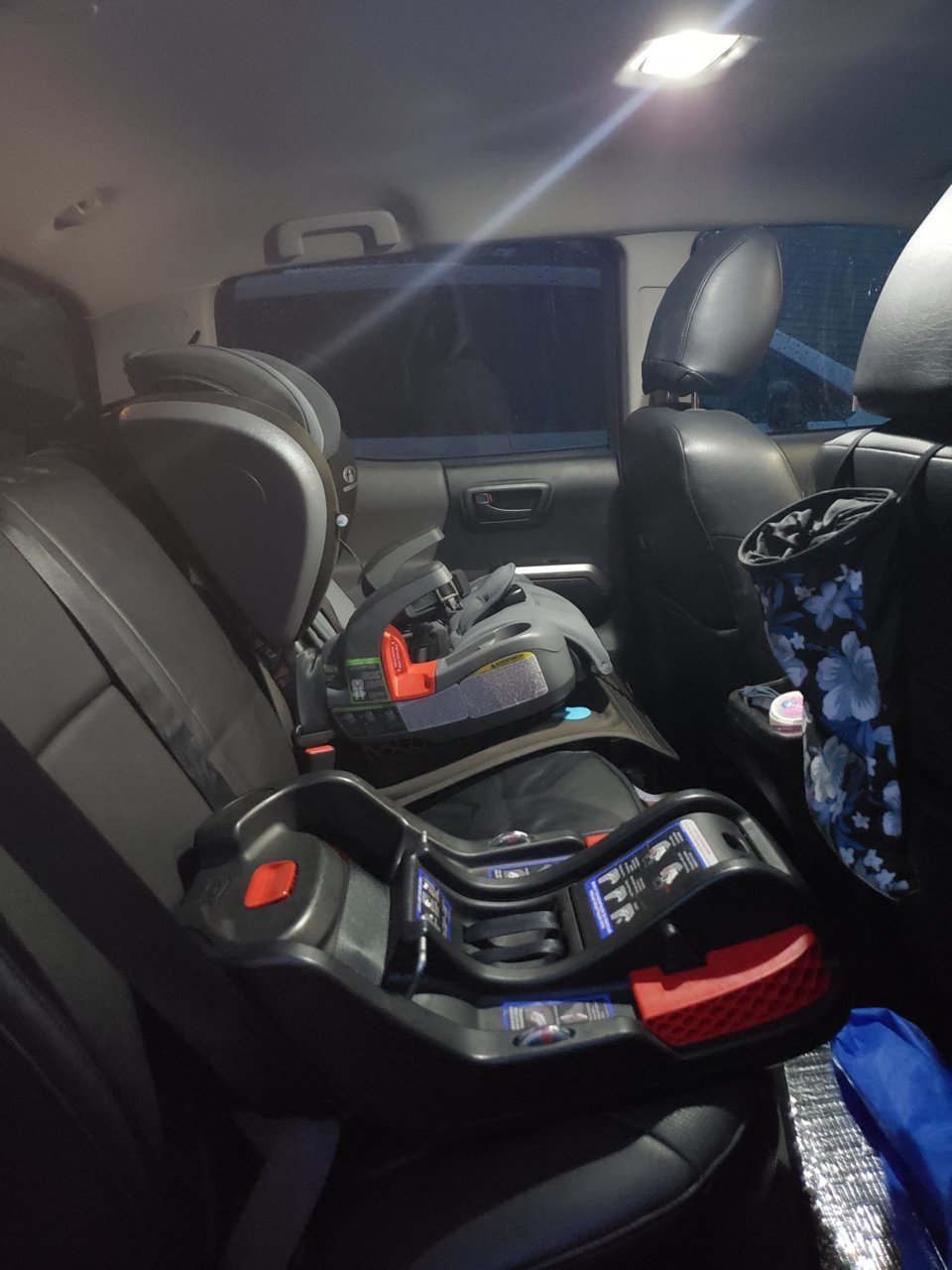

    Added a rear facing seat for my newborn. The lack of anchors in the seats is frustrating since I feel they would be more secure.20210318_194401.jpg

    The 3rd gens dont have anchors in the back??

    They do...unless he's referring to rear facing anchors...which they don't. I'm not sure if any cars do.

    They all have the LATCH system in the back.

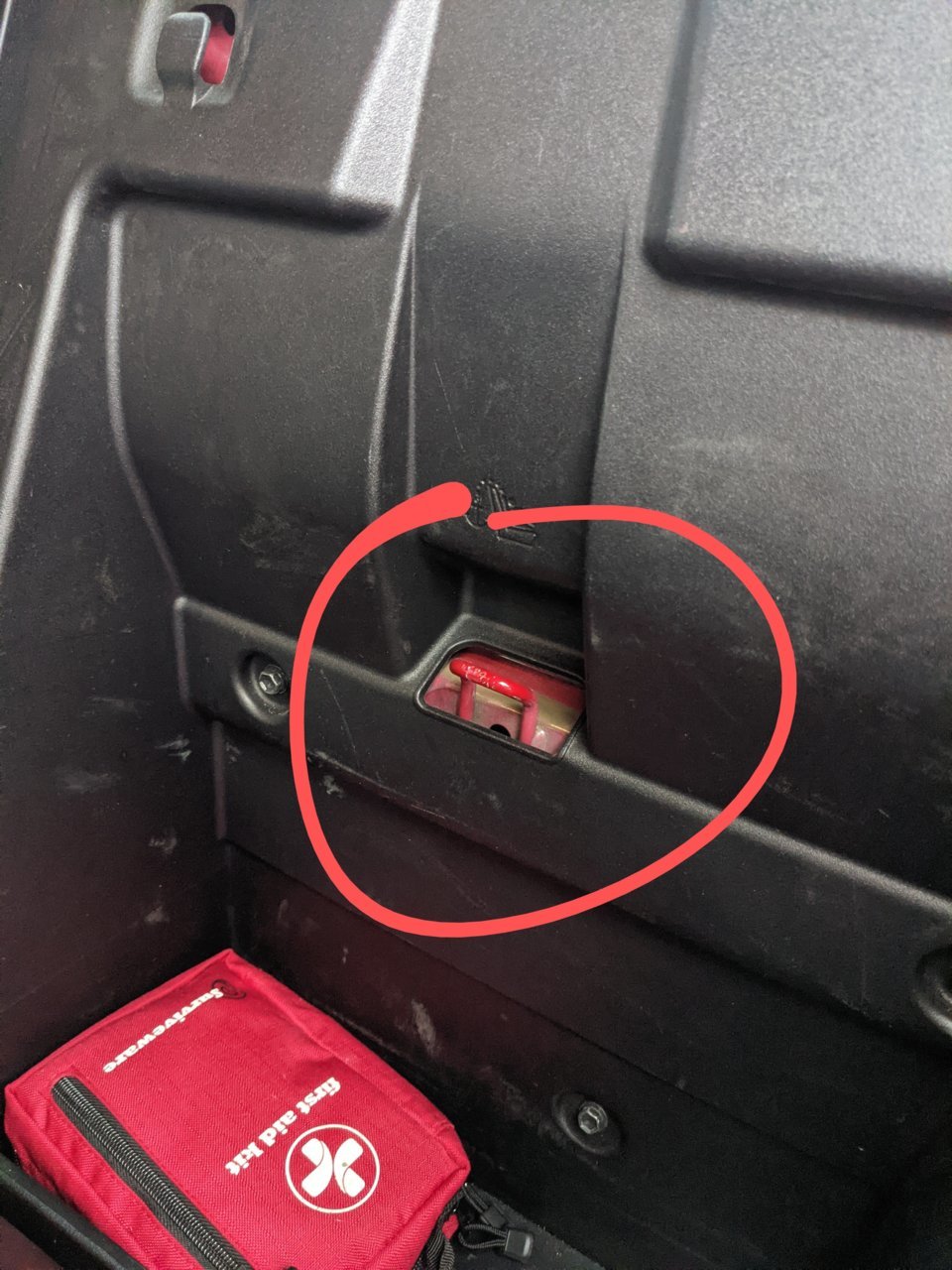

    They do have anchors, but they are up top behind the seat. My Subaru has them on the bottom cushion near the seat belt buckles.

    Unless this is something they added after 2016? Or I'm blind and having trouble finding them bc of my clazzios?

    They're on the back wall, not at the bottom or back of the seat. Fish the strap under the headrest, lean the seat forward, attach strap and pull as you push the seat back in place.

    Thanks for the photo! That is definitely helpful!

    Those are the top anchors. The LATCH anchors are in between the seatback and seatbottom.

    Correct. I assumed he was looking for the rear anchor strap. The others are more obvious, I guess.
