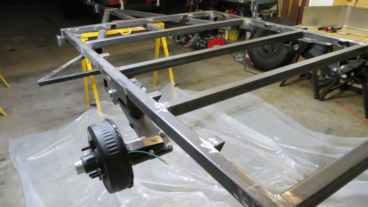

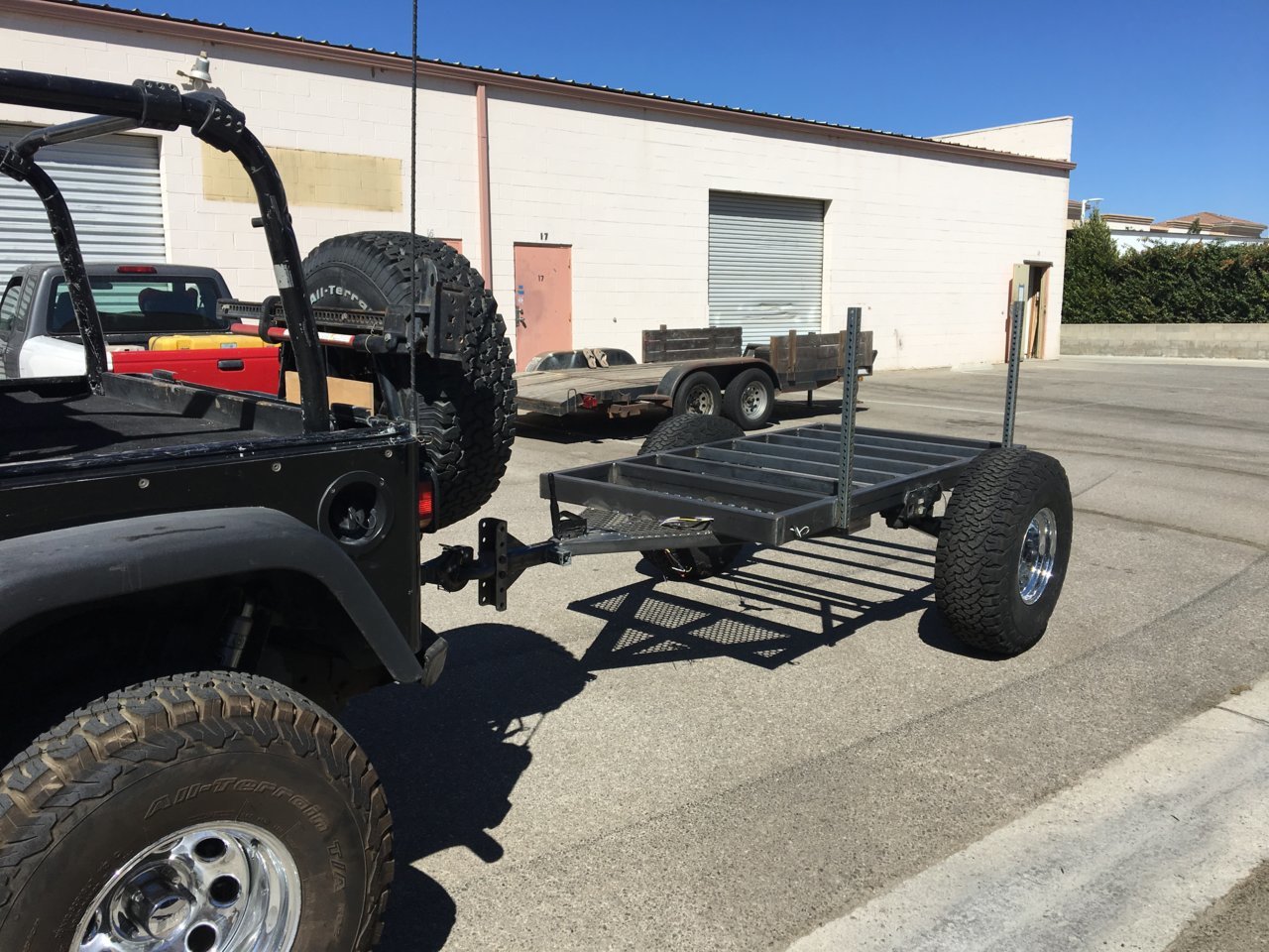

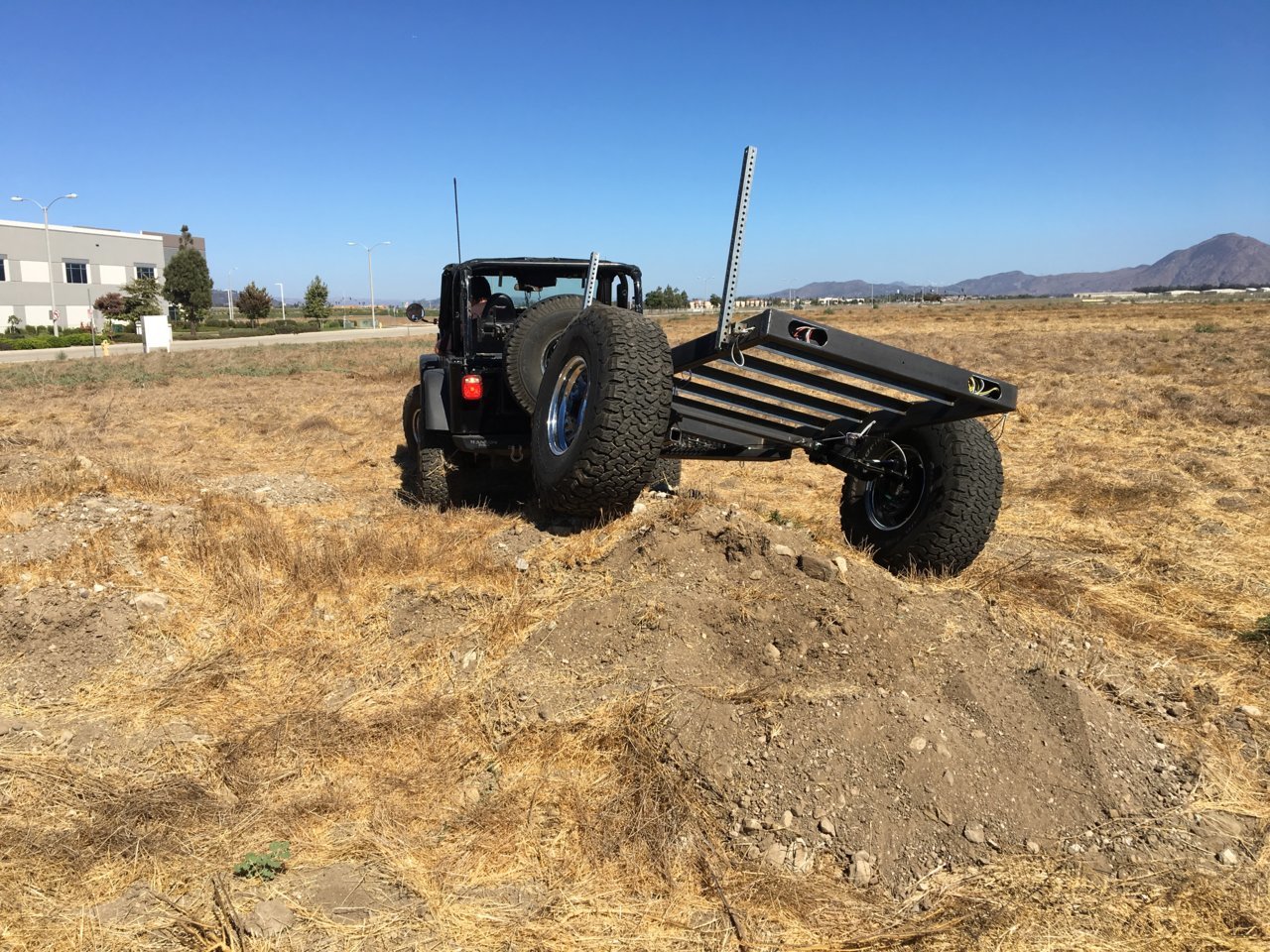

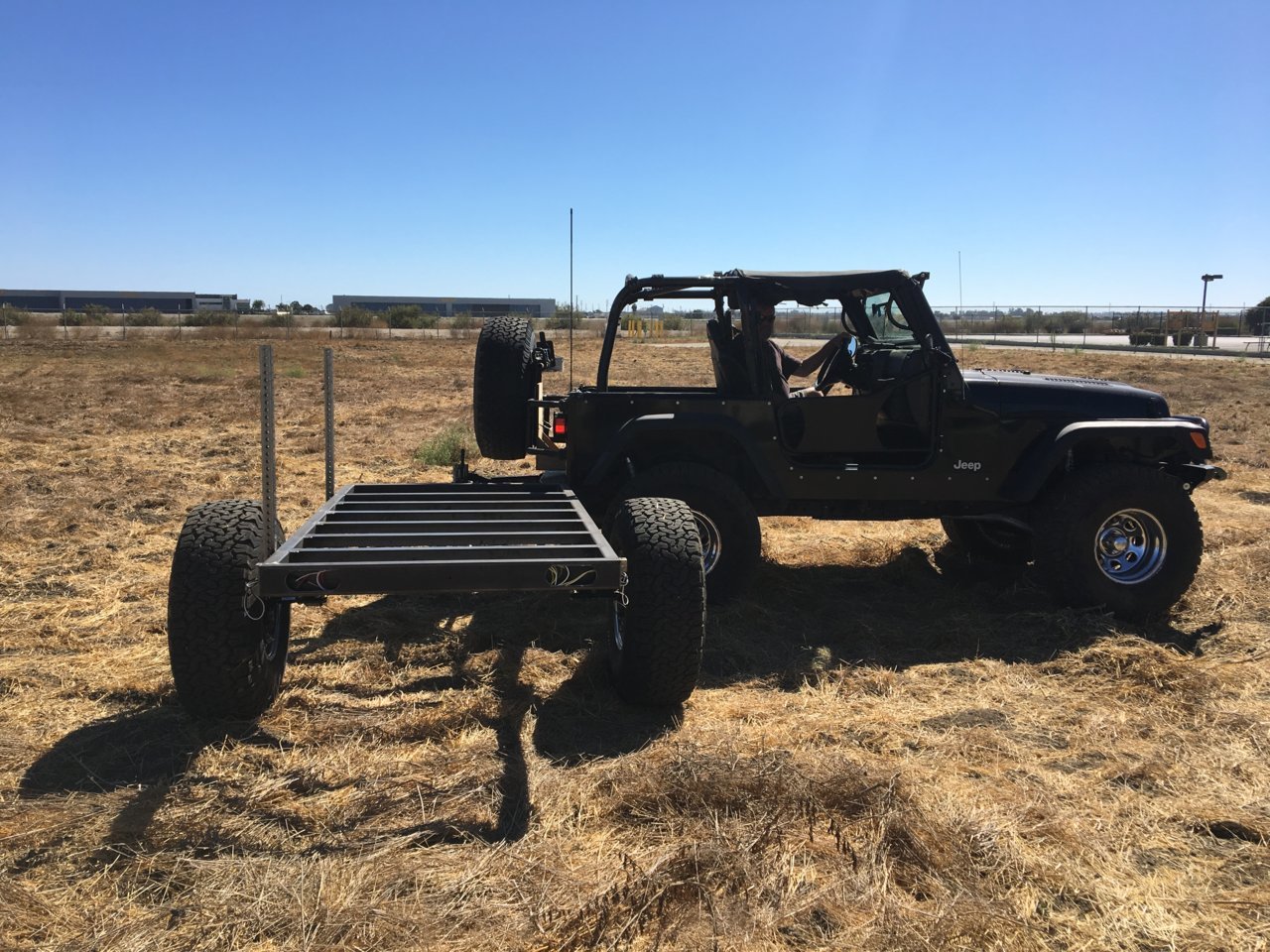

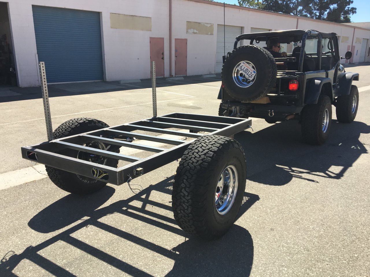

    I just finished a trailer frame for a customer and used timben suspension on it.
    It has the 3500 lbs., long off road arms with the 4 inch lift spindles. The trailer has electric breaks and a mechanical parking break. The trailer will receive a 4x6 box that’s 27 inches tall and have storage for Jerry cans up front. The tires are 35 inch BFGoodrich that match the customers Jeep.

    That thing is sweet! Nice work!

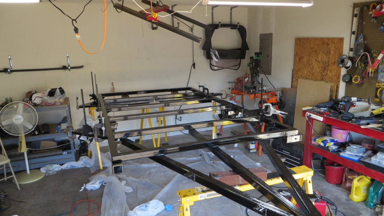

    I'll have to get some better pics of the Timbrens. This is my off road teardrop trailer with 1 tonne axle-less suspension PN#ASR1THDS02. I am just finishing up the build. Teardrop is a little on the heavy side. I might have to upgrade the spring after I see how it rides and weigh the trailer

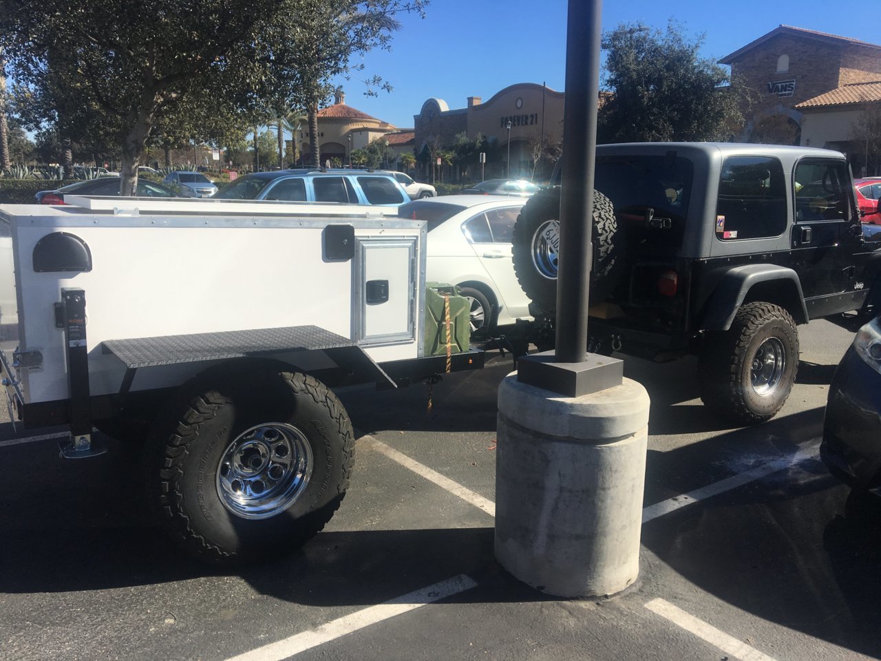

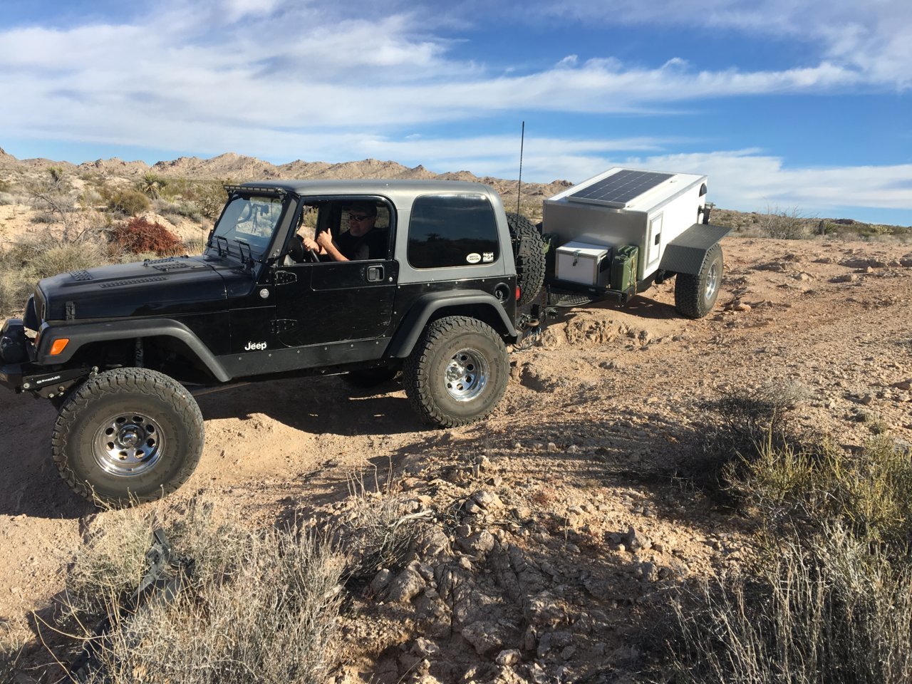

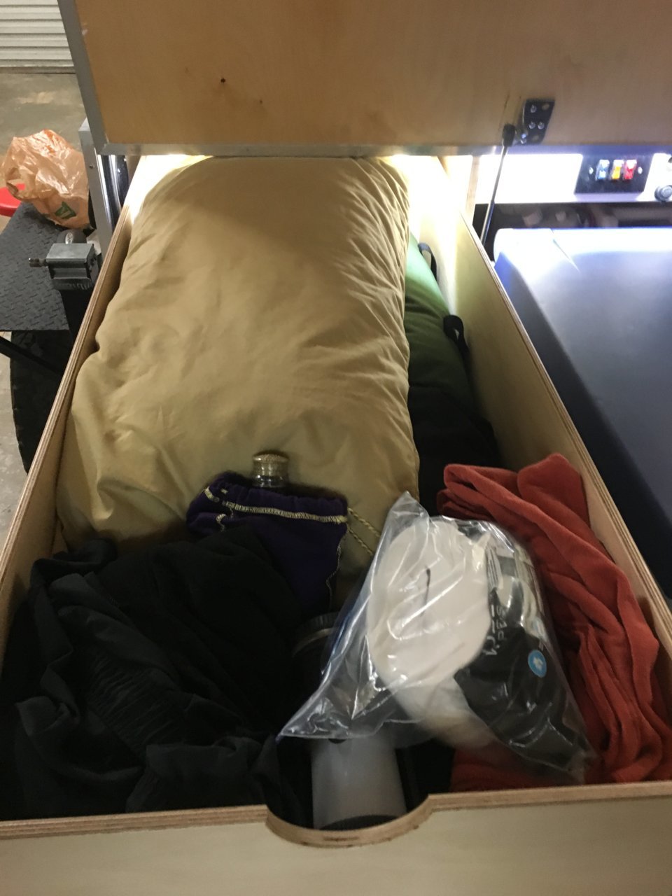

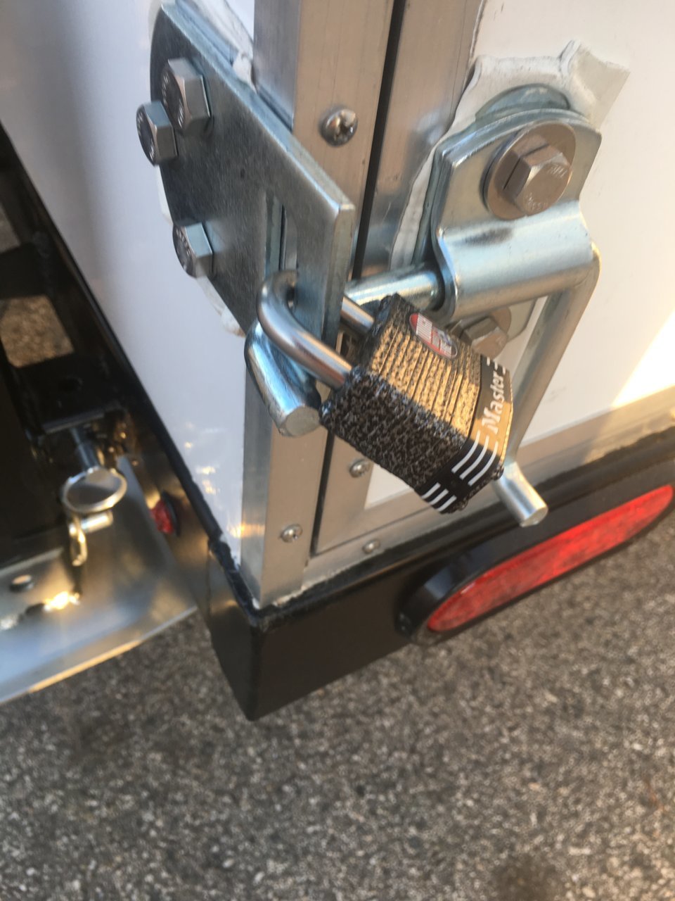

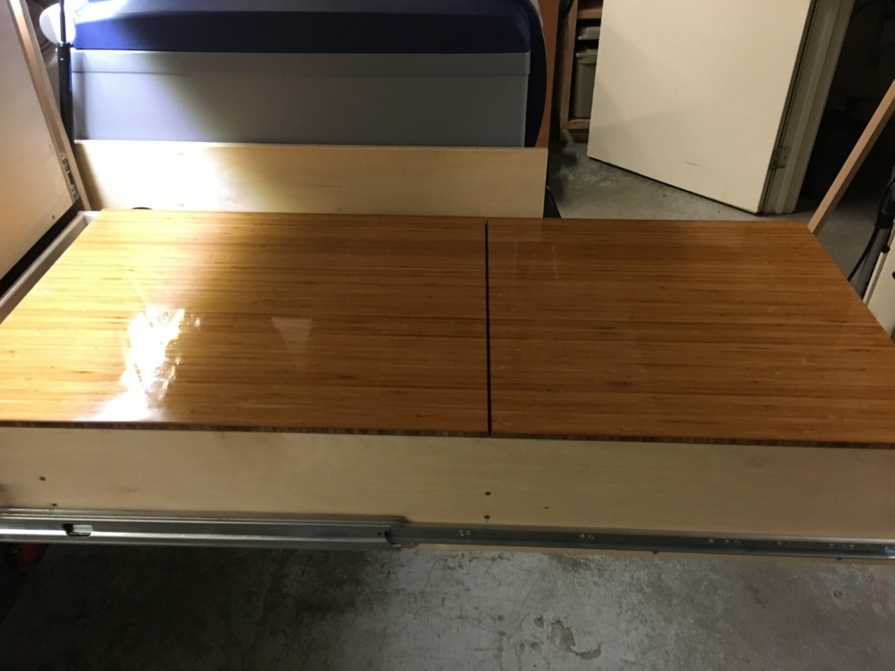

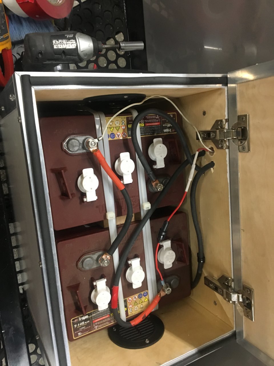

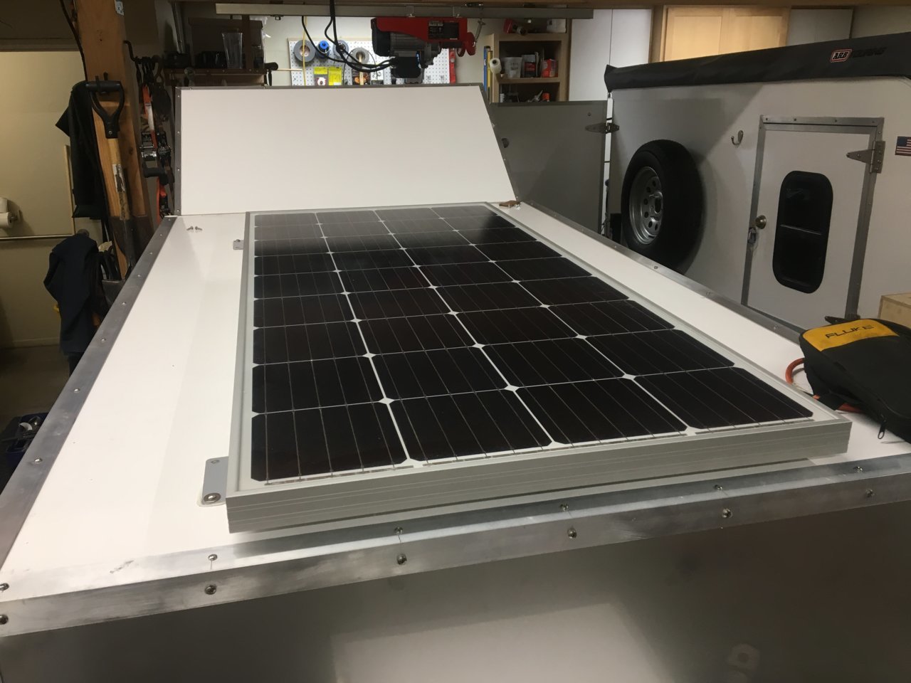

    Trailer update. Here is the good part.

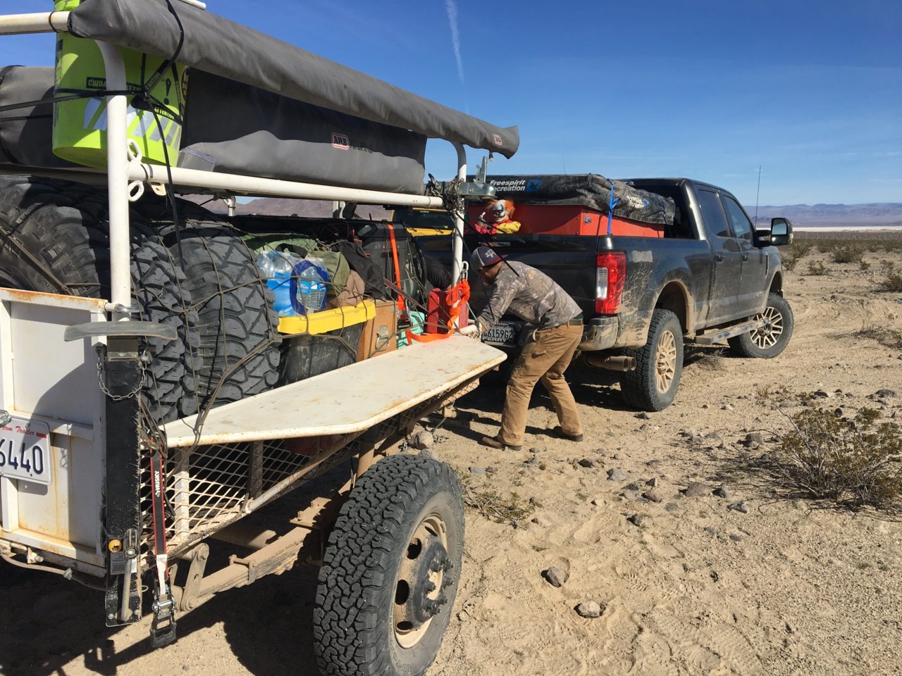

    The trailer is finished except for mounting the hardshell roof top tent. Its first outing was the Mojave trail. It did great and the owner is very happy with it. The trailer has a 20 gallon water tank, 2 260 amp hour 6 volt trojan batteries, propane water heater, 200 watts solar, an 80 quart arb fridge, 3 large sliding drawers, and stroage for 2 5 gallon jerry cans. Future mods will include a magnum inverter charger and a propex heater for the roof top tent.

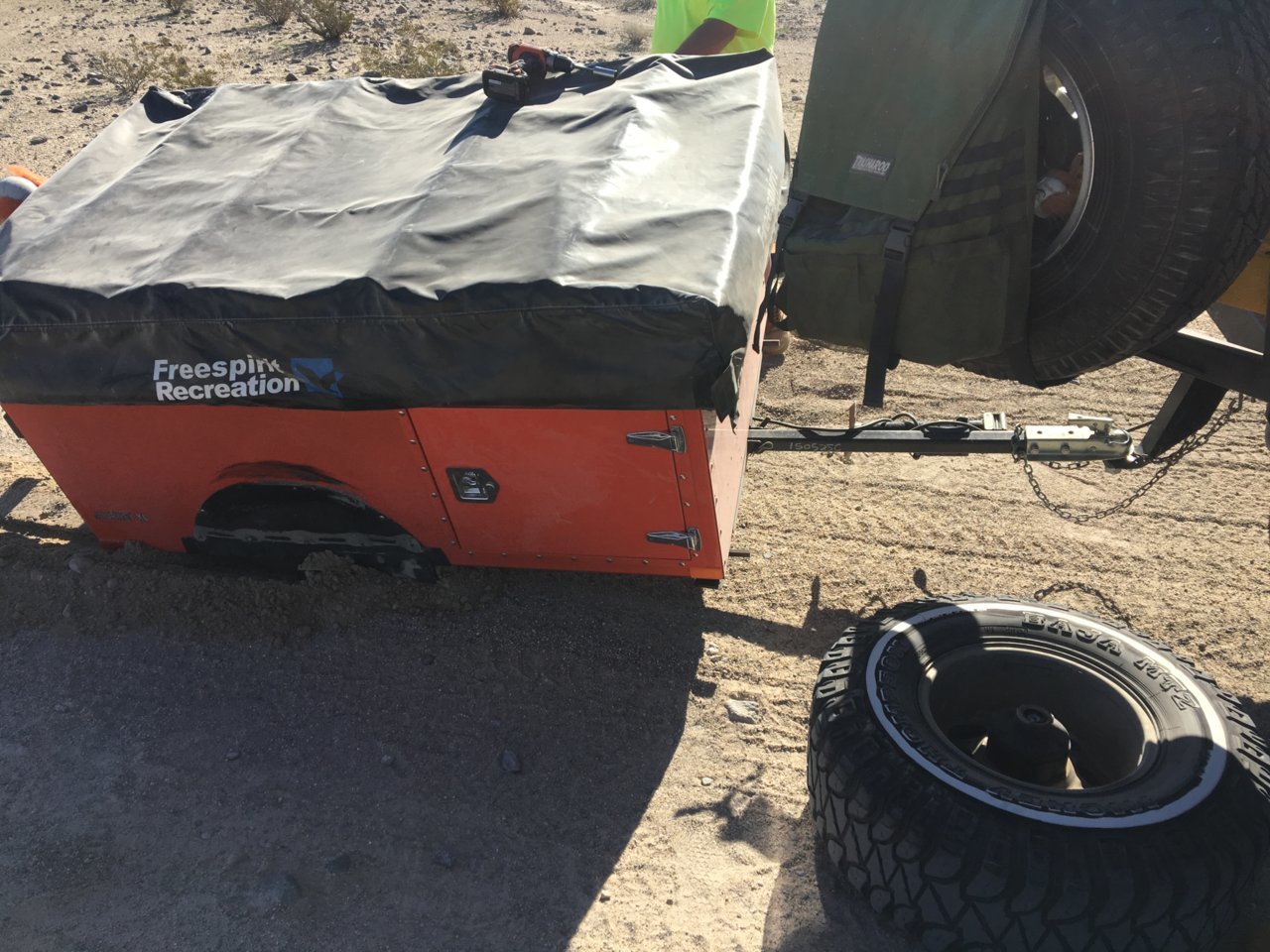

    Here is the bad.

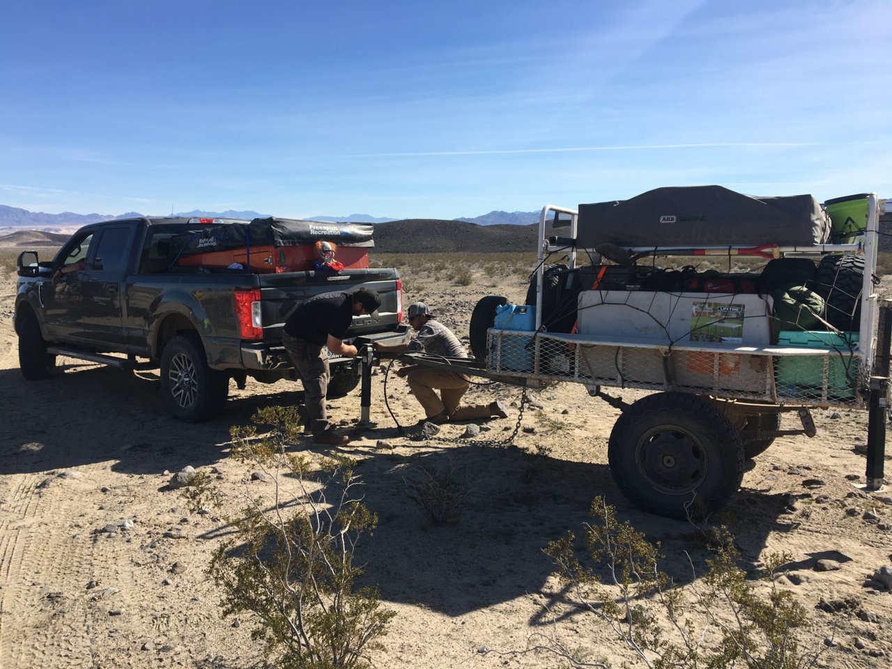

    Mojave 1 Freespirt 0
    We had a spindle failure just after Soda lake. Its a 2000 pound non brake unit. The owner was warned of this happening when we put the 33's on it. Thank God for SuperDutys and my heavy duty trailer. We were very greatfull for the group of 15 or so tacomas and 4runners that stop just in time to help load it into the truck bed. The ford was renamed SherpaDuty!

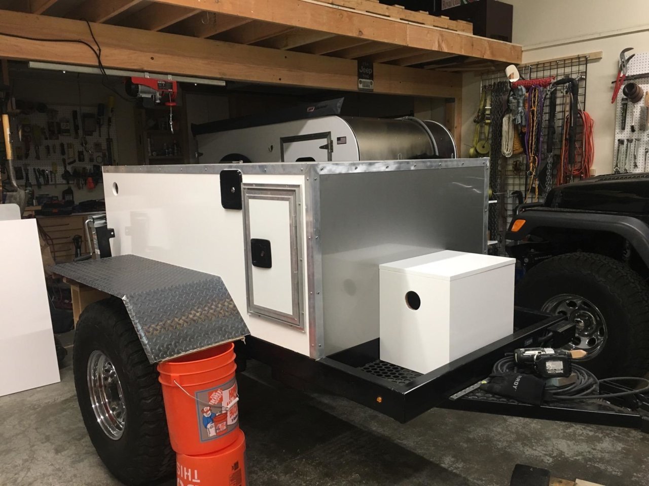

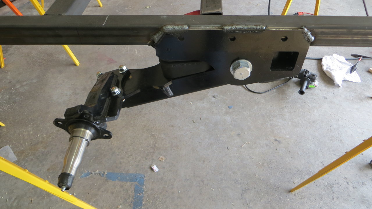

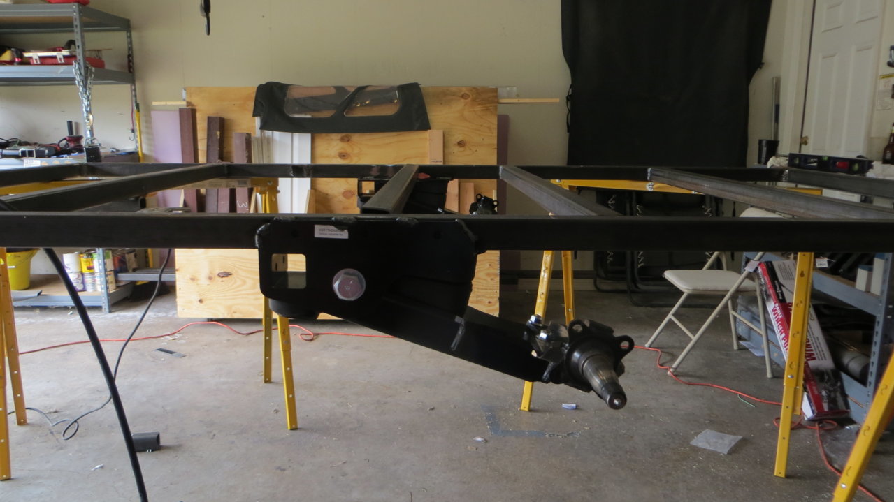

    Here are a few pics of my Timbrens when I built the trailer.
