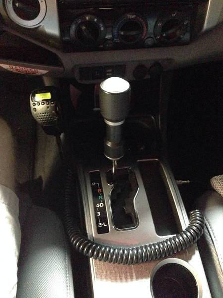

    When I bought mine I modified it with a coupler nut and some M8x1.25 stud that I cut to size so I didn't have to cut. But then again I like my shifter sitting high. It did take a little bit of modification to finally get it all together though. This picture was before I fine tuned it a little bit to bring it a little lower (cut the M8 stud down a little more). Not to mention the only M8 coupler nut I could find was on BoltDepot, and it cost $10 to ship a sub $2 piece lol...bunch of bullshit but owell.

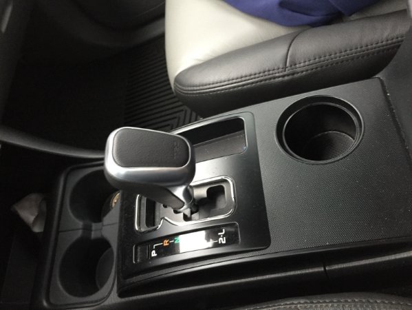

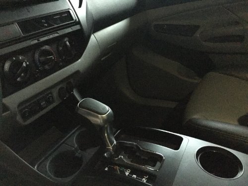

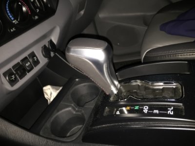

    Many thanks to Eddie and this thread.
    the side view photo makes the shifter look shiny chrome and its not, that was a result of the flash. its finished with a clean brushed aluminum finish...
    I installed the Tundra TRD shift knob too :) nothing like the feel of cold metal and leather in your hand. My truck isnt a TRD so im not into anything with the TRD branding in it, but the logo is pretty unobtrusive.
    i wrapped the lower part of the shifter in masking tape then took my belt sander to it. i took off more than i needed too. you can minimize sanding if you sand it with an angle (angle that would make the shifter lean backwards if placed flat on a table). as you just need to take enough off to clear the lowest gate which is 1 and 2 (full aft). i took off prob nearly an inch, and didnt need to remove that much. it feels like such a nice quality part. the leather on it matches the katzkins graphite PERFECT.
    i used part number PTR57-34140, it has the red stitching on the front (i was trying to avoid that) but you cant even tell its there its so out sight.

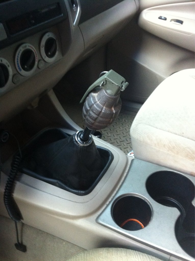

    My WWII grenade. Real WWII hand grenade that was disarmed and cut in half after the war

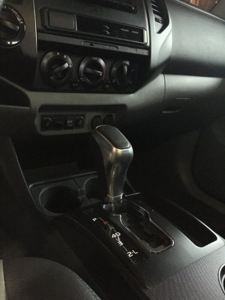

    purchased and installed... not cutting required.
    Used 3 different M8 x 1.25 pitch nuts and still have 5 good turns on the knob to hold her in place. Height is perfect.... shifts into all positions and is great matching height when resting elbow on center console and top of shifter.
    Might take a sharpie or black dye to the red threads if they start to annoy me, but as someone else mentioned, they are not very noticeable.
    P/N - Box
    Castling Nut, Jam Nut, Regular Nut (M8 x1.25 pitch) - 5 threads still showing... plenty to hold her tight.
    Shifted all the way back
    Shifted all the way forward

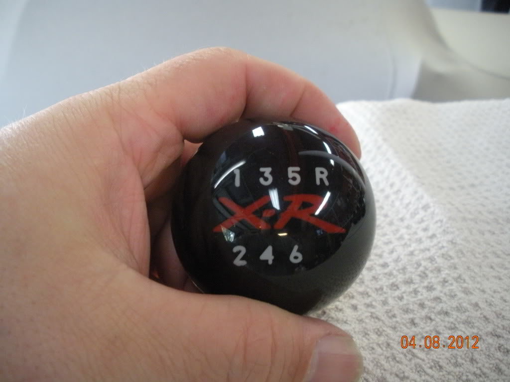

    Lots baby!

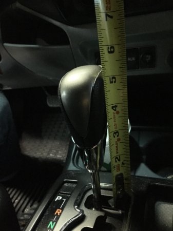

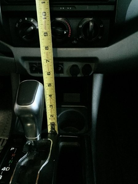

    whoa, yours looks incredibly high. do you know how high your is standing?
    mine is around 5", which is just about the same height as the stock one.
    the ruler in the shots is in a slightly different location but you get the gist.
    in fact the tundra one sits a little bit lower...
