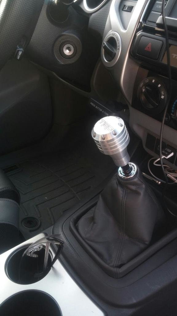

    Aluminum is kinda "cold" and I think I want to rework it a little.
    It's not bad feeling but I think I am going to do a revB out of delrin and play with the dimensions/proportions a little bit.

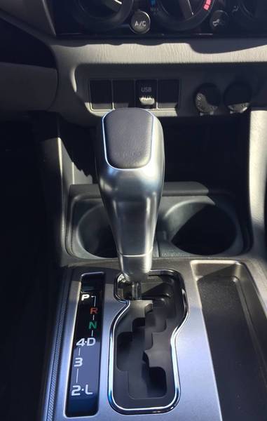

    Installed this guy. I didn't cut, sand or grind. No need.

    I like it where did you get it

    I bought it off eBay. A little pricey, but I like it. It's a lot beefer than the stock one.

    Thats off the Tundra or 4Runner correct?
    Any mods needed? or did it just screw right on to stock tacoma thread?

    Correct. Part number is PTR57-34140. It's also on the TRD Pro. This knob is too long to just screw right on. Some guys on here have cut or sanded the bottom of the knob but you don't have too. I wasnt going to do that to a brand new part. The bottom part of the knob comes off. I tried rocking it back and forth by hand but had no luck so I got a small toggle bolt and put it in the hole on the bottom of the knob. With the knob in one hand and a pair of plyers in the other gripping the screw, I was able to pry the bottom part off without damaging it. I then threaded a stop nut onto the shifter and then threaded the knob on. It took a few trys to get the nut threaded down/up so that the knob would stop and not hit anything while I shifted all the way down. Hope that makes sense
