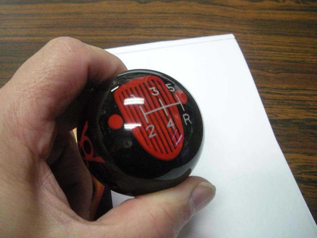

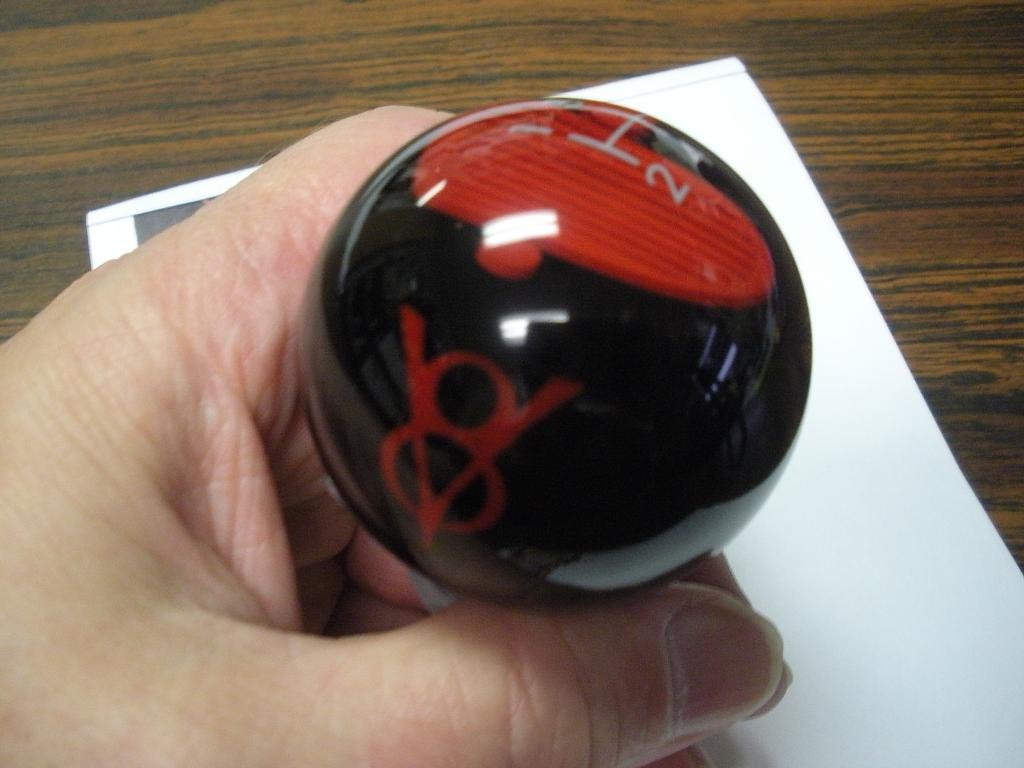

    Lots baby!
    This is what I have on my 34 Ford Coupe

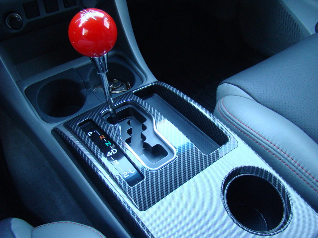

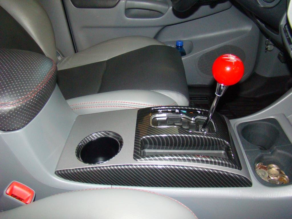

    John, I love that CF finish on the center console. What did you use to wrap it? Do you have a write-up on the install, by chance?

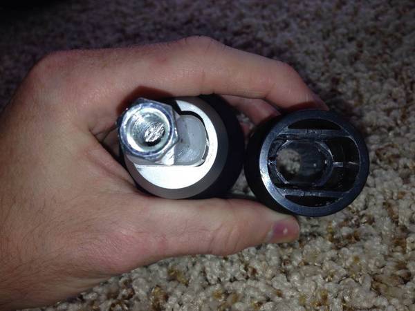

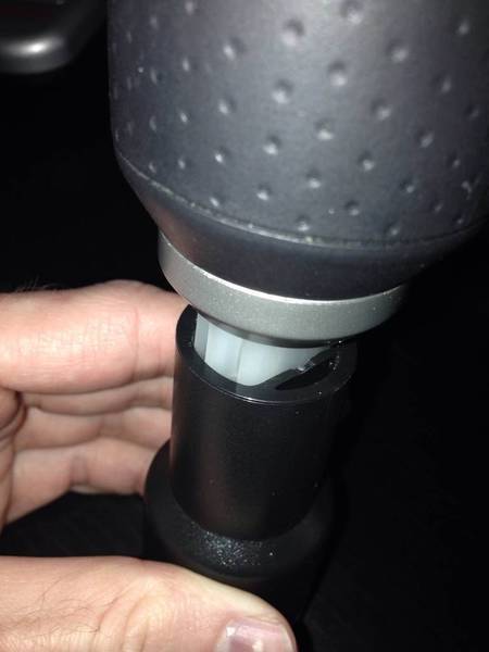

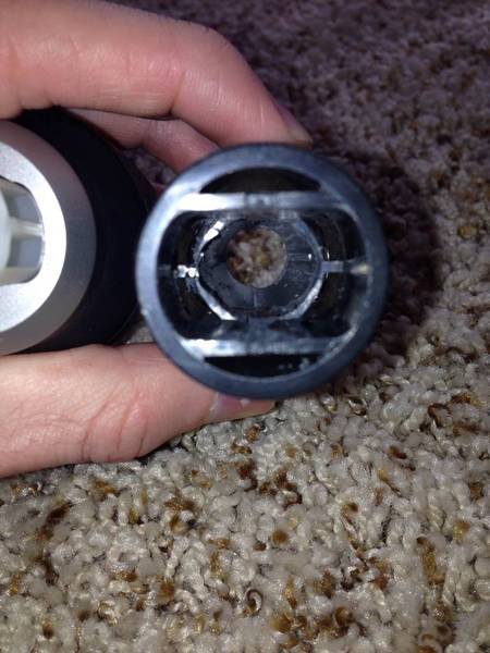

    Okay this was my method of fitting the FJ shifter without cutting it down to size since I liked my shifter sitting higher.
    Can see the inner plastic piece of the top portion of the shifter and how it inserts into its respective slot in the lower half:
    Next is the two pieces apart. You can see the M8x1.25 coupler nut I bought screwed up tight with the M8x1.25 stud I cut to size:
    Another shot of the "plug" piece of the upper half and its fitted slot on lower so the upper doesn't just spin freely:
    Lastly you can see how I did a little bit of filing of the internal plastic ring inside the lower half to accomodate the M8 coupler nut but still retain a very snug fit:
    Overall very simple. But finding a coupler nut might be a pain. I ended up buying off boltdepot.com and then of course just went to fastenal for a M8 threaded rod.
    After hunting a shifter off eBay and then getting the rod and coupler nut, I think it cost me like $40 total? Biggest variable is how much you pay for the shifter.

    Awesome, thanks for putting up those pictures. I like your idea of keeping it higher up, I think I prefer mine to be up like that too. Thanks!

    Hey Ben, sorry for the delay in responding.
    This is actually a shot of my recently hydrodipped interior pieces done by a fellow member-----http://www.tacomaworld.com/forum/buy-sell-trade-other/245364-rl-hydro-graphix-water-transfer-printing.html
    I went with Shawnaughty designz "silver true weave" over a black base, then gloss clearcoat.
