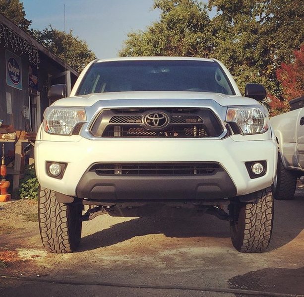

    Icon front and back. Got more lift than wanted/expected out of both, but hopefully it settles a bit.

    DAMN that's sharp! Mind sharing the details? I'm assuming 2" up front and the AAL? What size wheels and tires are you using?

    Icon ET 2.5 non-resi
    SPC UCA's
    Icon 3 leaf AAL
    Icon 2.0 VS
    Tires are 265/70/17
    Wheels are 17x9 0 offset
    I seem to have got about 3" up front and 2" out back, but my old suspension was wore out with high mileage so that could be why. I cranked the passenger side down a bit to fix the lean.

    What rear lift were you expecting? That AAL is only good for 2".

    I was expecting less, but it's probably the worn out springs sagging. It's advertised as a 1.5" lift and last time I used one that's what I got, but those leafs had much less miles.

    It's 1.5" with the factory overload removed from your leaf pack or 2" with the overload kept with the leaf pack.
    Did you pull the overload when you installed? The .5" difference in lift height is the thickness of the overload spring. So in that regard, miles don't make much difference. The thickness doesn't change, hopefully. :D

    Overload was removed as per instructions in the kit. ;)

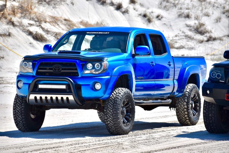

    6.5 Maxtrac suspension lift 275/70/18 Ridge Grapplers 18" XD Monsters Single in/Dual out Borla exhaust Spyder headlights/tailgates 8000k HID headlight/foglight bulbs Bull bar with 20" Opt7 light bar. K&N intake Throttle Body spacer Back Country running boards Pace Edwards electric bedcover Pioneer touch screen radio 2 kicker comp r 10" subs with 1200watt kicker amp.
    06 Prerunner. 6.5" Front. 4.5" rear. Maxtrac lift with a AAL.
