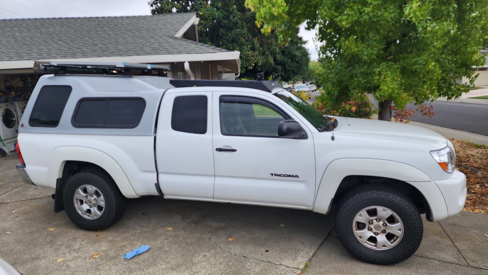

    Solar panels , how do you guys set it up on your tacoma . Specs etc. now why would I install a panel on my tacoma. I need a way to power my 12v freezer fridge 24/7 . Since it’s only me and my wife, I decided to just leave the fridge powered inside the cab. Here’s mine
    Renogy 220w 10BB solar panel
    Eco flow Delta2.
    So far I just lay the panel flat but I’m looking for a simpler way to tilt it if needed when stationary .

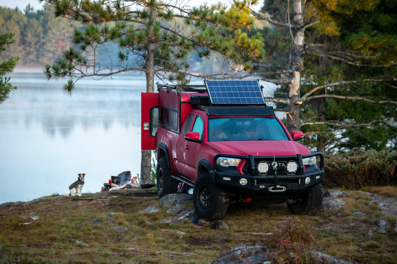

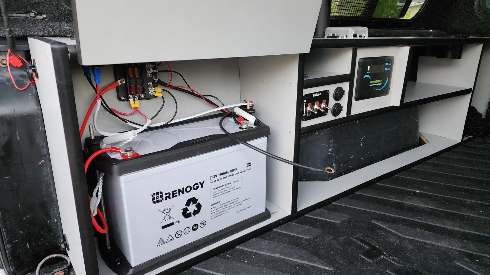

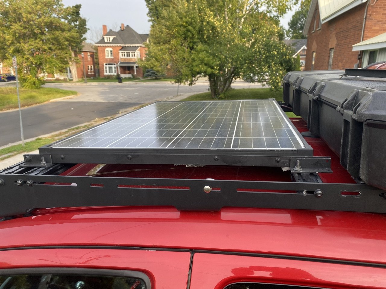

    I have 2 -100 watt panels on a dedicated 27 group AGM battery, the one on the camper stays flat recessed so I can still carry a canoe.
    The one on truck roof rack is tips up on a simple hinge made of aluminum angle .
    I run a 60 litre dual zone fridge /freezer and it has run all summer with the fridge set at + 2 Celsius and the Freezer at -9 Celsius ,both panels down.
    If I'm on a trip the freezer runs at -19 Celsius .

    Awesome set up. Is it ok for you to share how you rigged that tilting set up? Pics would be great. Awesome taco too. I’m slowly building mine but the end result will not be even close to yours :D . Thank you

    Here’s a couple photos

    Wow. Thank you. Why didn't I think of this. Thanks a lot

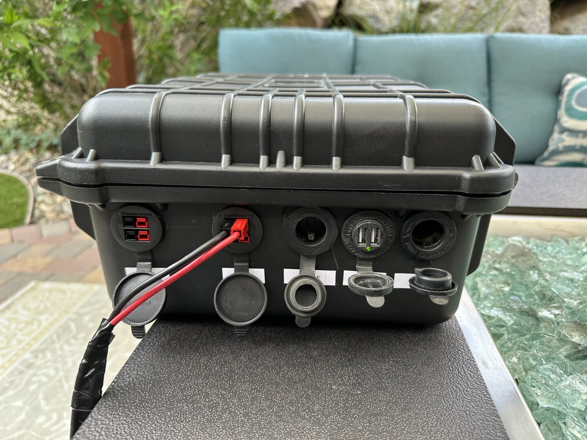

    Home made 50ah battery box with built in solar charge controller and dc to dc charger so I can charge off the truck when driving. Run a 140w folding panel which is more than enough to keep it topped off powering my fridge and electronics. I like having the battery and solar not connected to the truck so I can get the solar in the optimal spot and I can use the battery anywhere.
