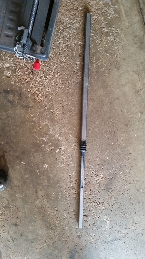

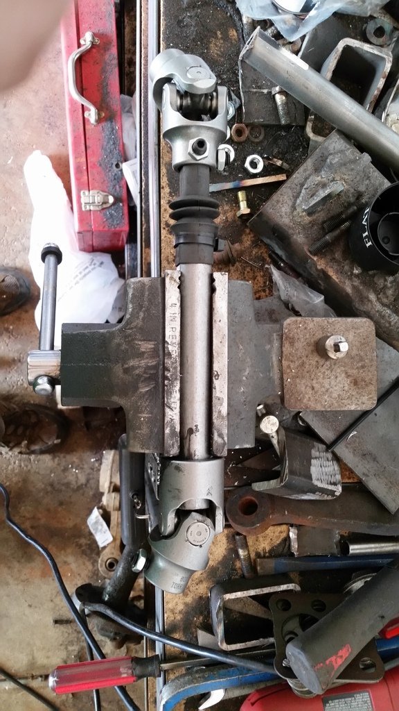

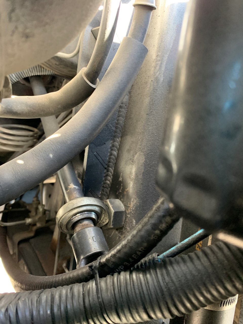

    Here are a few more. The threads were long going through the CO tower in regards to the Heim so I cut them as close as I could.

    This wasn't a kit.
    I bought a 4' shaft and joints. I cut/ welded after carefully measuring. The pain was the phasing of the 3 joints.

    Oh nice! Sorry was just thinking about the TG kits I have seen.

    Stay away from their kit... it's garbage.
    I did purchase that and the only thing I kept was the shaft IIRC.
    I sent their joints to another manufacturer back east that make joints for NASCAR... they simply laughed.

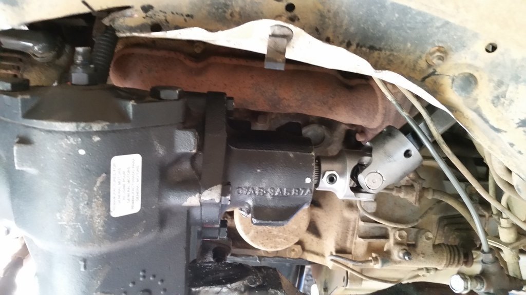

    I forgot what shaft this is.
    20160704_143817_zps2zhchiku_22fdd097ce9b683b9e9fb01ad8d7e4df83385680.jpg 20160704_153628_zpsjkhuiby8_547a498e0d970607f3b977b5f83241a9a76ab9be.jpg 20160704_150917_zpsbb4qz1ie_358571cdcb60f57ac0e43831a2104d030d70ac21.jpg 20160704_152458_zpsviyrhbbz_e3e2a413829a99746b9dd2e58d5414c3672848cf.jpg 20160704_150940_zpsszyvsyqs_68bc1d38033b1246550b77563b2c7bc9420eba28.jpg
    As you can see I had to clearence the ujoints for more range. That's a 1979 ford forward swing steering box.
