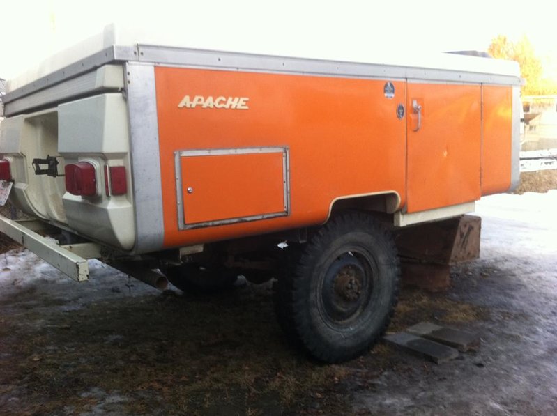

  4. Mar 29, 2012 at 5:00 PM
    BrewDawg
    BrewDawg Active Member
    Dec 11, 2011
    #68599
    31
    costal and rocky mountains Canada
    silver streak access
    classic APACHE hard wall tent trailer..under construction... adding truck camper jacks to stabilize and separate from trailer
