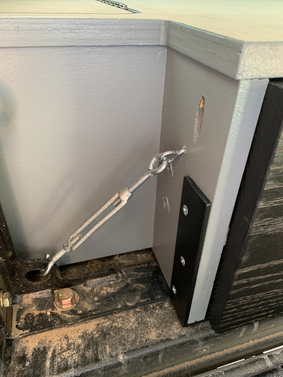

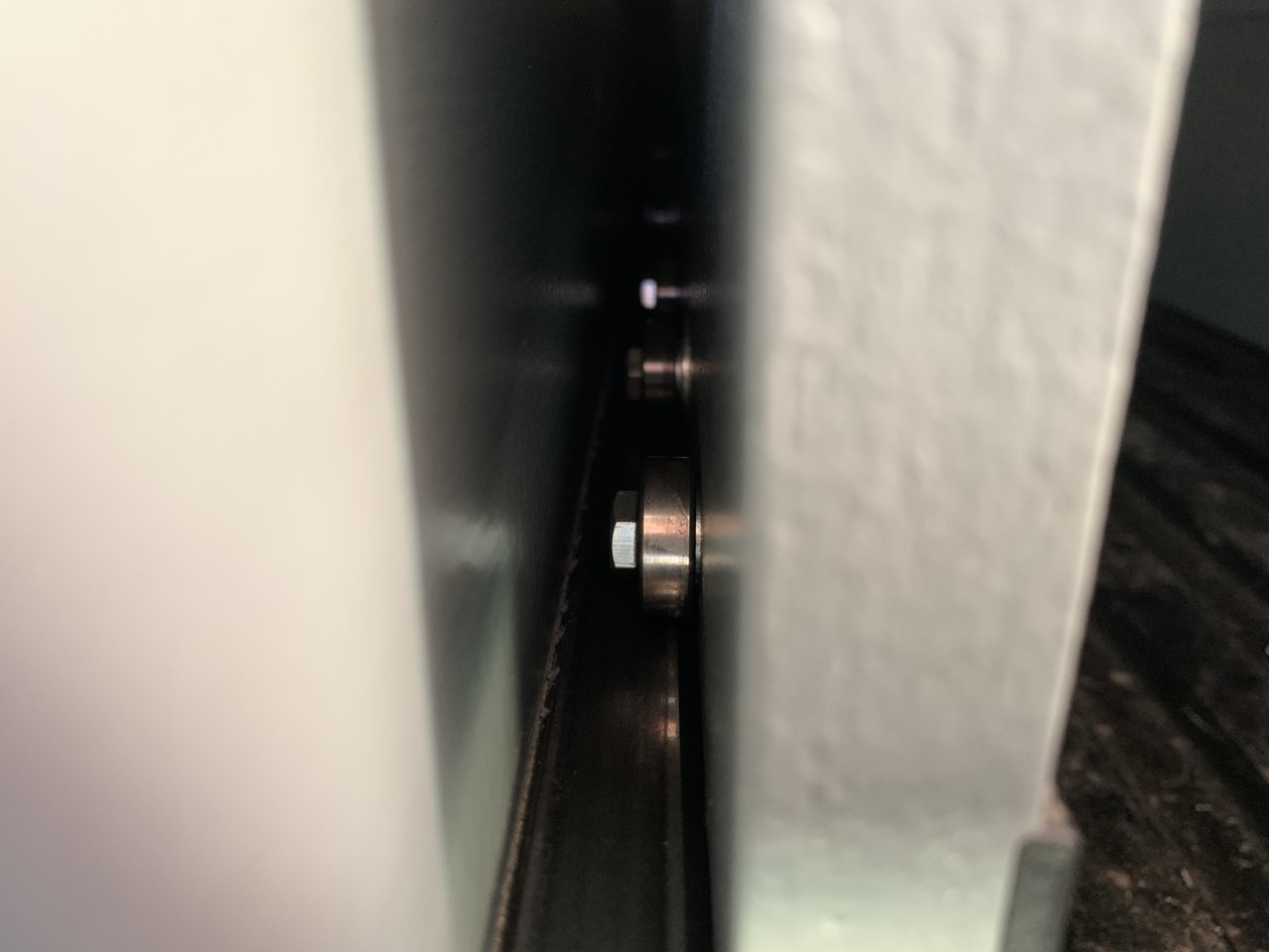

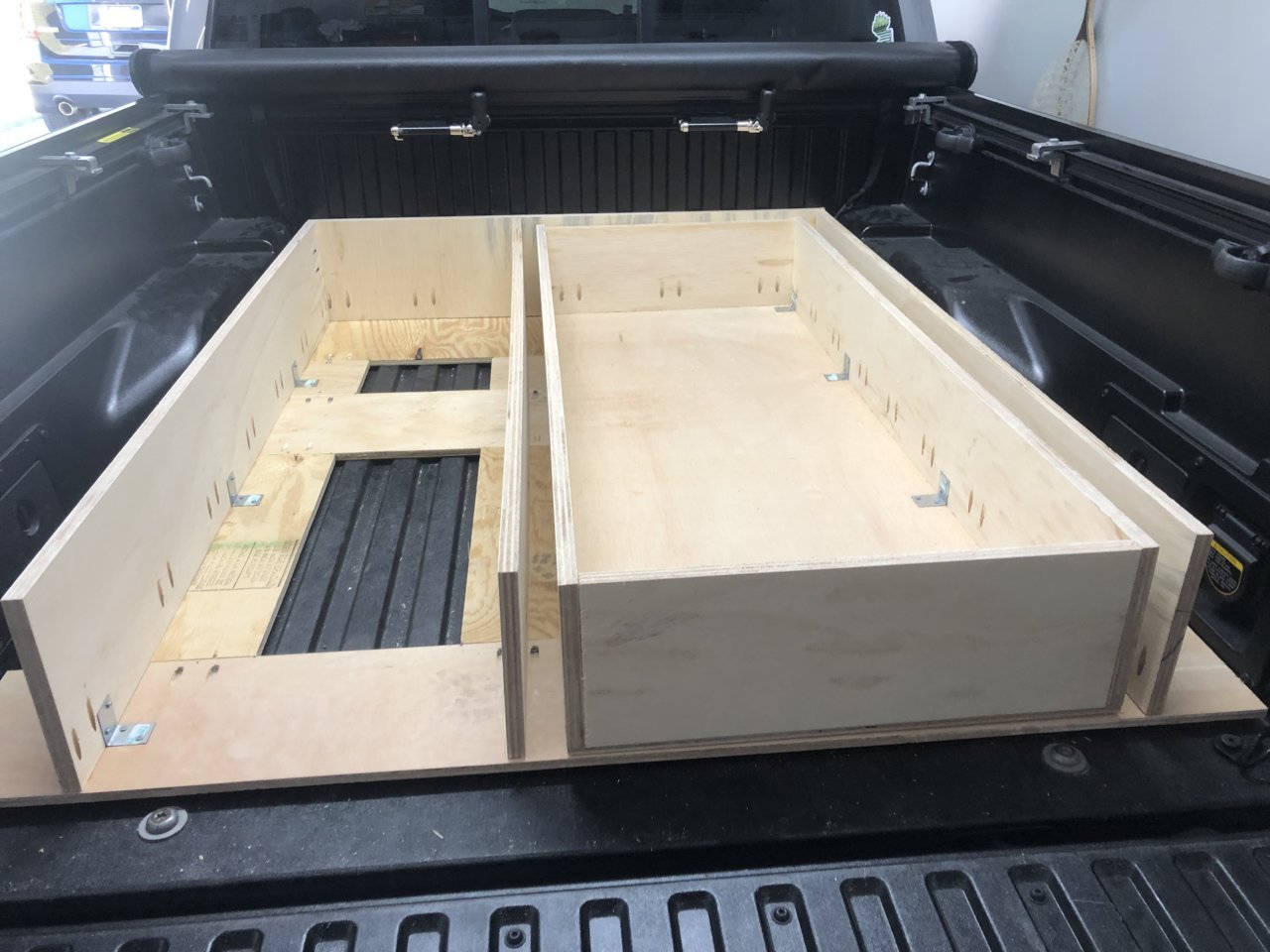

    I did a similar thing to many of the other diy full-length drawer slides out there using skateboard bearings bolted to the sides and steel tubing as the slides.
    Also, I used sande ply from home depot because it's what they had and is relatively lightweight per sheet compared to birch ply. It's supposed to be better for applications where it would potentially get wet but I chose to prime and paint it all to be safe.
    I don't have plans because I hate using cad software lol, but I uploaded a bunch of photos for you!

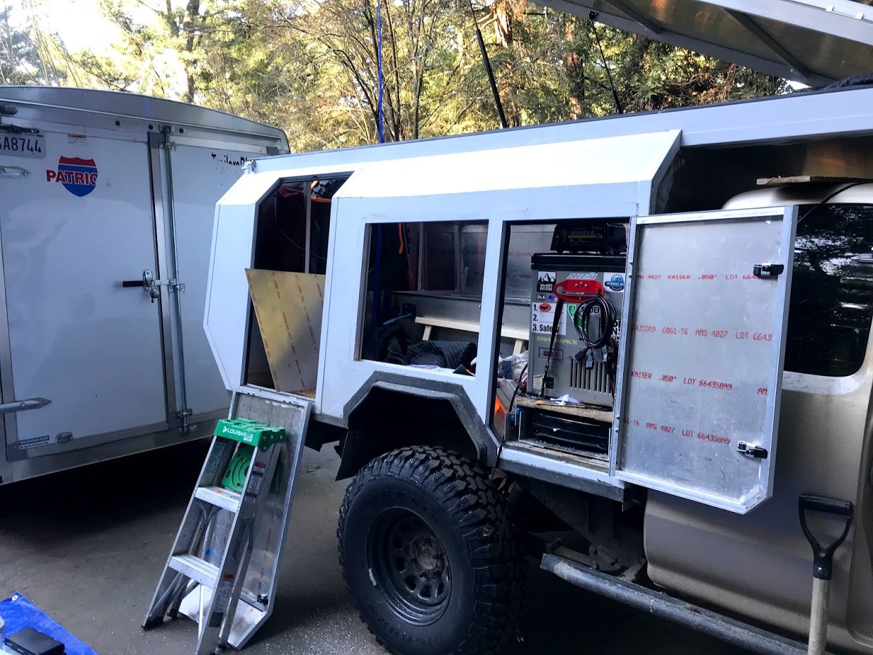

    It's not a 2nd gen and it's not quite done.
    That middle hole is gonna have a door on it eventually and shelves in a cabinet to serve as a kitchen. The door will open downward so it can be used as a work surface.
    The fridge slide has a slide under it with the stove on it.
    The step ladder is going to be replaced with steps built into the door. And a tent needs to be made for the pop top.
    And lots and lots of other things.

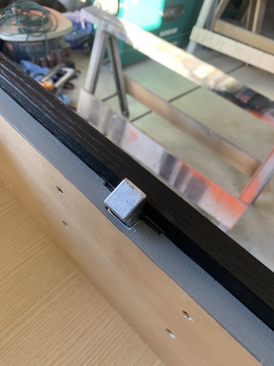

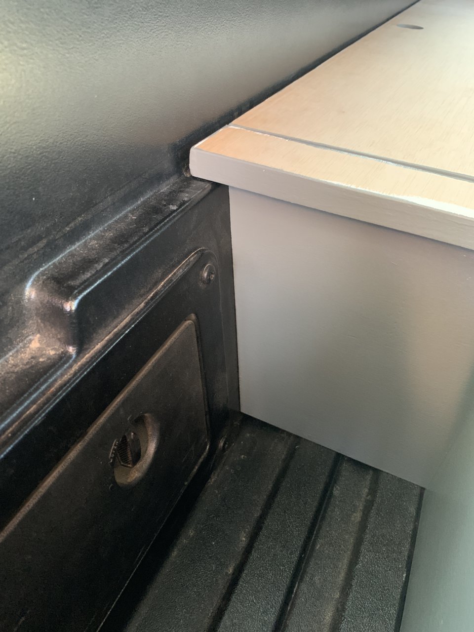

    This is great! Thank you. I can’t really tell what I’m looking at on pic 6. Is that a latch to keep the drawer closed?

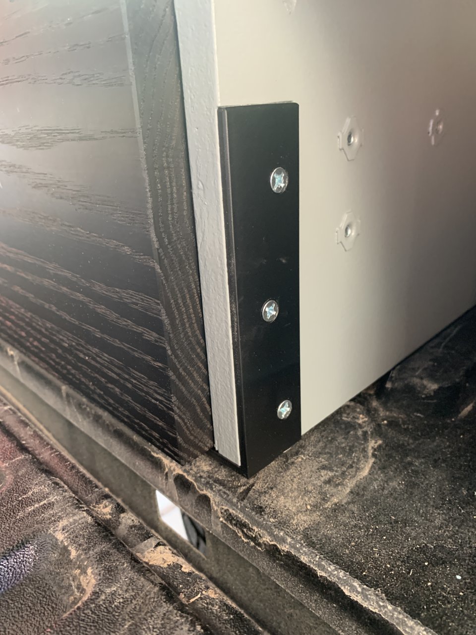

    The corners, was that for reinforcement? Did you also bolt them(the corners) to the bed? I also have the TC bed stiffeners so I will be anchoring to them as well.
    Just out of curiosity what was your final cost? I am ball parking everything for my purchases next month. I will be sealing the wood and then just throwing my bed mat on top.
    Thanks again! These photos are helpful.
    -M

    Yeah, that's the inside of the latch and how clean I got it to sit in the plywood when the drawer face was installed. The metal bracket I made for the bottom of the drawer frame was so that I could eliminate the need for plywood on the bottom to keep the maximum amount of storage height as possible. I only needed to do this in the front since the back is boxed in with plywood.

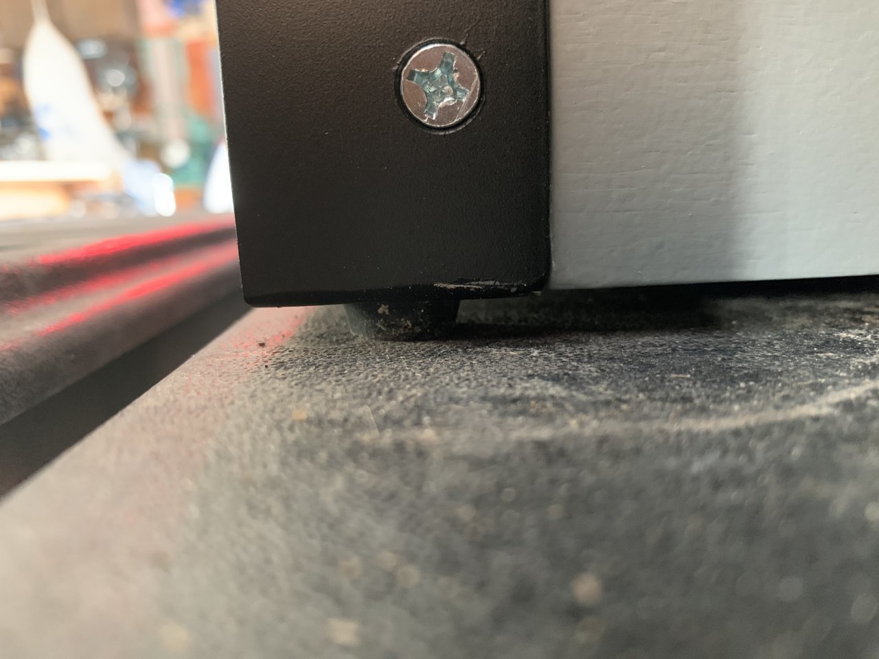

    I used several rubber feet (last photo) on the bottom of the whole thing to keep it raised from the truck bed surface so that if water gets in it will flow under it all instead of soaking in.
    I'm not entirely sure what my total cost is of materials but I would guess around $300.

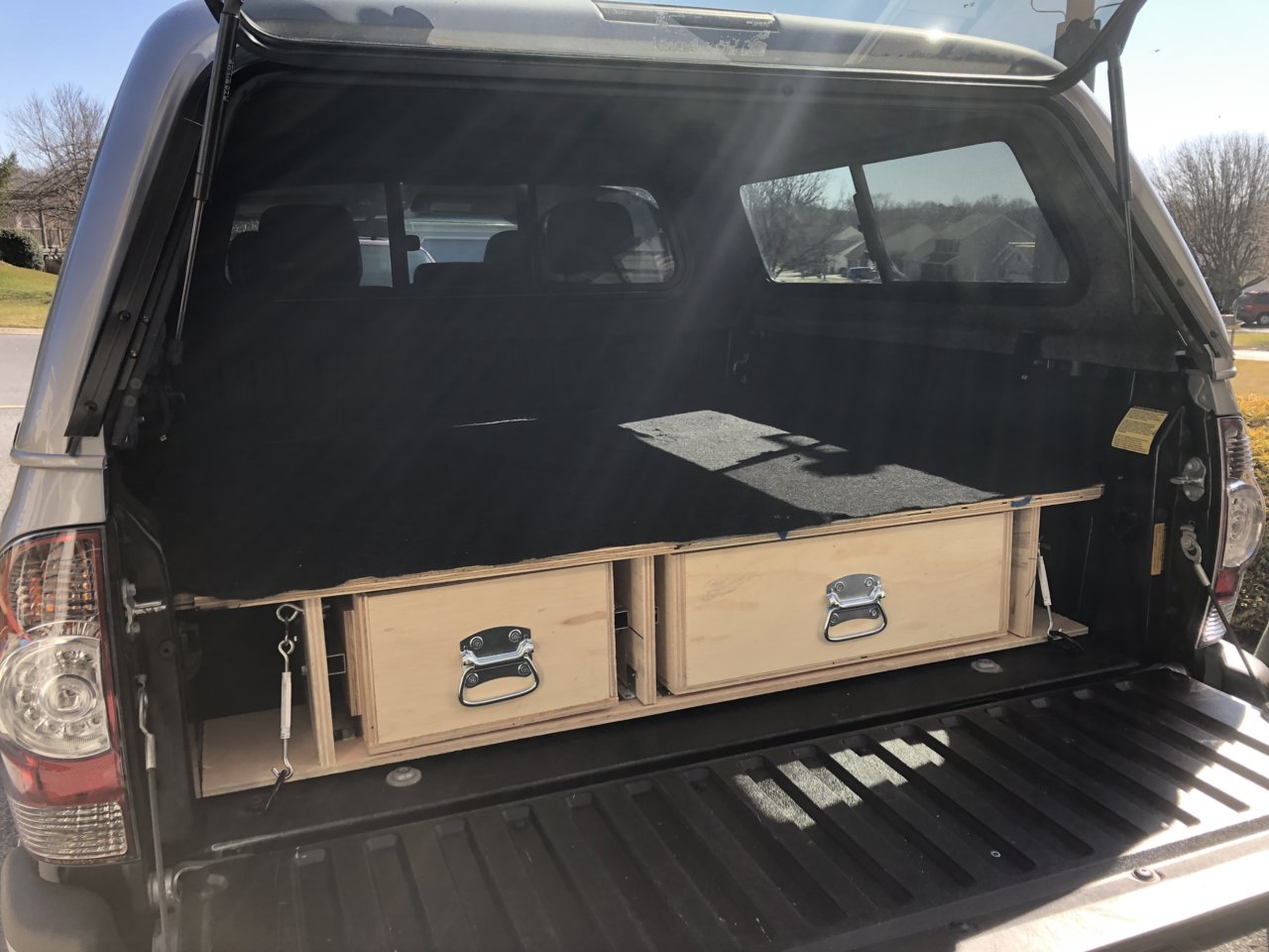

    My dual drawer system is coming together. ARE cap is being built now. Should be done by the middle of March. I’m looking forward to the finished product.

    Still need to carpet the drawers and top platform but it’s usable!
