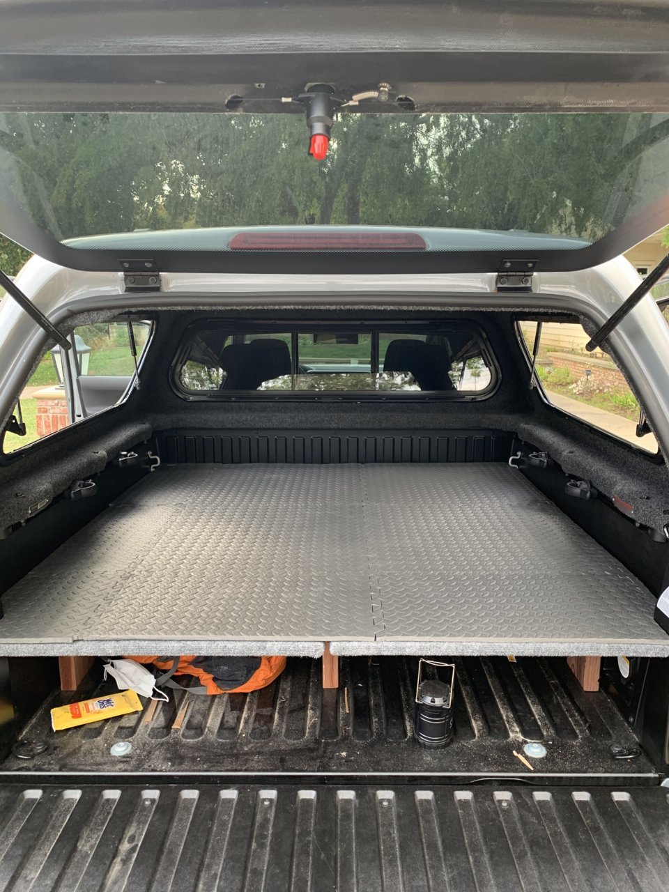

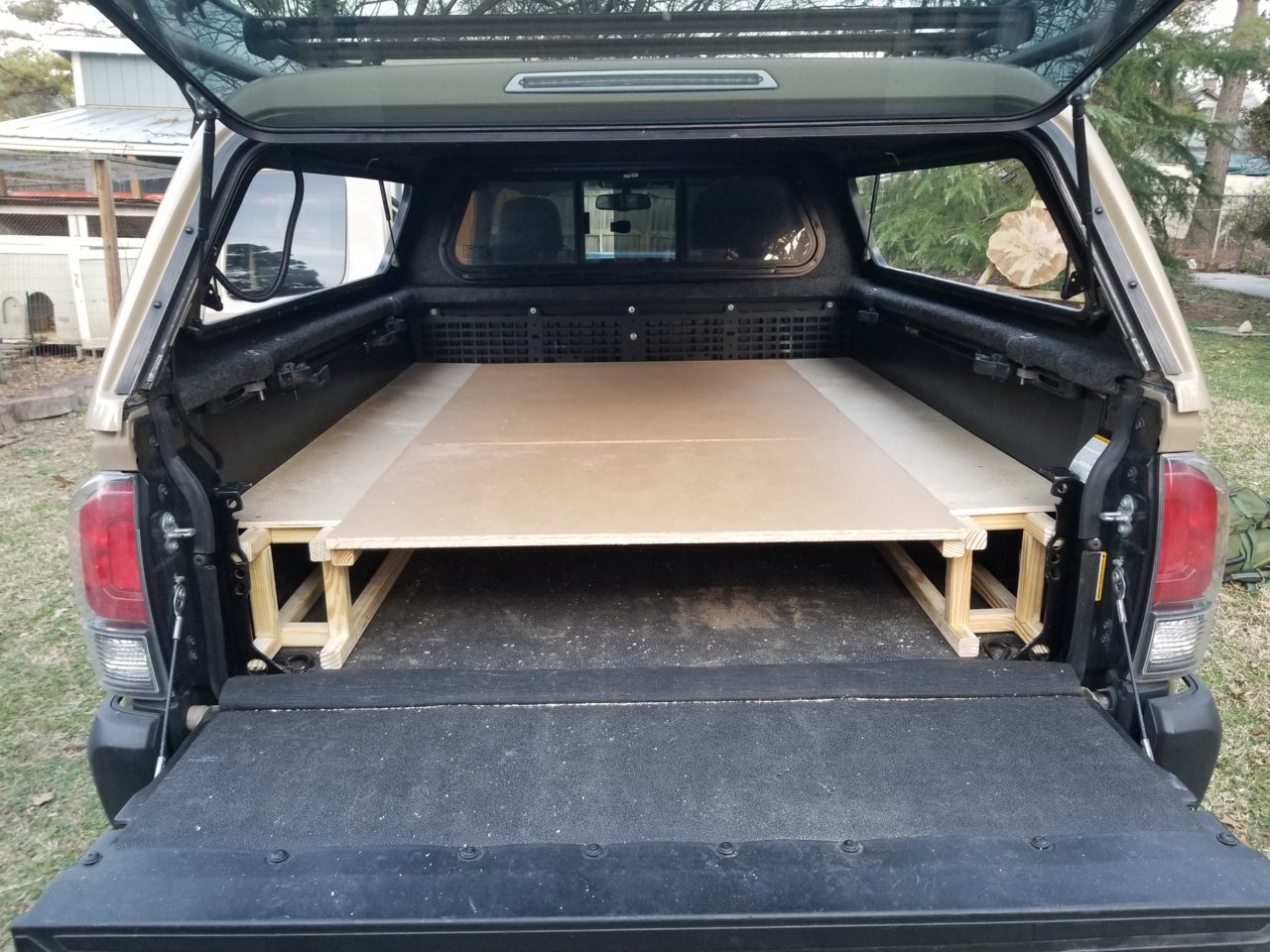

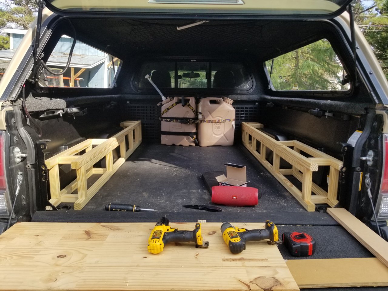

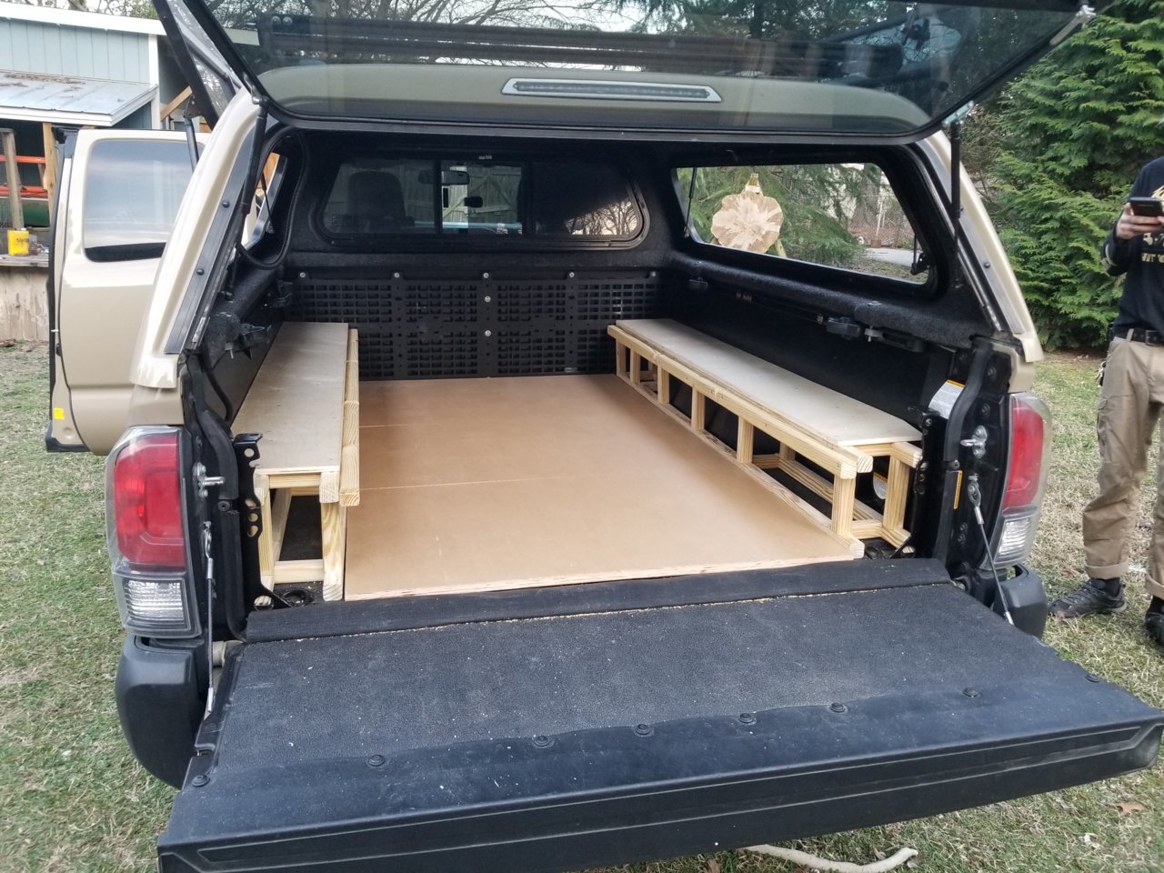

    Here's what I ended up going with. I'll probably tweak and change it down the road but I wanted to start off with something simple, cheap, & removable. Build time was only about 2hrs (most of that being measuring) and about $150 in supplies from Home Depot. I want to say all the ideas I probably got from this thread.
    After a couple of months with this setup here's my general thoughts on having a cap/platform combo. This is all pretty obvious to those of you already with caps/platforms but find it might be helpful for someone curious about doing a setup like mine.
    -Install/removal. I can remove or install the platform easily within 90 seconds (have to go in through the side doors), with the platform extension added/removed in an additional 30.
    -Security. I can keep camping/shooting stuff under the platform away from prying eyes. The tailgate & cap locks are obviously pretty easy to break into (locks only keep honest people honest) but are better than an open bed for obvious reasons. Fortunately I live in an area where I don't have to really worry about smash n' grabs and work in a gated facility with people I trust.
    -Organization. Currently I've just been using 2 simple duffels (1 for sleeping bag, 1 for misc camping stuff), and 2 Pelican cases (shooting stuff, misc vehicle/breakdown stuff) but it's worked out well. Easy enough to access things when I need them & remove everything if I'm gone more than a night or 2 from the truck (which is common for me). Originally I was going to add drawers but I like having an undivided bottom part for now and being able to easily unpack everything.
    -Comfort/weather proofing. As someone who's 6'4, I have no regrets sticking with the 5ft bed. If it's just me in the truck I can sleep diagonally and *barely* fit if it's pouring or I want to "stealth" camp, or pop open the back & extension with a tarp or mosquito blanket if it's nice out. I added some 550 cord tie-downs to the side windoors & back hatch so that when I want to sleep with them open I can have a downward angle for rain runoff (haven't tested yet). For the windoors I cut screen material that I just tape in place with one-wrap velcro strips. I can have add the extension, set up the bed, and add the screens and tarp in about 3 mins. The carpet is nice for the clean/sleeping area and helps with noise reduction/tight fit. The extension stores easily & also can be used for more comfortable tailgate seating. I might find some plastic material for the under side of the extension to use as a camp kitchen/prep table that cleans easily.

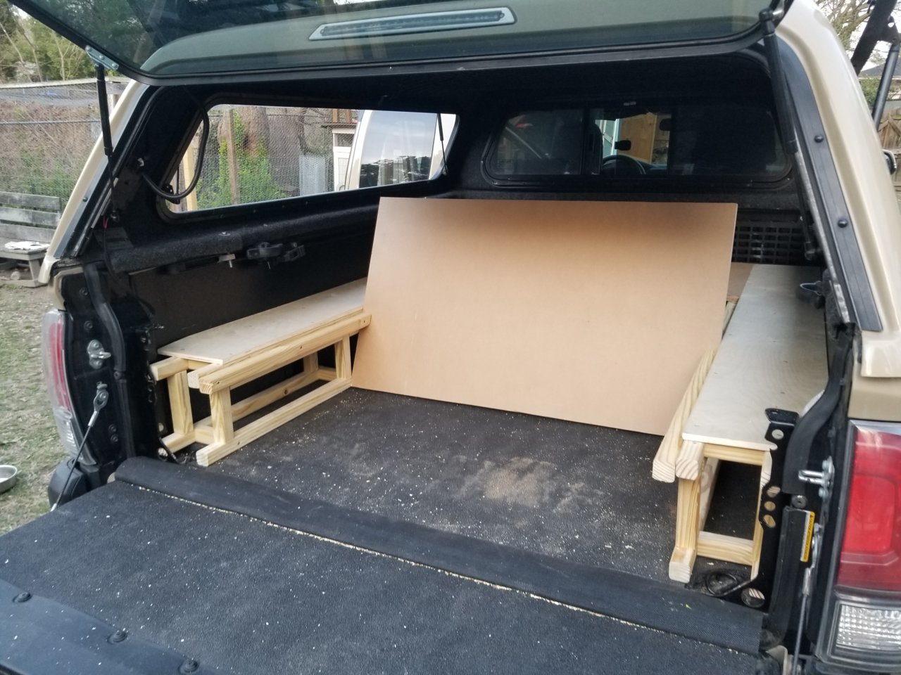

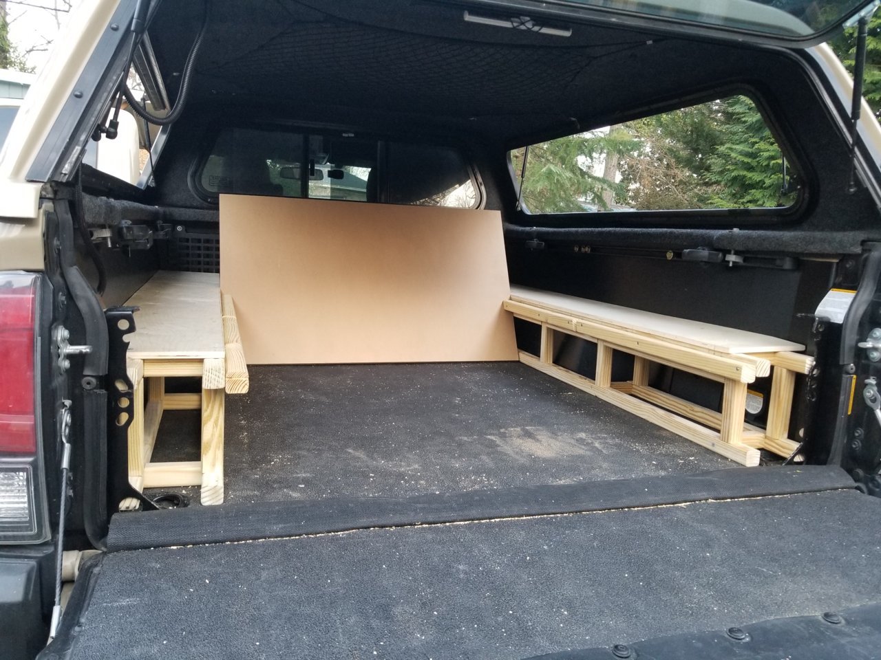

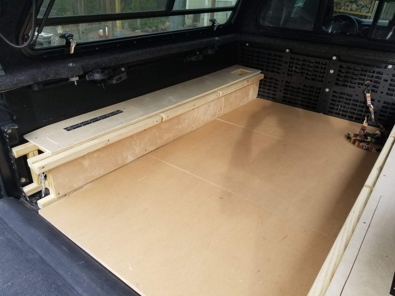

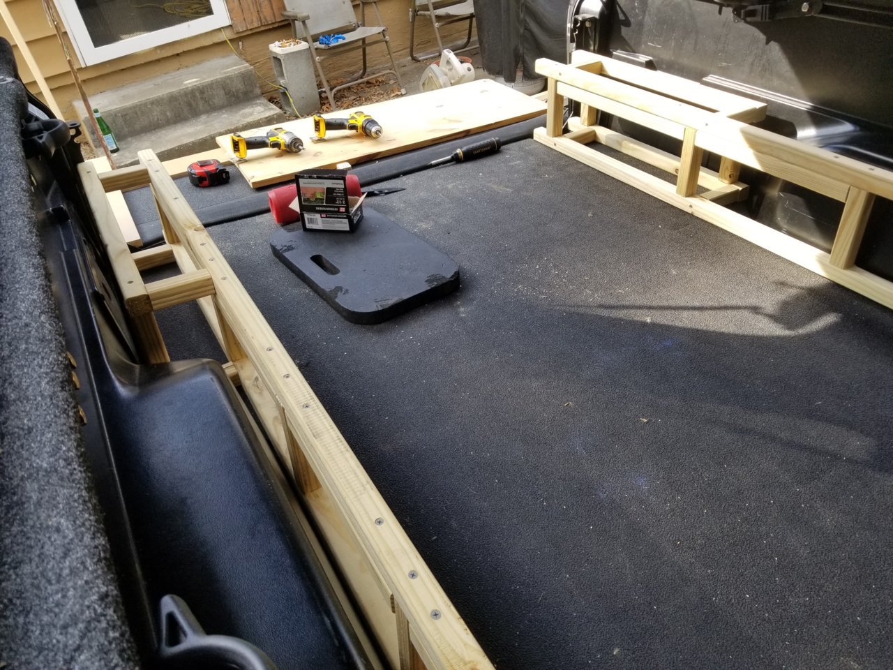

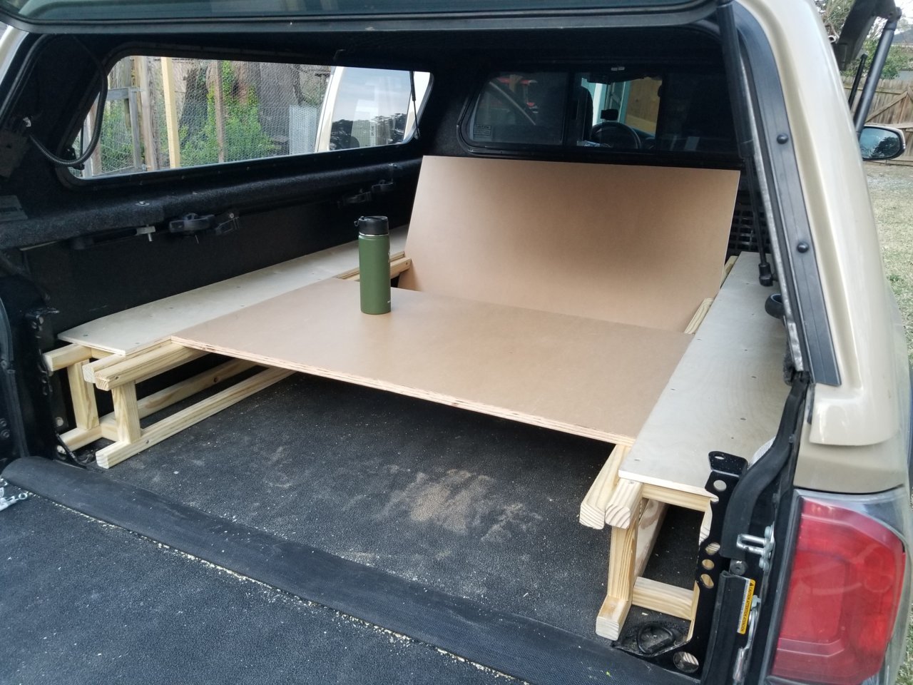

    Sneaking onto the 2nd gen section to post in this thread..
    I was originally going to build the "old school camper" like a few people on here have done, but out of 1" t slot aluminum from 8020.
    After debating the accuracy of my measurements, I decided to try it out of 1" treated wood (which I already had sitting in my shed) first, to avoid messing up measurements and wasting money if I got it wrong for the aluminum.
    This is as far as I've gotten. Probably going to use 1/2" MDO to cover the sides, and 3 sections of 3/4" MDO for the center platform.
    POOLGUY and crashngiggles like this.

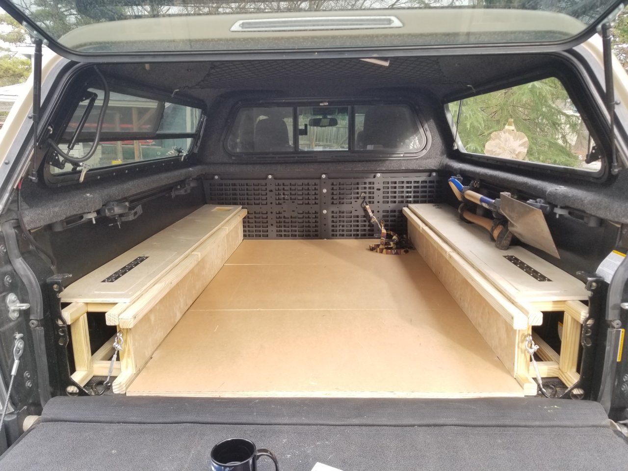

    Made some more progress today. Still need to cut access doors on the top of the side sections, put in eyelets to attach turnbuckles to the tie down points, maybe do a few cup holders, panel the open sections on the sides, and seal everything.
    Debating on whether I should carpet it or not. I feel like the edges might just get torn up with all the sliding pieces going in and out.

    Cut in some little doors to access the cubbies and tie down points and notched the passenger side top panel to fit my quickfist mounts.
    Just need to seal everything and it should be done.

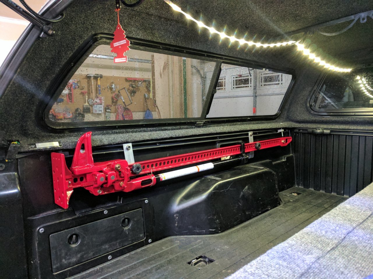

    Does anybody in here run bedside hi lift Jack/shovel mounts with a sleeper set up?

    yeos
    yeos OCD Member
    Feb 24, 2013
    #98297
    1,221
    Moses Lake, WA
    2007 Lexus GX
    I did before I sold the platform to you.

    ACLB 6 SPEED: Suspension: Bilstein 6112s (3rd perch) (F) Taco Lean Spacer Bilstein 5160s (R) TSB Leaf Pack Wheelers Offroad 3 leaf progressive AAL Wheelers Superbump Front Duro Bump U bolt flip kit Duro Bump progressive bump stop 3rd gen TRD offroad sway bar Wheels and Tires: Summit Racing Wheel Dakars (Polished Silver) 285/70r/17 Goodyear Wrangler Duratrax (Load D) "Performance": AFE CAI with custom powdercoated white filter cover MagnaFlow Performance Series Exhaust URD Cam gears XTP Intake Manifold Spacer OTT Torque Tune Brakes: Stoptech Slotted Rotors Stoptech Sport Ultra Composite Brake Pads Wheelers offroad SS brakelines (Front) Interior: Kenwood DD headunit Oem Subaru Kicker Tweeters Alpine 6x9 (Front) & 6.5 (rear) (With Taco tunes speaker mounts) Alpine 500 watt amp Sound Deadening (Doors, Rear "wall", Roof) ODI Rouge Shift Knob Weather Tech Mats Painted/wrapped trim pieces Console Safe Console Vault Gridx Organizer Ram Phone Mount Meso Customs dual color map lights Meso Customs dual color dome light Wet Okole seat covers (Black) Wet Okole center console cover (Black) 1" Seat Raisers (Driver & Passenger) AJT Designs climate control and 4x4 knobs Back Up Camera Lighting: Retrofits (Mini H1's, RGB Halos, 5500k Bulbs)(Lenses wrapped in self healing PPF) Diode Dynamics SS3 Max SAE (Yellow) Diode Dynamics SS5 Pro (Yellow) Driving lights (ditch lights) Anytime fog mod Rigid Industries E series 32" Combo bar (spot/flood) Diode Dynamics XPR Reverse Lights Diode Dynamics XP80 turn signals LED brake, parking lights and license plate lights Armor: Apex All Pro sliders BPF steel skid plate Bigass Trailer Hitch Camping/Storage: Leer canopy LED interior lighting Sleeping platform (Storage underneath) Removable snowboard Yakima mounts Extra D rings in bed (6 total) Custom Powder coated white snow shovel with custom bedrail mounts Amazon special Traction Boards Hi Lift 48" Jack with custom Rail mounts to accommodate my sleeper set up Other: All pro Bed Stiffeners Relentless Fab tailgate panel TRD sport graphics (Turd Gen spec) Anti Sun glare hood scoop wrap (Satin Black) Custom FleeBay grille 4 Hella supertones ECGS needle bearing Many Patches BPF shackle mount (With smittybuilt shackle) Tinted windows (Front/Rear + Full canopy)(18%) Meso Customs gasshole AVS inchannel window visors Diff Breather Kit 2012-2015 Oem Turn signal/folding mirrors (w/ sequential signals) 2012-2015 Oem LED taillights Full Size (285/70r17) spare DIY Larger Engine Splash Guards DIY Vipercut TRD radiator cap
    And everything fit? Shit I need the info for those mounts lol

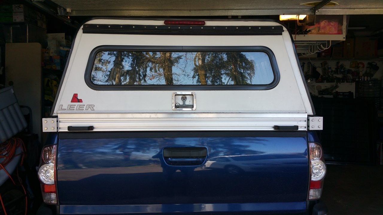

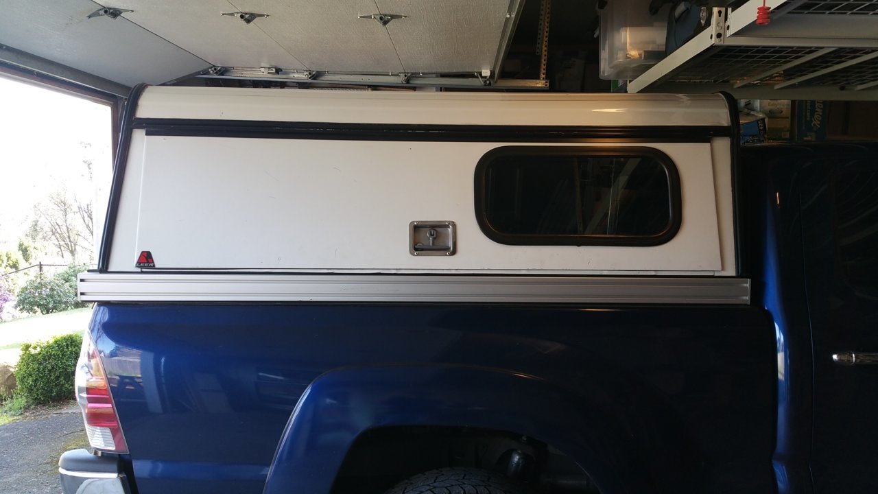

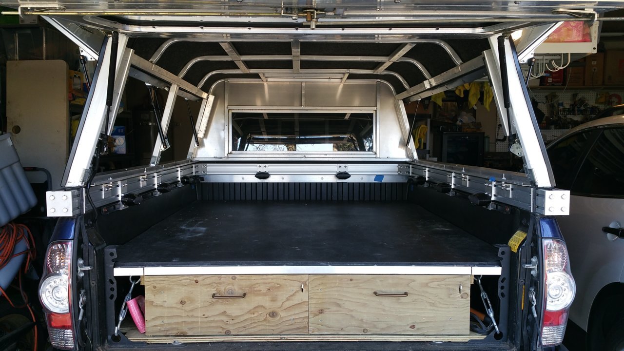

    couple months ago i added some 3030 to give some extra height to the Leer DCC. Works great so far

    Interesting. Do you have a side photo? There must be a gap above the tailgate right?

    4,927
    MGM 09 AC 4WD V6 TRD-OR w/ Tradesman Shell
    Just the basics
    Not me. My hilift is underneath the drivers side wrapped in a moving blanket. I don't want to sleep with it by my side.

    sure, just used some aluminum angle/c channel/1.5x3L to close the gap + some more angle alum w/ weatherstripping to keep the water out. For everything between the bed rails and 8020 i used a heavy duty bulb seal, cut down in half, and inserted into the 8020 channel. Does a great job of keeping the water out. Only a couple small leaks i'm hunting now. It took a bit to get to that point though lol
