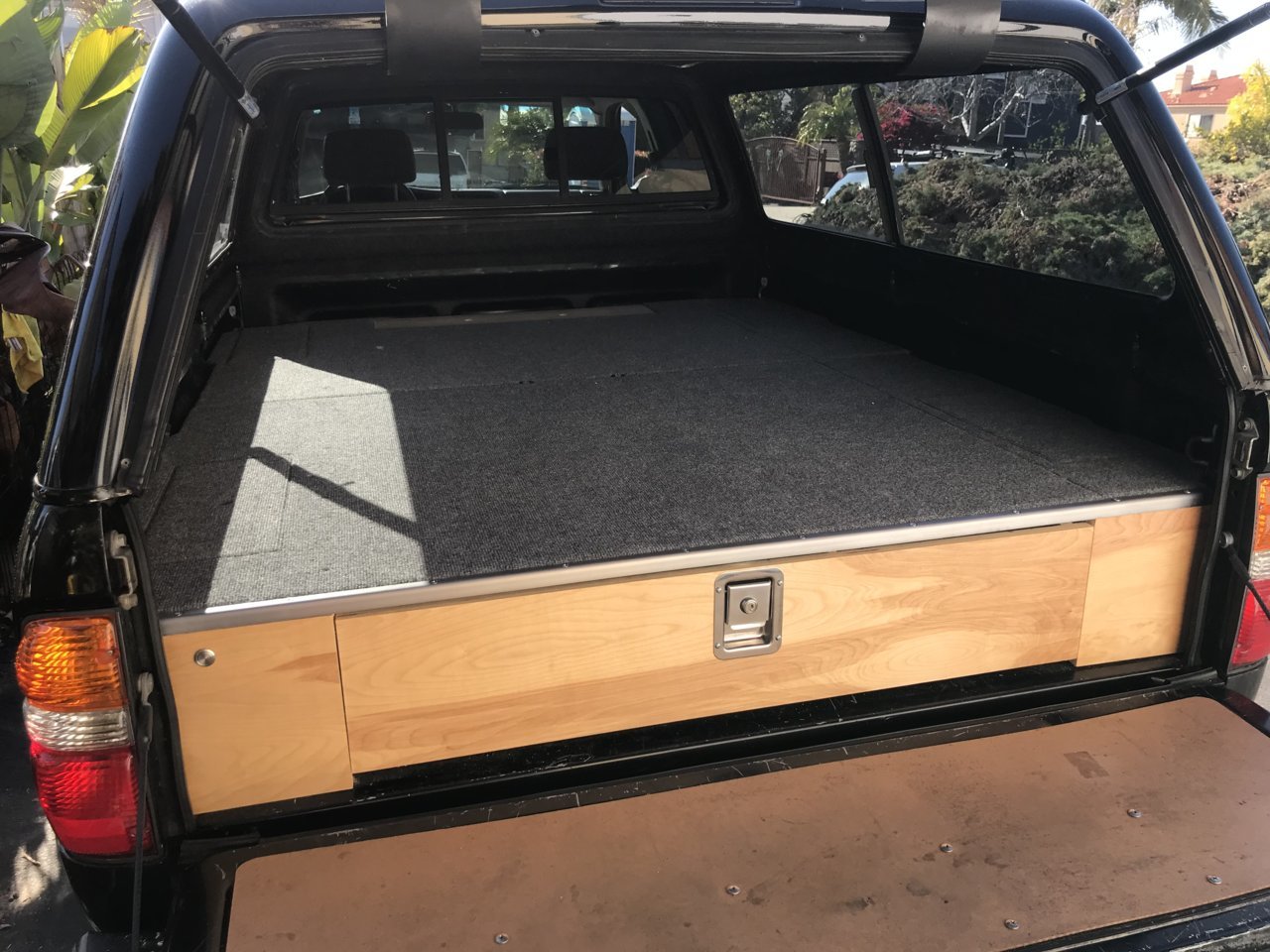

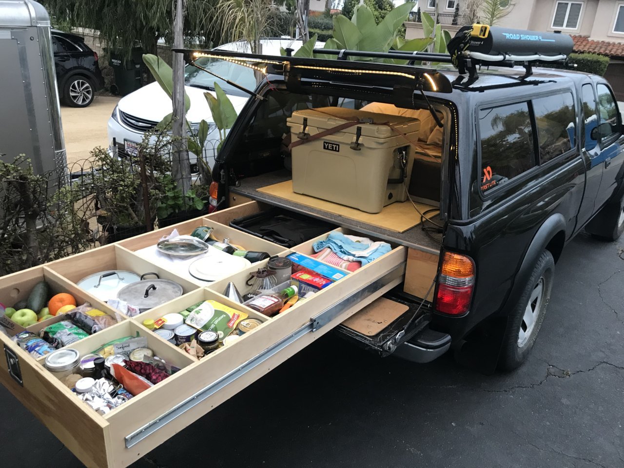

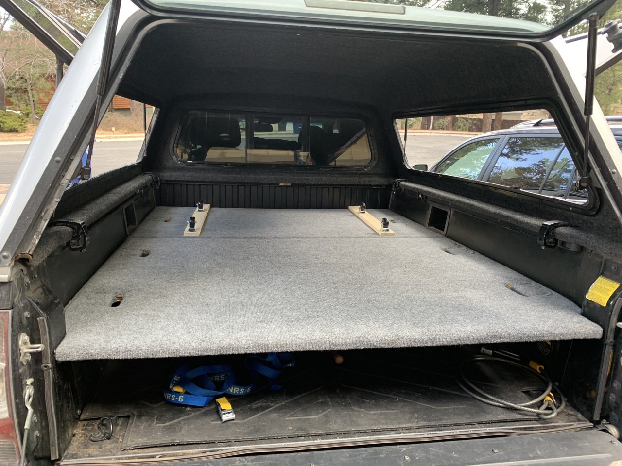

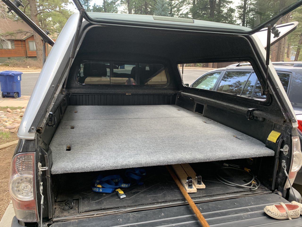

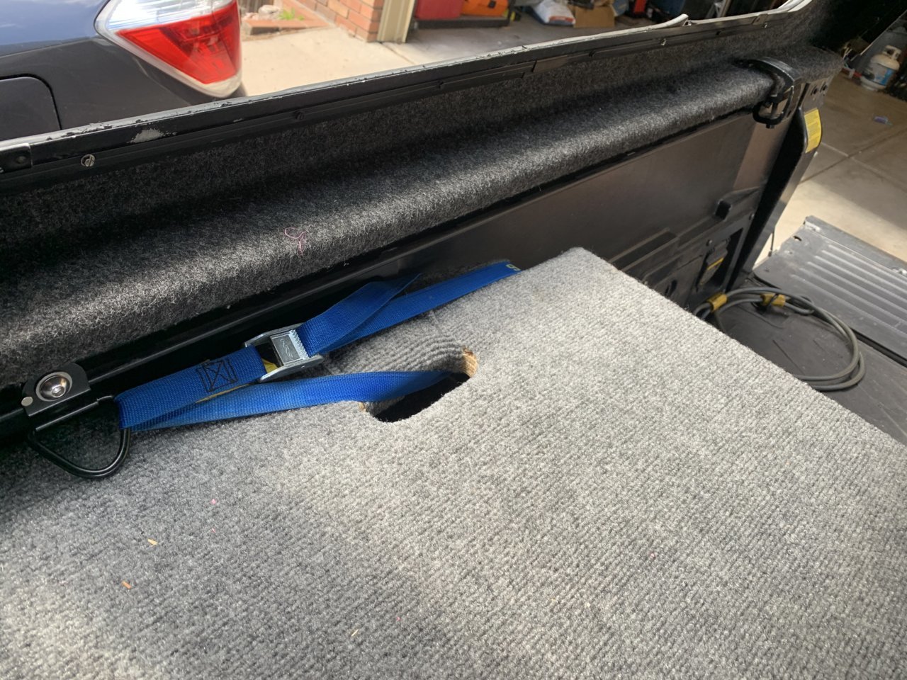

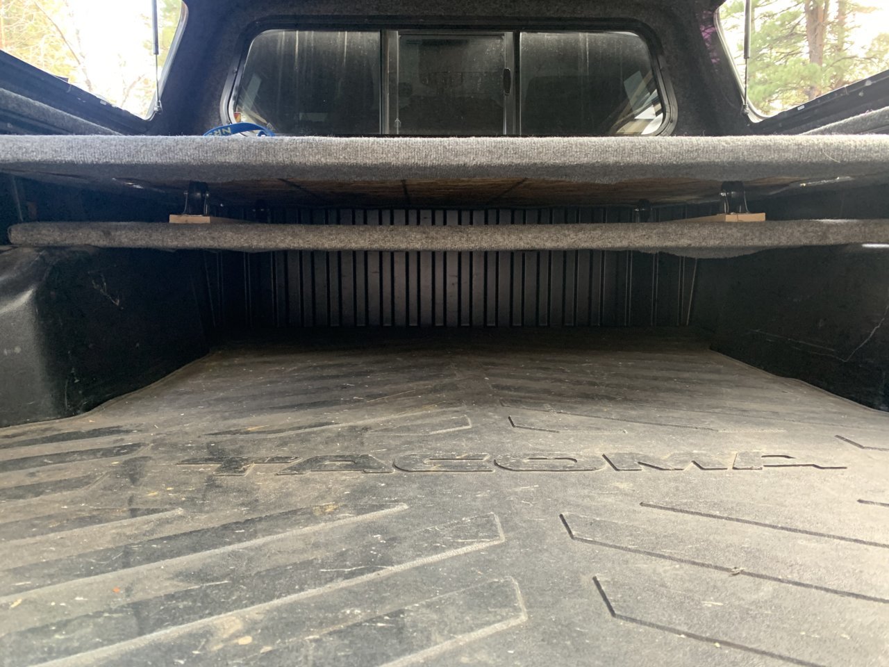

    So grateful for this thread. Here's what mine ended up looking like. We've taken it all over the western US. If I had to do it again I would probably get a taller shell. Otherwise it's been amazing.

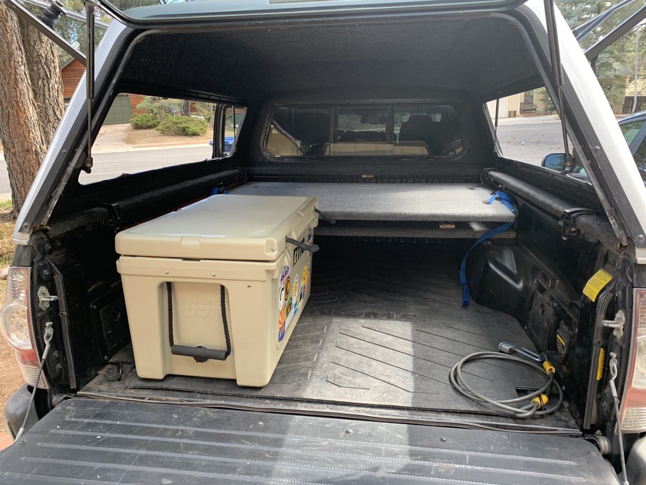

    I built my platform with a transverse split so I could create more room in the bed of the truck. Bringing some firewood wouldn't be a problem.
    Works well for me. Simple and I really like the functionally of the setup.

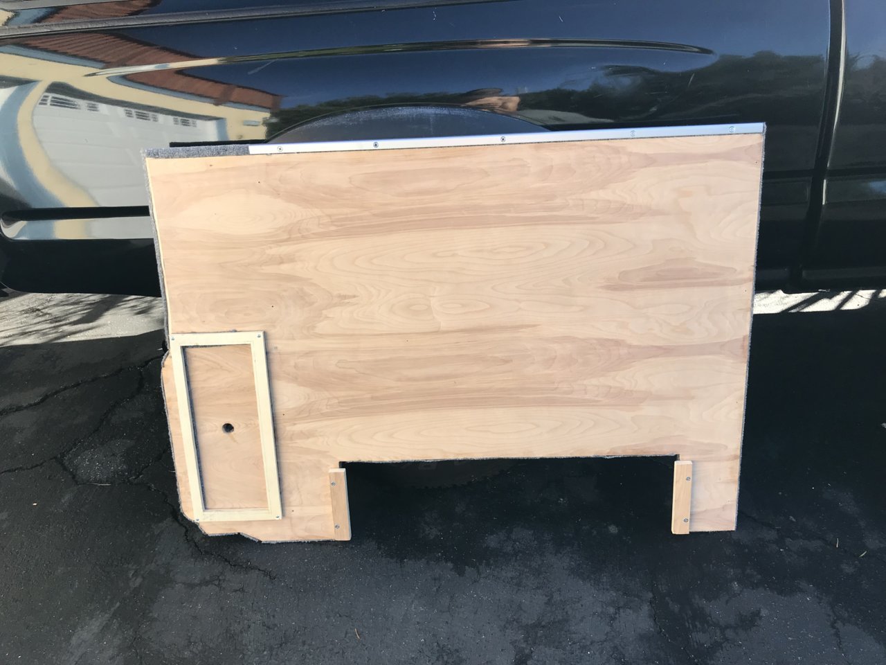

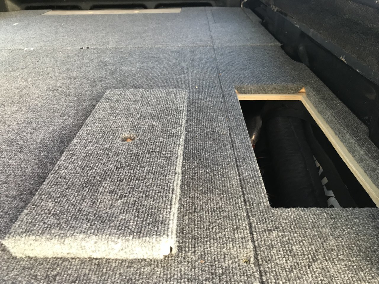

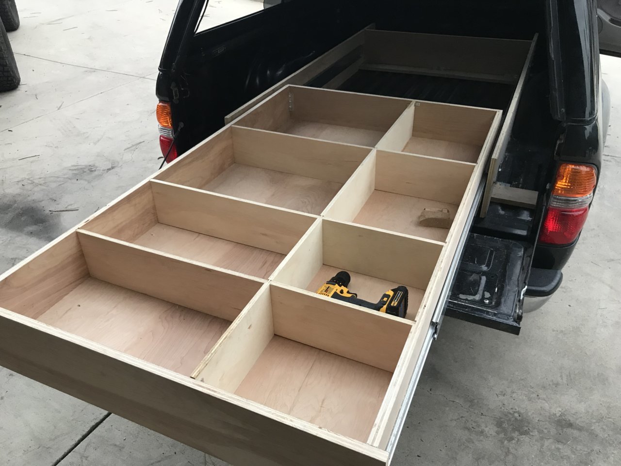

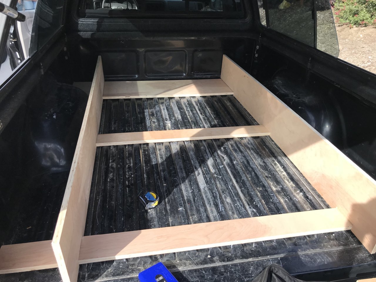

    No but here's a couple more of the build. The sliders I used are 60" and rated for 500#. They weren't cheap but they were worth it.

    Those pictures are helpful! Where did you get the sliders? Also you didn’t do any addition cross members over the large drawer, do you have any flex?

    Here's the sliders. I realized they're actually rated to carry 500#.
    https://www.amazon.com/Drawer-Slide-Extension-Heavy-Capacity/dp/B0096E92XC

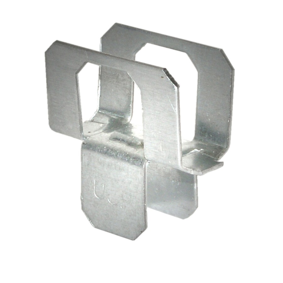

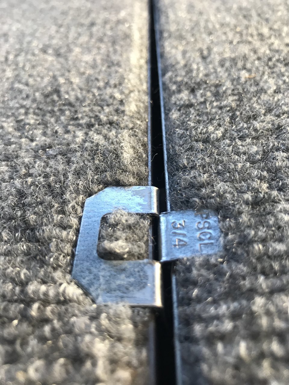

    You mean cross member to support the plywood deck? I used 3/4" birch and added steel edges to the plywood (on the bottom so hard to see) for rigidity and the thing that actually helped the most are these H profile brackets that hold the 2 sheets of plywood together. They are very effective! There is almost 0 flex now.
