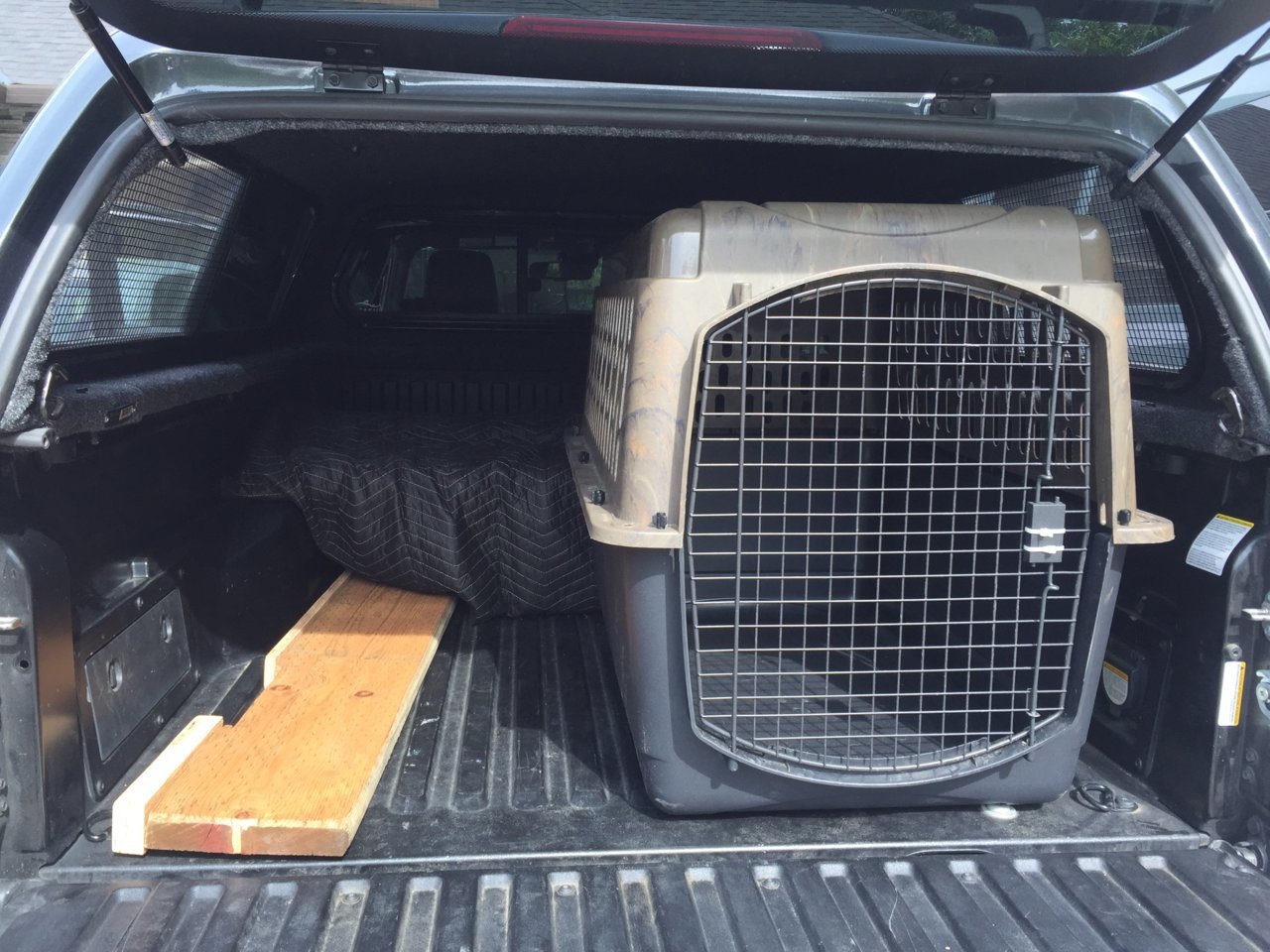

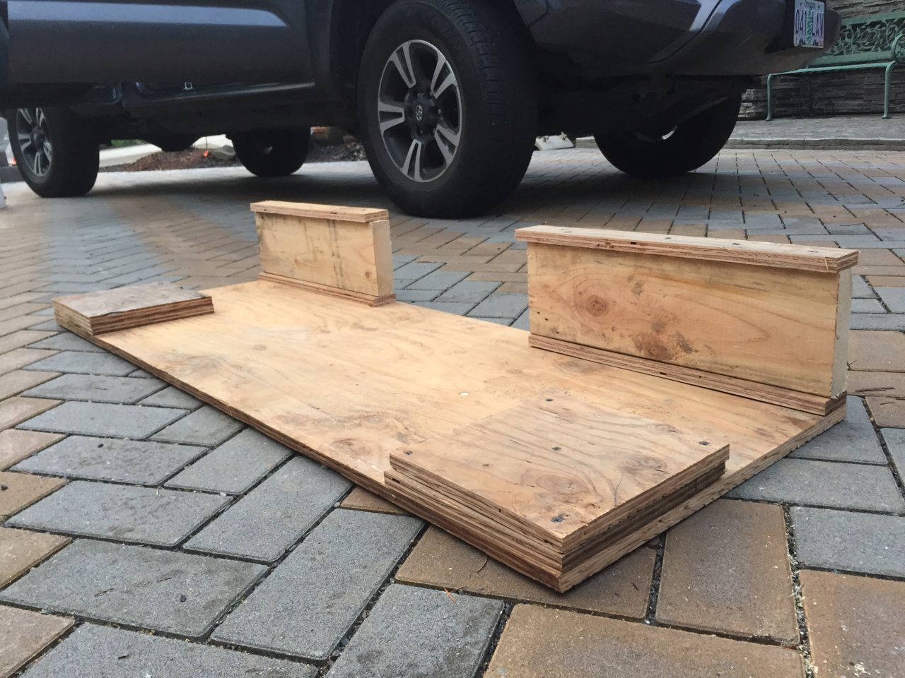

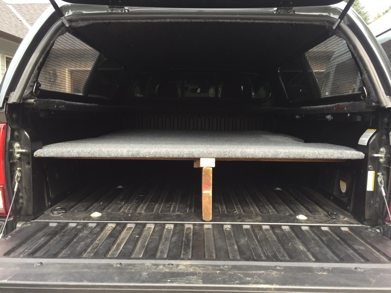

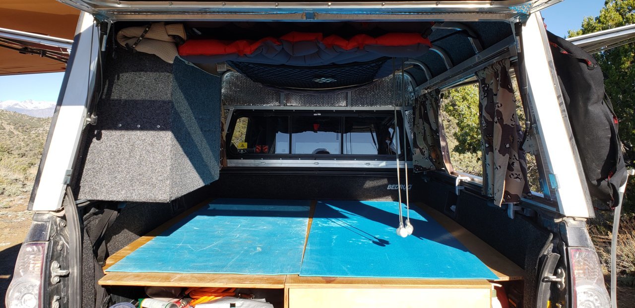

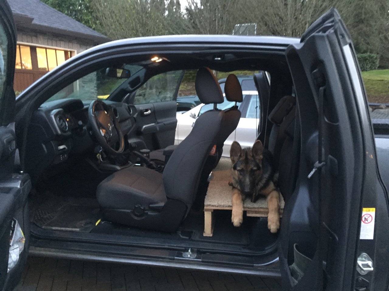

    @Paddlinpilot I built a dog platform inside my access cab - sleeps a big GSD pup fine (he’s much bigger than photo now and still fits comfortably):

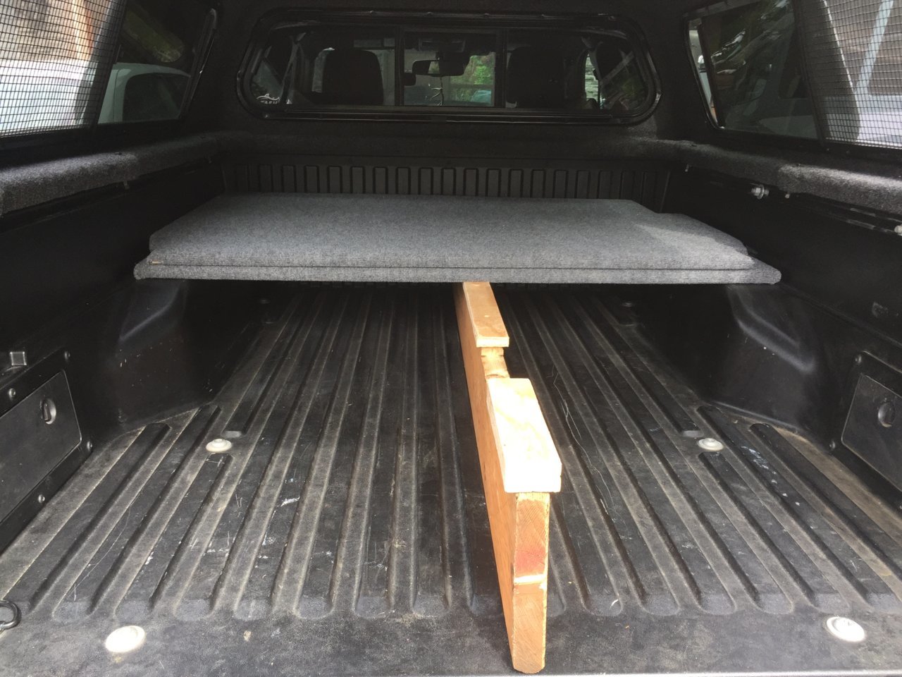

    My platform in the shell is modular, so you can just stack the back panel on the front for your dogs to sleep on and keep the back open if that’s what you want (center support is only really needed when it’s 2 hoomans plus dog). Just 2 cross support boards, 1 center support board, and 2 plywood panels - none of the parts are screwed/bolted together so easy to change the arrangement and deploy/tear down. Last photo shows the 2 panels stacked up front under a moving blanket and no need for center support. Pup either sleeps in his crate outside or with us, he’s still too drivey to trust alone without the crate:
    37227A64-CAEE-40AC-82F9-B2A9FFED95C4.jpgEB6399FE-6697-464B-98D9-88A7A8B14AFF.jpg4D01999E-0FB0-43A1-B72D-8B3FB3EB1CAA.jpg

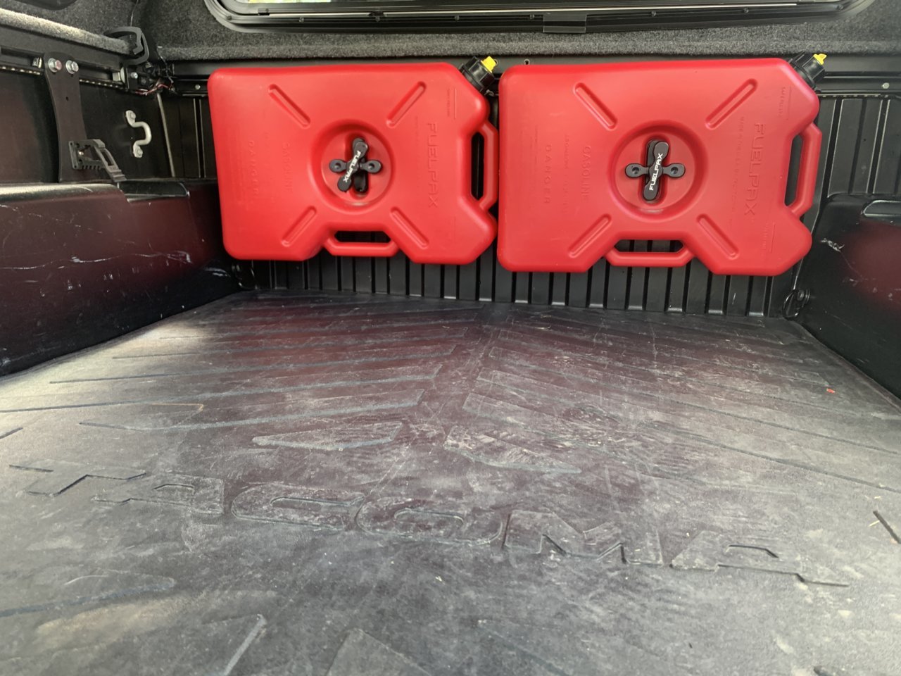

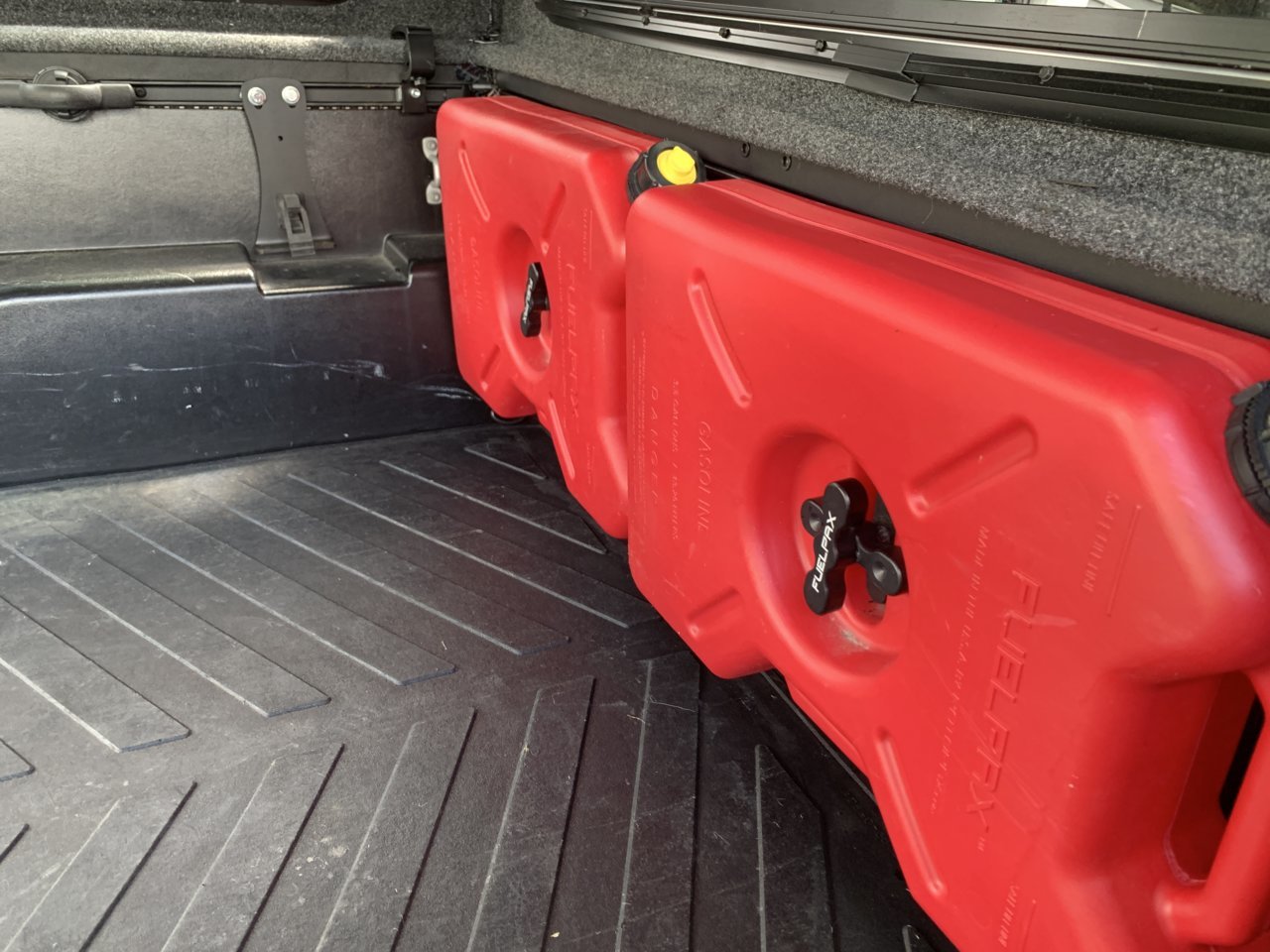

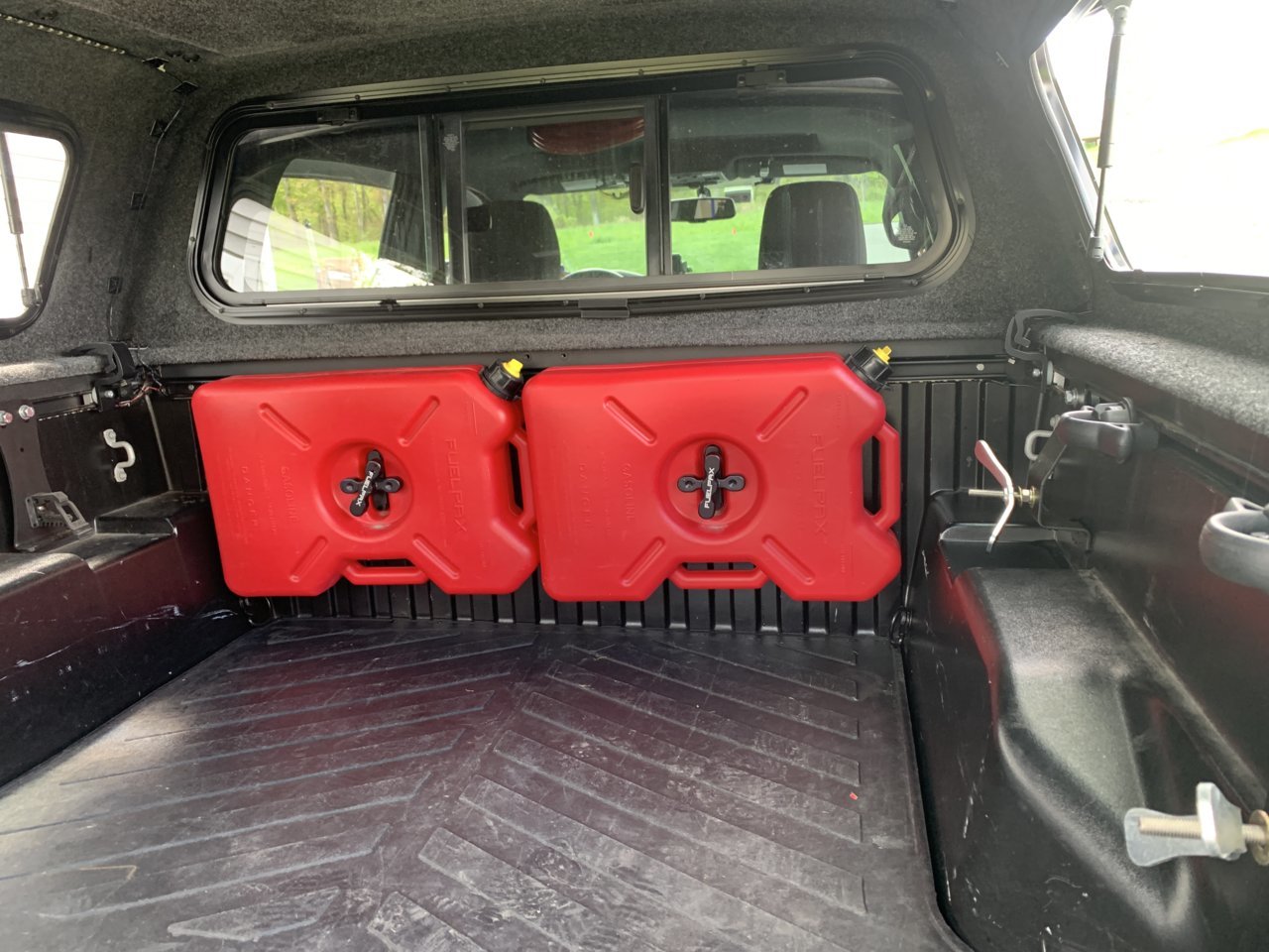

    Starting to brainstorm a drawer system. Once place I’m stuck is where I have my Rotopax fuel canisters mounted to the front bed rail. My initial idea is to just make the drawer/platform short enough to clear the canisters and their takeoff and removal, but I’d be loosing ~6-8”. Wondering what other idea people have done to solve this.

    Move them up after you build the platform, might have to modify the brackets.

    Yeah thats likely the best option. Wondering if there’s any pictures / ideas on a mount to fab up somewhere I could copy.

    rotate the brackets you have 180 degrees?

    If I did that I’d need a spacer to push them out past the lip of the cap and I think it would put a lot of strain on the brackets.

    Is there enough room to rotate the brackets 90 degrees, use that spacer to bump out a tad and have the cans resting n the bed platform for support from below?

    If I rotate the cans 90 degrees they’d be lower. I’d need to rotate the drop down brackets 180 degrees. I figure I’ll build the drawer system full size and deal with mounting the canisters after the fact.

    Was it an issue getting the panels in the bed of the truck with the canopy? I want to do this design as I want flexibility for storing gear, but have read it is difficult to fit the panels horizontal.

    I have similar design (3 full width top sections) and admit it is hard to get the top sections in and out. Depending on how tight they fit side to aide, you'll likely need a section where you have nothing attached to the rail in order to get them out. Luckily I have a softopper so it's easy to get out of the way. If you intend to keep the platform in the truck most of the time, I think the benefit of easy storage near the tailgate is worth it.

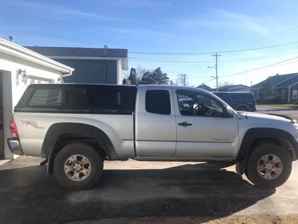

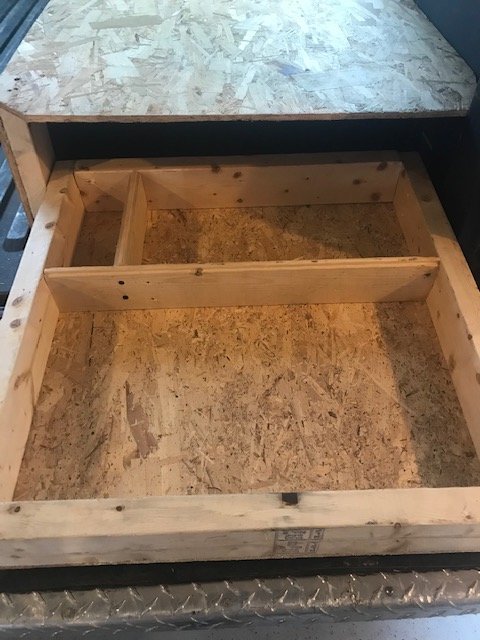

    Bought a used ARE cap yesterday, decided to make a small sleeping platform. 31” wide, 69” long. 2x4 up rights on the outside edge and a piece cut to close it all in. I just have to find some of that carpet you guys are using and a mattress to put on it. The small drawer holds my vamp stove, a propane bottle and sits on the tailgate as a table. Going to test it the weekend as is. See how it all works
