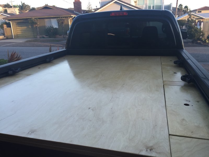

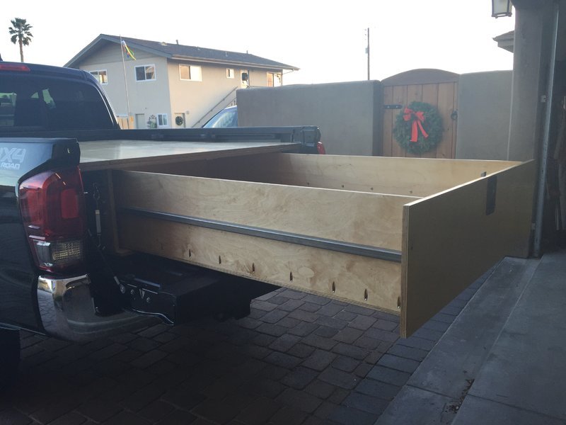

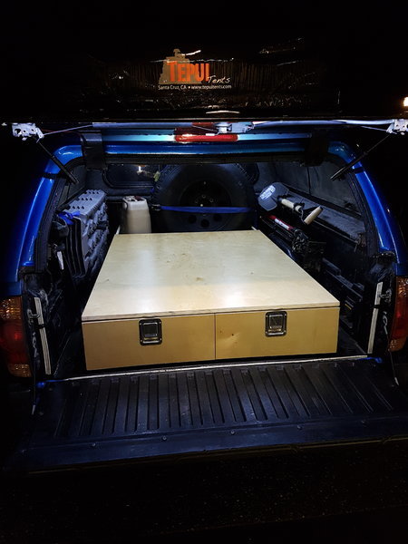

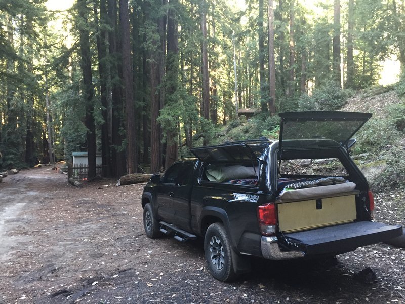

    I built one with the help of my retired woodworking ninja neighbor when I first got my truck. It's been great, I'm happy with how it turned out. IMG_0411.jpg IMG_0405.jpg IMG_0411.jpg IMG_0405.jpg IMG_0409.jpg IMG_0498.jpg

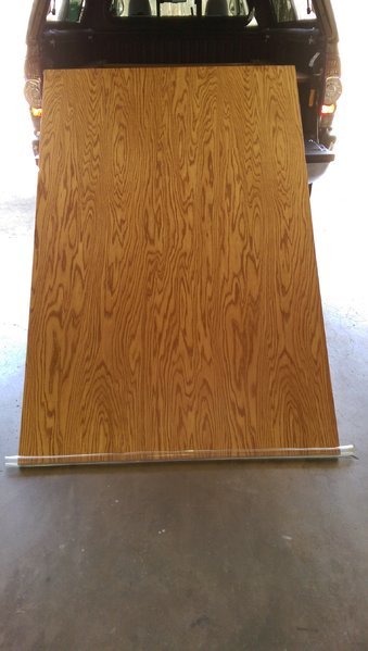

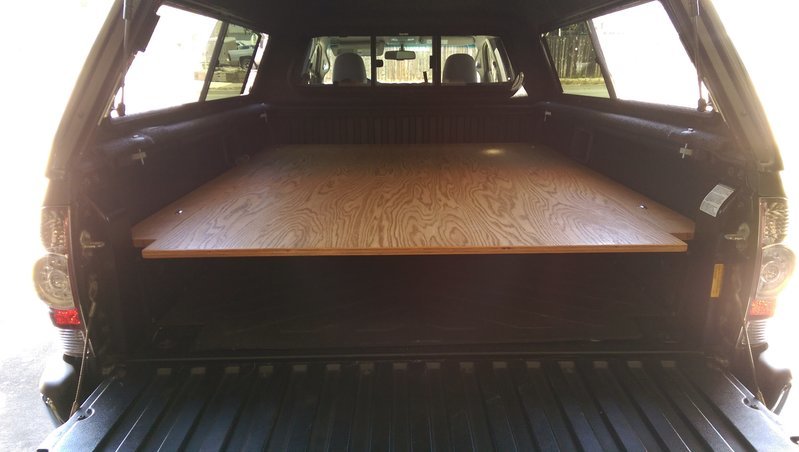

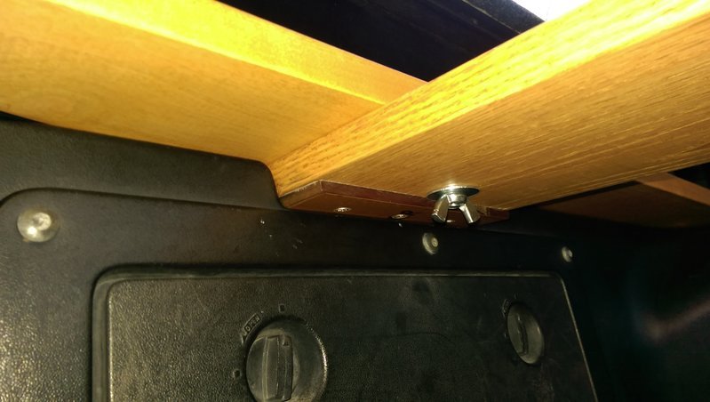

    OK, my first post in a very long time so...I decided to build a platform that was made with the KISS design, Keep It Simple Stupid. I wanted no carpet, gets dirty quick offroad, had to utilize my limited tools, belt sander is best, and be simple to take down and use just 1 sheet of plywood. This oak holds me at 170lbs and my wife at 115 no problem.If you like, get a 6in dia. PVC water pipe and cut to height of plywood for support only when you need it(sleeping) and can be moved for maximum storage when traveling.
    So here is the build list.. ALL wood used is 3/4 in. thickness

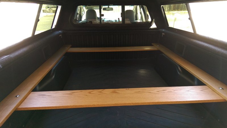

    1- 10 ft x 7 1/4in. oak board (cut to 57 and 57 3/16 in.) for cross pieces ((bed is not true!!))
    2- 6 ft x 5in.birch side rails cut lengthwise to 4 1/4in. (+/- 1/8 )width. Table saw or circ saw guide a must!! (carved w/dremmel or beltsander to match side curves)
    1- sheet of oak plywood (Lowe's...actual width is 48.5 in;))
    4- 1/4in. shims under cross pieces

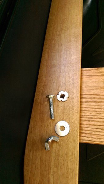

    4- 3/8ths carriage bolts with pointed wood saversimages_0fdd6822461d9f35c41f883f89fce6f359affec7.jpg
    washers and wing nuts
    Cut plywood at Lowes to 73 1/4 in.
    Carve side rails to fit curve near tail lights and bed edges with belt sander
    Build up cross pieces with shims (glue & screw) to go flush with top of cutouts and wheel wells..check with side rails
    Drill larger that 3/8ths holes for frame allow a little slop, install bolts loosely.
    Fit check plywood and using belt sander, fit the SIDERAILS to the plywood since the bed is not true, that's why I used Birch (softer) so I could sand it to fit. BED WAS 1/4in. Different front to back!
    Wax plywood sides to slide easier
    Plywood length is not touching tailgate, left enough gap to fill with water pipe insulation or other I used a 1 1/4 in tygone tube split as an edge protector and gap filler. IMAG1592.jpg IMAG1585.jpg IMAG1589.jpg IMAG1574.jpg IMAG1576.jpg IMAG1581.jpg

    Great build. I want to do this same thing with a tall platform at the bed rails and an extended height cap - how is it sleeping in, climbing in and out and moving around in?

    It's perfect for what it is. It's a place to sleep, nap, read, ride out a storm. It's not to hang out in.. that's what being outdoors is for. When I take the truck out it is to be outdoors, surfing, hiking, spending time around the fire, etc. It's plenty of room to do what it is intended for. It's not claustrophobic for me, and I'm not a huge fan of being in small spaces, and I can move around and spread out. I love it!

    How did you attach the beams going width wise in the bed? It's like everyone is attaching them to some magical notch.
