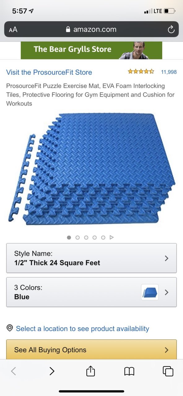

    There’s a made to fit thick rubber mat for the Tacoma.

    Yeah looking for something to cover the top of the platform.

    Check out a local farm and ranch store for wide rolls of various rubber or rubber/? sheeting.
    Stores near me have this in varying thicknesses.

    horse stall mats work great

    It’s not rubber but...This is what I use on top of my platform. It is comfortable, durable and fits approximately 90% of the top of my platform. You can buy two sets or a larger mat whichever is cheaper and cut to fully fit. Which is what I will be doing soon. I bought mine at Costco for a comparable price. I can pull it out hose it down and let it dry, plus I can store it easily in a stack of 2’ squares when the system is out of the truck. Hope that helps.

    Didn’t even think horse stall mats, that should work good. heavy duty and easily cleaned. Thanks for the input guys!

    Horse stall mats are heavy AF.

    Hell yeah they are.. def not a good idea for a full time set up in a truck.

    For my current setup I went to a local carpet store and they had some 2’x2’ squares of low carpet for $1 each. I used that and it’s worked well.

    Lots of good idea above. Could also look into garage flooring rolls? Something like this would weigh less than the horse stall mat: https://www.homedepot.com/p/G-Floor...inyl-Universal-Flooring-GF55LV510MB/303800695. Can also get them thicker, and with diamond plate texture, etc.
    Also, good outdoor carpet can totally be hosed down or even pressure washed when muddy, so I wouldn't completely count that out.

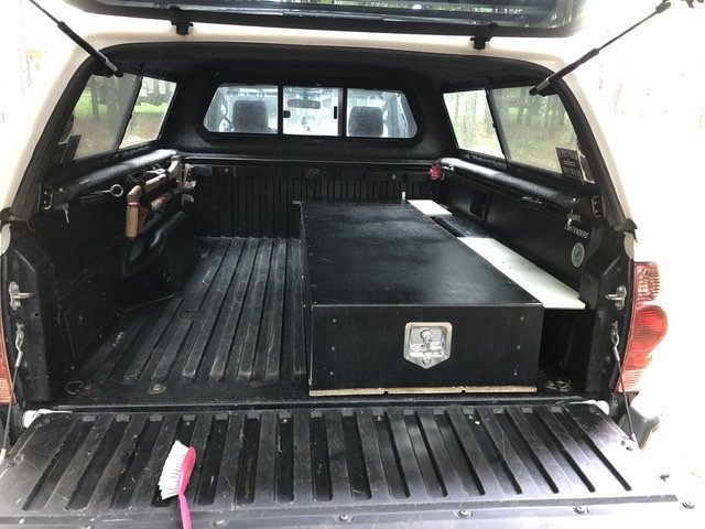

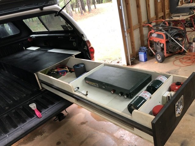

    Finally got my sleeping platform/drawer system done. I still wanted space in the bed for other storage so only made the platform half the width. After a weekend camping with my dog I realized I need to add a little extra room so am going to add about 6 inches to the side that I can flip up when sleeping and have them down when I have stuff loaded.

    Hey, I like this setup! Can you quickly provide the size of the lumber you used? What is that drawer you have...self-made?
