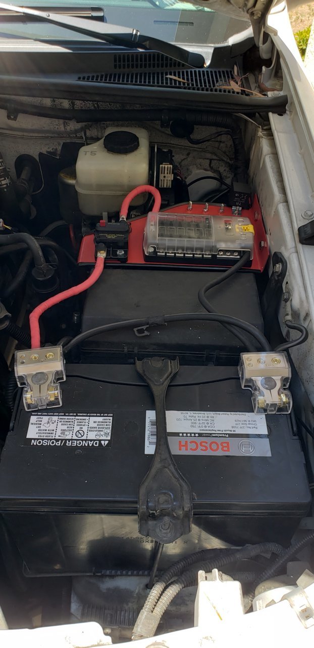

    Almost done. Need to install battery, finish wiring the redarc dc to dc charger, fridge slide and panels to cover plumbing and water tank...
    Someone convince me not to buy a lithium battery. They're expensive..
    Also, I need to tie a wire from the DCtoDC charger into an ignition wire or something that only turns on with the vehicle on. Any recommendations for the rear of the vehicle? 20200926_130245.jpg 20200917_171721.jpg 20200920_110957.jpg 20200920_111002.jpg 20200920_125804.jpg 20200926_130230.jpg 20200926_130245.jpg

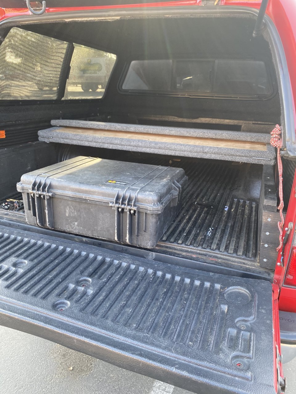

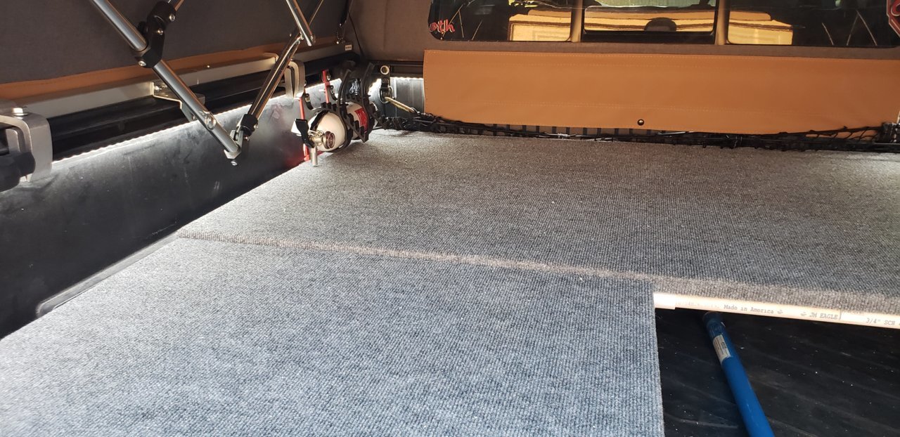

    Still a work in progress, and no where near as fancy as some of these sweet build outs, but mine works for my needs. Super light weight and modular. I can use all 3 panels to make a full bed platform, or just sections depending on how much I am packing. LED strip lights wired to the battery so I can use them with the engine off. Switch in the bed. Now I need to find the right containers for under platform storage, and am gonna get a few lounge chair pads i can store under the back portion. Not loading 1000lbs on there like some of you, but strong enough for my ass.

    This is such a sweet set up. Well done. How much weight you think this added?

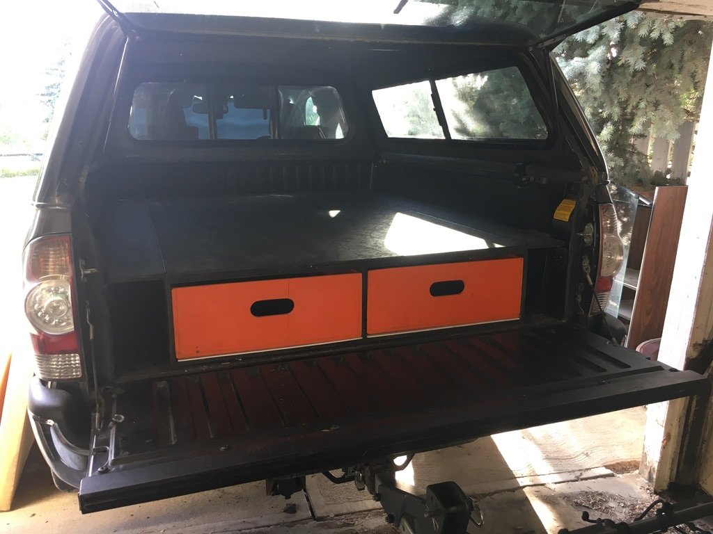

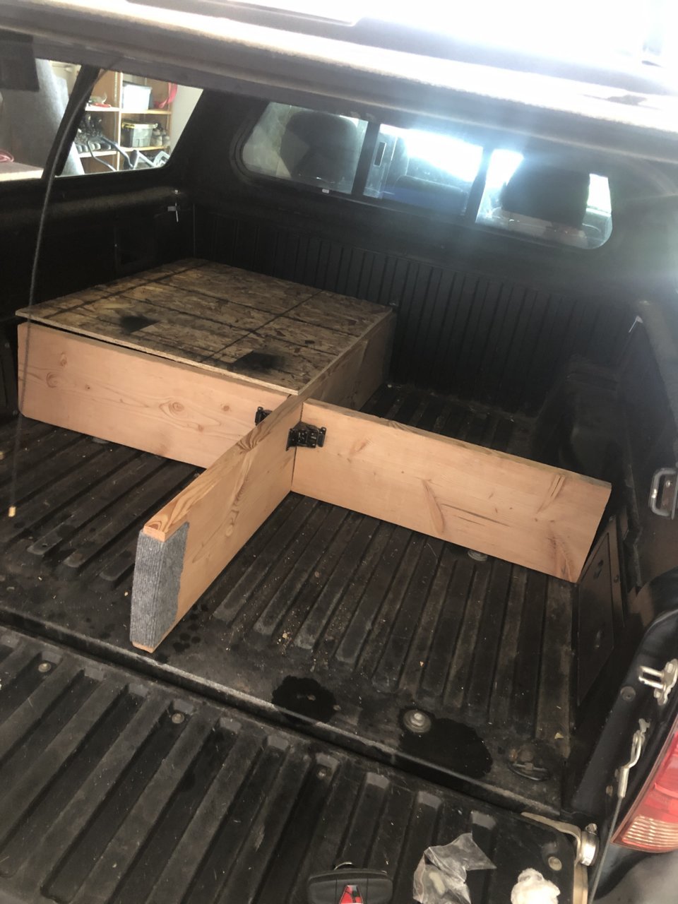

    2AB5DFC4-DA81-487A-A5E0-A2E12D9E0980.jpg Just did this today. For when I don’t want to use rtt. Thanks @overlandunderbudget
    55F95FC0-8301-45CA-9269-229E0F4AB28E.jpg 62EE3C08-54F4-41C2-818E-5FAE8C709A24.jpg

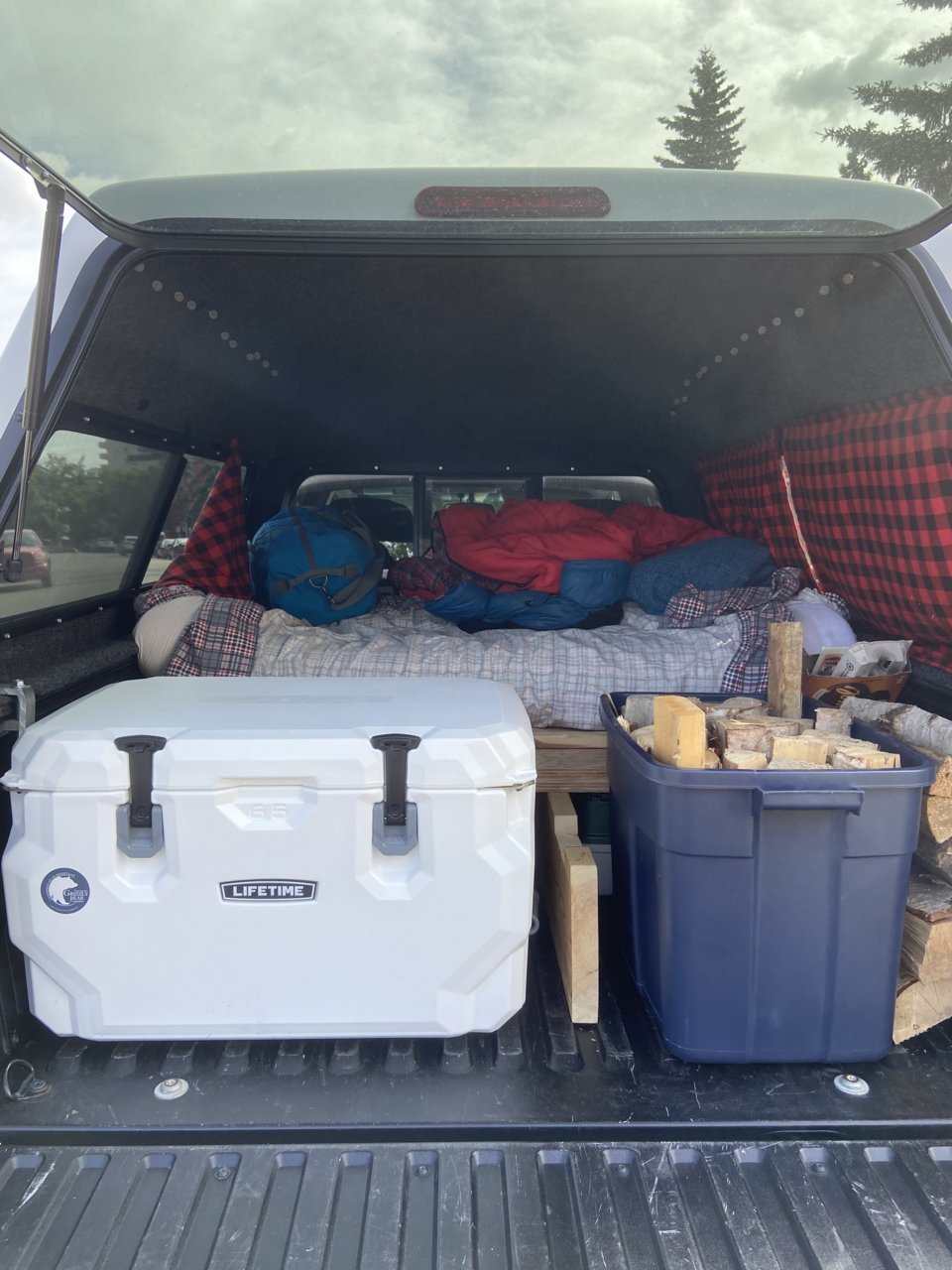

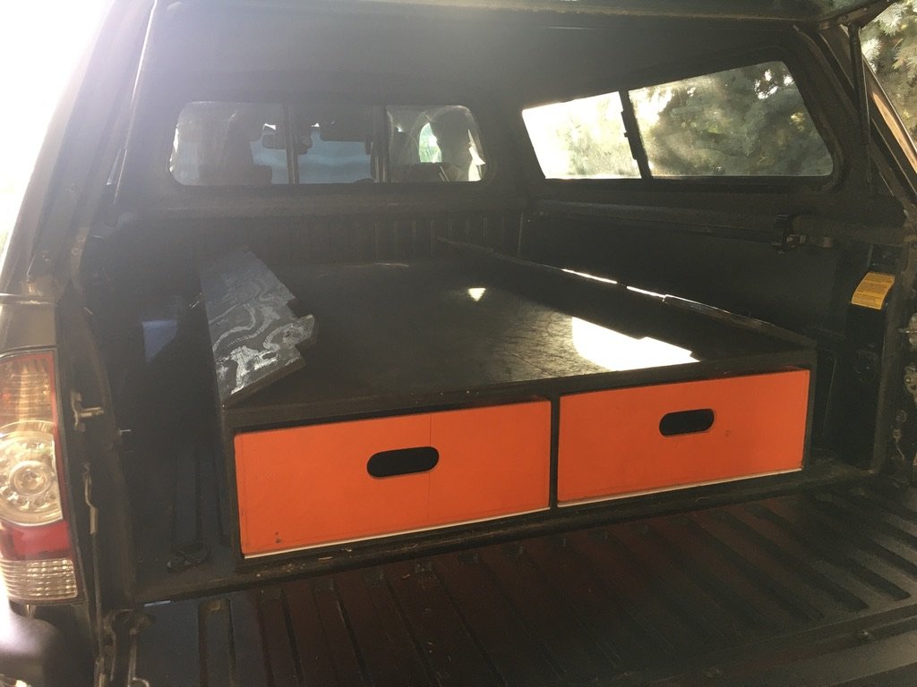

    I like to think it’s about as simple as it gets. Different storage spots for climbing, mtn biking, cooking, and clothes so you can get your fix all in one trip. 6’ of man in 5’ of bed so a little squish diagonally it is

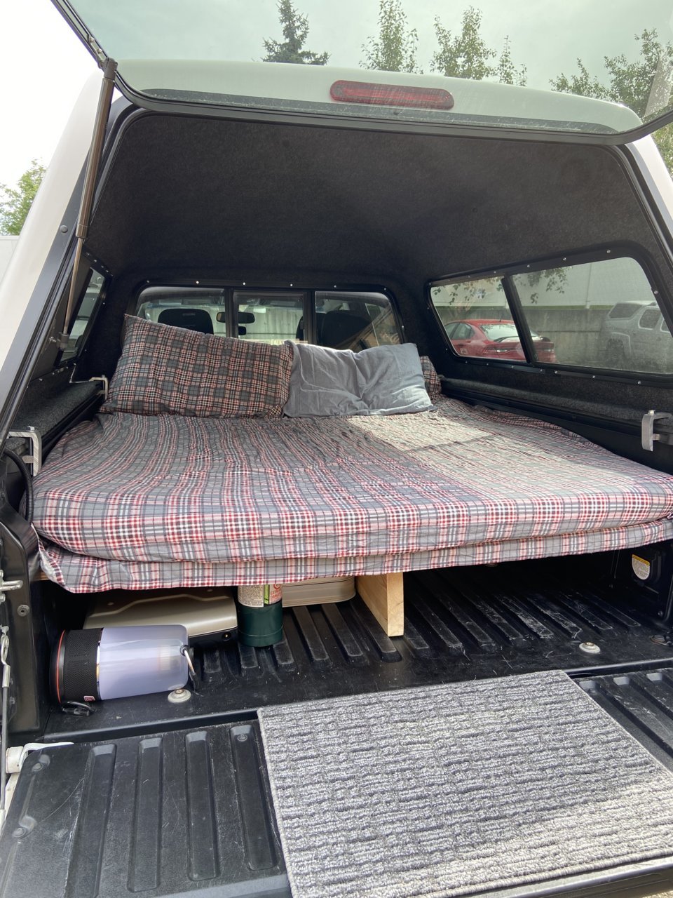

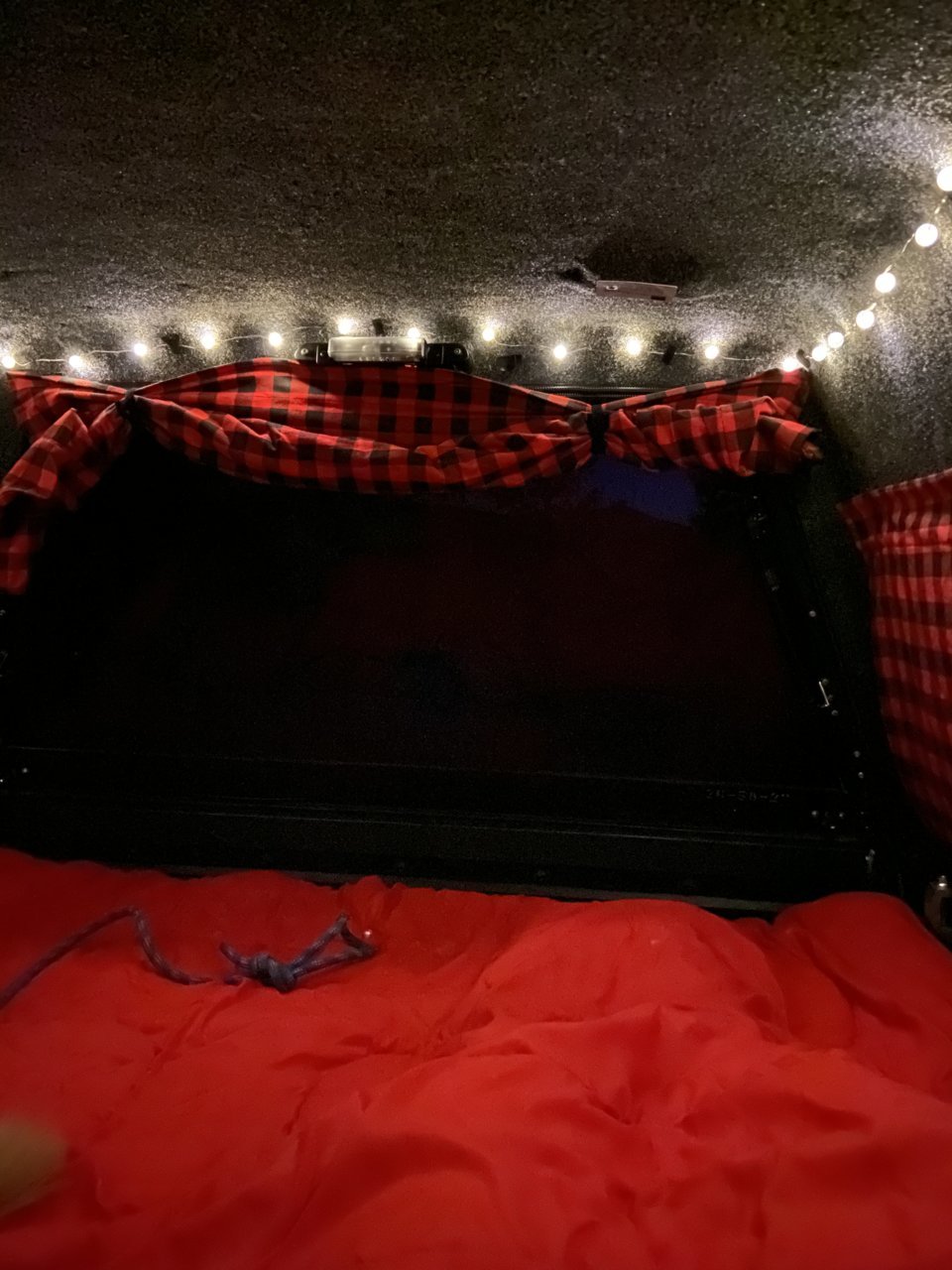

    I took a lot of inspiration and advice from this thread to build our set up. Totally happy with it and glad I went with the hi rise canopy so we can sit up proper. We slide the last panel on top of the rear and fold the memory foam in half to store the cooler and wood if we have to pack it, otherwise our gear slides under the platform.
    Canopy: high rise bulldog canopy from Cap-It with headliner, sliding full length side windows with screen and sliding rear window with no screen. Headliner included. Curtains were made by a friend and attach with Velcro.
    Platform: 2 sheets of 3/4” marine board cut into 3 width pieces 1 length of 2x10”, and 2 1x6” cedar planks. Marine board was overkill but works great and will be moisture resistant. Since the lumber isn’t true measurements the 2x10 fit perfect as it ended up being ~9 1/4”. It’s notched for the 1x6 planks to fit in, that also carry to the notches in the side of the bed.
    There was some leakage in the rear corners of the box, which we spray foamed to seal it. For the most part it stays pretty dry. Will eventually add weather stripping to the tail gate to cut down on dust. F1BD31E9-2B60-4CEA-993C-7F9E94748EEE.jpg 57178769-CFDB-4247-B311-2EB03527D36A.jpg C9DD8F2B-E9A6-4556-8E6E-2F15919B89AB.jpg FFD0422D-6BD8-4FB2-B675-5A4049C96F5F.jpg 6CB3E26B-945F-4351-ADF6-21EFECB960E0.jpg E18CEF2F-E94F-45F0-8BA5-9A8258CB4E3D.jpg

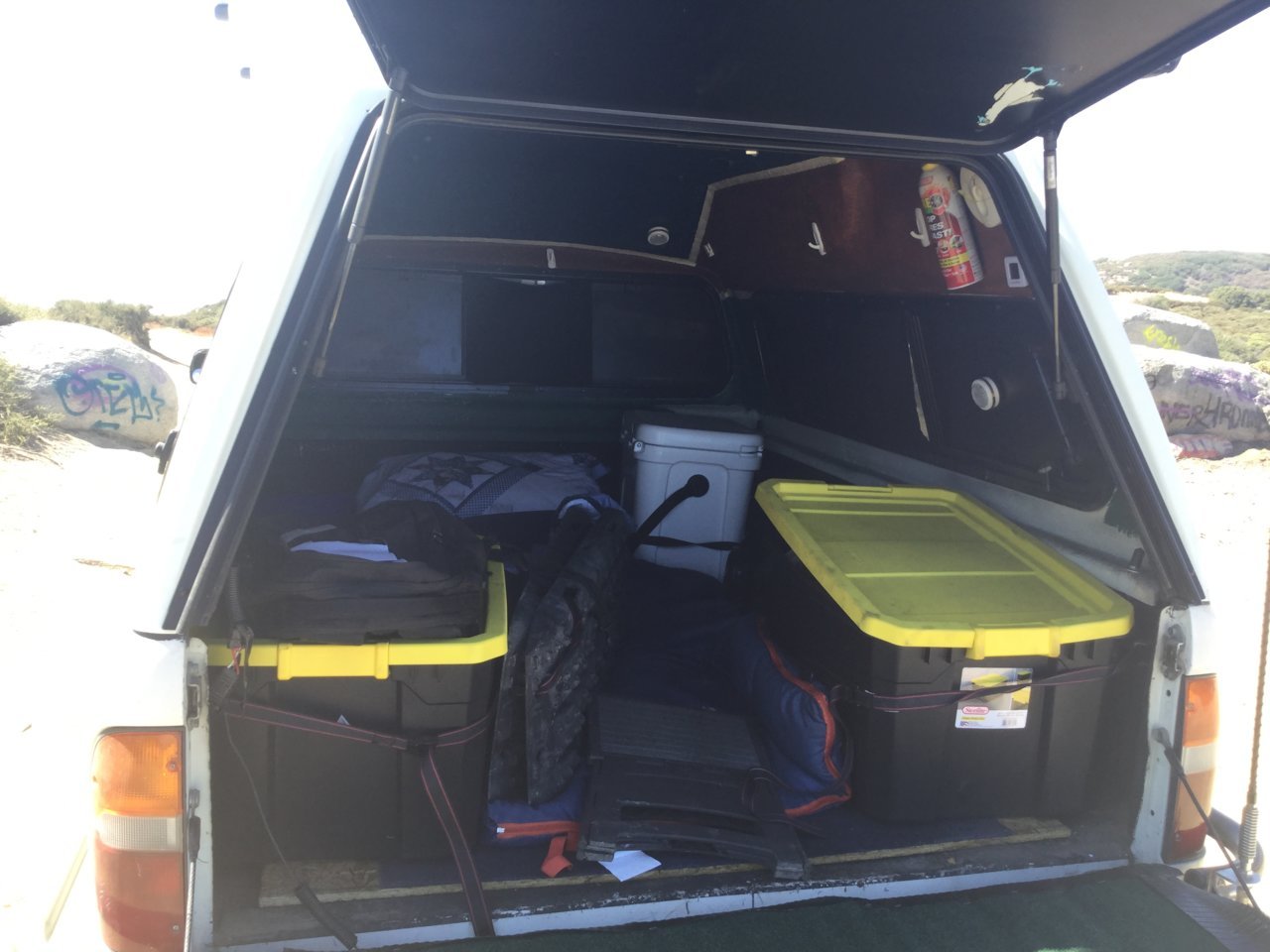

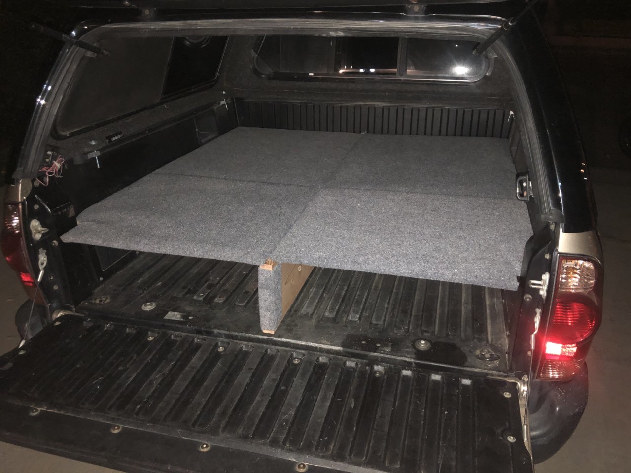

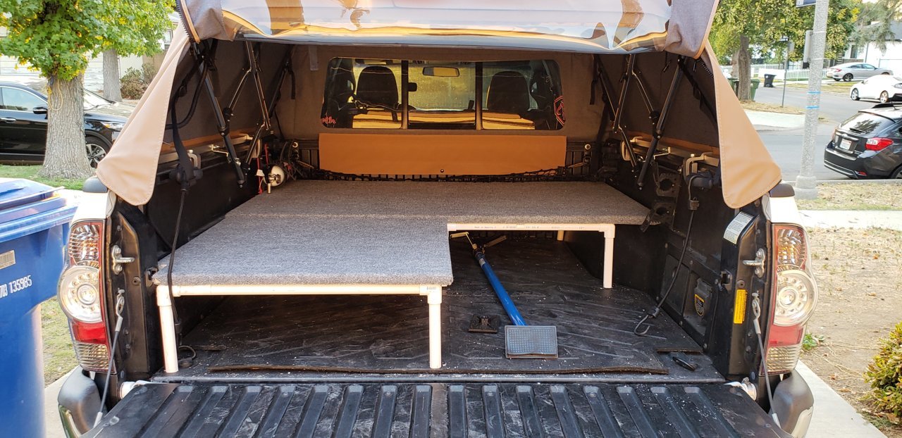

    Okay I'll bite! I'm on about page 80 of this thread now so I thought I'd give a first draft a whirl.
    The keys for my build,
    Keep it low
    I have 2 huskies and my lady has 1 shepard mut, so I frequently roll around with 175lbs of dog in the bed. I basically give them the whole 5ft bed so they all have enough room to stand and lay down. I want
    Large underspace for skimboards/short boards/snowboards.
    My main hobbies are skimboarding, biking, snowboarding and camping/hiking. The girlfriend is more a surfer than any of those 3. All of these objects are long, semi wide but thin. I wanted a compartment that could fit my 72" snowboard, 50"x26"ish skimboard or a short surfboard in a pinch.
    Recoup some of the dog space.
    The third is more general as to why we all do it. Add additional functional space, with storage space.
    So here's what a morning trip to home depot and 3 hours this afternoon produced.
    I used
    3 "common boards"
    QTY2
    1x6x6ft
    QTY1
    1x10"x6ft
    1 sheet 3/4" ply
    1 2x10x8ft
    Notching the 2x10 was the biggest PITA. everything else when fairly smooth. I don't have much woodworking experience but I do have some tools.
    I used a circular saw for the plywood and lumber cuts. A dremel and sawzaw for the weirder ones.
    6ft long metal ruler was also clutch for making long straight cuts
    The plywood is 2 sections, 36x48 and 24x48 with the "common wood" finishing off the section over the passenger wheel well. It kept the whole thing fairly cheap and easily removed.
