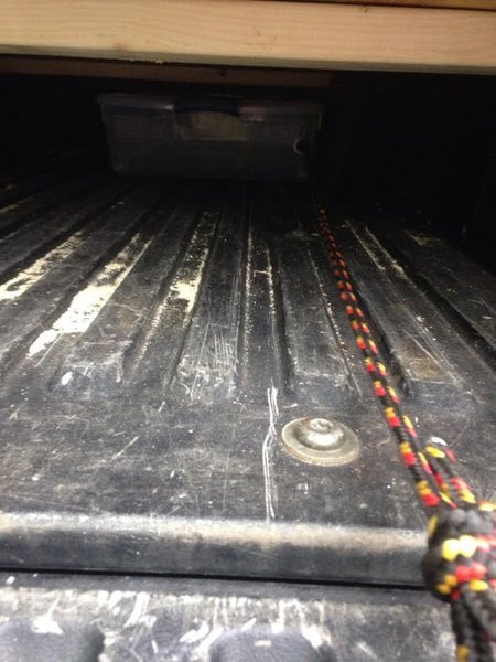

    The notch right above the cubby door. In the pictures you quoted you can see it in picture #3.

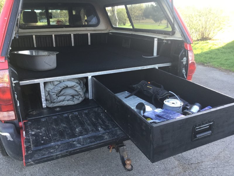

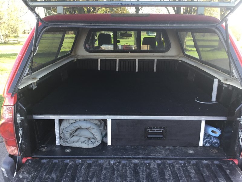

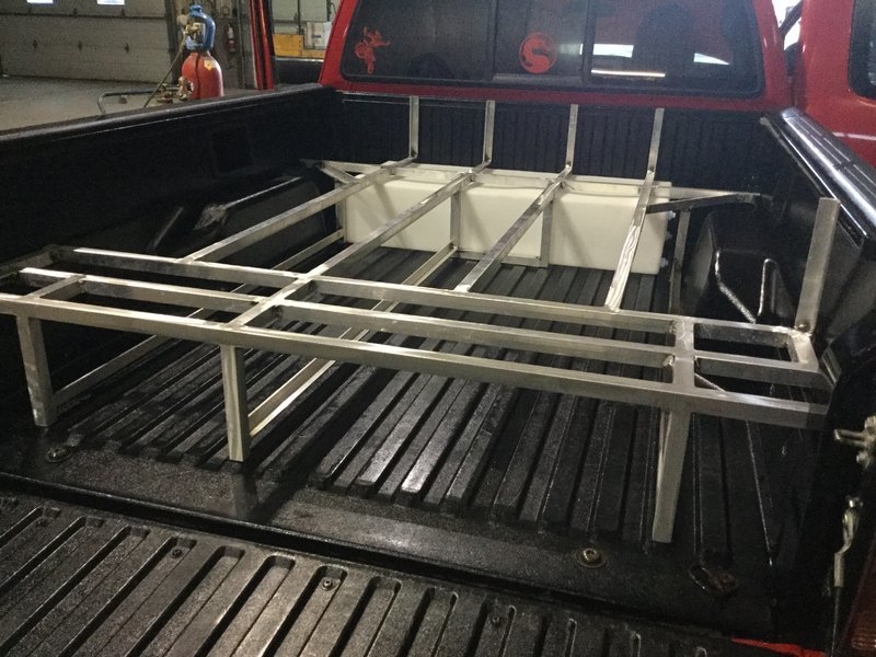

    Still a work in progress but im getting there :)
    6´ bed, 21 gallon onboard water tank, large gear drawer, narrow kitchen drawer. Aluminum frame, 1/2" plywood.

    Sick! Where's the water tank from?

    Ebay... search rv water tank, this one is 39"x16"x8"

    looking great, where do you plan on putting the sink? and how or where will the water spigot be??

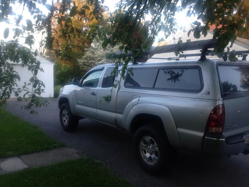

    Nice truck! Reminds me a lot of mine..
    Just out of curiousity, is that the ARB 2500x2500? Also, what did you use to mount yours to the thule rails/tracks?

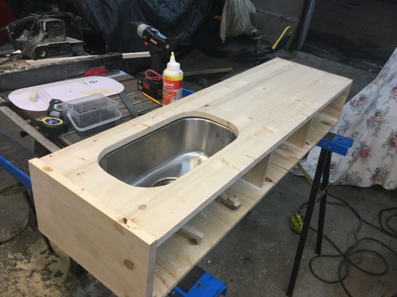

    The sink will overhang the tailgate when the drawer is pulled out, then i can dump the water in a collapsible bucket. I will have a pull out faucet installed on top of the platform

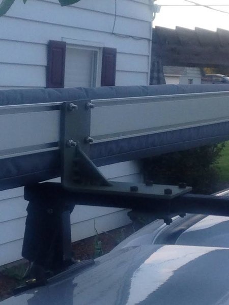

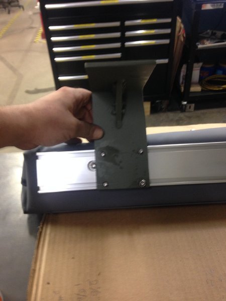

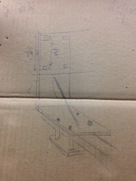

    Hey man! Yeah it is the 2500, I was tempted to go for the 2000, but for a couple extra bucks, I figured it would probably be nice to have some extra square footage in case I ever decide to purchase the drop down room. I chose to build some custom mounts to attach mine. I have a bit more overhang than ARB recommended, so I chose to construct a little bit more robust of a mounting system. So far it's done exceptionally well! P.S. Loving your truck man, I am always envious of the forest green tacomas. Such a badass color!

    I was also debating between the 2000 and the 2500 but im glad i got the bigger one, the extra space has really come in handy. How many inches of overhang did you have on yours near the front? Whenever i was mounting mine, the overhang was almost an issue for me but i think i had an inch or two to spare. I just moved mine back as far as i could where i could still open the shell window all the way. Those brackets you made look great, really beefy! Are those 1/4 inch steel? I should've just made some brackets like that but i just got some of the brackets from ARB and then drilled through my cross bars and bolted them down that way. it's done well thus far, i drive on rock roads every day and its solid. Thanks man! i dig the timberland mica too! one of my favorite colors they offered! its a shame they dont offer it anymore

    If I remember correctly, ARB said no more than 700 MM ( about 27" ) of overhang. I think I ended up somewhere around 29 or 30. It hasn't been an issue yet. I debated moving it back some, but I really like how I am able to open the access cab door while standing under the cover of the awning. As far as the metal I think it was 3/16" so it has been very solid. I think my favorite thing about the awning is having people ask what it is, I tell them its an awning and they say "what do you need that for?" I then give them a demonstration of how easy, and awesome it is to have, and they start asking how much it cost and where to buy one.

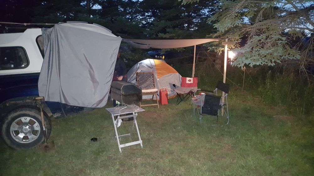

    that is a nice setup there Mc. I've got a removable plywood platform in the truck bed for my wife and one boy. me and the other son in the 2 man tent. canopy setup off my good old honda element.
    this is as close as my cheap ass will ever get to rv'n :) gets us to the local small town music festivals on short notice.
    this one was last weekend at the Kempt Shore acoustic music festival in Kempt Shore, Nova Scotia. All great people in a great place.
