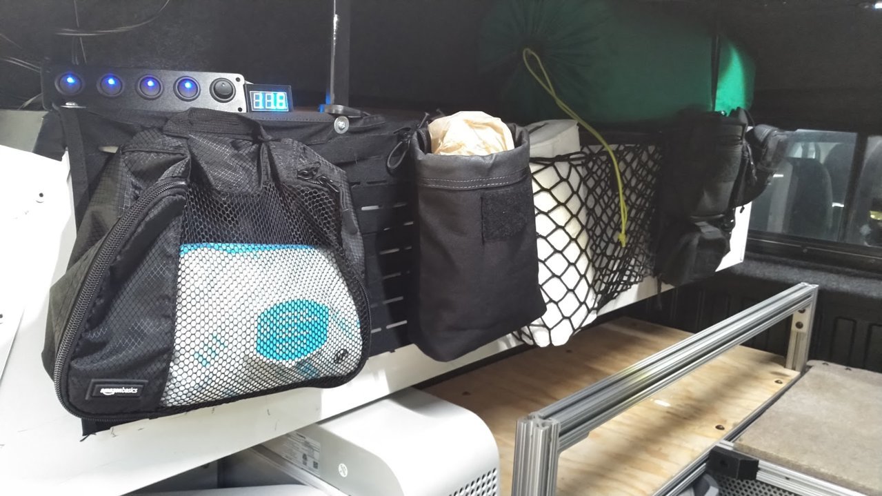

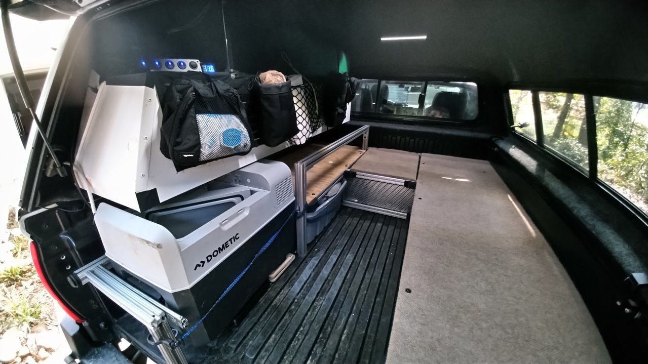

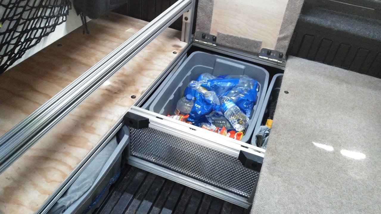

    Thanks! I still have a bit more to do, so it's a work in progress. :)
    Most of it came from a robotics shop that was selling cutoffs and old projects. I found it through a posting on Craigslist where they were offering it for sale before recycling, and just bought a couple of old projects off of them so I would have what I needed with some excess. I still have enough tslot in my garage to almost build a second one, and enough hardware to build like 4 more, and I've spent under $100 on materials including picking up the scrap.
    I wouldn't ever use new tslot. It is ridiculously expensive new because it's designed for precision applications. For example, here's a good source - https://8020.net/40-4040.html - that's about the same profile I'm using and it's $0.61/inch before adding cutting or hardware. I have about 40' of tslot in this build, so ~$300... before shipping and before cutting and before adding hardware (screws, brackets, etc). I have no idea what hardware costs are since I didn't have to buy any, but the robotics company I bought this all from said they usually quote project hardware by matching the cost per length of the actual tslot (so they'd quote $0.61/inch for hardware as well, before considering labor).
    On the plus side, tslot is ridiculously durable, so if you can find any used tslot structures, it would work great and already come with fasteners. That said - I wouldn't use any profile smaller than 1.5" / 40mm because smaller sizes will deflect slightly over a 6' span with a few hundreds of pounds on it. The frame I have now doesn't move at all when me and my wife sit on it, or when the inside of the truck is loaded up with IT gear.
    Tslot's really easy to work with. It went together faster than welding and finishing a frame, and if I ever want a layout change, it's fairly easy to rebuild. It's ridiculously light too, at least compared to building out of mild steel. It's perfect for this application if you can source it for a reasonable cost.
    Extrakrispy, sachou and ETAV8R like this.

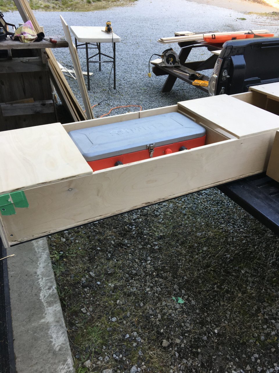

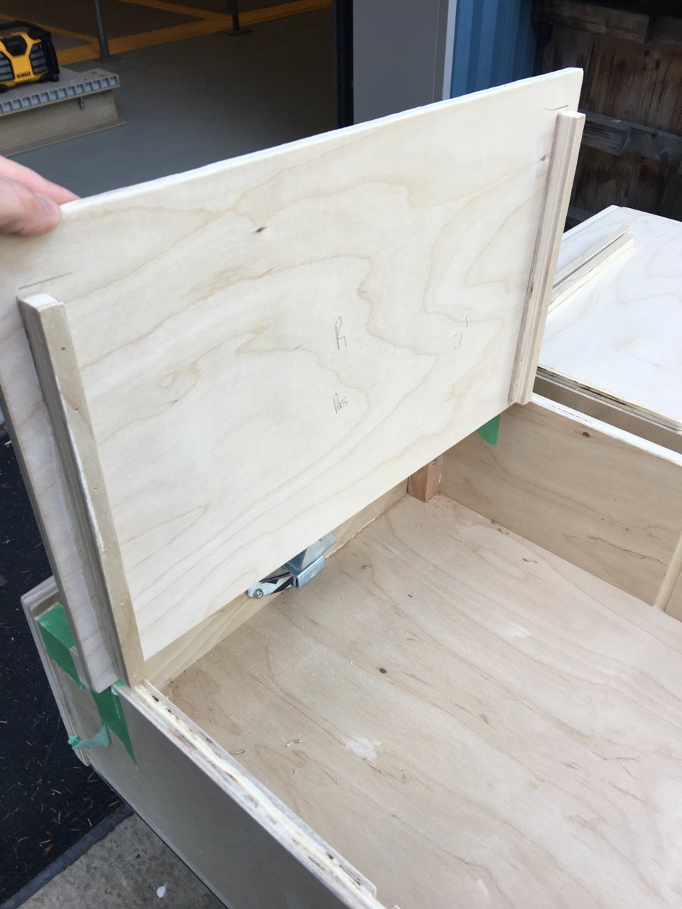

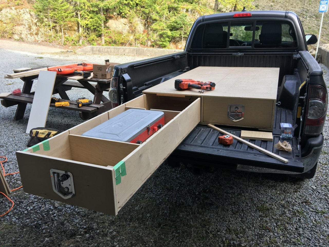

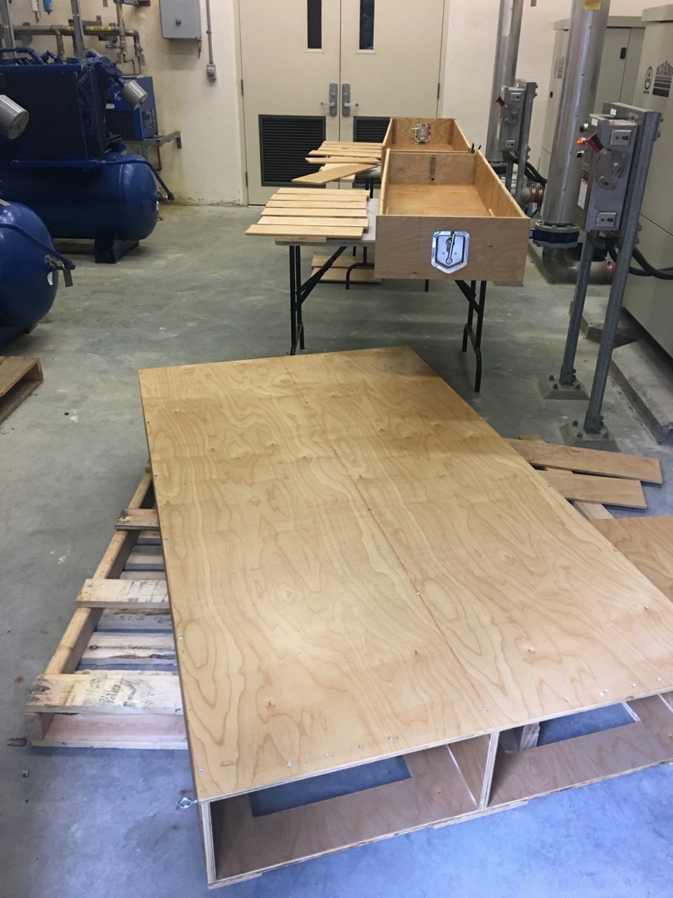

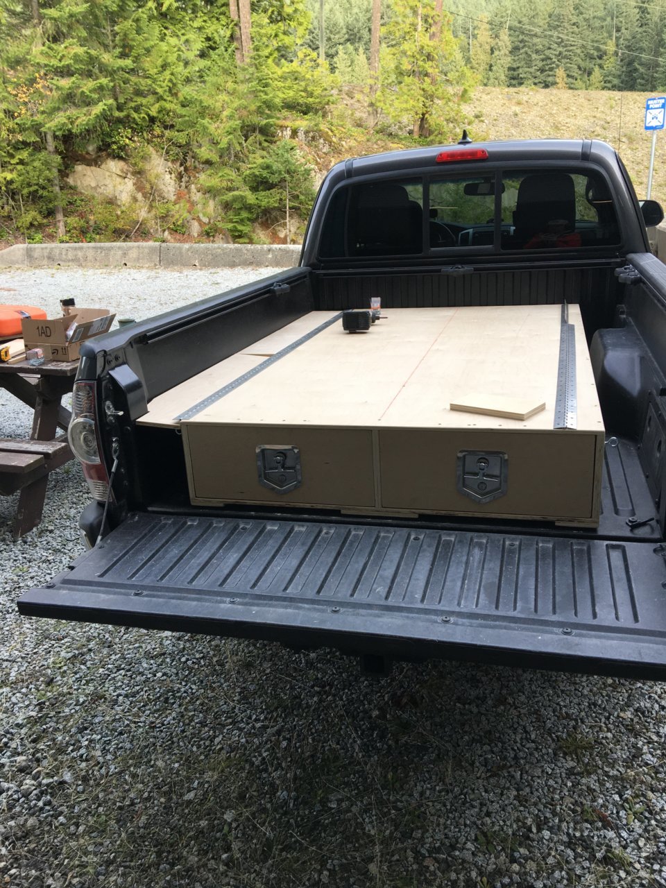

    Got some great ideas off this thread so wanted to put my drawer build up. Super happy with how it turned out so far but will have to wait another 2 months for my ARE canopy to arrive and test it out for real.
    Like lots of others I went with shop grade birch and used UHMW strips for drawer slides doesn’t seem to take too much effort but haven’t loaded them up either. Thinking about rubbing them down with some snowboard wax to help.1BDE2472-27D9-434D-9BA2-51F4AC0A4F01.jpg

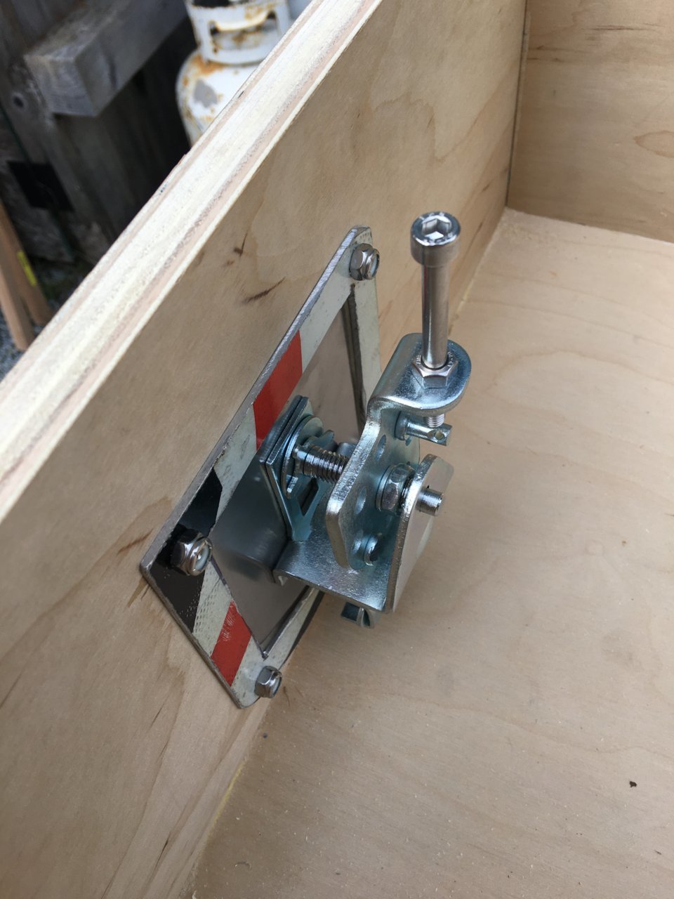

    Cut out an old stop sign to strengthen up the back of the t handle.
    piano hinge mock up before staining and carpeting.
    C9BA9A76-4C7F-4BC6-AA15-0915D46DD581.jpgMade a couple slide able flat tops for food prep etc. EADC8D5B-F10B-466F-8B9F-446290BB237A.jpg

    I also got a little excited to stain the drawers and did so in suboptimal conditions. (Below 10 degrees Celsius.) so had to find a dry warm spot for them to hand out and dry out. Much better now. Just used a thompson’s water seal plus protector.

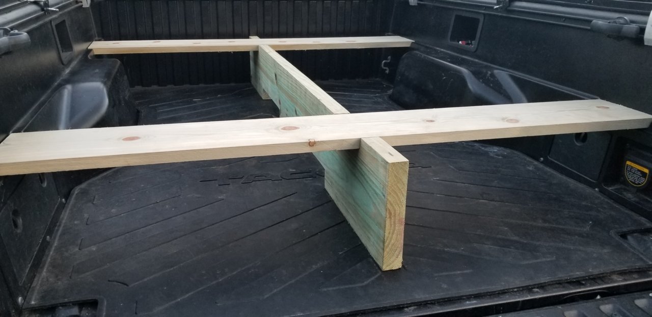

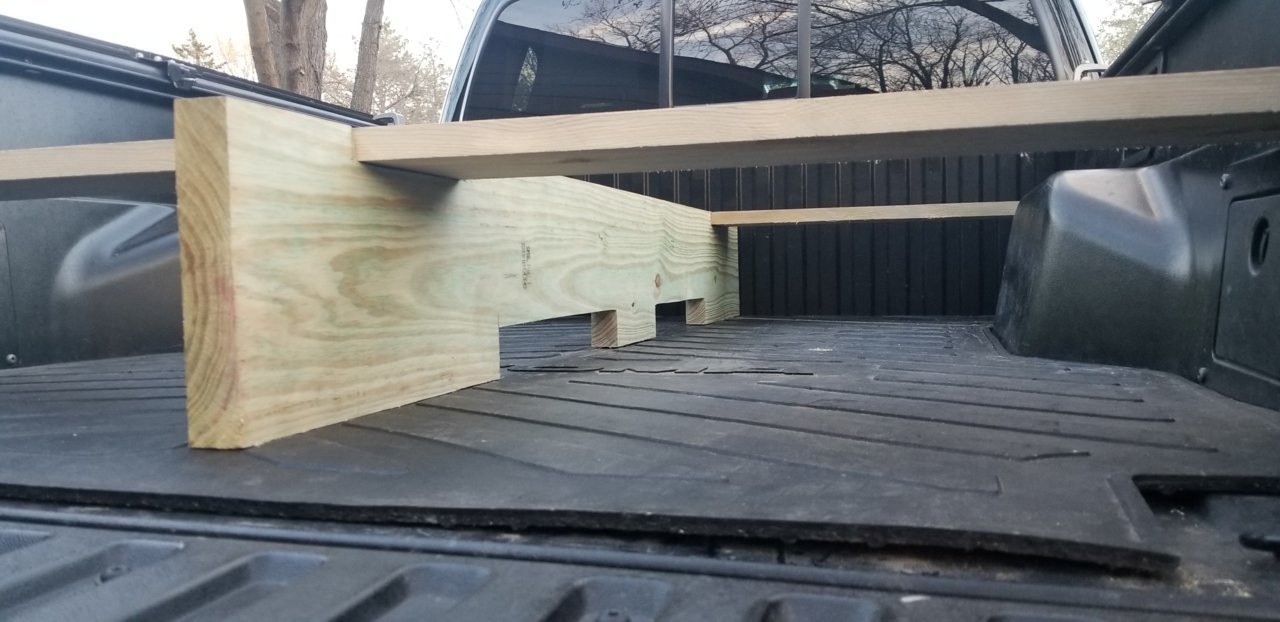

    Turned out pretty good. I wanted it to be easy enough to get in/out yet very stable.
    Used all pressure treated lumber.
    -5/8" Plywood
    -2×8s Ripped down and angled the ends to fit the notch also planed to a true 1"
    -2×10 Center support notched for cross braces
    -Marine grade carpet wrapped with padding
    WarrenG, deanosaurus, MY50cal and 8 others like this.

    What are the bottom notches for?
  13. Nov 8, 2020 at 7:27 PM
    #2393
    VLBtaco
    VLBtaco Well-Known Member
    Apr 20, 2020
    #325301
    57
    Nick
    2012 Black Tacoma TRD access
    Fishing rods.. I normally will store 2-3 under the platform and have to place them diagonally.

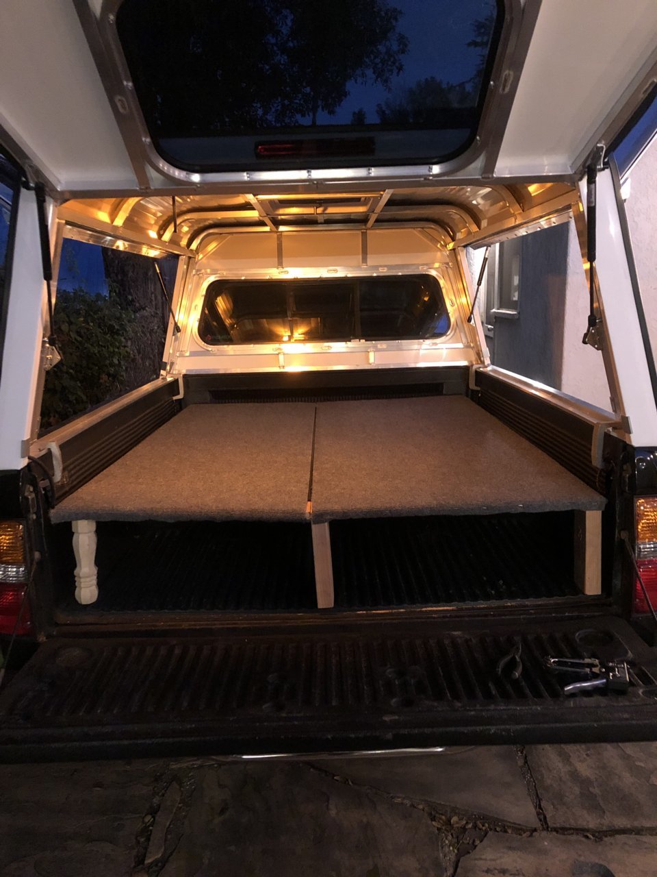

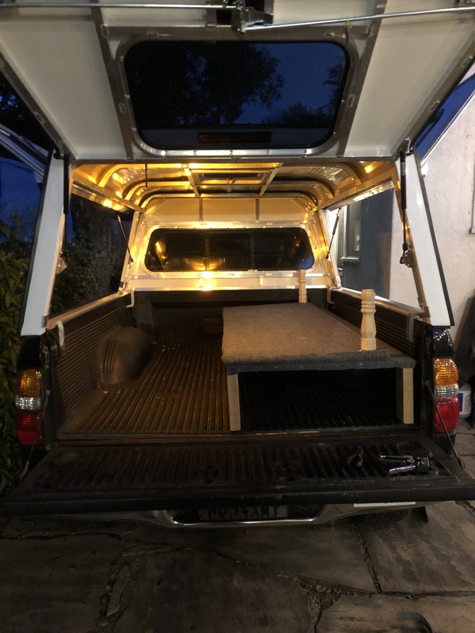

    Not trying to impress and looking to keep the load light:
    Perk is that it all cost ~$115. Ornamental legs and all.
