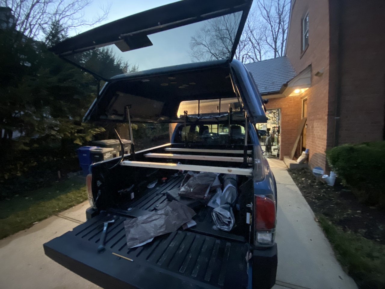

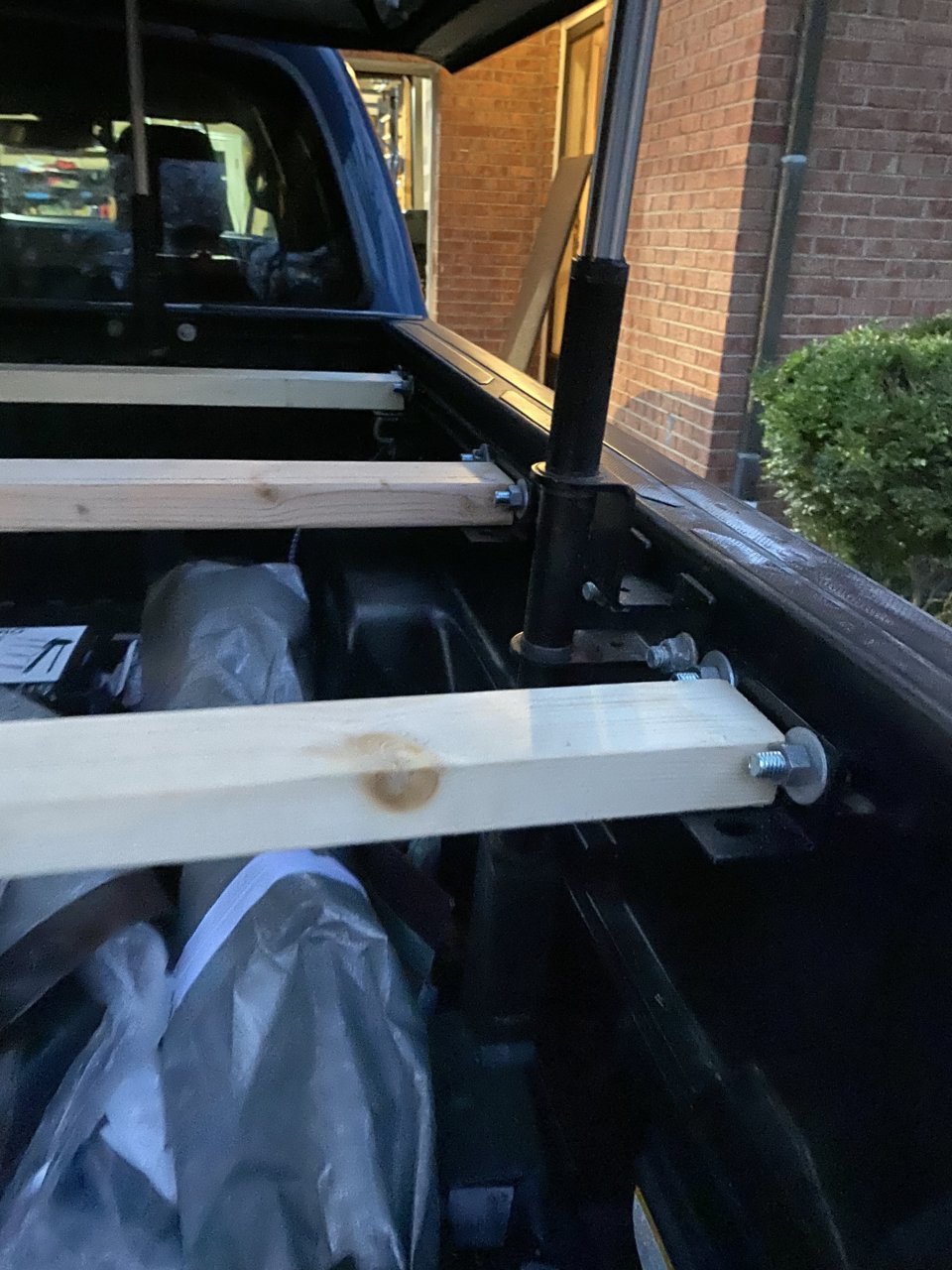

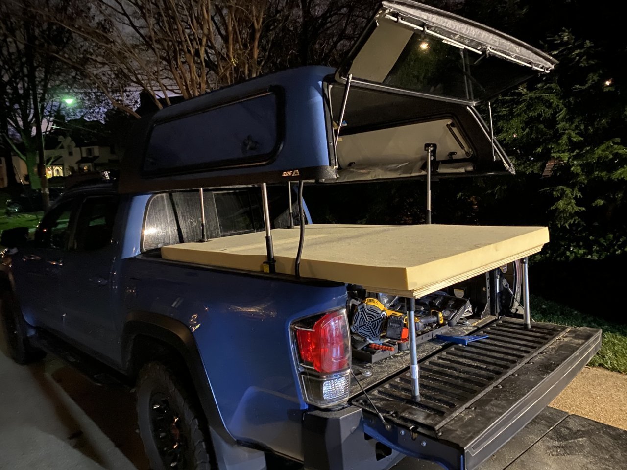

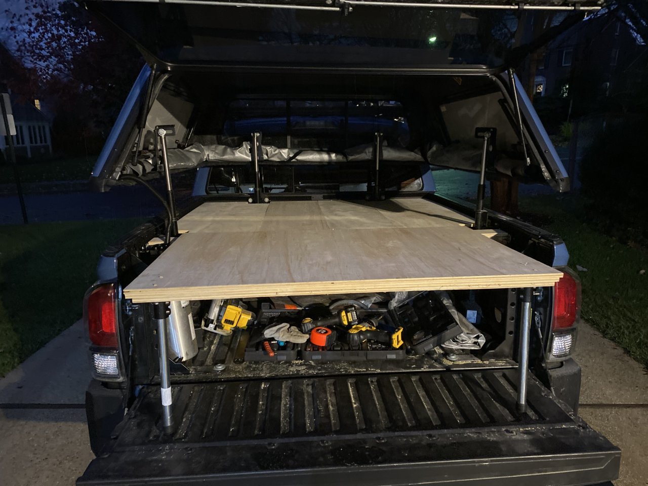

    The main platform is made of 1/2” sanded plywood. The plywood sits on three slats running across the bed (two 2x3 and one 2x4). The slats rest on some 1/8 angle iron brackets I found at Ace. The brackets already had holes in them. I attached the brackets to the bed rails using 1/2” carriage bolts.
    I made an extension out of scrap wood from the original platform. It makes the platform just over 6’. I used Steeltek structural pipe (Lowe’s) for the legs. Steeltek makes fittings for the pipe. Oh and where the legs are I stiffened up the plywood by gluing a few layers together so it’s 1.5” thick there. The extension pushes in so the tailgate can close. It is supported by the main platform on the cab side.
    I took a memory foam mattress I had in my guest room. Will get a probably paint it all black so the look is clean.
    I made a tent out of tarps the covers the sides so when the EZTopper is up I’m all sealed in.

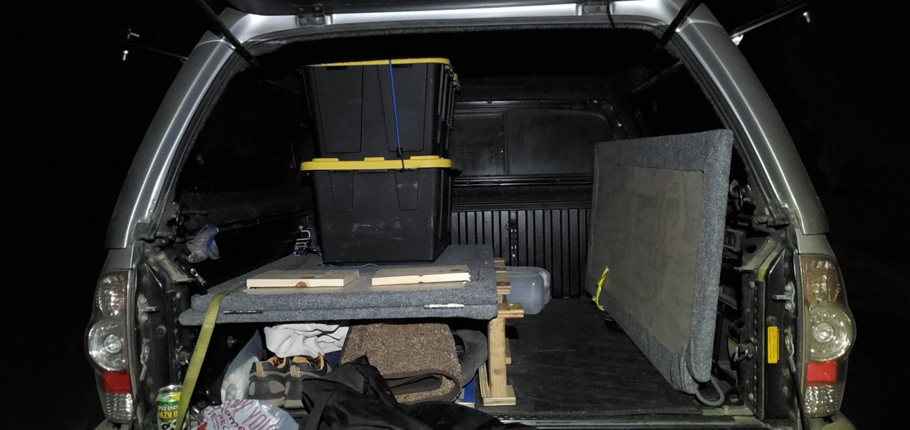

    Subd. Mines still very much a work in progress but I’m sure there’s some good ideas in here

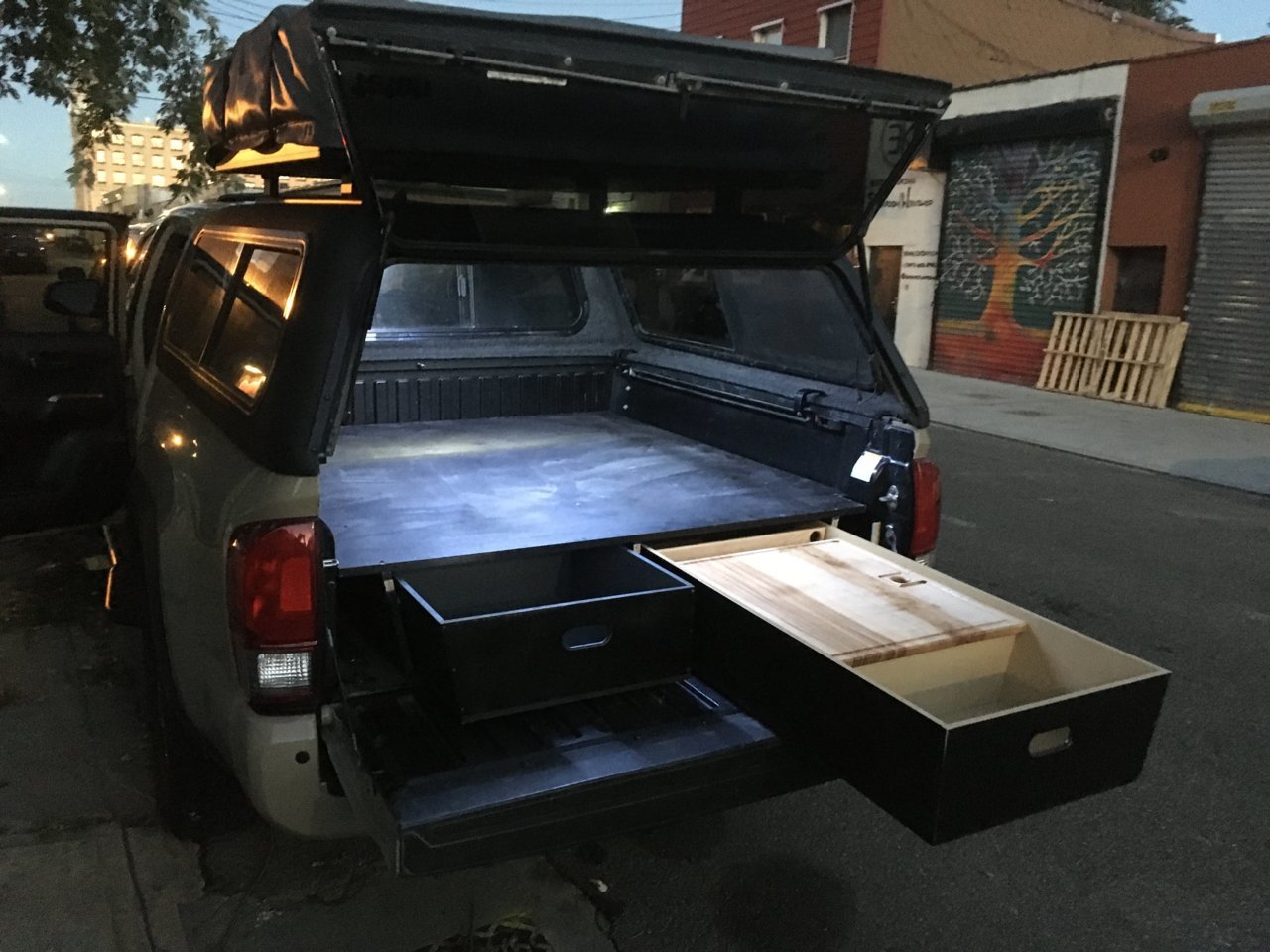

    I just finished this. Fun project to make. It's on a 2012 tacoma with a fwc project m top.

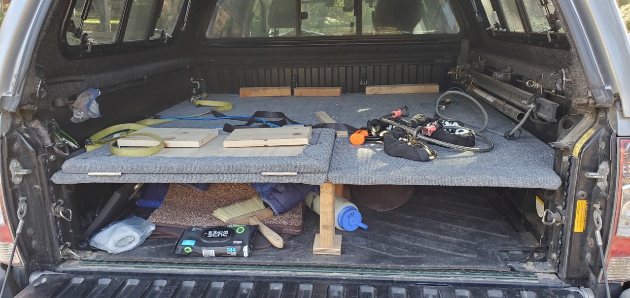

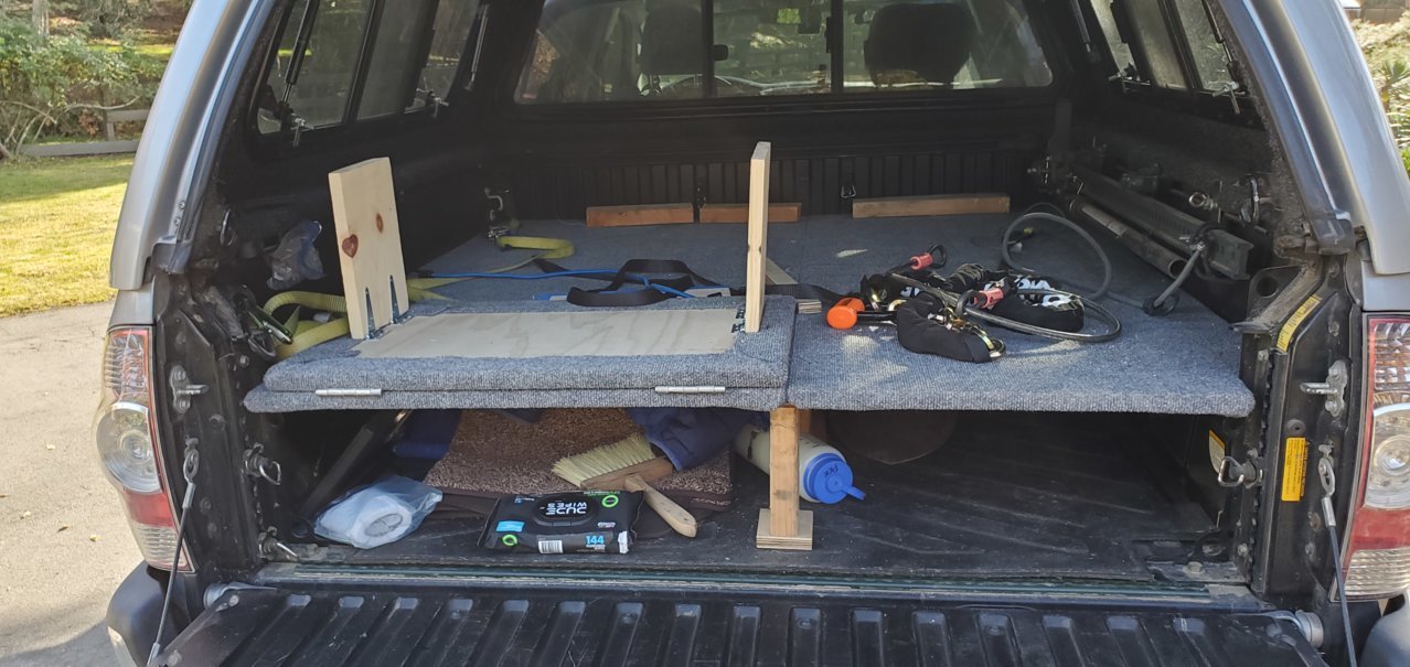

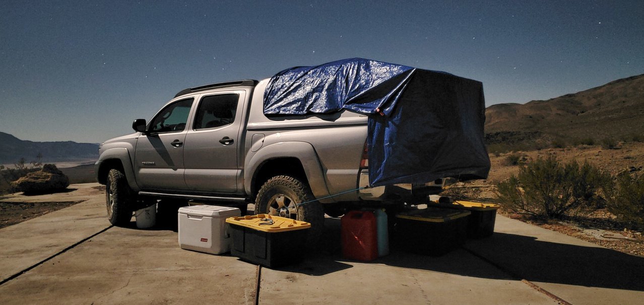

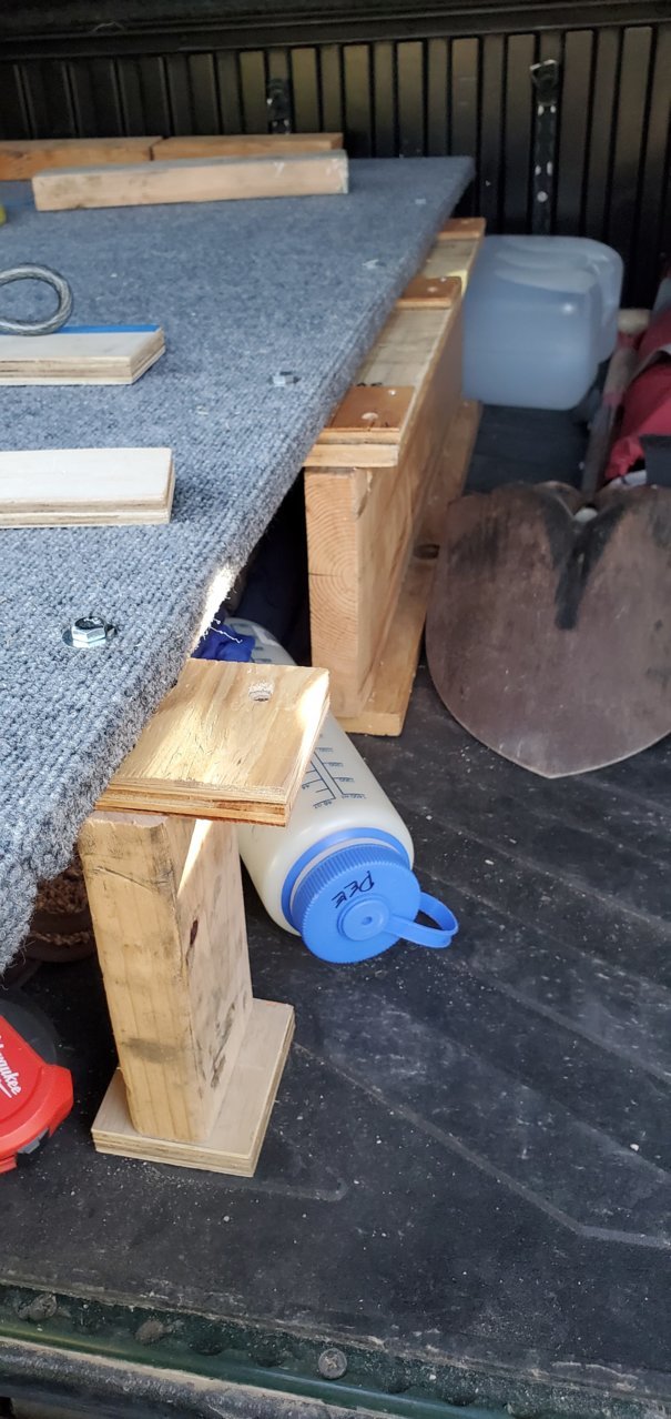

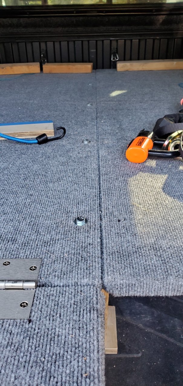

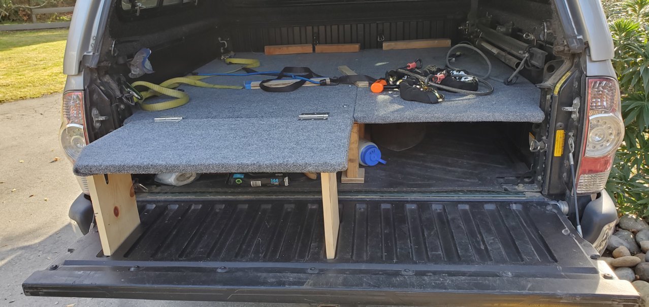

    Ignore the pee bottle and the dude wipes my father-in-law gave me. Built this last week, last minute, to replace my old platform which was not split lengthwise. I only use the platform solo, with my wife we will tent it, so therefore only one side extends to full length. I wanted to be able to have more headroom on one side to sit, pee in bad weather, etc...So I remove one leaf and set it the way you see in the picture or slide it under the sleeping platform (a little too tight, should have made the sleeping leaf .5-.75 inches wider). I made an I-Beam to support the center of the platform with holes drilled and tapped with t-nuts so that I can bolt down the platform and keep the I-Beam from walking about while I drive. When travelling I keep the platform whole and use the Costco yellow and black bins on top, I have a Snugtop Sport HiLiner so I can fit two of these bins stacked towards the passenger cab. I need to figure out what to do in inclement weather because when I use a tarp it flaps around so loudly that I cannot sleep. I got the idea for the flip-down extender from @bprout and I may have to look into his shell tent (see post #9523 https://www.tacomaworld.com/threads/lets-see-your-tacos-in-scenic-places.300429/page-477). Here is my photodump...
    Crom, WasabiOregon, WarrenG and 9 others like this.

    I'd seriously consider countersinking those bolts or at least switching to crown heads; even if it doesn't damage your mattress stuff will still catch on them or worse, if you're like me, you'll crawl in and kneel on them.
    Switch to a Nysil or similar tarp, they're a lot quieter than those plastic tarps. I've had to get up in the middle of the night to take one down the darn thing was so loud flapping around.

    @Bajatacoma Thank you for the suggestions! Yes, I knelt on the bolts and it did not feel well. When I tried to slide my bins around they would catch on the bolts and I would have to reach in all contorted to lift them making me feel as if I would pull a muscle. I have added that to my improvements. I just looked up the tarps you are referring to and that seems like the way to go for now. The tarp I was using sounds like cellophane when you handle it, haha.

    Nice build. I’m glad you’re looking into flush mount bolts. That will be a huge win for you. Here is another option for you to consider instead of a tarp. The DAC mid size fits Tacoma’s. They are about $160 on eBay or a little more on some other sites. Google truck canopy extension tent.
