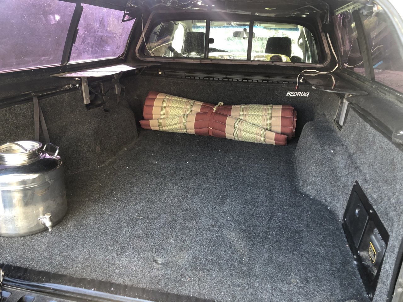

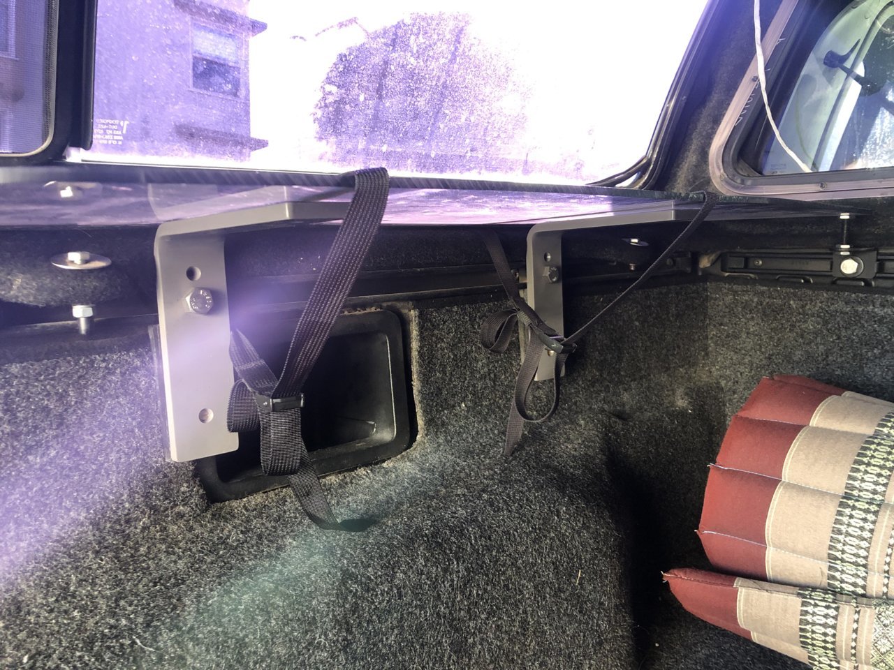

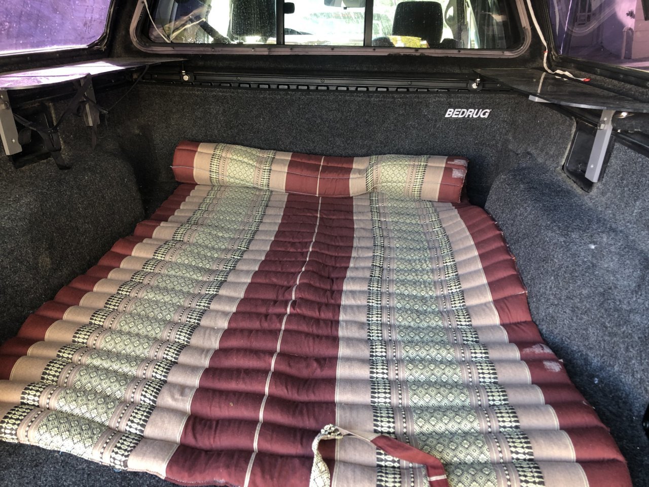

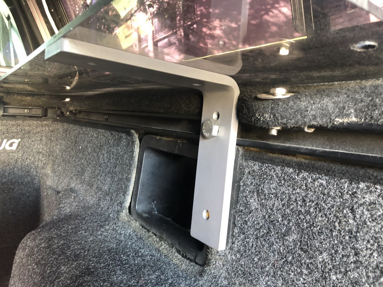

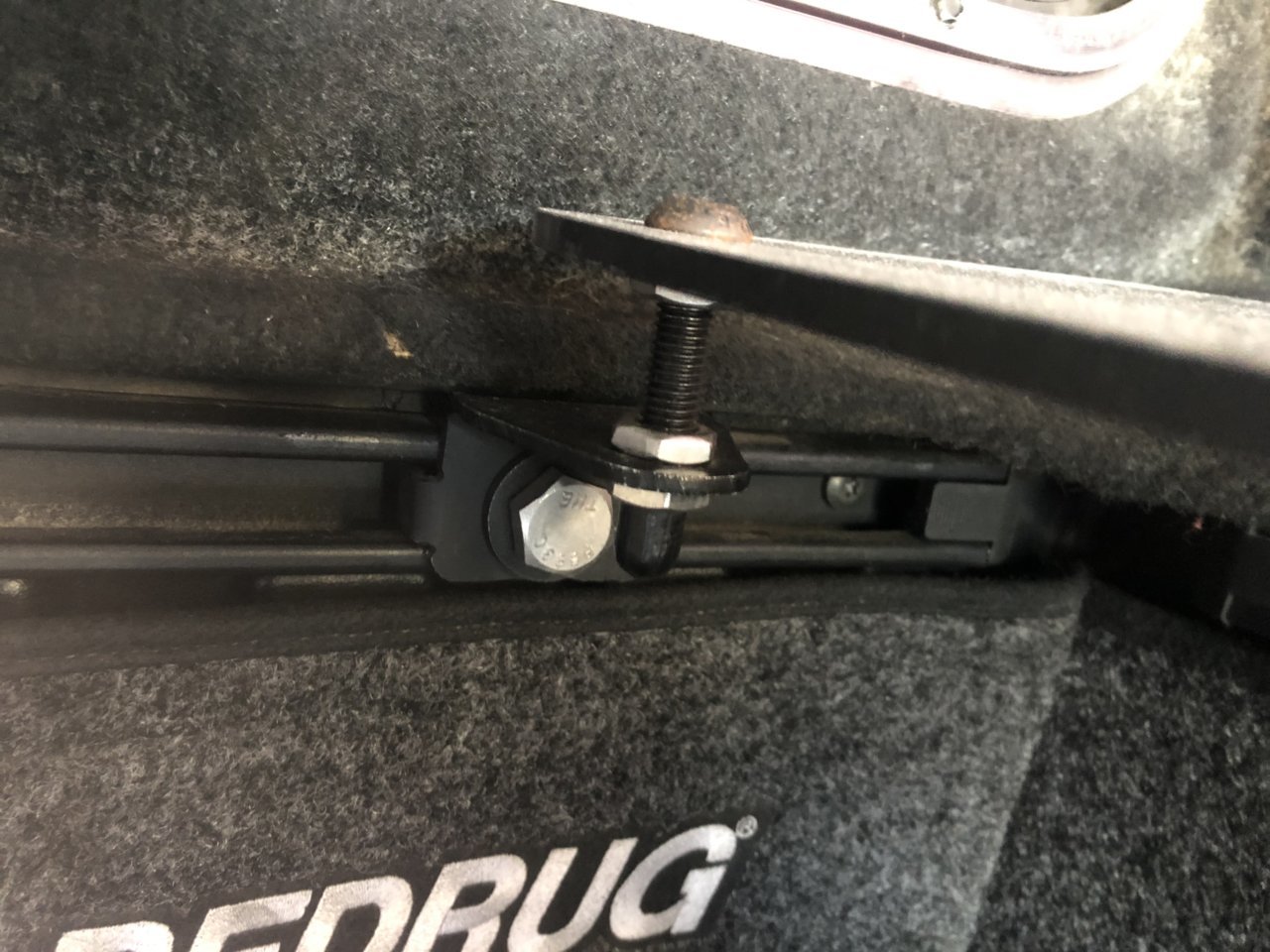

    Current setup. Its just some shelving on the sides with tie down straps. Benefits are that its super simple and I still have the full camper shell height for headroom.
    Disadvantages are that sleeping space is limited for two people between the wheel wells. Also storage is minimal and every night I have to bring stuff to the front seat. Its only a couple bins and bags but I'm going to get rid of this setup and opt for a platform.

    Do you have any other pictures showing the frame, drawer slides, etc?

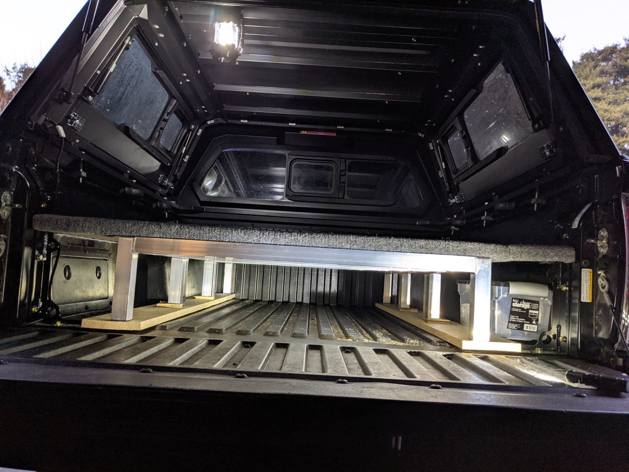

    Version 1.3.
    Still going with the one big pocket and the dunnage racks. This is sitting really well now. I cut out a 1" hole to go over the T50 bolt which sticks up a bit due to the bed stiffeners. I cut about 20 pieces of 1/2" ply I had laying around to 3" by 1" and screwed them to the bottom of the common boards (.75"x5.5"x60). This creates little runners that keep them in the track they are on in the bed. I then screwed some more of the 3" pieces to the top to make a border around the dunnage racks so they can't move either. I also took the bed mat out of the equation. So overall I gained about 1" under the rack and shaved some weight down. Its perfect now, I can still fit my camp chairs on either side and big stuff in the middle.
    I also picked up some 1" fixed casters from home depot for $1.25 each and test fitted it with an under bed storage bin and it fits with the casters recessed in the bed channels. (Another reason for removing the bed mat)
    Very happy with the stability now, I may do a do-over on the top ply and either do a 3 piece 60x30 or a 4 piece 30x30 to give it more uniformity and more options if I want to remove part of it.
    WarrenG, CXYyuppie, GsTACkO and 4 others like this.

    Simple is always good! What’s that bed Mat you have? Looks kind of like a tatami mattress but a bit more compact.

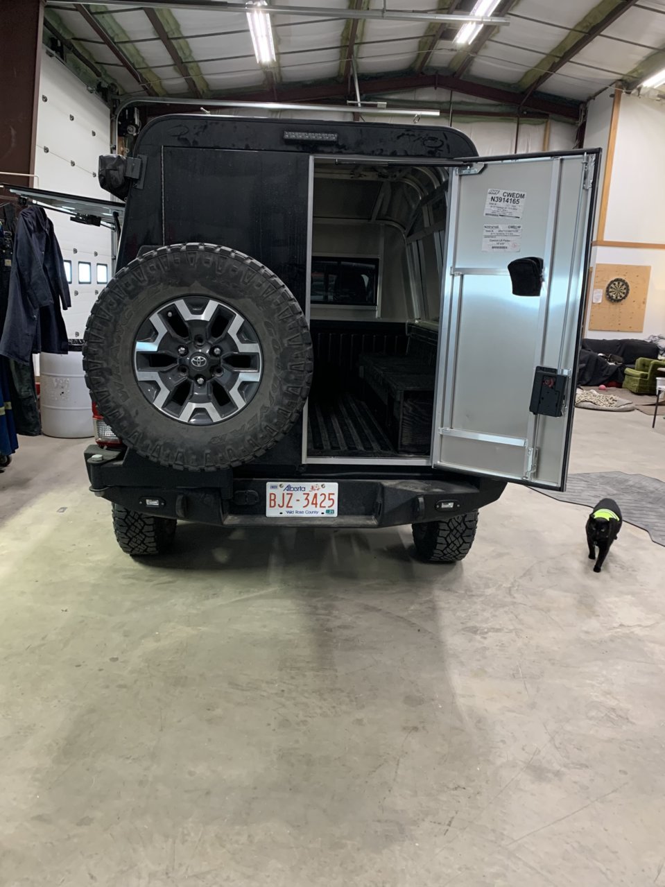

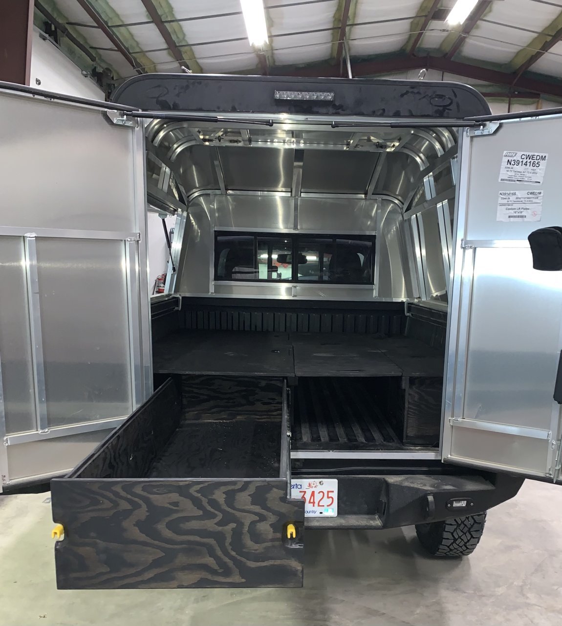

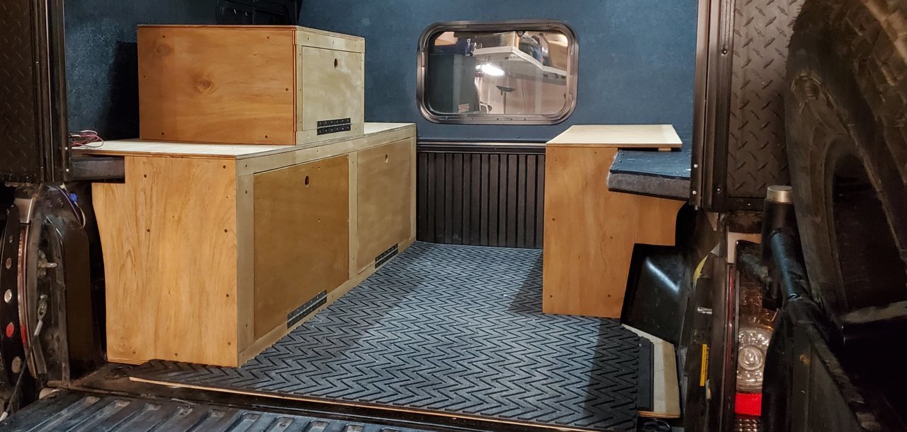

    I've been picking away at this for the last week or so. It's been a long time in the planning and I knew roughly what I wanted to do. It's nice to start to see it come together, and for the most part it's turned out better than expected. We spent a few years camping out of the back of a 4Runner and decided to go to something with a little more head room.
    Went with a 5 foot slide set back the extra foot to leave a space at the front for easier access. There is also cutouts to get into the drawer from the inside.
    Wanted easily removable panels so that we could sit up inside, it also fits inside a groove in the slide to act as a large table and another panel that doubles as a small table inside.
    The slide can still be closed with the panel in place, and the final panel can be stored in the end.
    Jackery has a fixed home with an edge around it to protect any cables that are plugged in from stuff being moved around.
    Single sided swing out I had built that still allows one door to be opened without swing the spare ,it does block a small portion of the brake light but the photo makes it look worse then it is, and I have the @MESO total tail kit installed so the turn signal is relocated and very visable.
    Thoughts, comments, improvements?
    I have small magnets that I will be using to keep the panels in place and I am having cushions made to fit the 3 main sections.
    djm68, 2Toyotas, Ngneer and 14 others like this.

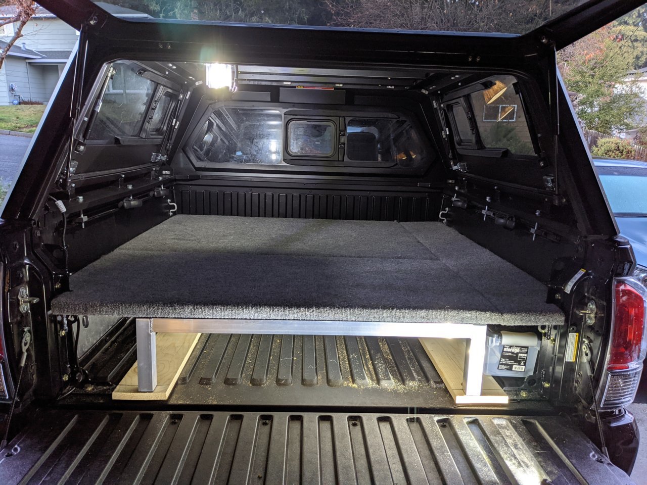

    Dont even own a taco but love this thread, great seeing everyones ideas and sharing pictures.
    I “stole” this idea, but think it would be great for some of you guys/gals to gain a lot of space. In my case, i gained about 70% real estate.
    This would be very useful to the short bed crowd.

    If slide outs are your thing check out Brian at Offgrid Backcountry Adventures. He built a slide-out that takes in the tailgate to turn five feet into seven +/- for sleeping

    They are 2, aluminum ARE service caps from a 7’ long box Ranger. Made an egg sandwich.

    Its an ARE 26-32 wedge.

    Sorry, I was talking about my canopy being a wedge.
