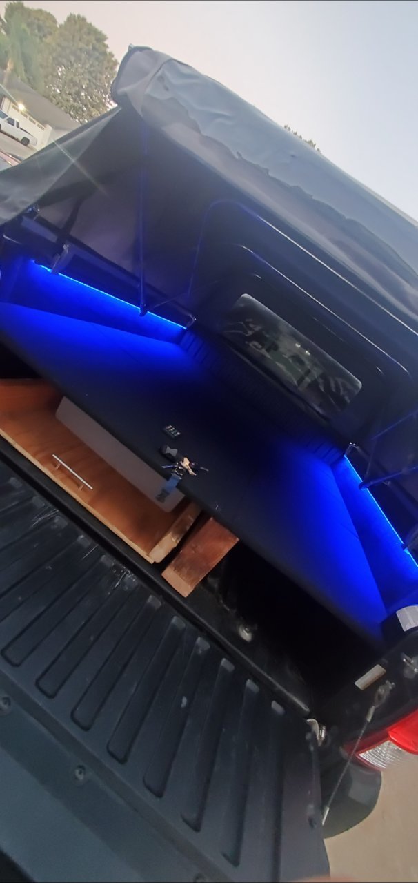

    Just a simple platform for sleeping on and a slide out board underneath for storage. Covered with a softopper

    This is the kind of setup I eventually want. How are you preventing the half-drawer/platform from sliding?

    What drawer slides did you use

    I know for myself I just had the base of the platform overlap the bed bolts and used those.

    Do you do anything to seal the gaps between the caps and the pull out.

    that was the tricky part...
    The wood is the “baffle” between the cap and the pull out. It is tensioned against thick weather stripping that is on the inside of the cap.

    I see. I have a bed mat I'd probably want to keep down there without cutting in half or drilling holes in...hm...

    You could probably use some turnbuckles to the factory tie downs and maybe something like these to try and secure it to the bed rail, should keep it from moving if you didn’t want to drill any holes.

    The kayak hitch is a great idea for support! I went with pipe clamps for support, they work fairly well.
    Just go for it, i did my first one out of wood to make sure it would work, pretty cheap experiment.
