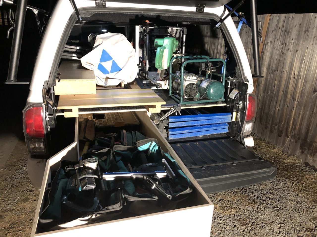

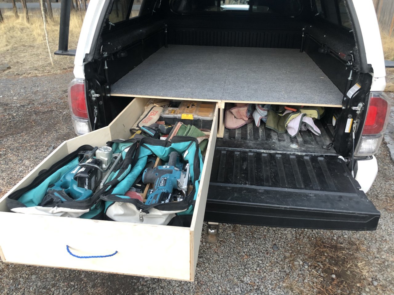

    Here is mine. used about 1 and 1/2 sheets of 1/2" baltic birch, plus a half sheet of 1/4" ply. The ply has a prefinished side face down so it has less friction. I will need to add some poly plastic strips at some point I am sure. The drawer is easy to opperate as is. the left sheet is not attached and can be easily lifted up. I had a platform with drawer guides made from steel tubing and bearings and 3/4 ply and it was too heavy. Its important to stay light with these little trucks. IMG_1935.jpg

    Looks good. What part of the build uses the 1/4" ply? Is it holding up?

    the drawer bottom. It is glued and stapled with 1/4" crown stapled to the plywood drawer sides through the bottom. should hold up a lifetime.

    Love that you made it wider at the end/didn’t lose space from the wheel well.

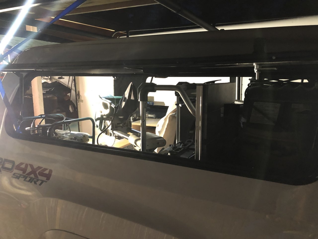

    Here's the progress on my current one. After making the last one out of wood and suffering warping and mold due to water intrusion, I decided to go hardcore with this one. Even after sealing every possible spot on my canopy, the windoors continue to leak with no solution.
    1" steel welded crossbars with 1" steel runners. I'm going to add one more bar at the center seam and a bar connecting the top holes of the bed stiffeners to support the front edge. 3/8 starboard. Will be topped with marine decking and instead of a standard drawer type, going to do more of a slide type thing. Still working on that

    I can get you some measurements. the bottom of the drawer is prefinished maple 1/4" plywood and it functions pretty well, even loaded up with tools. Im sure it will get worse but i plan on getting some poly plastic (white slippery stuff) to make it better in the long run. My last truck i had the drawer with skateboard bearings but to me it was too heavy and over kill. this drawer fully extended doesnt even really sag and lift up on the bed platform.
