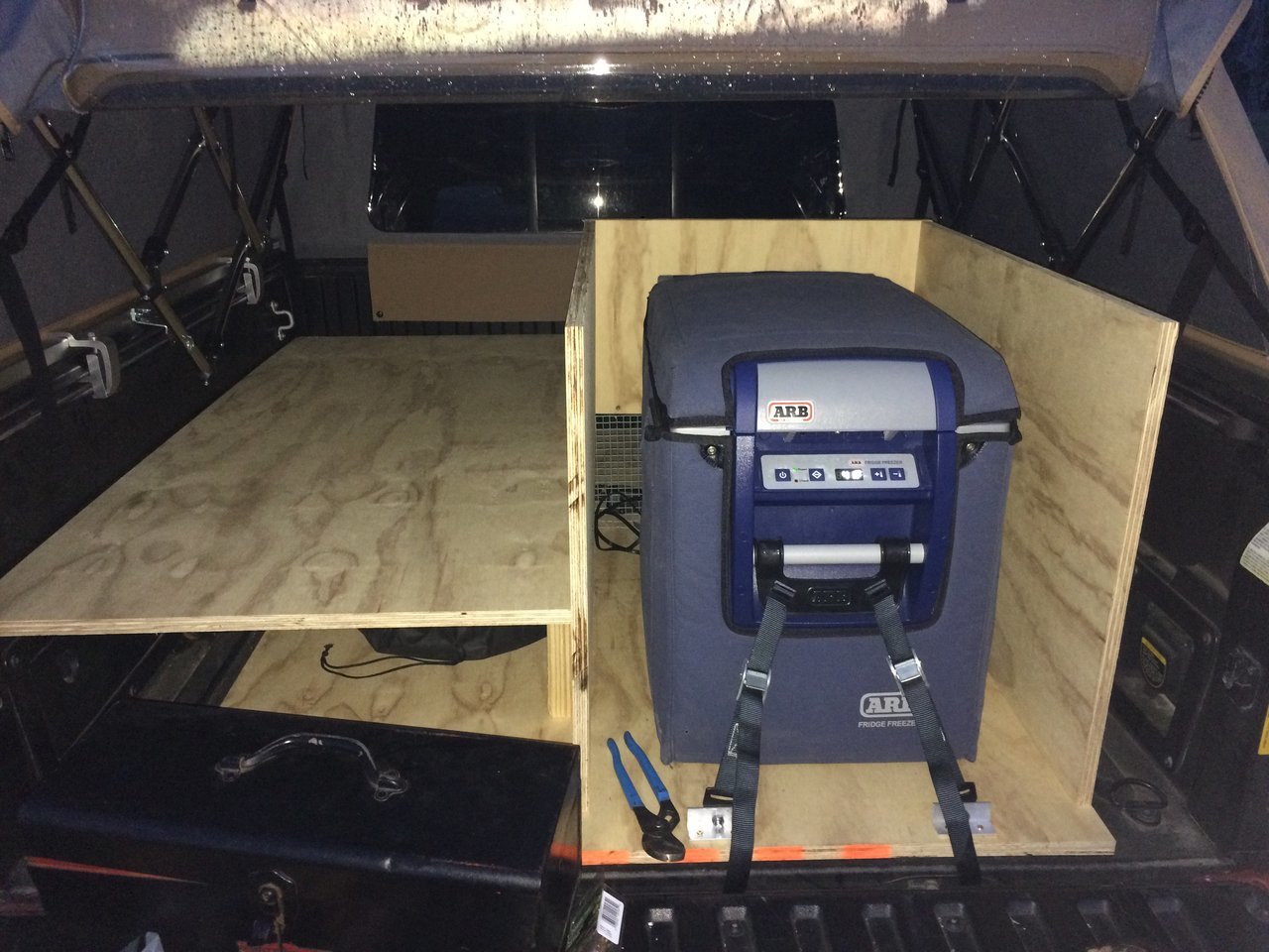

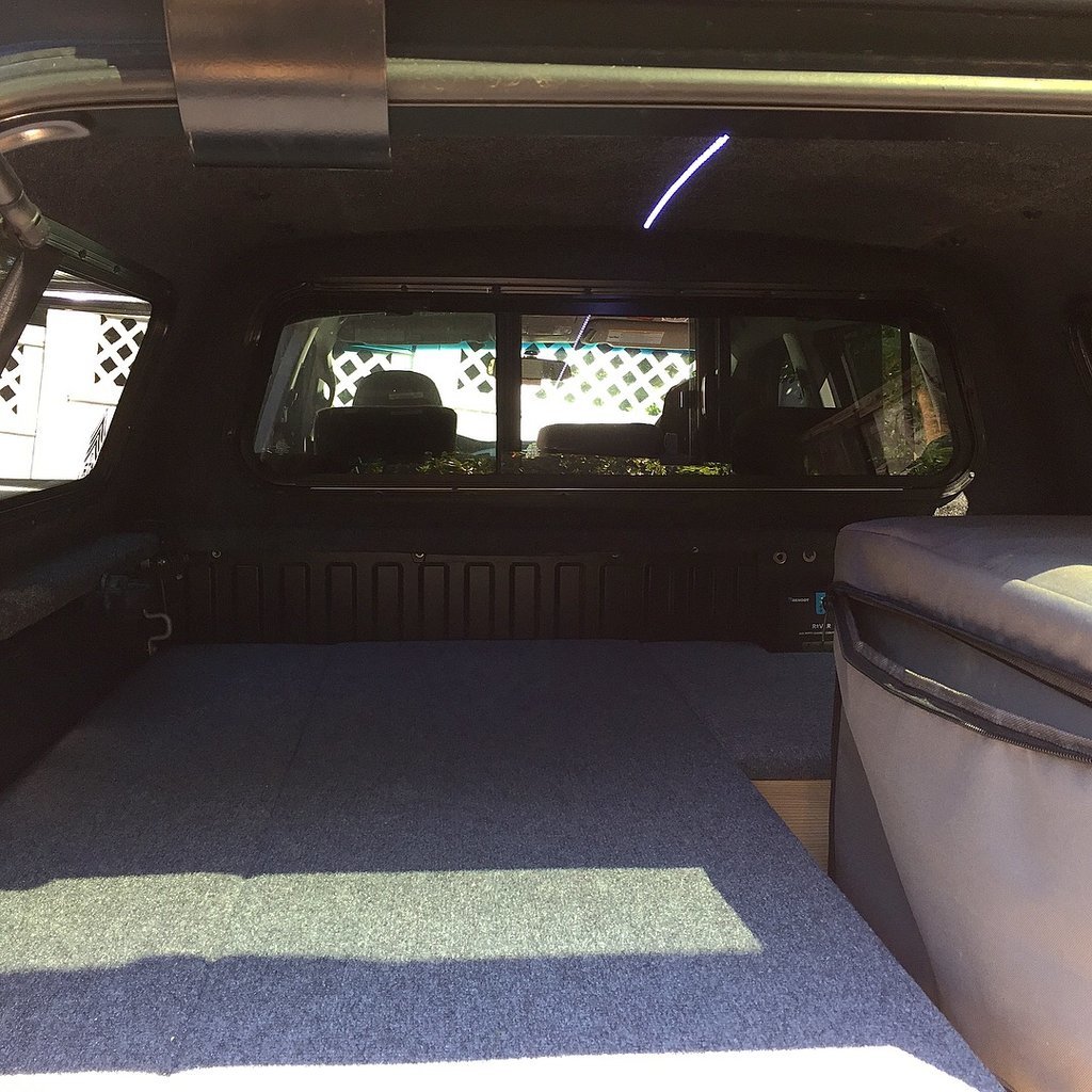

    Heres my setup i made for extra storage and a box for my ARB fridge in my dcsb

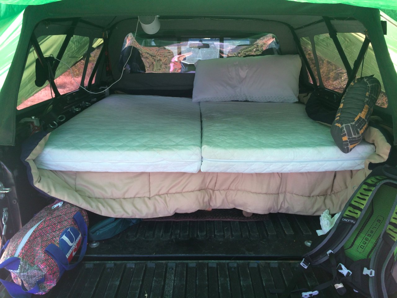

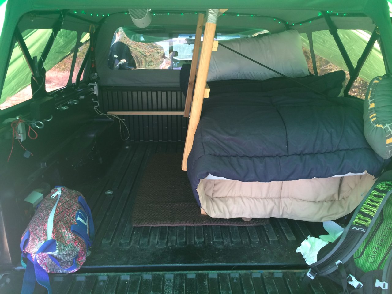

    Kept it basic and removable. As I said, I can sleep diagonally, no problem

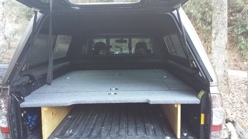

    Yes, I have a turnbuckle on each of the 4 corners holding the frame to the Whatchamacallits attached to the bed.
    The top carpeted pieces are not, except for the front hinged piece forward.

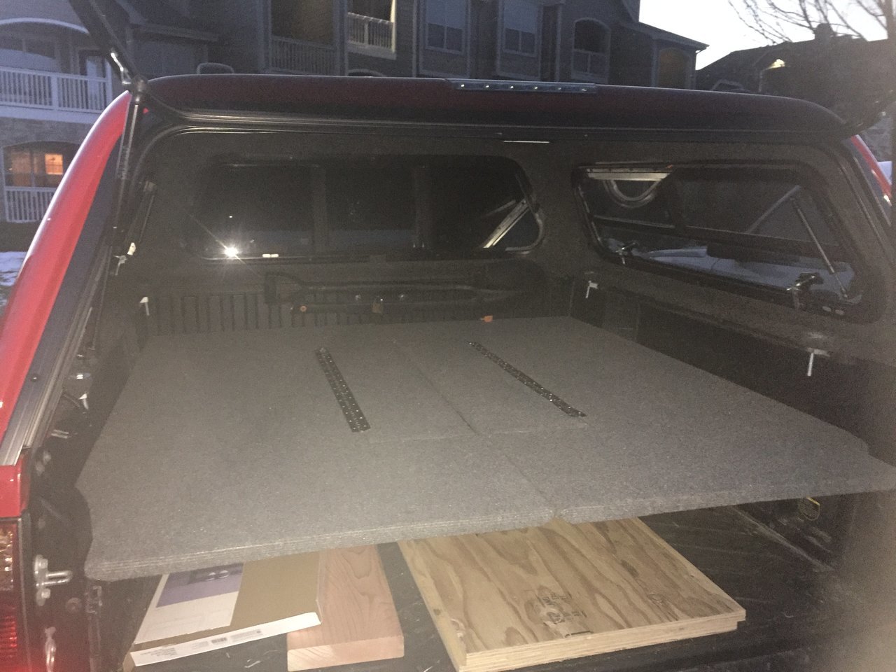

    Here's my platform that I've been working on(not finished, needs foam padding). Very common setup of 2x6 sideways in bed cutouts supporting plywood. I'm about 6'1" and the last time I slept in back I didn't have the platform yet and laid at an angle with pillow in corner. With the platform it will be much nicer not dealing with the wheel wells.

    It wasn't the greatest but had some bad weather roll in and didn't want to setup the ground tent

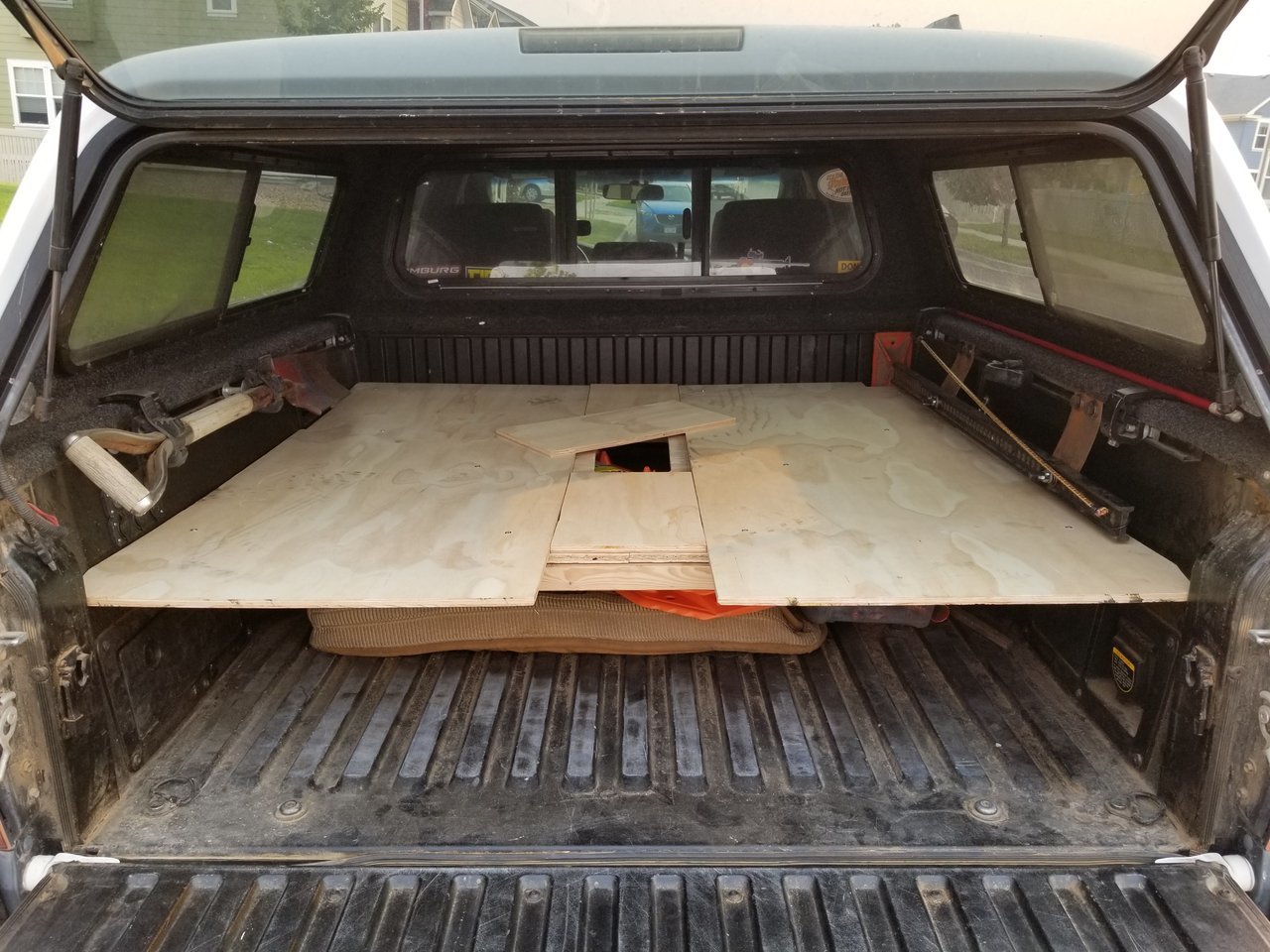

    Went with 5/8 plywood over notched 2x8's. Glued marine grade carpet over the two pieces of ply (stretched & stapled on the bottom).
    Pretty happy w/ how it turned out. The dog is a diva and really likes when the full sized mattress is on the platform.

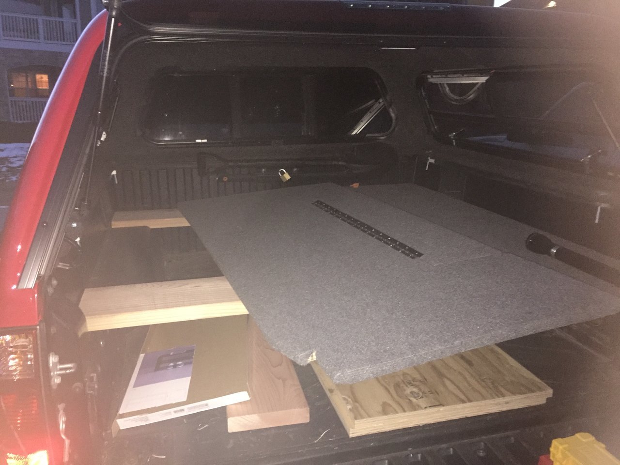

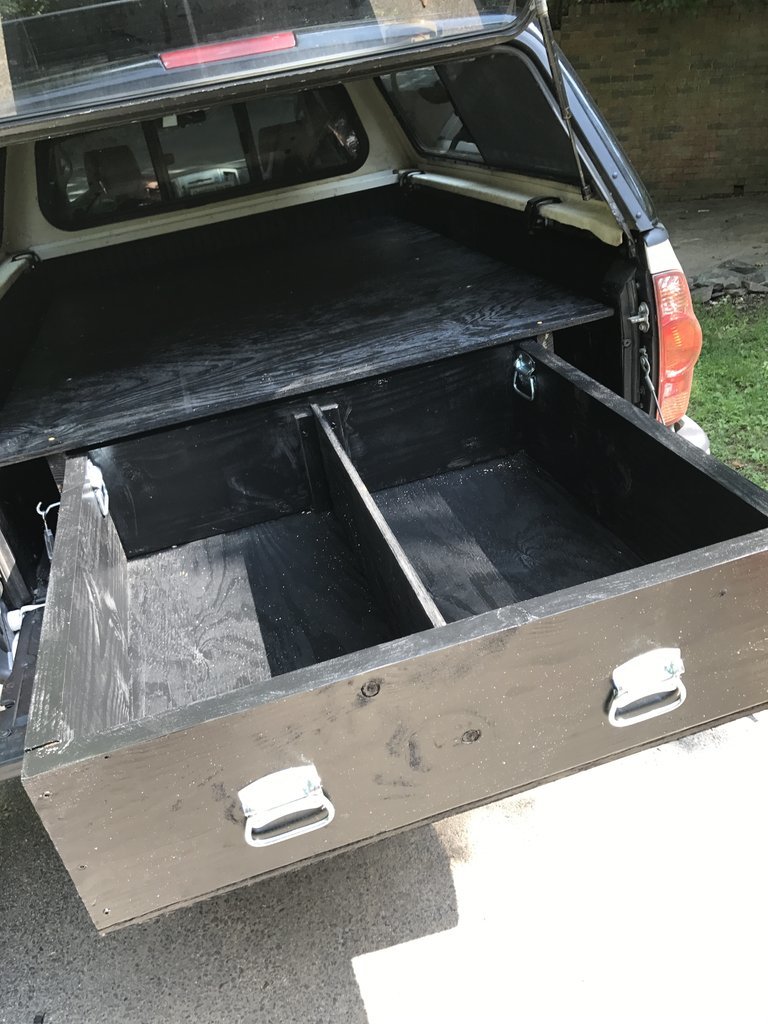

    Got the platform thing all finished up. Overall I'm very happy with it! I'll probably pull my back trying to get the tire out, but it should come out.
    The drawer isn't on slides or anything, and when loaded with tools it's heavy as fuck. I'll probably get slides at some point. I did put handles in the back of it so the whole thing can be lifted out if needed for some reason. Also the divider in the drawer is removable if needed.

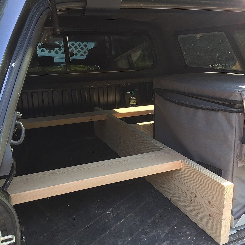

    2014 Toyota Tacoma TRD Off-Road
    Bilstein 5100 (front) | OME 885 springs | Bilstein 5160 (rear) | OME Dakar medium leafpack | JBA UCA | Cooper S/T Maxx 265/75 R16 | ARE Z-Series topper | Renogy 100W solar panel | SnoMaster TR42 fridge | sleeping platform | Mobtown sliders | Custom Car Grills grill insert
    Built a new platform today to fit around the SnoMaster fridge. 2x6 cross beams, 2x10 center support, 3/4" plywood carpeted. I used 3 pieces of plywood because they were left over from my previous platform.
