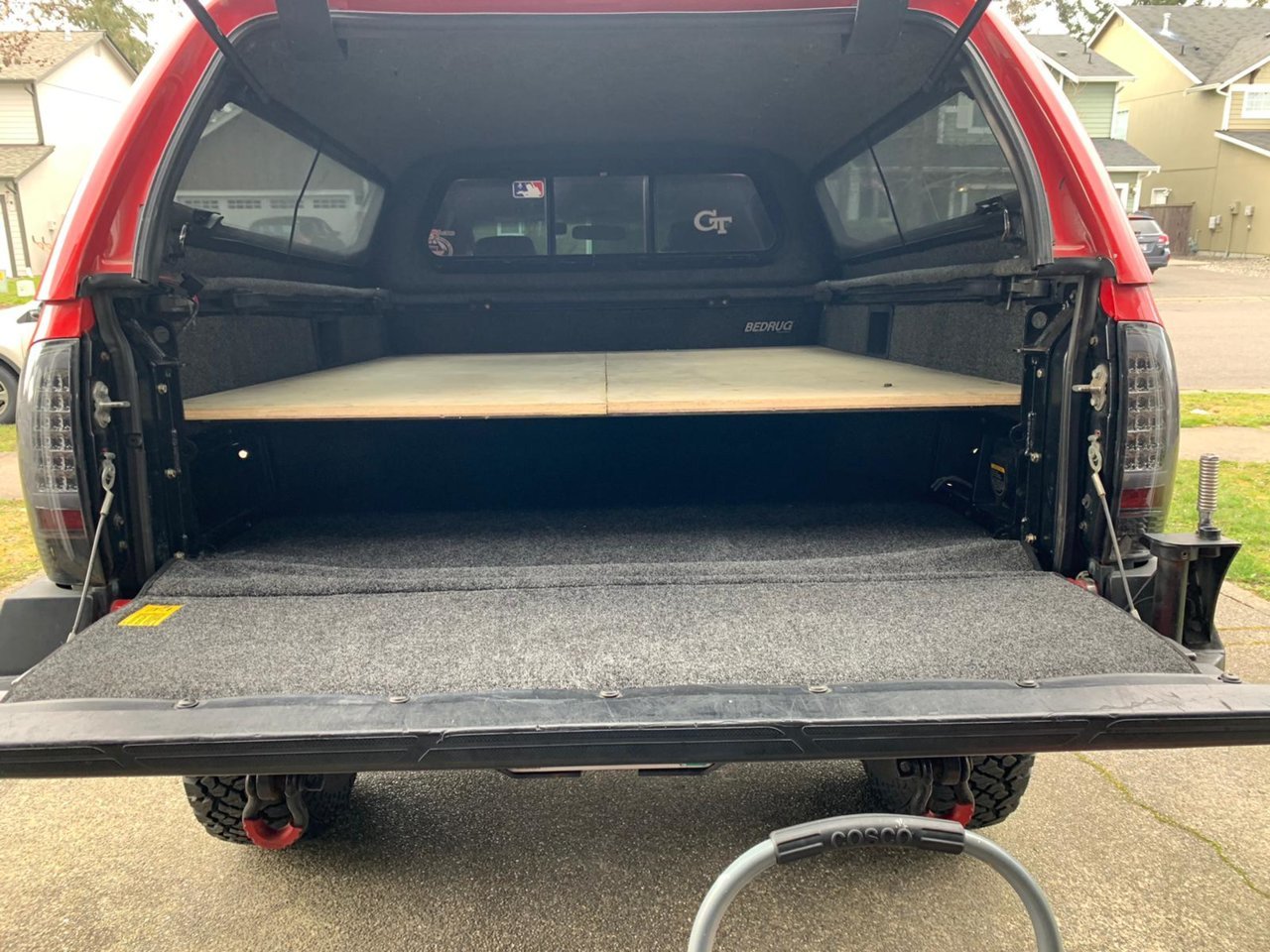

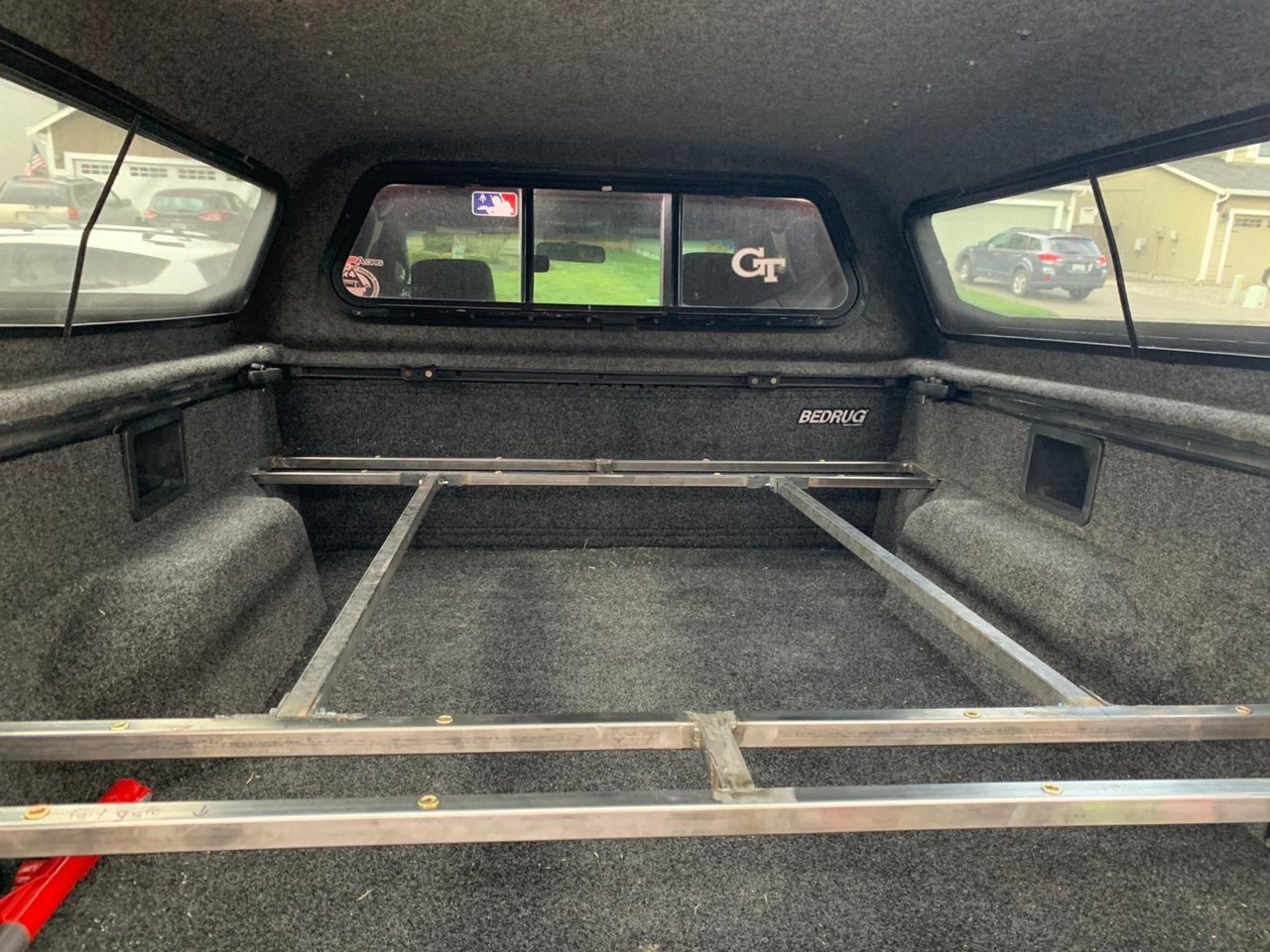

    the cross bars are bolted to gether from front to rear. the ones going side to side are welded together. made the ones running from the front to the rear bolt on so i could remove everything. otherwise it wouldnt be able to come out. i used rivnuts to bolt down the plywood and recessed the bolts.

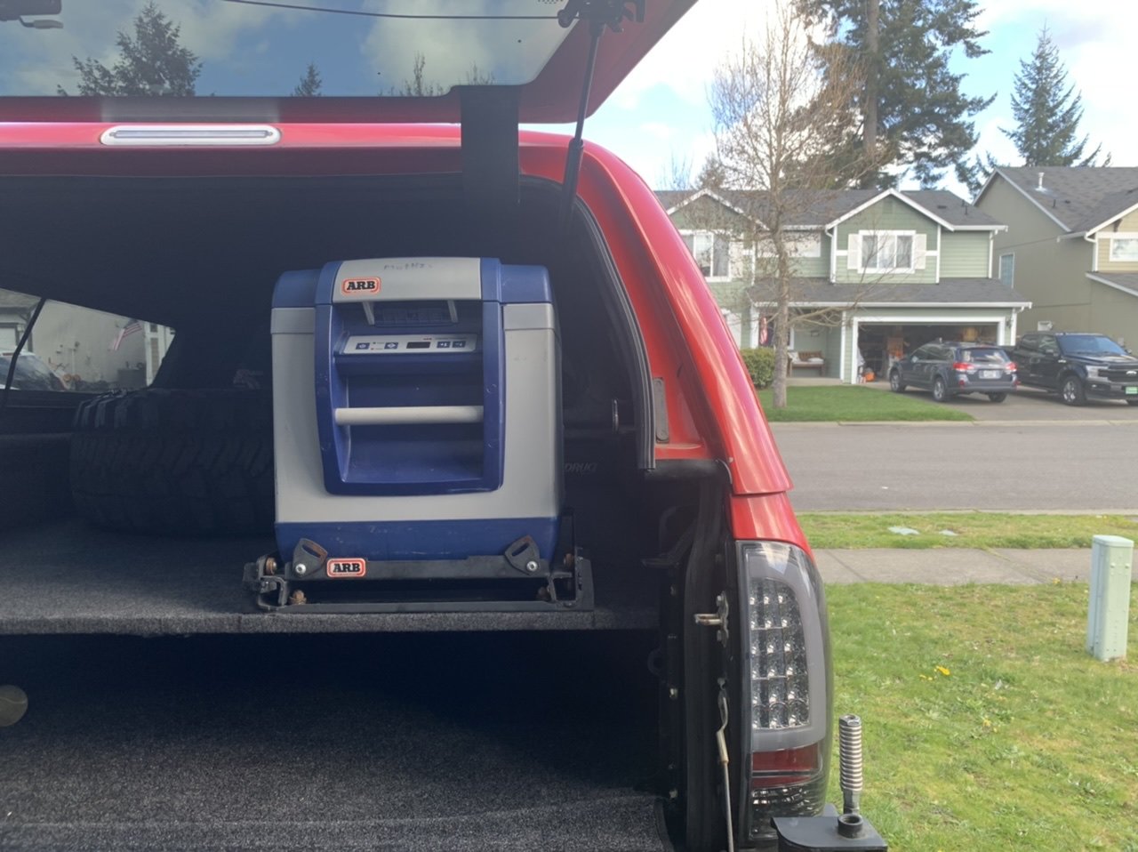

    Mounted my Fridge in the back too.
    Still need to get a mattress and thinking about getting this one. https://www.ikea.com/us/en/p/lycksele-loevas-mattress-20102074/
    should fit perfect in the back. only issue is the fridge. that might have to get moved into the back seat while sleeping if i have my wife and daughter with me. atleast in the future. my daughter fits perfectly behind the fridge right now. just might have to do something different for the mattress situation tho

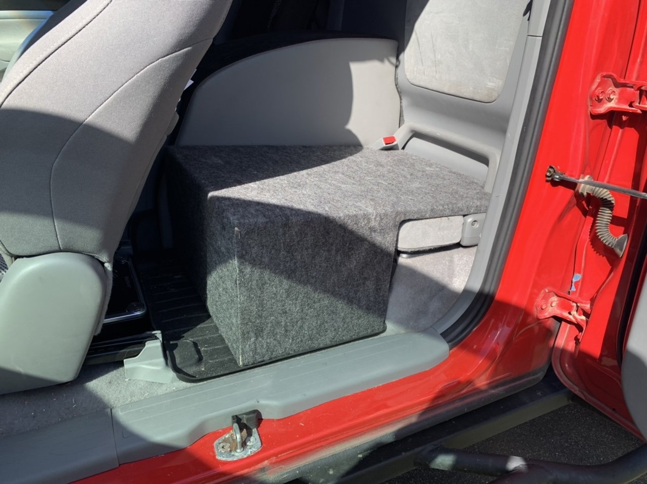

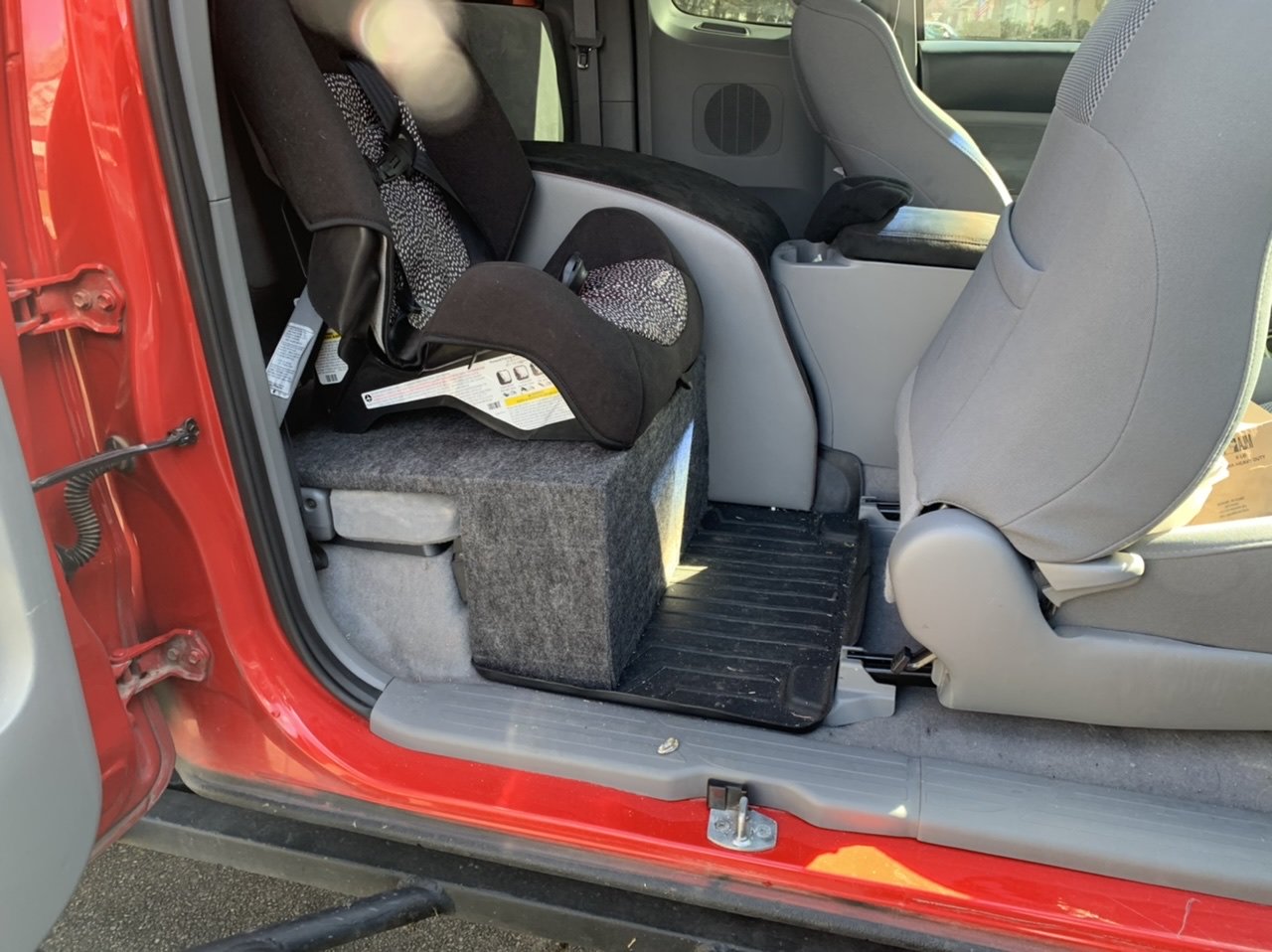

    made a platform for each side of the access cab. reason for 2 different ones is because i have a 10 in sub in the middle. mainly did this so that my daughters car seat had a more stable base.

    Fridge fits fine where it’s mounted. Only thing I have to do is remove it and put it behind back seat while sleeping. It fits behind the drivers seat as long as I’m not sitting in it. I could sit there but I would have the back so damn vertical it would be uncomfortable. For now everything works. Is it a little inconvenient? Yeah a little bit it works. No different if I just had a cooler that I would have to remove out the back to sleep.
