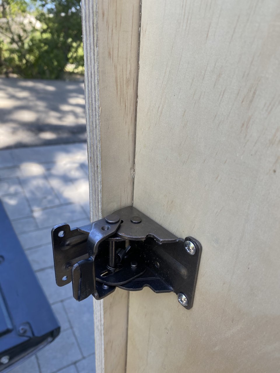

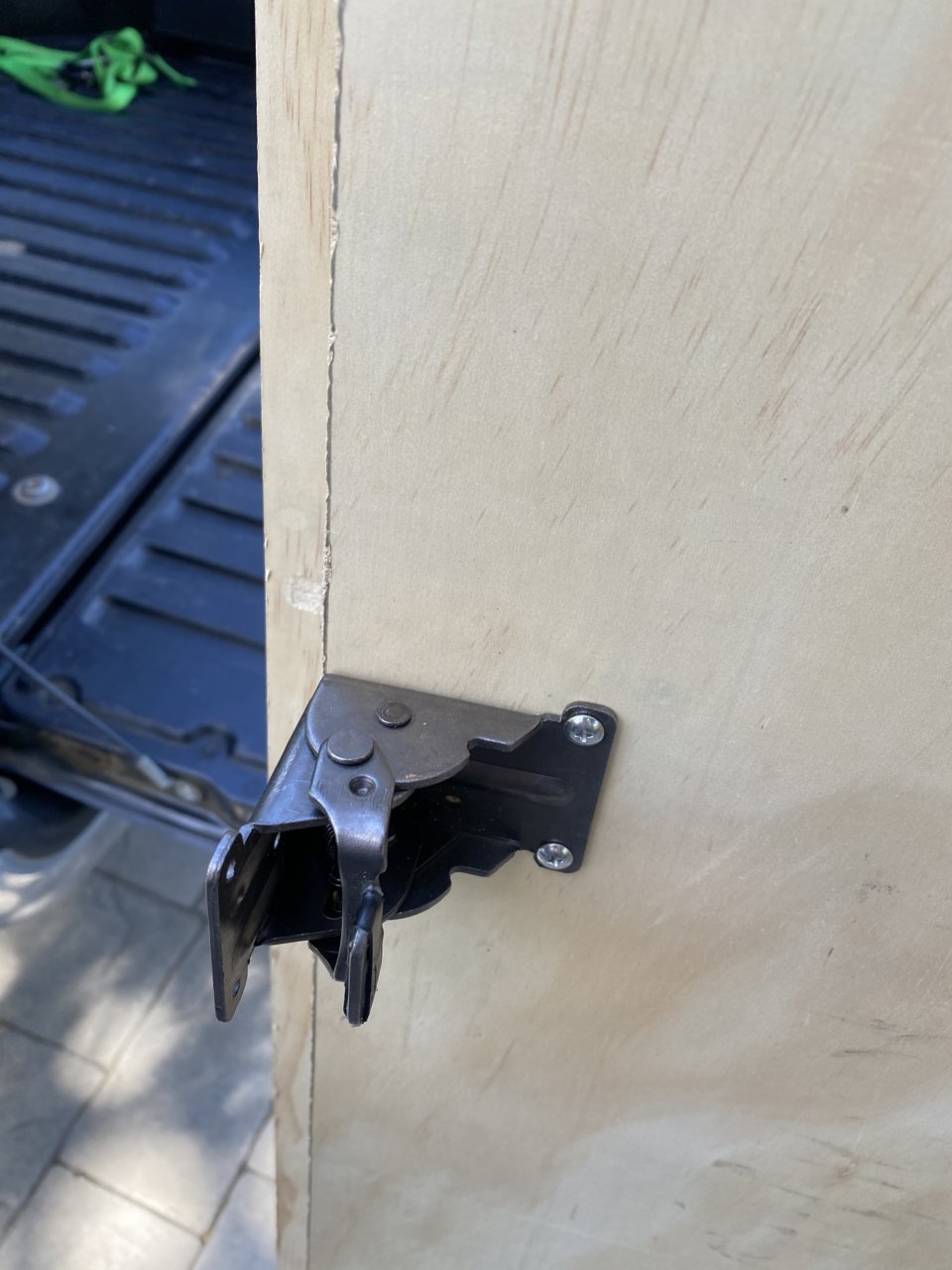

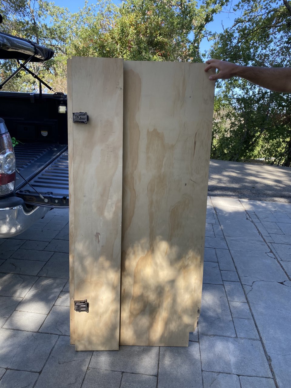

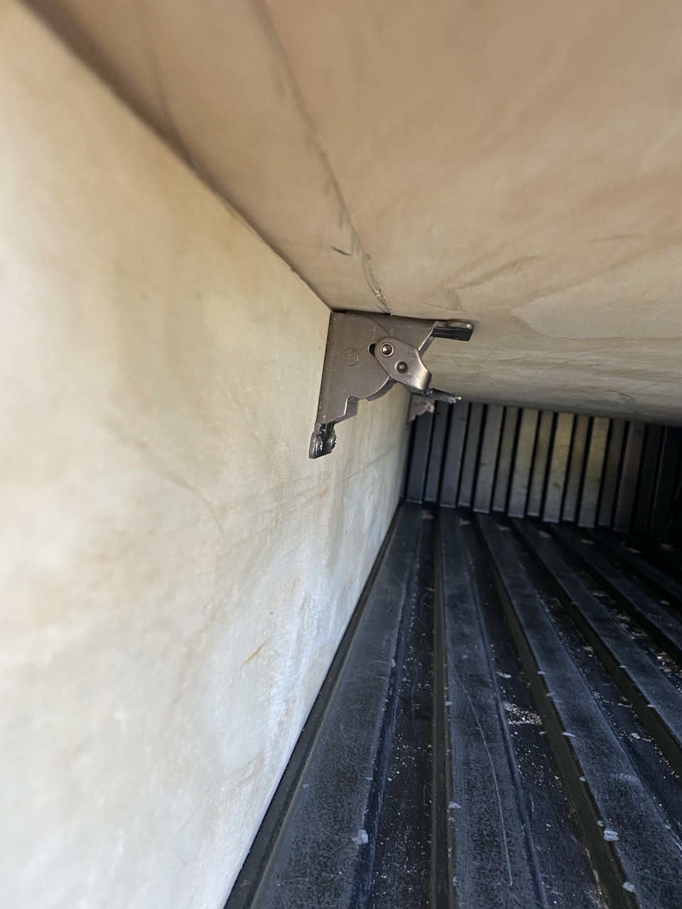

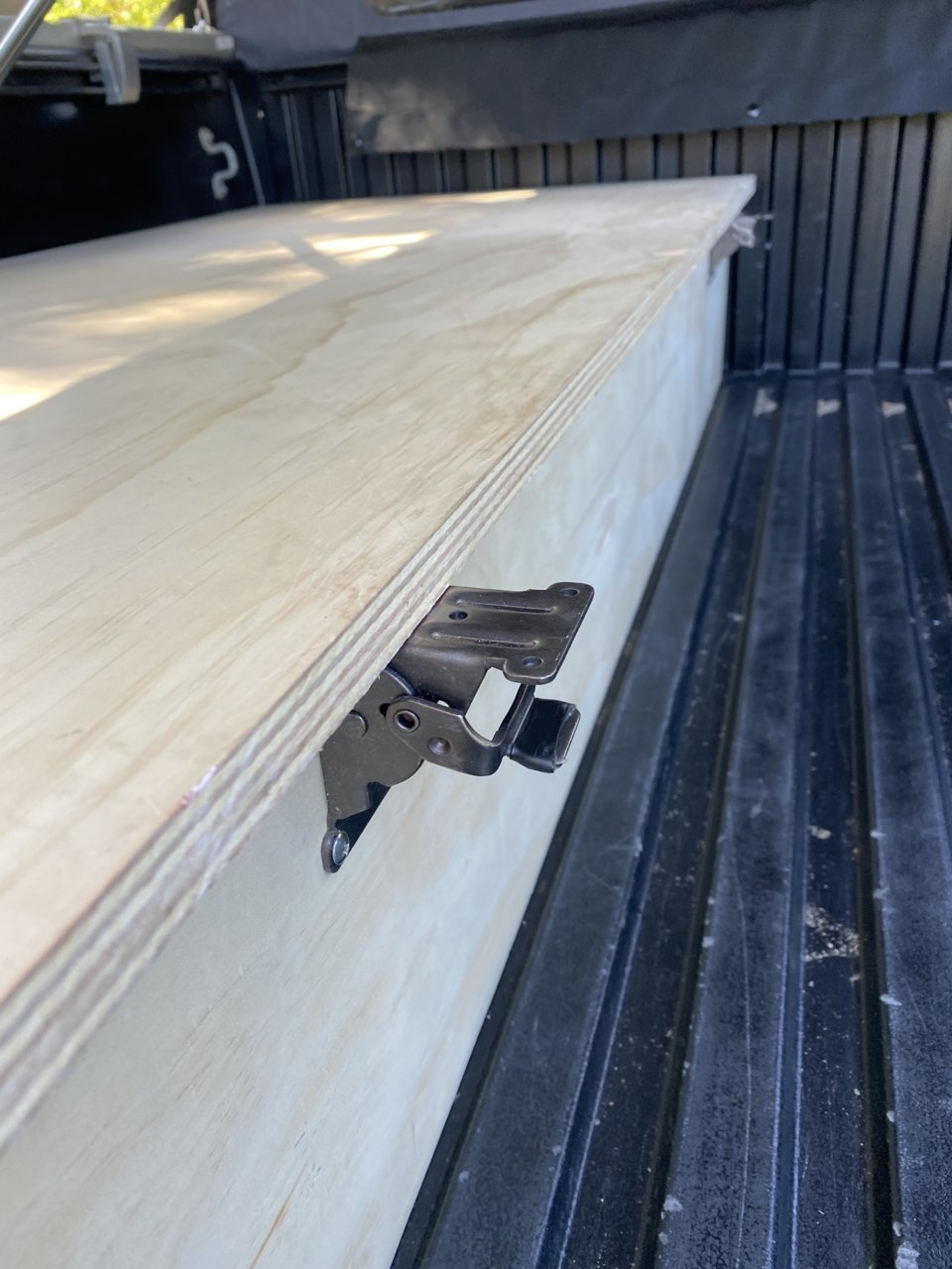

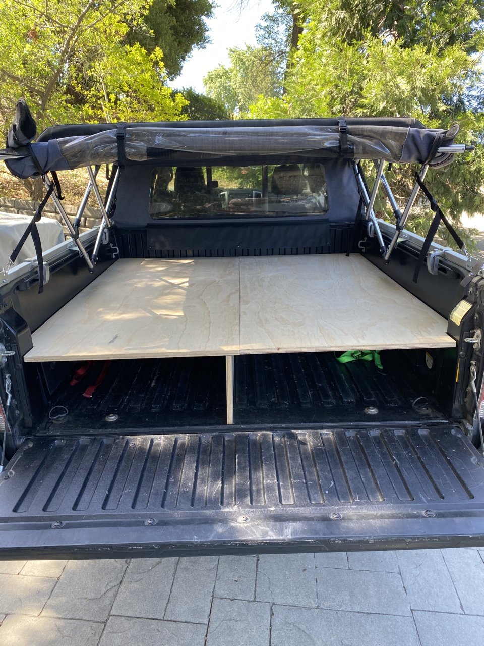

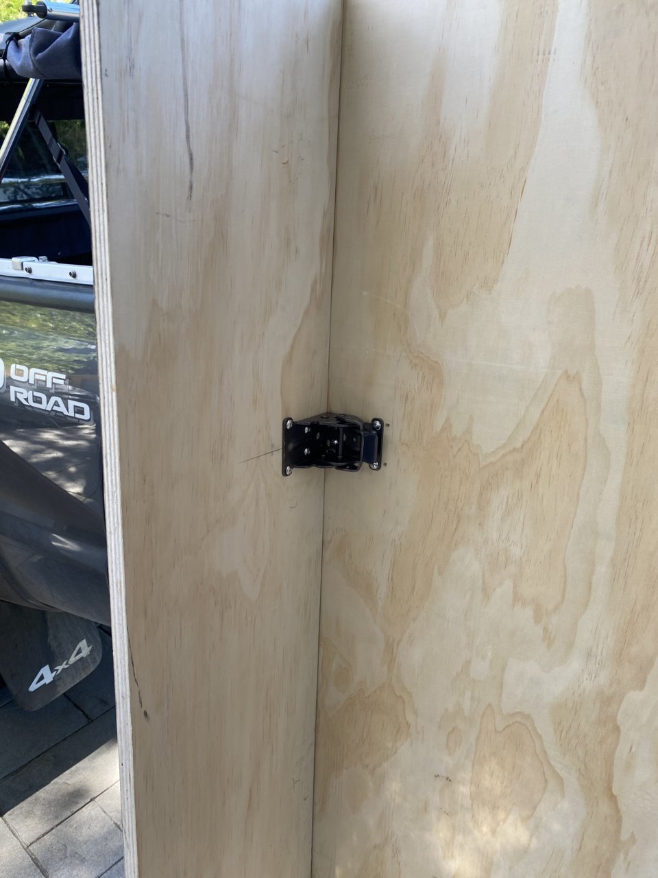

    3/4” Ply top planks and center runner. Hinges fastened to the center runner (driver side) are approx 14” from edges. Hinges fastened for the passenger side plank are approx 10” from edges. Used supplied hardware.
    Hinges used:
    https://www.amazon.com/dp/B06VTJZHS6/ref=cm_sw_r_cp_api_glt_fabc_QGBAVDYH61F18E0TMBV3?_encoding=UTF8
    Bed Dims used:
    https://www.tacomaworld.com/threads/detailed-bed-dimensions.400407/

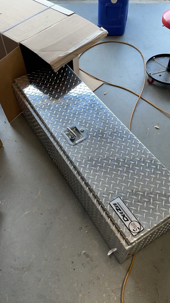

    #2642
    Fast1

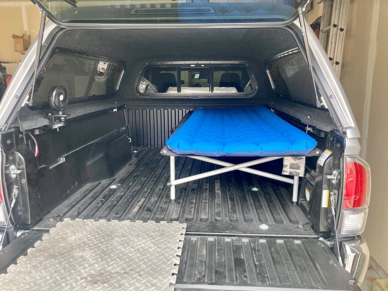

    Has anyone ever tried something like this for simple ultra-light, easily removable solo use in a mid-height topper (Leer 180)?
    Cot (Teton Sports, 25" wide x 72" length) is ~10 lbs and I use a Big Agnes Q Core Deluxe sleeping pad with a R4.2 warmth rating and 4" thick at less than 2lbs with my Marmot 850 down sleeping bag.
    Thought I'd throw in a few plastic bins to store things in.
    Could cut the legs an inch or two and get the cot lower but then I'd sacrifice storage space underneath for infrequently used items like traction boards, tow strap, tools, pump etc..
    So I have maybe 20 lbs of cot, sleeping pad, empty storage bins and sleeping bag
    before other packable necessities.

    Yep...that’s about how I roll. You can search for my previous posts with photos. Gotta love simplicity.

    that is probably what I will end up doing honestly...easy in/easy out. Easy to store when not in use. All of the "built in" drawers, and bed ideas are great, but almost seem to be too much for me.
    I like minimalist approaches, and I can use camping gear I already have.

    Well I planned on screwing the 12” vertical boards down into the base. I guess that’s why I was thinking 3/4” base.
    As far as the drawer length, it will be around 54” long by 32” wide. I’m building the platform to sit level with an aluminum truck tool box.
  19. May 21, 2021 at 9:20 PM
    #2659
    Pointeman
    Pointeman Well-Known Member
    Aug 11, 2017
    #226590
    1,814
    Mark
    2013 Pyrite Mica Tacoma DCLB
    6" Fabtech Amp Research hydraulic steps Front Runner Cab Rack Leer 100xr topper w/rails 17” Black Rhino Warlords Dark Tint 295/70R17 Nitto Ridge Grapplers
    Nice box. Makes perfect sense now. Looking forward to seeing pictures when completed.
