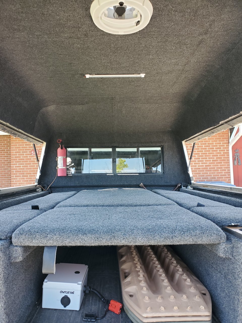

    Not much, but it works for drill weekends and exploring the back country.

    I like the little bungee cord you've got going across the back there. Nice and simple retention solution. Do you have access to the area in front of those bins, or is it just dead space?

    Thanks! Form follows function, or somesuch. The cab side is not dead space. There's a thin plywood divider added to the middle 2x4 crossbar that prevents the boxes from sliding back too far, and provides storage for things I don't need as often (read, anything not to do with fishing or brushing my teeth). The back platforms each have a finger sized hole cut in them and lift right out of place to expose the storage underneath.
    I went down and snapped a few more photos showing some of the updates I made and how things work if you or anyone else is looking for some inspiration. I updated some of the photo descriptions with more detail too in the media gallery with these photos.
    Probably the thing I'm most proud of is that the whole things comes apart in about five minutes if needed. I also sometimes take the top platforms off and use the frame as a support to load full sheets of plywood in and clear the wheel wells (which is why the gateside supports running the length of the bed are cut at an angle)

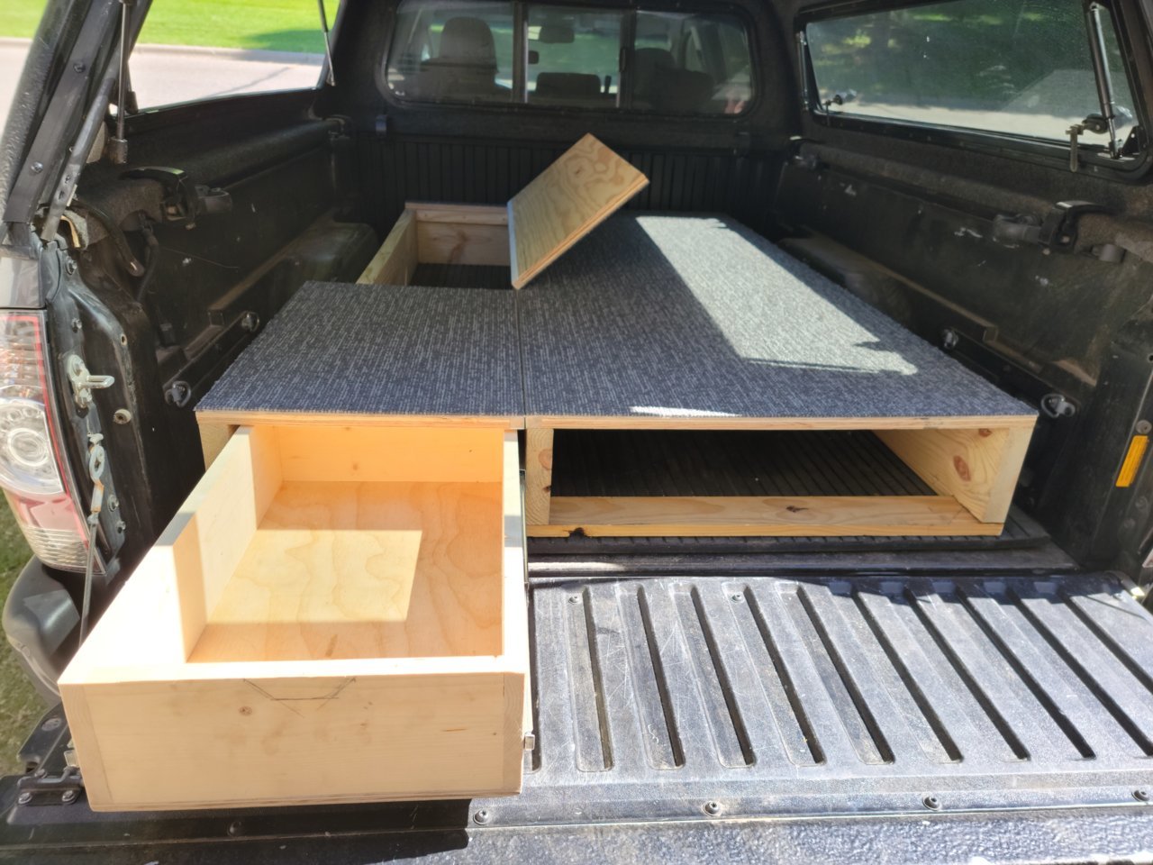

    Threw this together with some scrap wood. Glued some carpet squares to the top. My goal was to have a pull out drawer for the generator at deer camp.

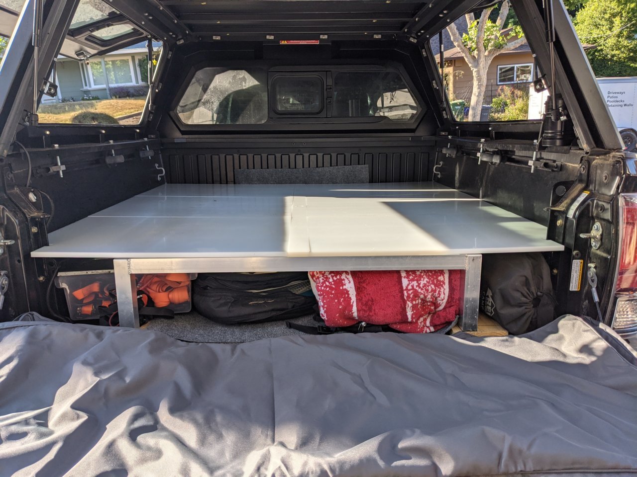

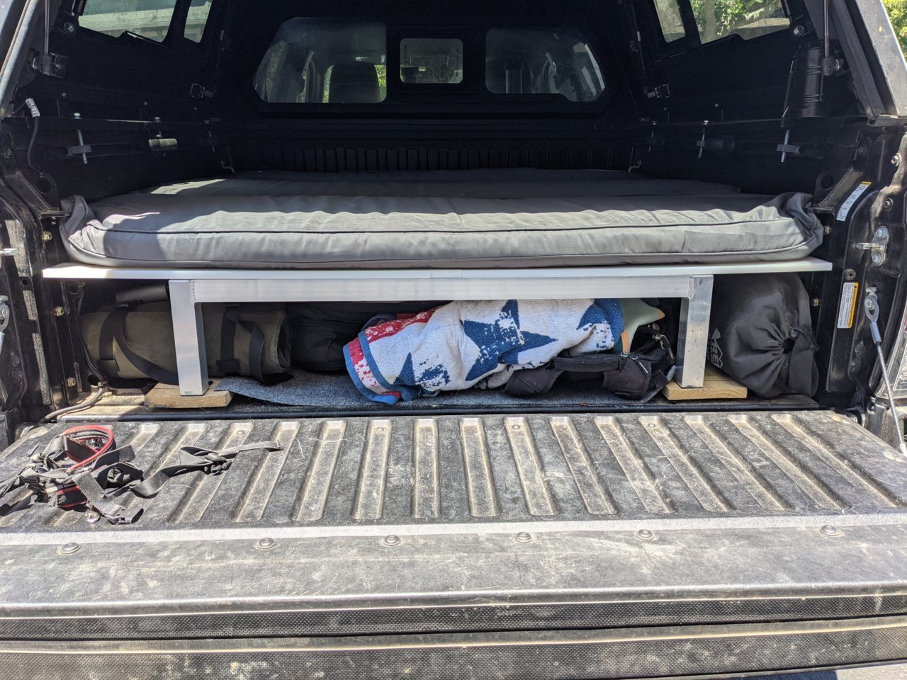

    Alucab Canopy Camper BAMF HC Dual Swingout Rear bumper BAMF Sliders Westcott 1.5" TRD pro lift Icon RXT option3 leaf pack Rago HD Shackles & Hangars BFG KO2 285/75/16 CBI T3 Aluminum front bumper Warn EVO 10S Total Chaos Bed stiffeners Home built Aluminum HDPE bed platform.

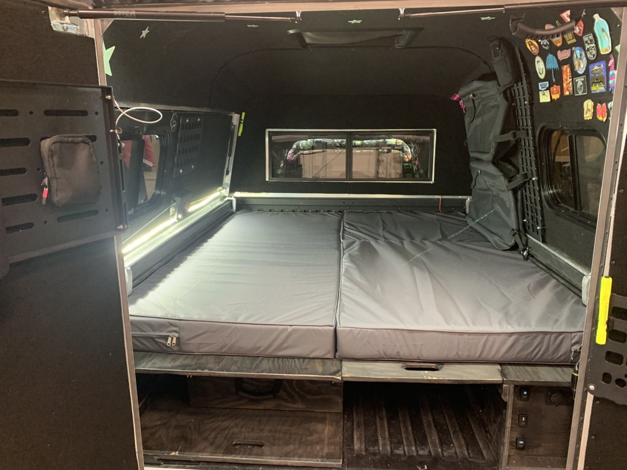

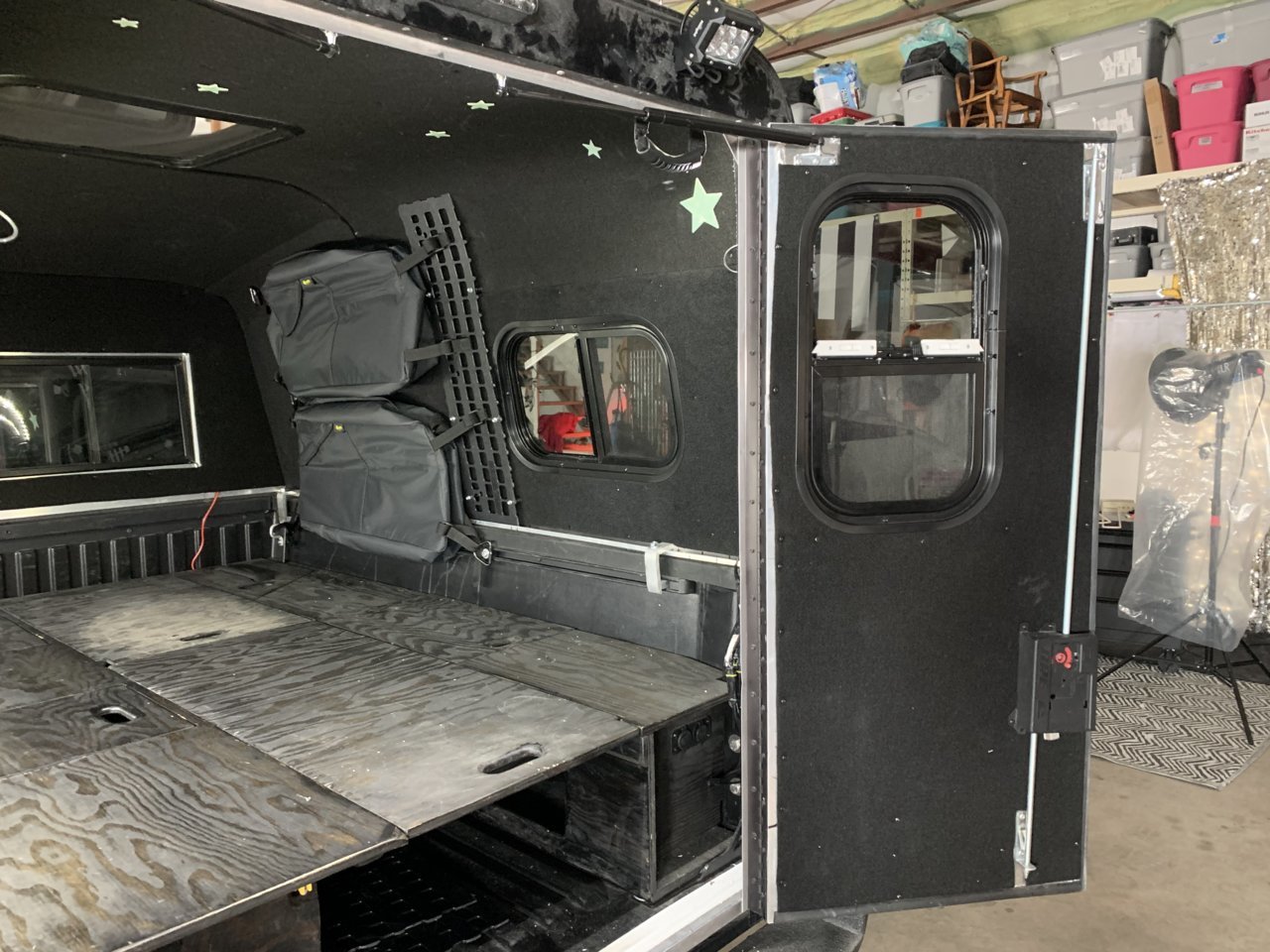

    V 2.0
    3/8 HDPE 6 pieces and a center spine. Got a good deal on it because it was a local shops scrap
    3 57.5" x 20" custom cushions 2" thick
    3 dunnage racks 20 x 36 x 8"
    2 60" 1x4 common board cut with runners to hold it in place
    Just need to trim the ends for my bed stiffeners

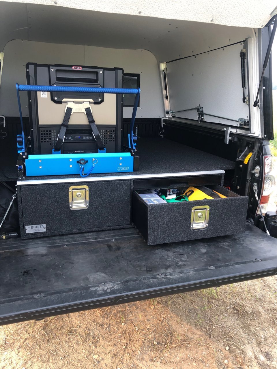

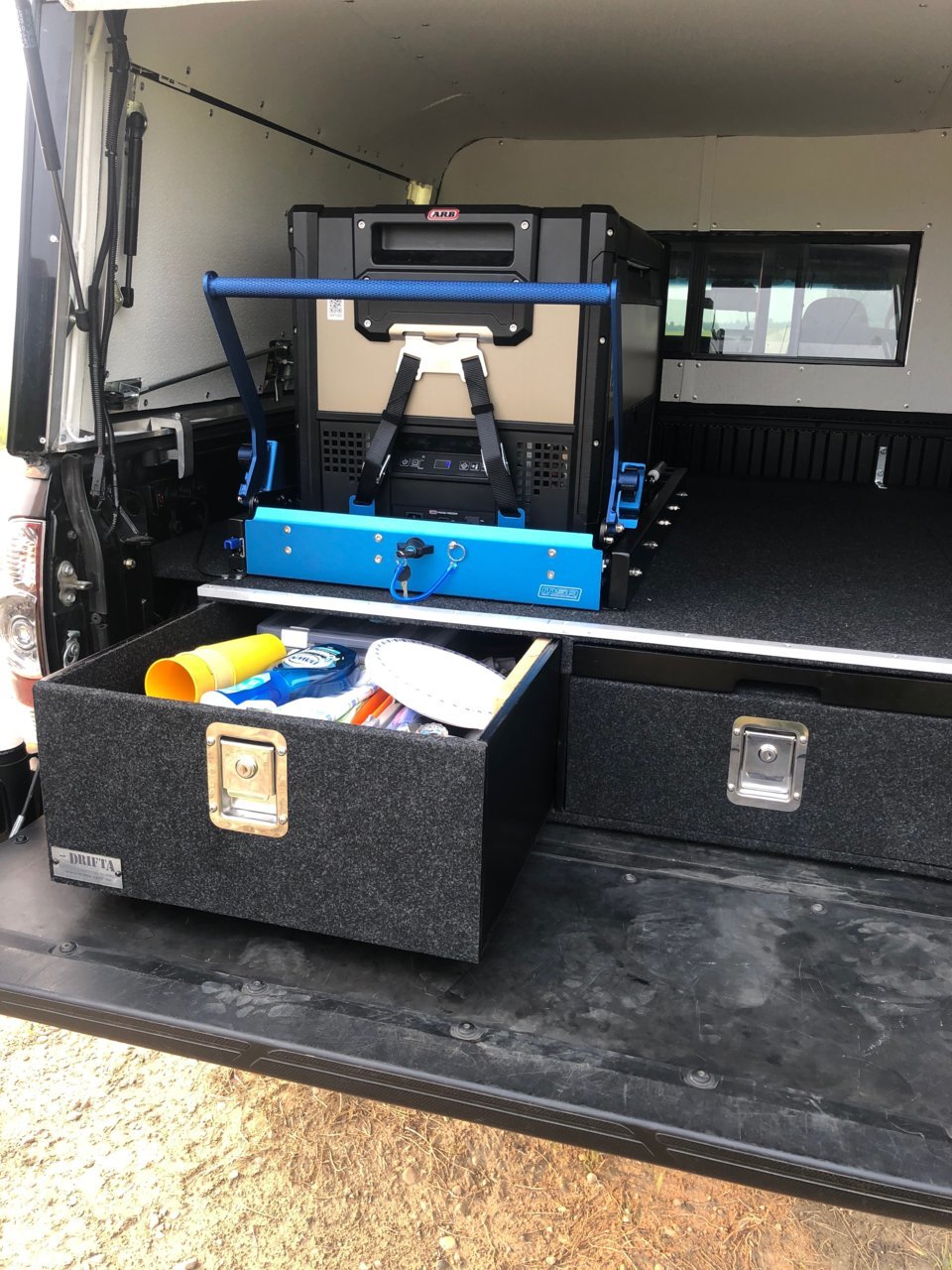

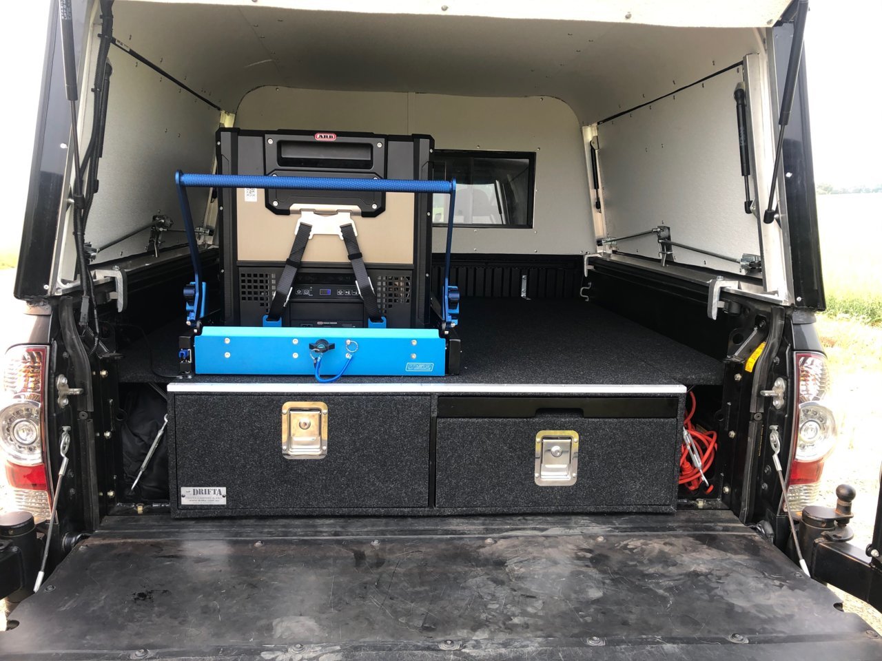

    Just got these the other day and had some time to install over the past two days. Drawers are VERY well made and fit in the bed amazingly. The drawers hold so much stuff and it has a built in table!!

    You bought these built? They look great

    Yes, they were ordered from Drifta (in Australia) through the North American distributer Kakadu Camping in British Columbia. They are very well built and work amazing so far. IMO they are superior to the Decked system as they have larger drawers and fit the bed much better.
    Eta- they also have a built in table above the shallow drawer.

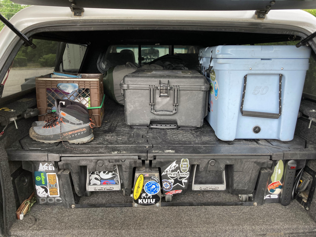

    Usually I'm backpacking or riding in to backcountry camp but the Exped on top of the decked works great in a pinch. Most valuable item in there is the milk crate. 16016FE0-A10F-40DF-940E-8C0A23976D0F.jpg

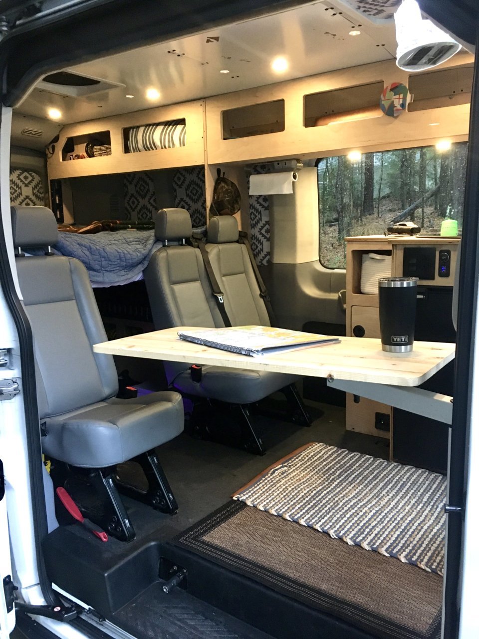

    reminds me of the book How Buildings Learn x Stewart Brand.
    "... permanent is temporary and temporary is permanent ... "

    How tall is the decked system? From the floor to the top of the platform?
  20. Jul 21, 2021 at 8:01 AM
    #2720
    Coconutman7
    Coconutman7 Well-Known Member
    Jun 30, 2021
    #370008
    80
    Southeast
    09 TRD Sport DCLB
    From floor to deck is 11.5”. Drawers are roughly 8.5” deep if I remember correctly.
